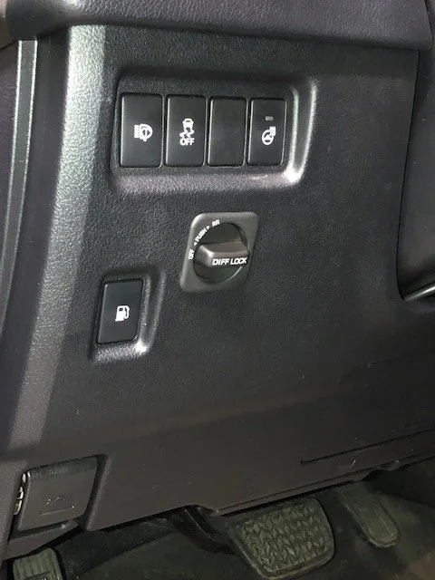

I am going to use a 100 series rear diff switch and I do not plan to regear at this time.
This is 80 series switch but going to pick up the wire splices and male connector for my 100 series switch.

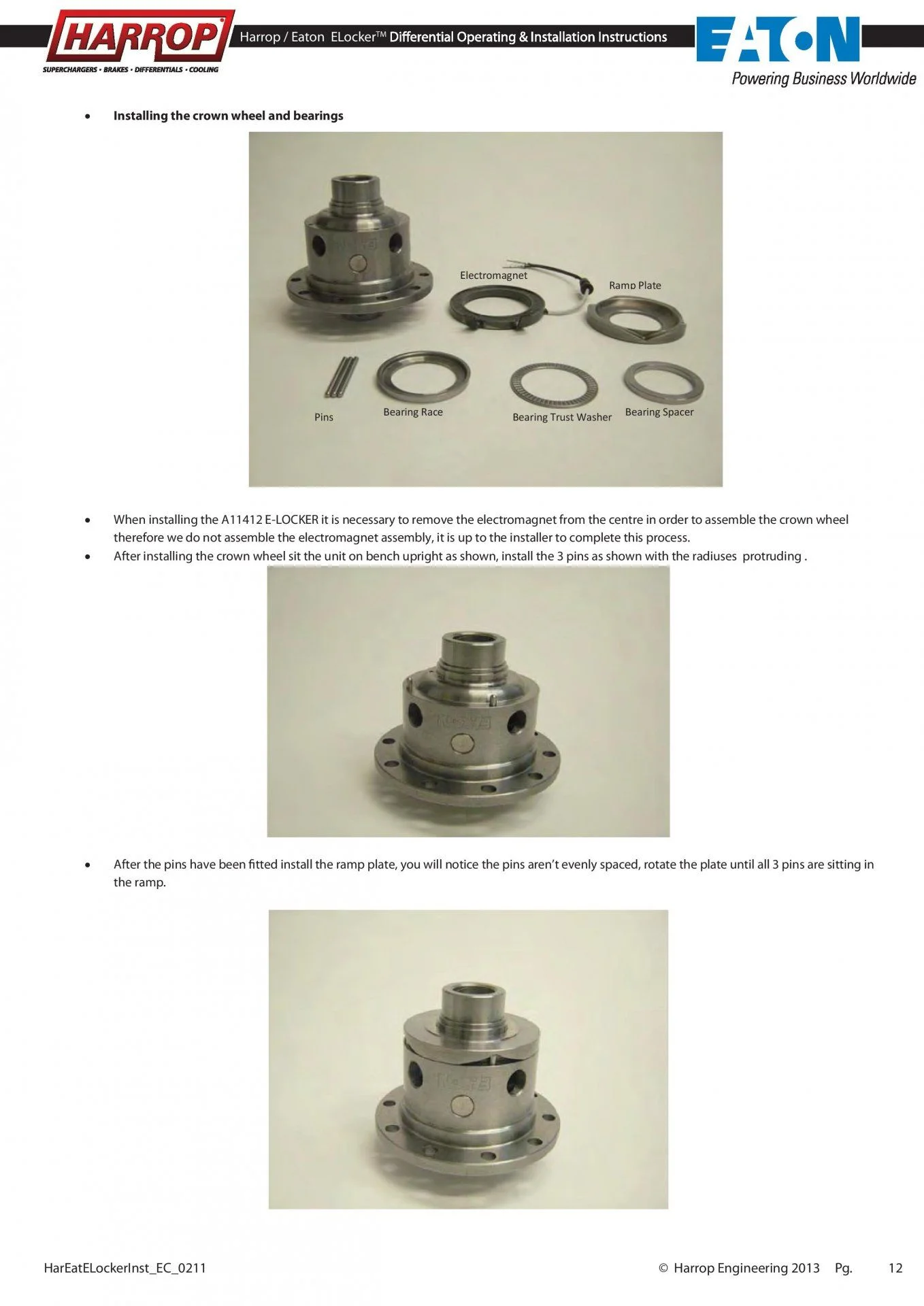

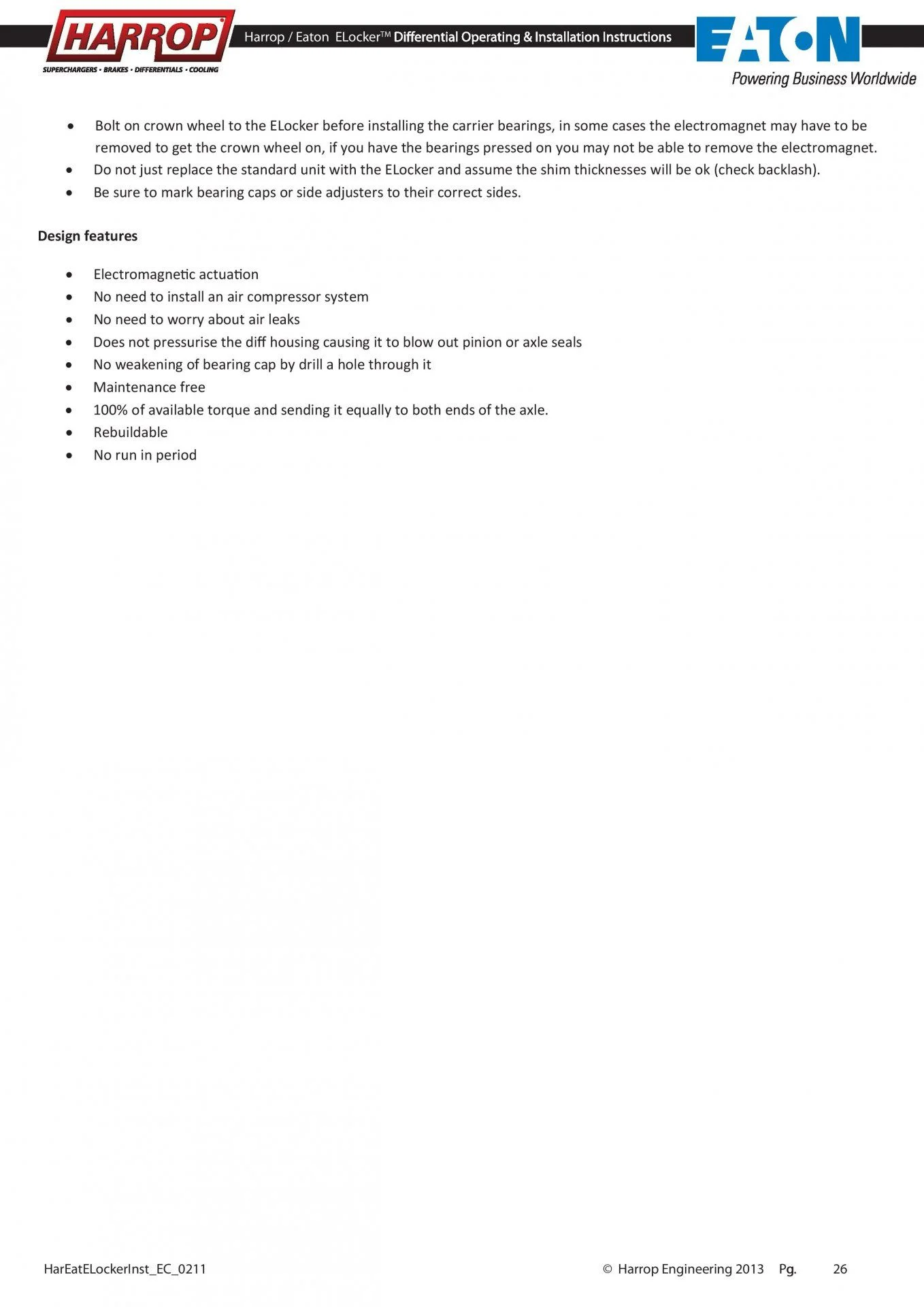

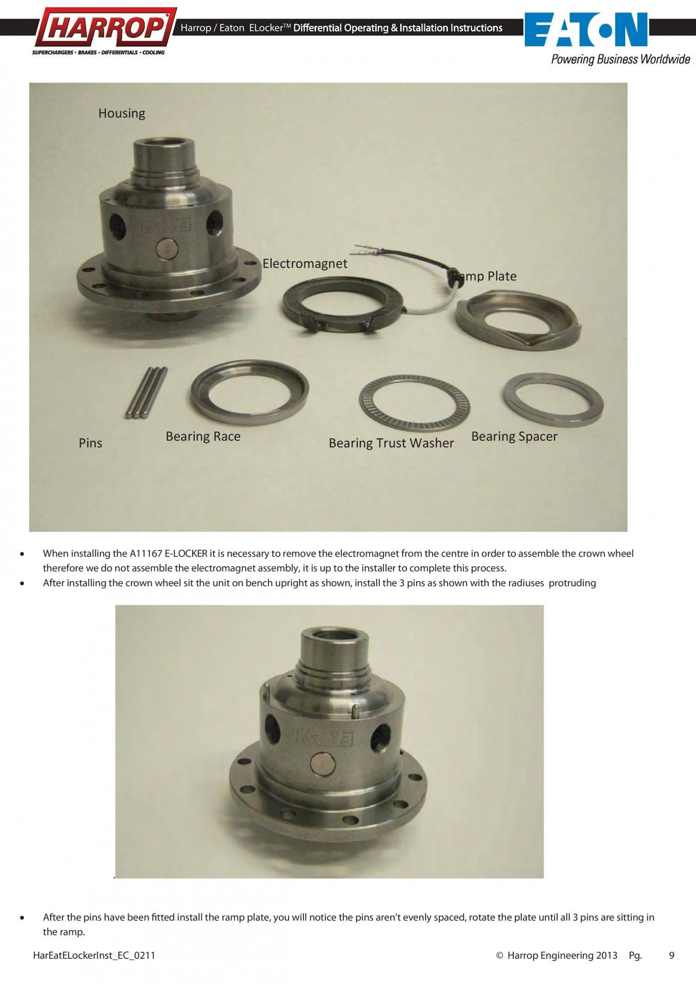

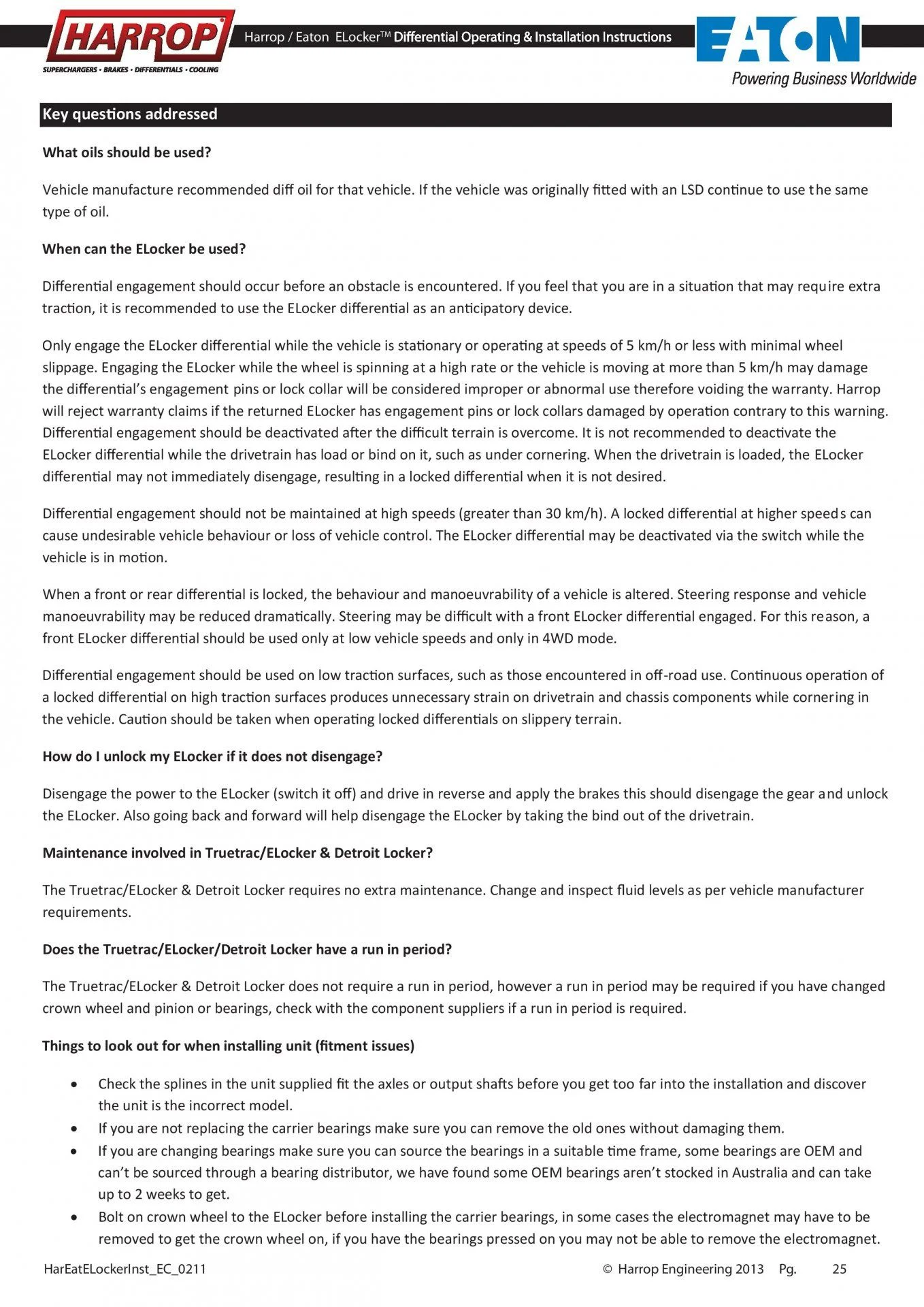

Installation Instructions
https://lexusgxor.com/_media/general:harrop_installation.pdf
