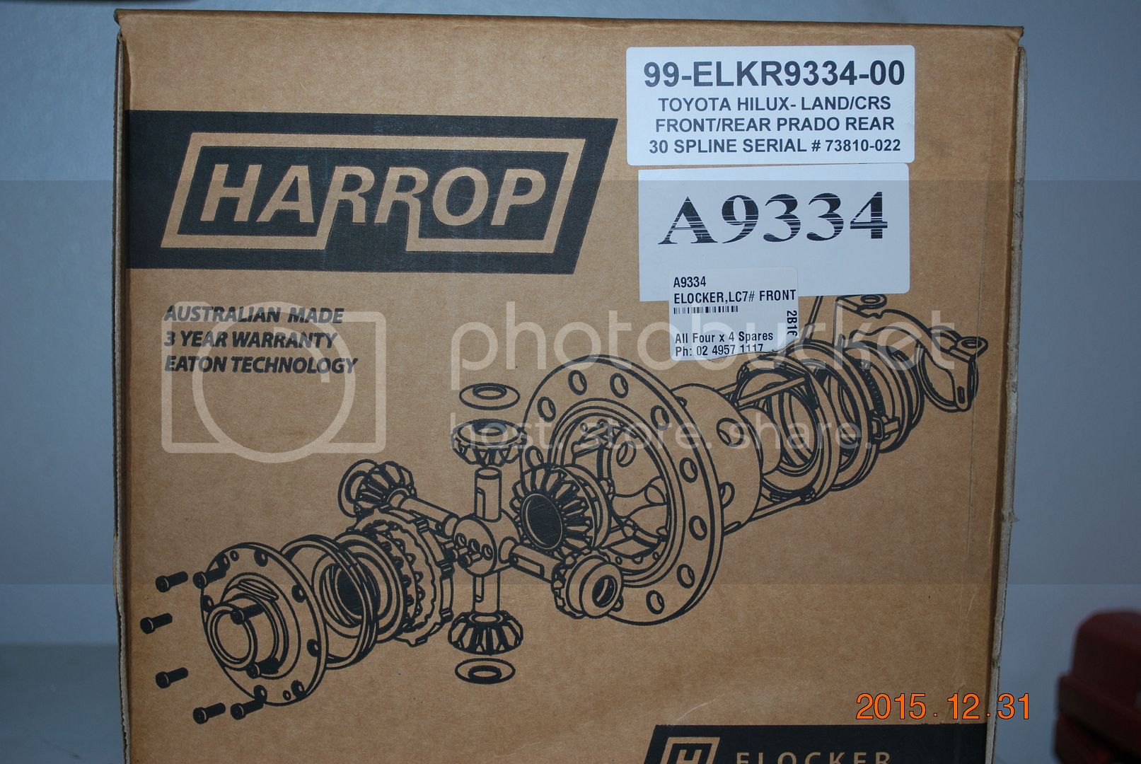

It's here! About 8 days delivery time from Australia!

Yeah dude! I'd love to take a look at it and see what I can do for the wiring.
Will you have to "grind" or "notch" the housing to fit the harrop e-locker in a non-locked axel housing?
Nope...It's my understanding that these are direct fit for unlocked front diffs (no grinding or notching as would be required for swapping OE elockers).
:cool: not that it matters to me, but was curious. I think you will love that set up.
(I'll tell Joey to put away the grinder now).

GENERAL INFO - Not an Eaton, but a Harrop, who licensed some intellectual property / design issues from Eaton. These are made in Australia and use some parts from Eaton, but definitely not the same thing.
