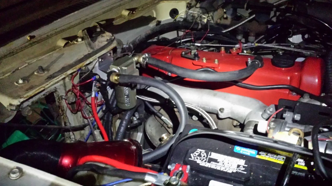

I made a bracket for the oil separator and bolted to the firewall with some rivnuts. I need to clean up the wiring soon!

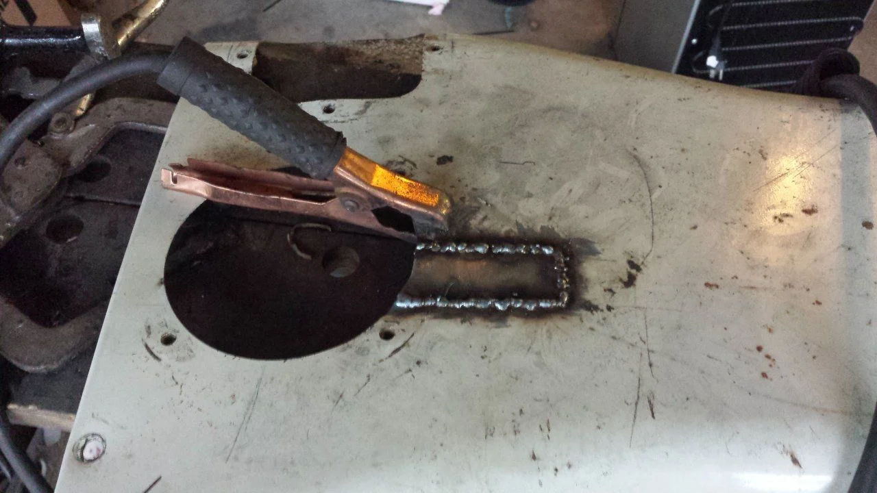

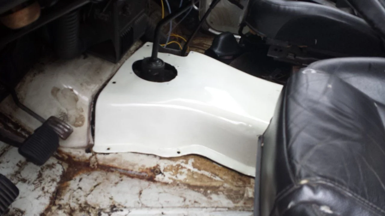

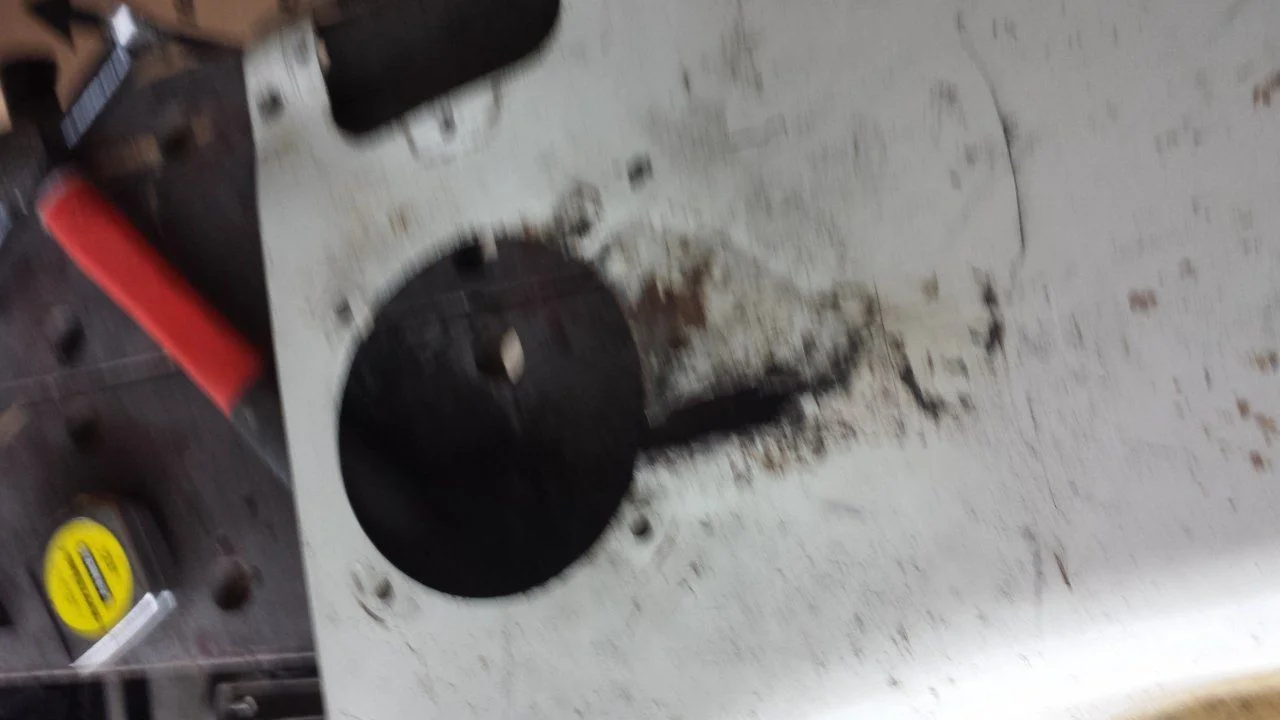

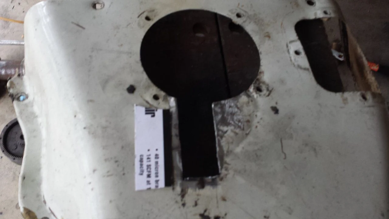

For some reason, the shifter cover was all jacked up. I cut out the jagged section with the plasma cutter and welded in a new piece. It's far from perfect, but looks better than what it was.
Heck yeah! Once you clean that up and paint, done. How does that plasma cutter work for that type of operation? I need to get one, someday.
Dave, I'm doing the same thing. Get you one of the "copper spoons." 10 clams at HF. It's t*ts.
Scrapdaddy, I can't speak for the OP, but my plasma cutter might be the best tool I've bought behind the compressor and mig.

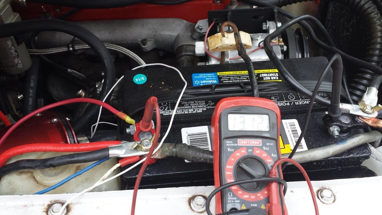

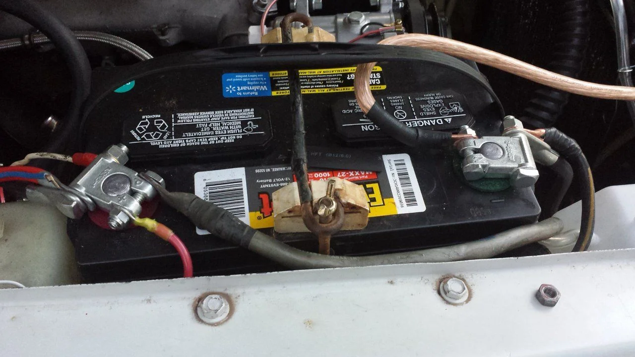

Did you upgrade your wiring harness when you went to the 10SI alternator? What all is involved to go from externally regulated to an internally regulated system? Are you running a voltmeter or ammeter?
The 10si alternator I use can be run as a one wire or three wire setup. The charging wire is a 10 gauge wire that goes straight to the battery. The charge light wire needs to be run to the existing charge light circuit, but I haven't done that yet. The last wire, remote sense, is just jumpered to the battery terminal. I did disconnect the external regulator so the charge warning light isn't on. I think that's where I'll connect to the charge light circuit.
