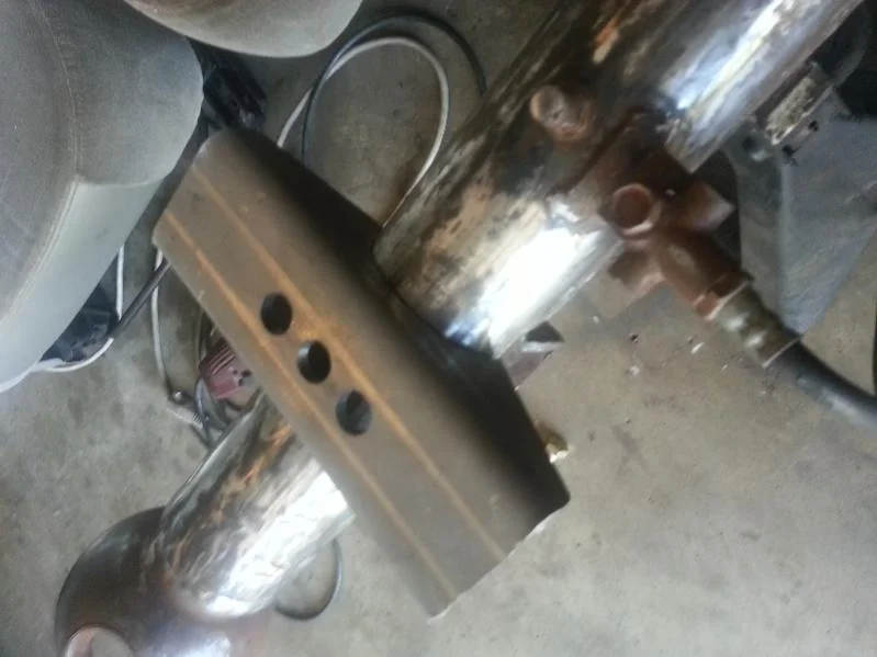

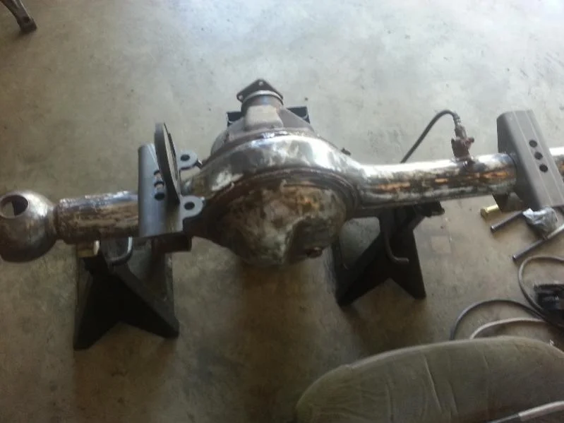

Well, I finally had some time (and sub 100 degree temps) to work on the piggie. I got the turn signals mounted, swapped out the wide tires for some 33's until I can find some 35's, and I also decided to keep it SOA with a proper cut and turn. I ordered Ruff Stuff's front SOA kit and it arrived last week. The parts are stout!
Yes ,I wasn't exactly sure,had mine at 12 then kept reading 14-15,so I did mine @14.The more I clocked it the harder it was to make the RS perch work with the 60 axle and not exceed 31" width.Anyway I will be watching:)
I might just stick with the 12. Kurt at CruiserOutfitters tells me he sets axles up between 8 and 12 degrees. But, I'm going to check the angles on the axle that is on the pig now. It wasn't cut and turned but should give me a good idea on the angles.
