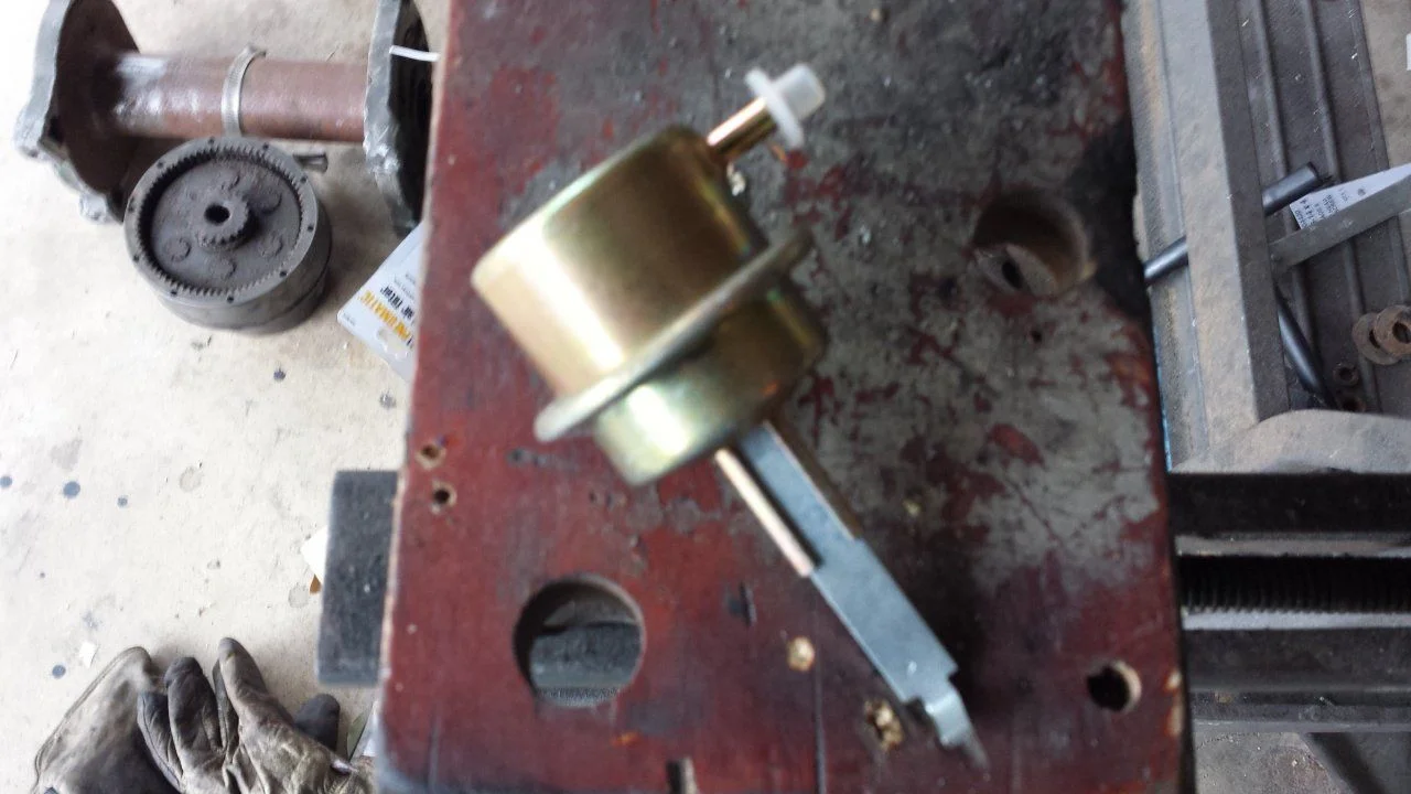

Got the new gauges to work. I need to get the stock water temp gauge working next.
The gauges are by Hewitt Industries and AutoMeter.

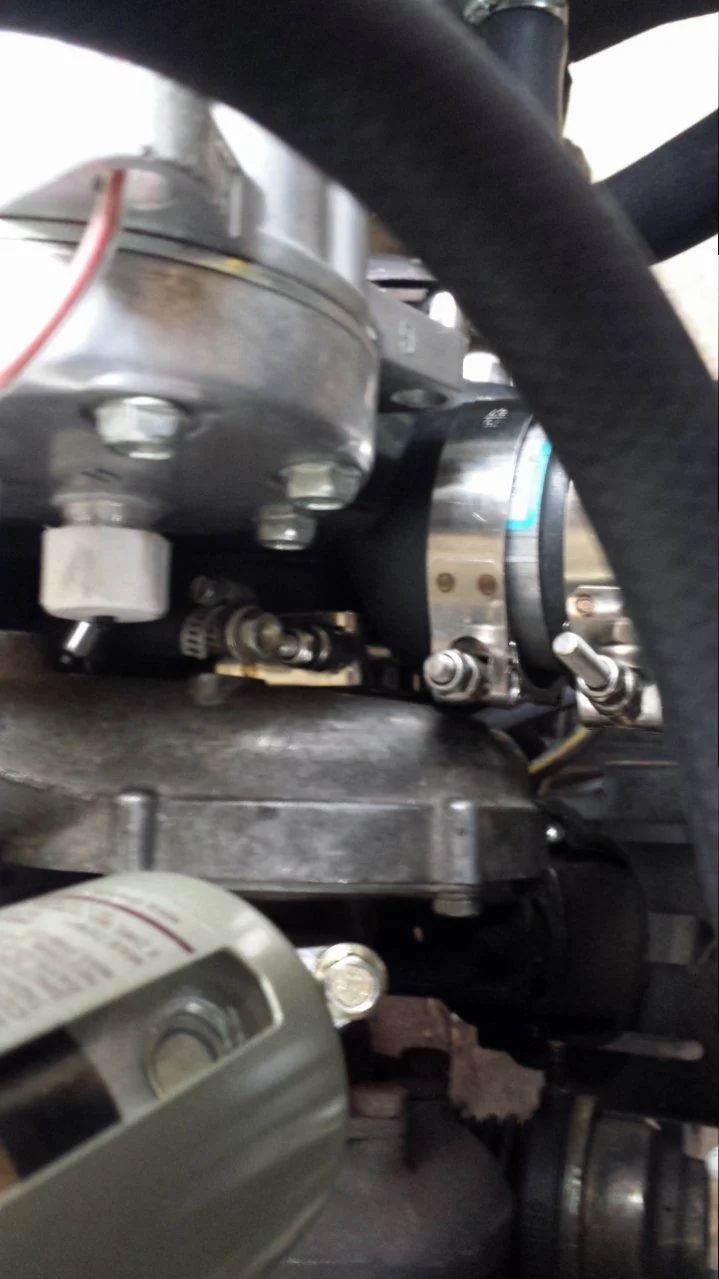

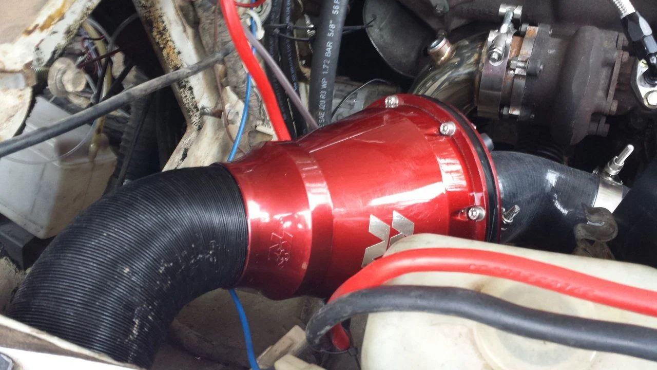

David,
Is that shut down valve like a run away valve, that cuts off the fuel in a run away situation? I'm not sure of the right terminology. I carry a piece of 2x6 in order to cover the air intake, in case of a run away.
Ron, this is the primary way of shutting off the engine. There is a mechanical linkage that can be used on the pump if the vacuum valve doesn't work.
I also have a board ready just incase none of those mechanisms work.
