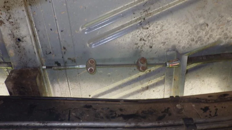

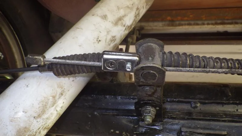

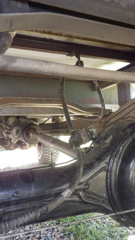

shortened my spare e brake cable for the ol 55 series tcase brake by twisting the crimp end off of the drum end, cut the sheath to length, strip the out sheath jacket and re thread crimp end onto cable housing coils. as gunna make a splice bracket, but found suitable spots under the rig to do what the bracket would have.....I compromised. Had to cut the end off of the 55 cable and used u-clamp splice for now. I had one tiller splice which I used to take up the slack on the passenger side fzj80 brake cable(due to shortened housing)I will get 2 or 3 more tillers to replace the u clamps with, and then cover the whole cable splice joint in a rubber bellows thingy similar to a shock absorber booty that I still need to look for...the point is, I have an e brake.....

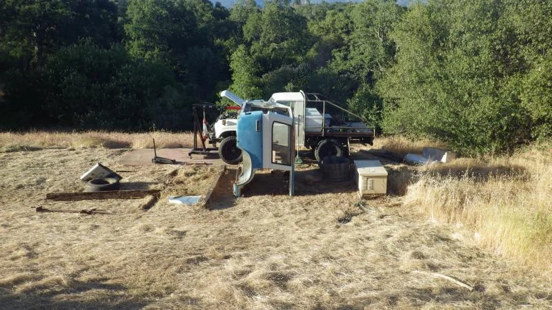

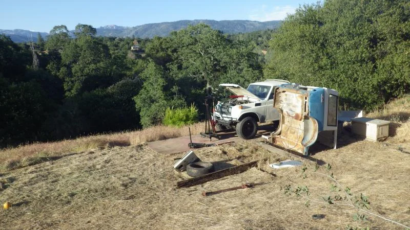

machine shop still has the motor, they say wednesday now:rolleyes: best laid plans and all....got the only concrete patch on the lot unearthed and cleared so I won't have to do this dance on the gravel this time. looks like theres just enough room for the cherry picker....

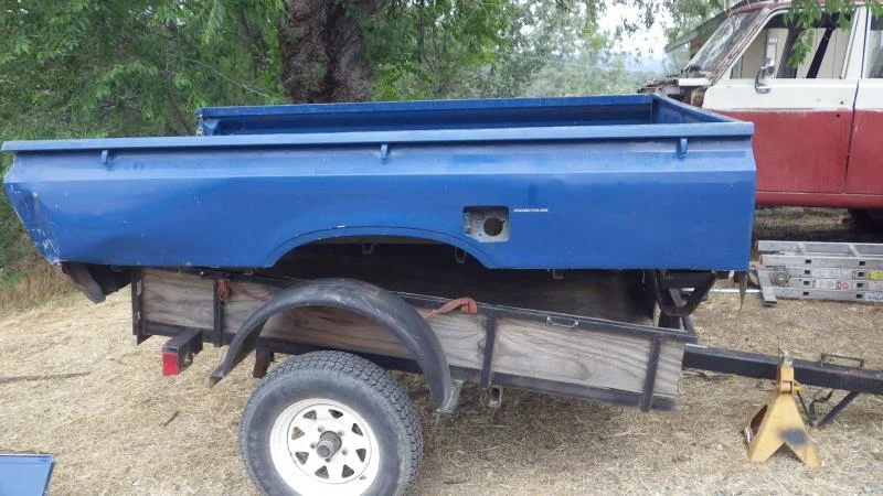

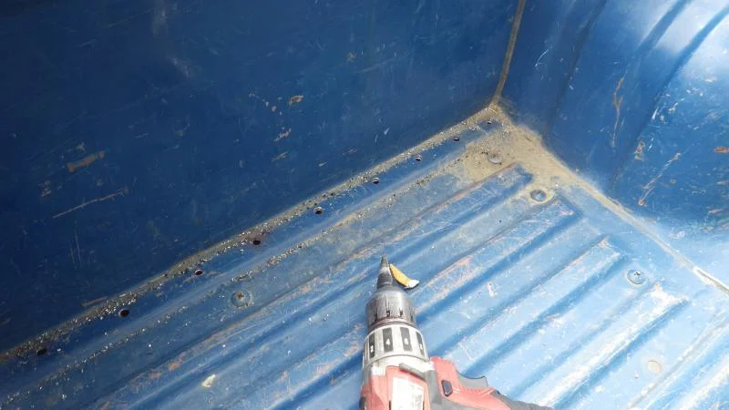

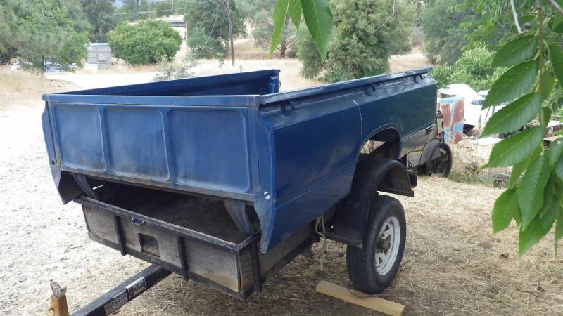

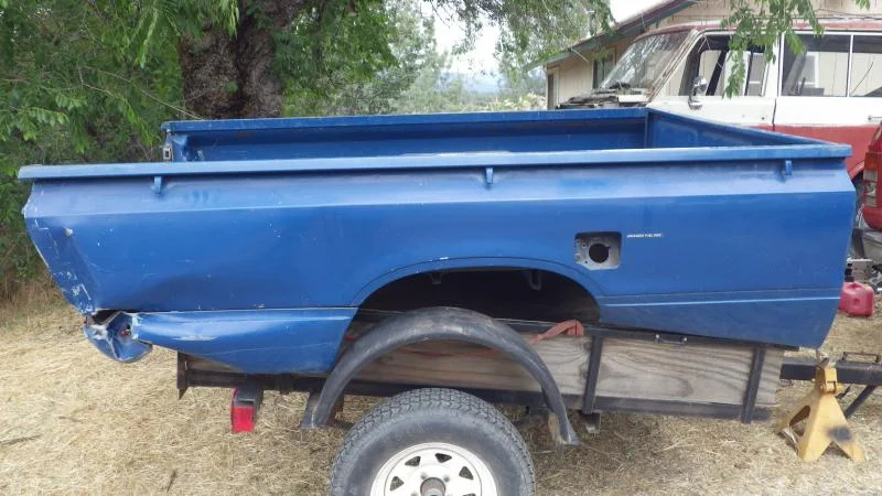

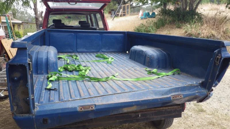

its here......not the motor, but.....it doesn't look like how he remembered it looking on the phone, but free looks great to me. the thing has got to be at least 200 pounds lighter.....you know me, had it home for a half hour before I started drilling spot welds and yanking things off...
the skirt comes off, some step hoops go under on the fore side of the wheel well. the gas door is on the wrong side, and before the axle, so the bed will be flipped to put the gas door at the right spot and move the damage to the front, so most of it gets cut off. overall, 11 inches will come out of it, maybe 13; yep 13, for a new OAL of 76". it is too narrow and the wheel well gap cannot grow, so I have drilled the spot weld for the sidewall to floorpan, will add a piece of 1 1/2 X 3 to each side with 1" overlap under the bed lip to bump each side out 2", then the tailgate can get re-worked....

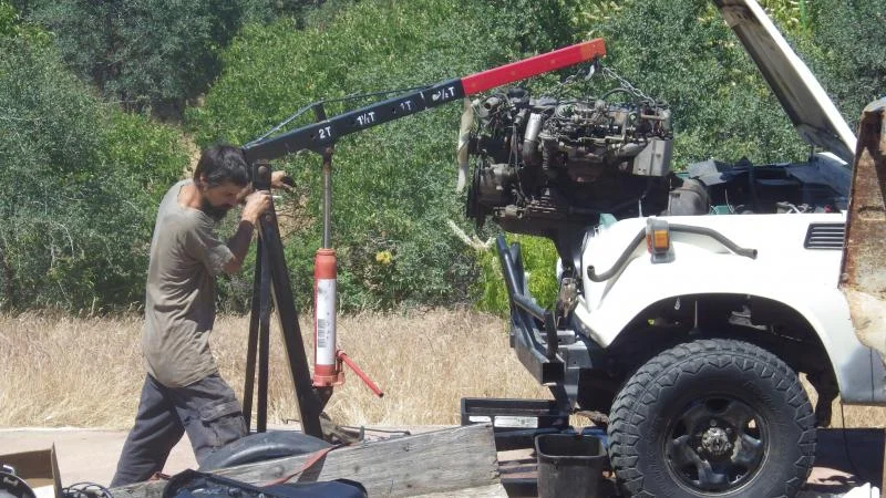

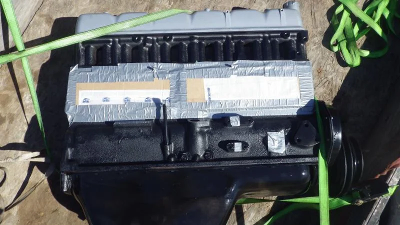

it's here. 3K in motor. bragging rights for those who can tell the world what's wrong with it.....
It's on its side? Wait, its not in your pig? I don't know, it needs 2 more cylinders?
I saw it right away, was like Cmon, guy....I guess it's a 2effer thang. I told him to leave it and I'd fix it. I gotta redo the valve lash too, as it's set for stock and not the 014/014 that the new delta wants. Not sure if I'm going to know what to do without an oily mess.....game is still on...
