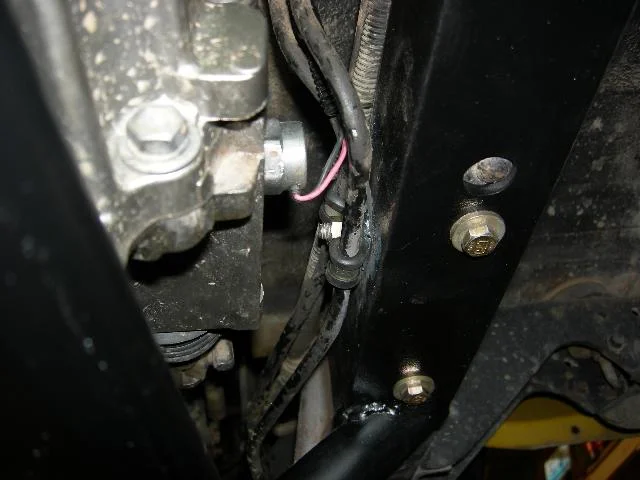

Finally was able to get the skid plate for this fabricated and installed this weekend...
John’s truck still has the stock fuel lines on the frame. I modified them a bit to clear the newer style transmission mount that was installed. The rear mounting provision on the frame for securing the lines was now covered up by the angle used for the skid plate, so welded a bolt to the inner angle plate and used two rubber-cushioned positioning clamps to now secure the lines to the frame.....
This truck goes down the road so nice. It is a real pleasure to drive John!

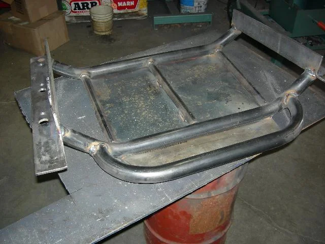

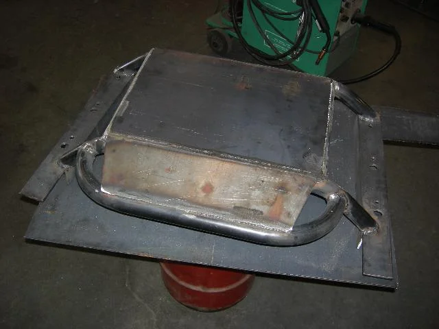

Nice work on the skid plate. What size tubing and plate did you use? Any plans for a transfer case drain area, or just drop it when needed?
The tube used was 1.5”x.120” HREW for the main cross tubes and hoop around the parking brake drum. Three 1”x .120” tube was used for the stringers between the front and rear cross tubes. .250” plate was then welded to the tube frame.
It is only six bolts securing it to the frame and the one bolt securing the fuel lines that need to be removed in order to drop it. Drain holes invite rocks and other things directly into the drain plug to cause unwanted drama with them.
