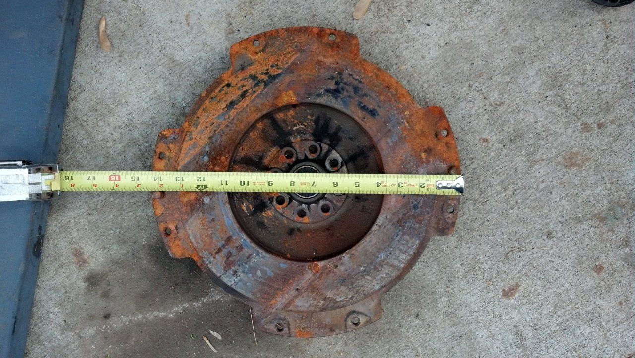

if you look closer in that pic you post Johnny, you will see there is a step .. it varies according to the clutch combo you use .. 275mm vs 300mm
Mine APPEARS to be 12" across the raised part (300mm?)
Thanks Mark, although I was hoping for something more precise than that. It appears that you have a 300mm clutch, whereas I have a 275mm clutch.
Does anyone have a 275mm flywheel that we can measure up?
EDIT: Realizing that I have the dimensions of the step from the friction disk I have. What I need is the height of the step, measured in thousandths.
SORR-REEEE if I wasn't PRECISE enough for you. ;) I thought the initial question was "Is there a step?"
Yes, I think mine is 300mm and I really don't have a reliable way to measure the step - especially given the rust. But mine might not be a good reference for you anyway.
To wrap the flywheel discussion up, I had it machined with a .020" step, which is the FJ60 specification. I could not find the step height listed for the FZJ80 anywhere:
