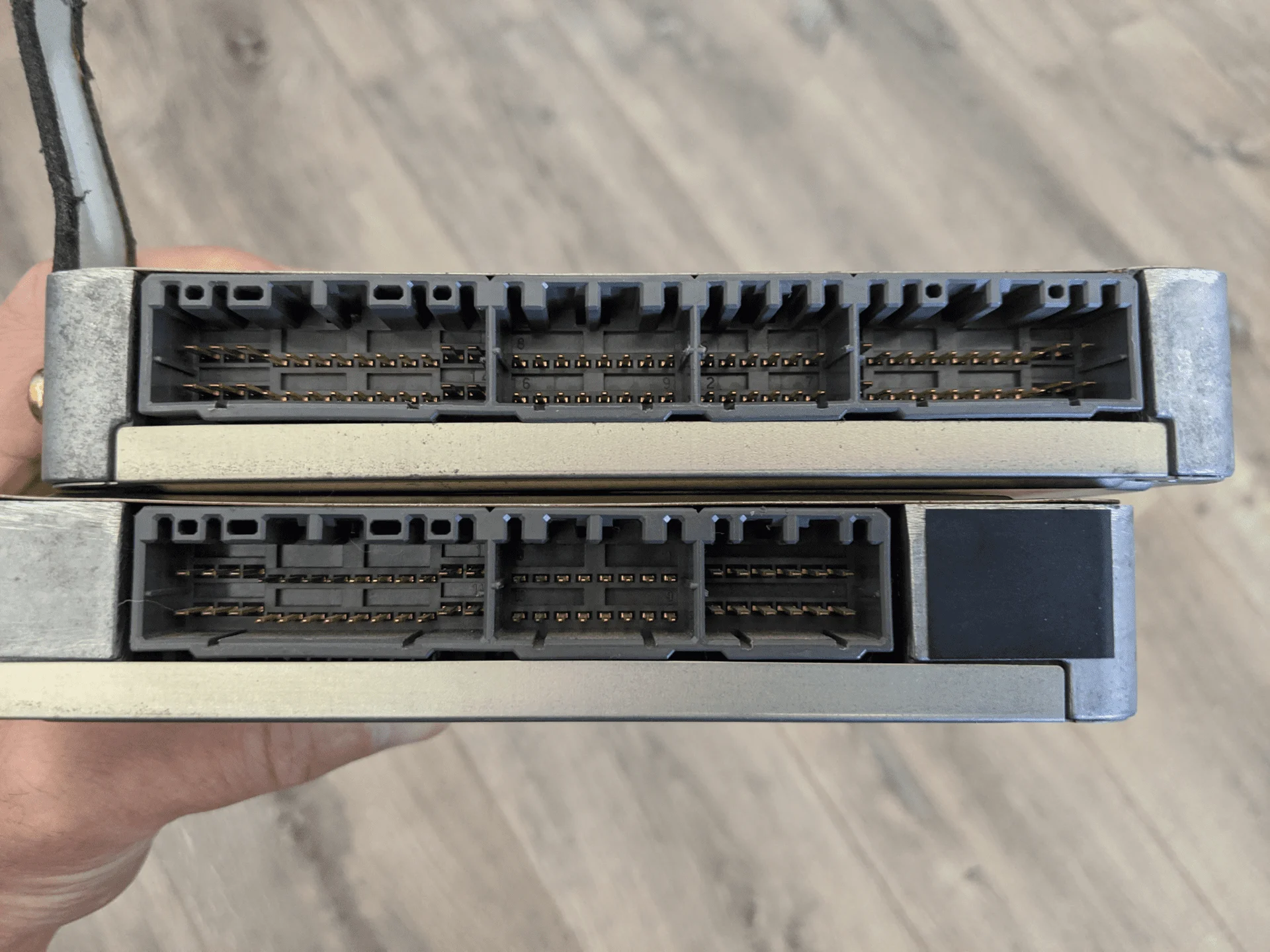

Dennis, you talking specifically the 95+? The MT (93/94) ECU 89661-60200 I picked up in Australia last year has a different plug for the 12-pin connector. Pinout is the same, but it uses the wider lances.
Yes, i was referring to OBD2 ECU's, hence 95(maybe)/96/97
Sorry, i have no idea about earlier ones. Keep in mind, that the 5spd will work just fine with original auto ECU. The only reason to change it is to keep the CEL off if you live in a nazi emissions state.

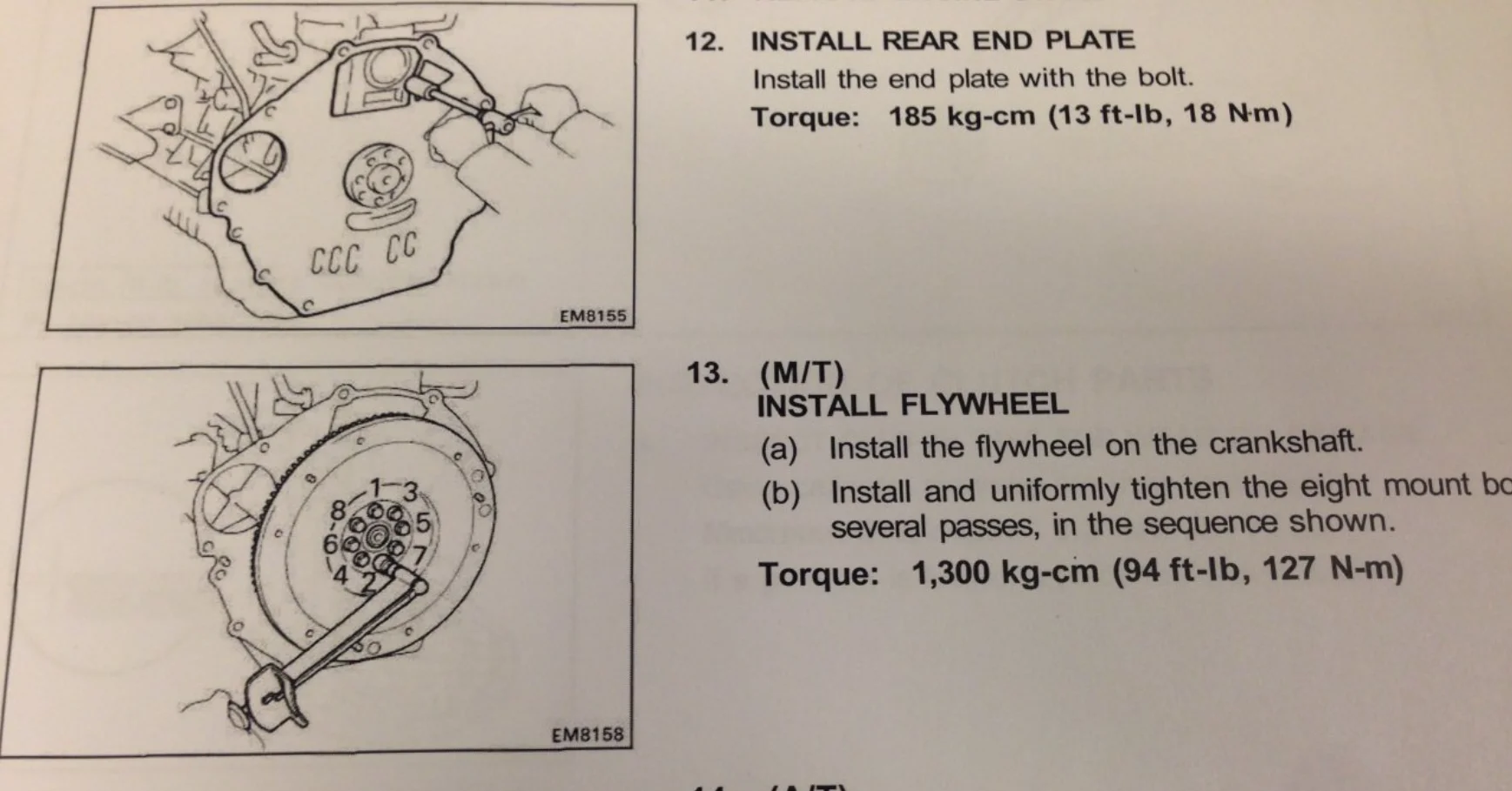

2. I noticed in few threads there is a "rear end plate" that was installed to engine block. I can't seem to find any information on this. The FSM shows it in the procedure with a single bolt to secure.

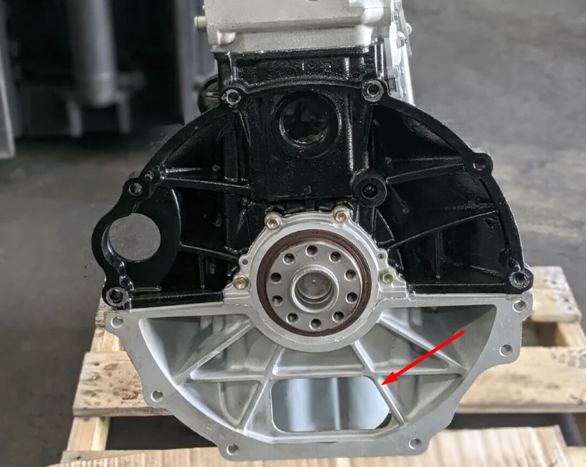

As far as #2, you don't HAVE to change the rear end plate. As far as i could see, the only difference on manual vs auto rear end plate is the little opening with a plug on the auto plate that is used to access torque converter bolts. It won't affect anything to have this opening with the manual tranny. I kept the auto plate on my truck when i did the swap and it works fine.

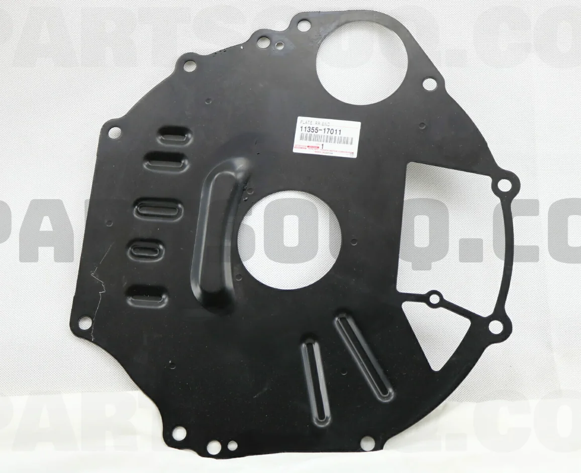

Dennis - Thanks for the reply. The access plug you are referring to is part of the upper oil pan casting on 1FZ. See first image below. The end plate looks like something that is installed before the flywheel. After digging around this part looks specific to 1HDFT and 1HZ plants with MTM. Not applicable to 1FZFE. This explains why no parts diagrams show it.
For those looking for the rear end plate part number: 11355-17010 Looks to be the same part for both 1HDFT and 1HZ.
