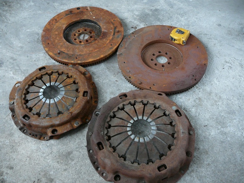

the problem comes with the tranny input shaft ..
the H150 use a 21 fine splines input shaft along with a 275mm clutch .. and the H151 use a coarse 14 splines ( weird but true ) and 300mm clutch ..
Here the comparision of clutch sets ..
main.php
One of my goals was use a 300mm clutch ( disc and Pressure plate ) ..

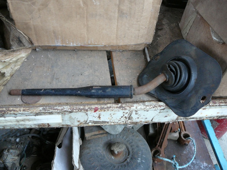

My shifter

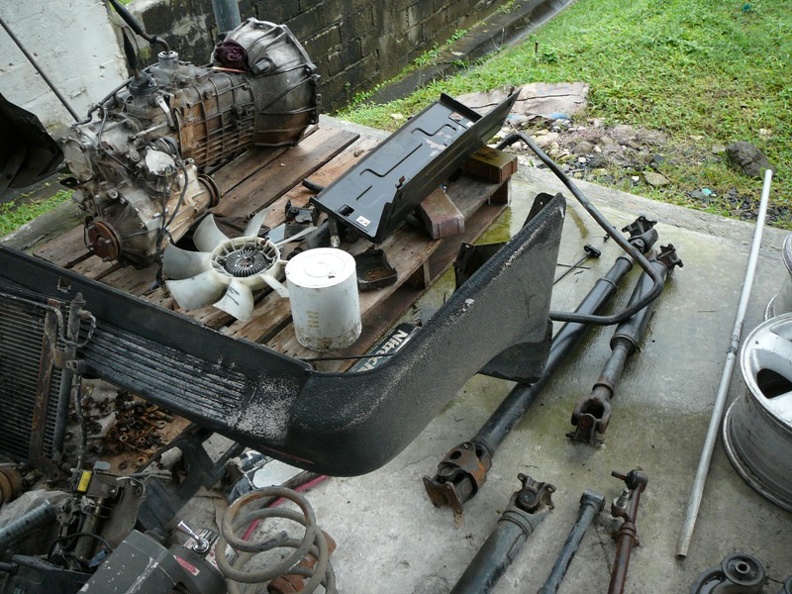

I was a lucky guy and after month and month got an H150 tranny .. complete !
main.php
Thanks Tito .. !

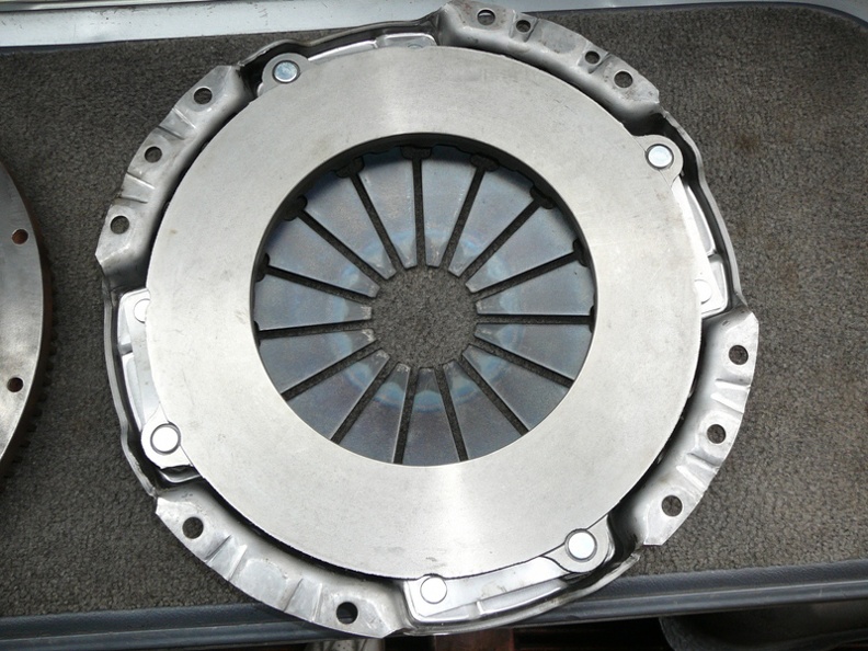

Here my flywheel .. ( got both 275mm and 300mm ) 300mm
The PPlate was easy .. extreme easy, coz it's a factory sotck 300mm PP for a 1HD-T both flywheels ( 275 and 300 ) are same size overall .. the only diference are the disc mirror ..
And no you can't use a 300mm flywheel and PP with a 275mm disc .. it let you only with less than 60% of contact surface ..

1HD-T 300mm PP
