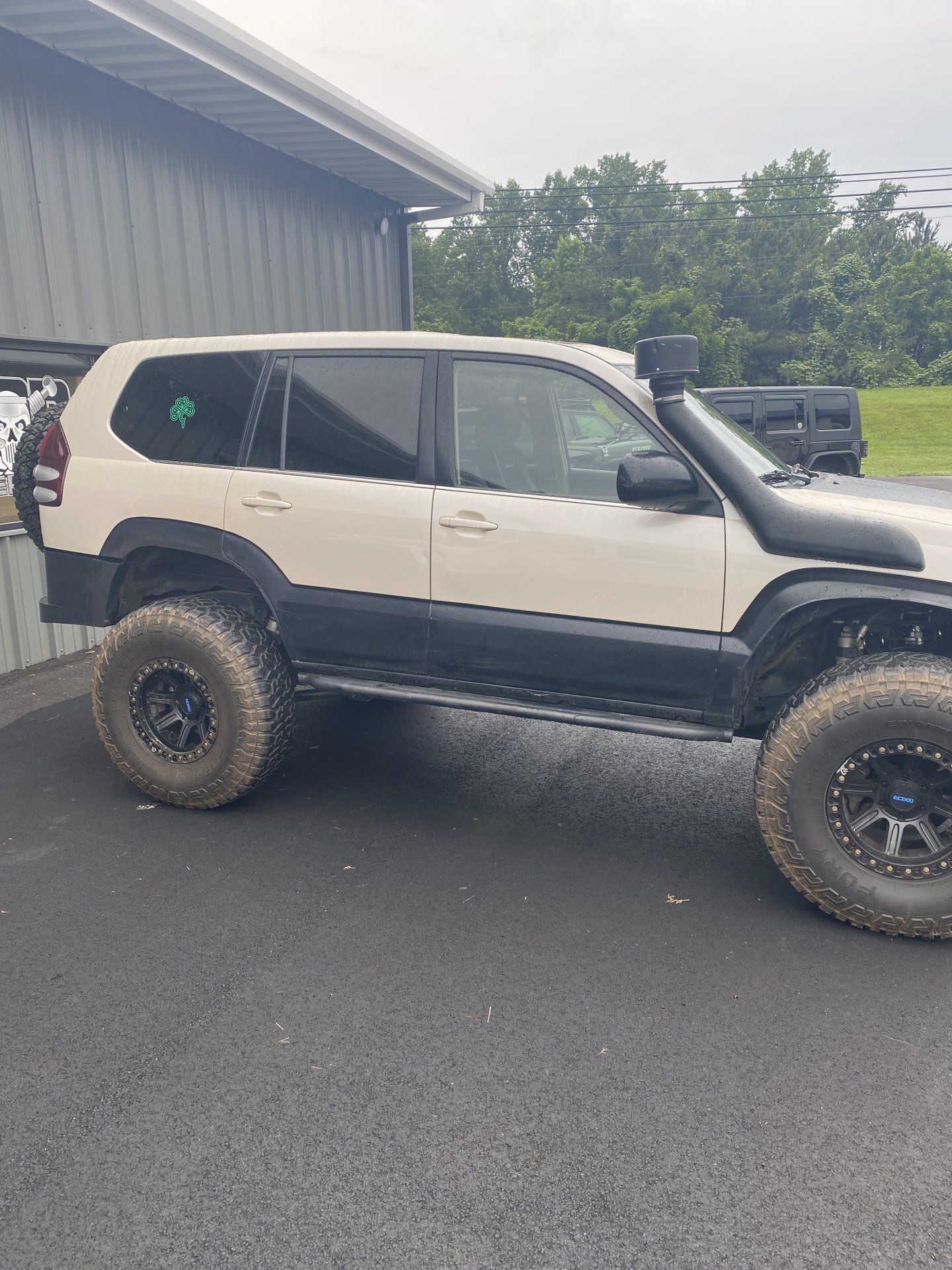

Big booty needed a lift. Some 749v Dobinsons did the trick. Also had the latch hook rewelded as the 37s are heavy and stress cracks were forming.

A few weeks and some miles later...still smooth and nice. It drives WAY better on road and I have the VSC off switch I installed for "spirited driving" mode when I don't want to get chucked into the ditch. Going to drive it very long distance in the coming weeks along with my (Hummus Panda) and her (Maggie) GX. We did a build on her GX to match my capability so we can wheel together.
What is a hummus panda?? Looks like her GX has substantially more lift than yours, she also on 37's?
It is all exactly the same truck to truck but mine is heavier. She and I both have 37s. . Mine is just sand dollar pearl and black two tone all over so hummus (color) and panda (pattern of two tone).
