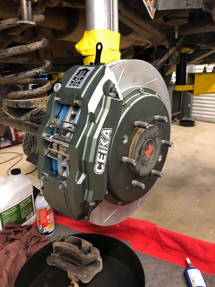

Ceika big brake kit (rear)
Wilwood big brake kit (front)

How do you like the Ceika brake kit? I was thinking about getting a set for the front of my 80 series.

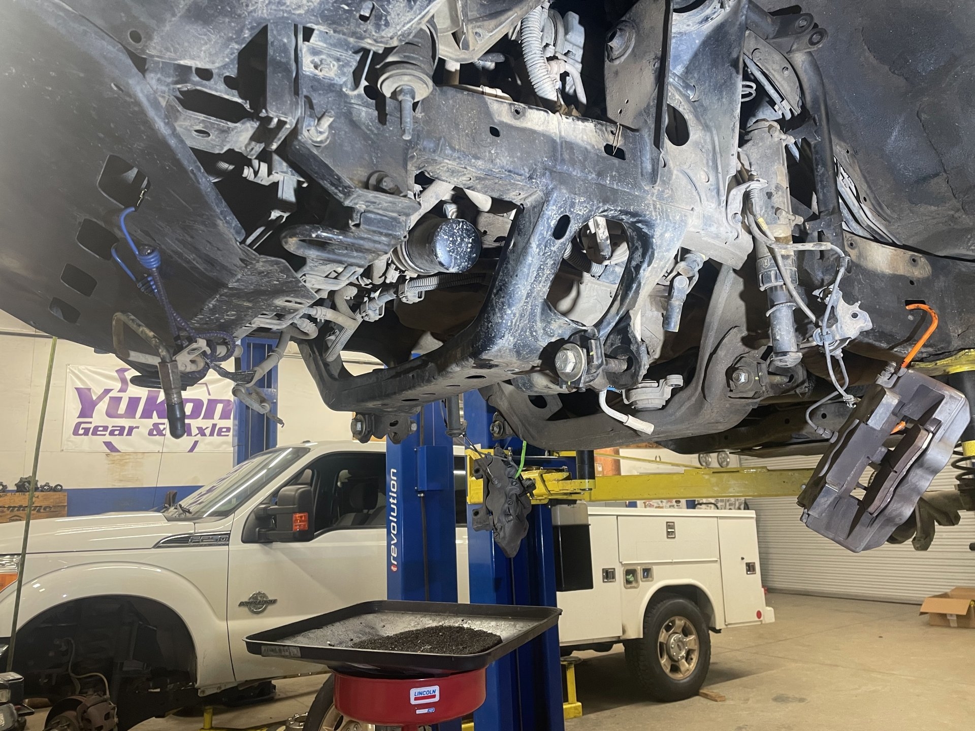

Tear down has begun.
It is coming along! Ran into a few issues with suppliers on the rear links and the engine mounts being from 2003 led to the marrack sitting on the oil pan. SOOOO...new motor mounts! The fit is almost done. The finish is going to take time. 4.88s and lockers are in both diffs. Things are coming together. Should be completely done and aligned in the next week. I am in Canada but returning next week so I am hoping to pick it up when I get back or by the following weekend.
