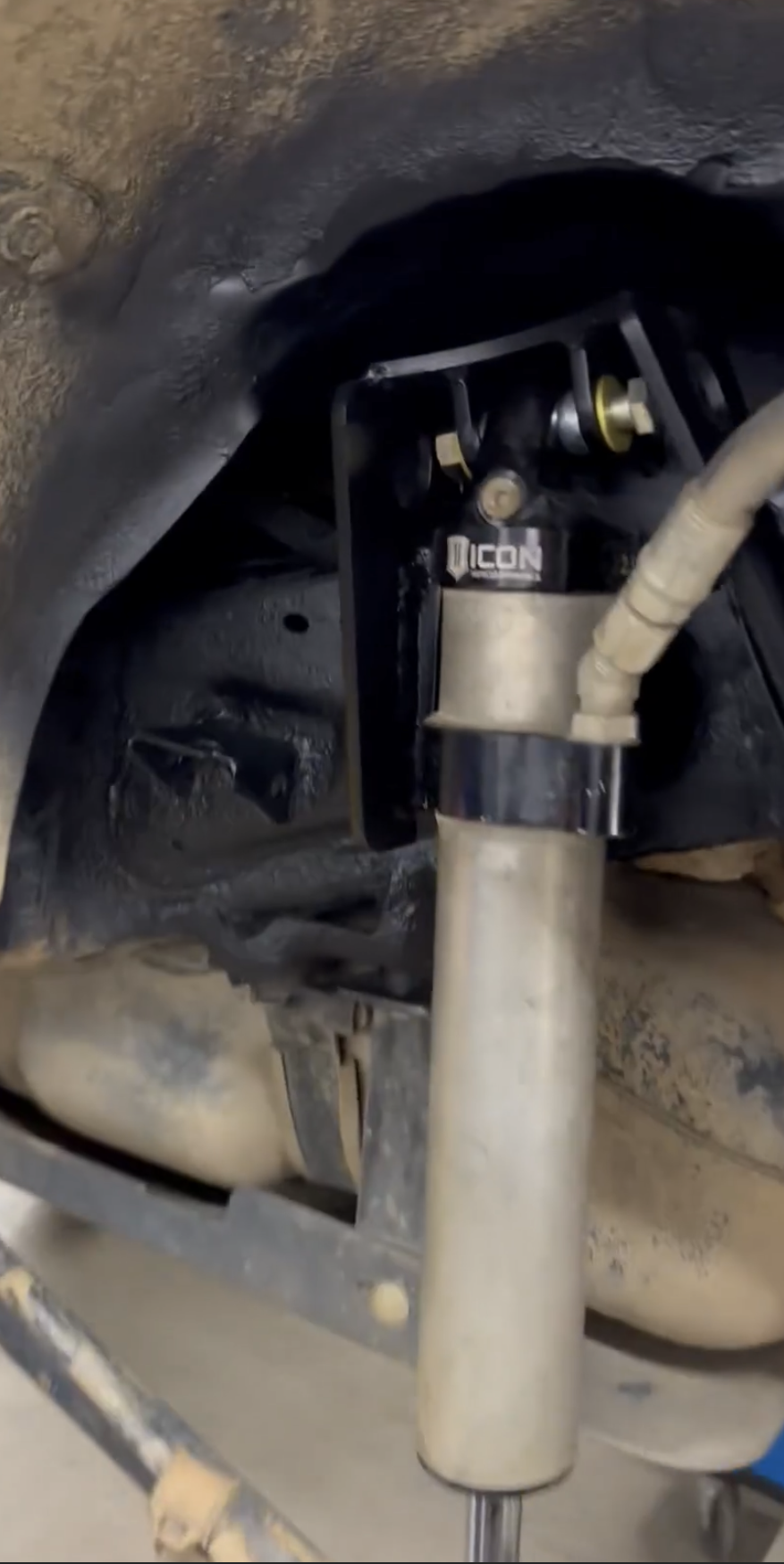

Another update! We installed Califab rear shock conversion kits and replaced the icon top caps with stems for the eyelet version. The conversion allows you to run eyelet and move the shock out a bit so you don't hit the frame and the stem to eyelet also relieves the torque on the shock that often twists the shock or strips the top stem out of the shock top cap. Pretty elegant and nice looking solution (Wife's was first so this pic is her shock)
Does this contact and stripping of the cap occur on all or just the long travel?
Long travel. If you don't use a limit strap it can allow the shock body to make contact with the bottom edge of the frame at full droop and torque the top stem.
