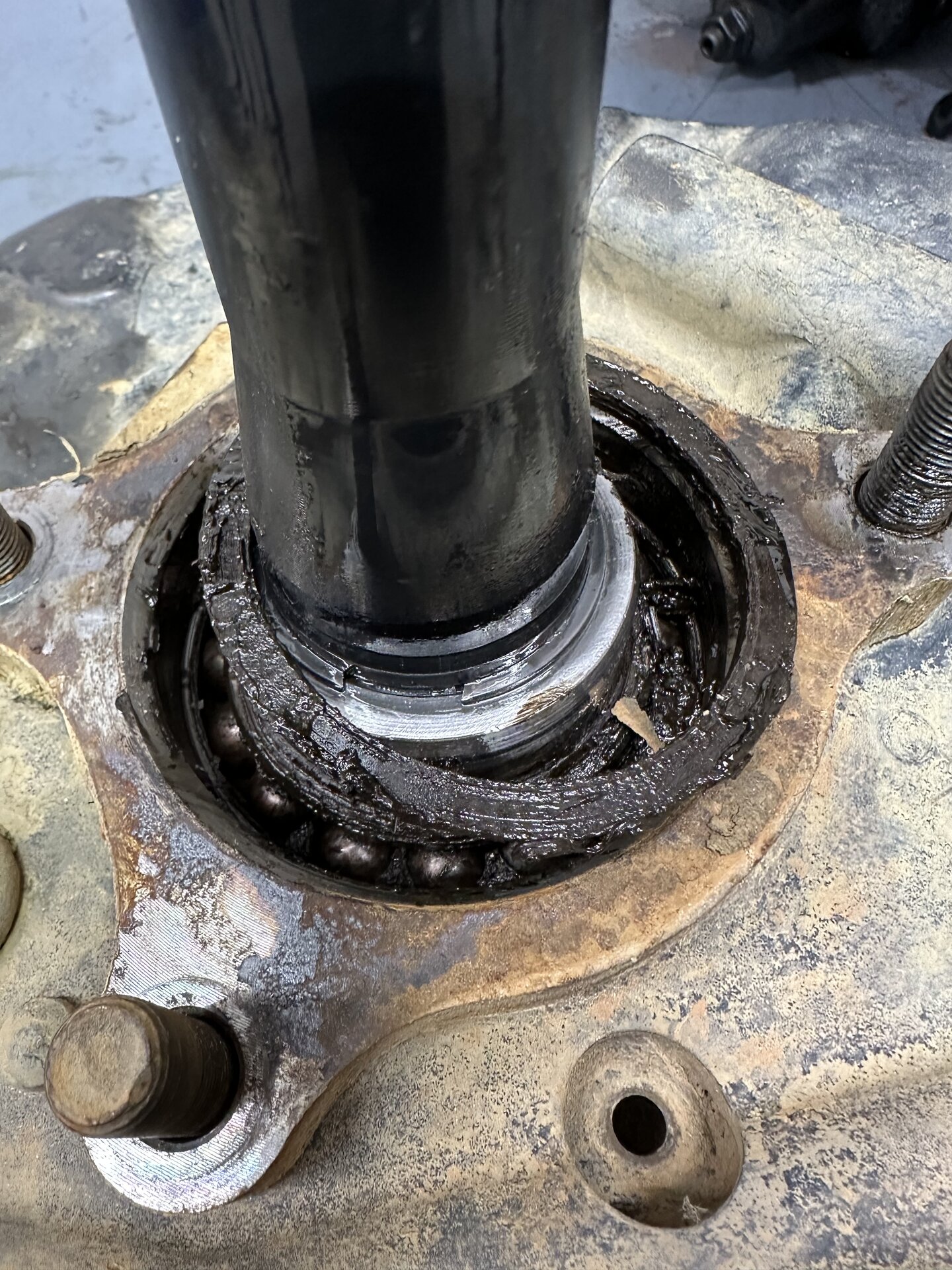

I just had a random rear wheel bearing failure. DOH. Was wobbling to where it gouged the rotor. Nothing too bad. Replaced and all good.
It's FINE!
