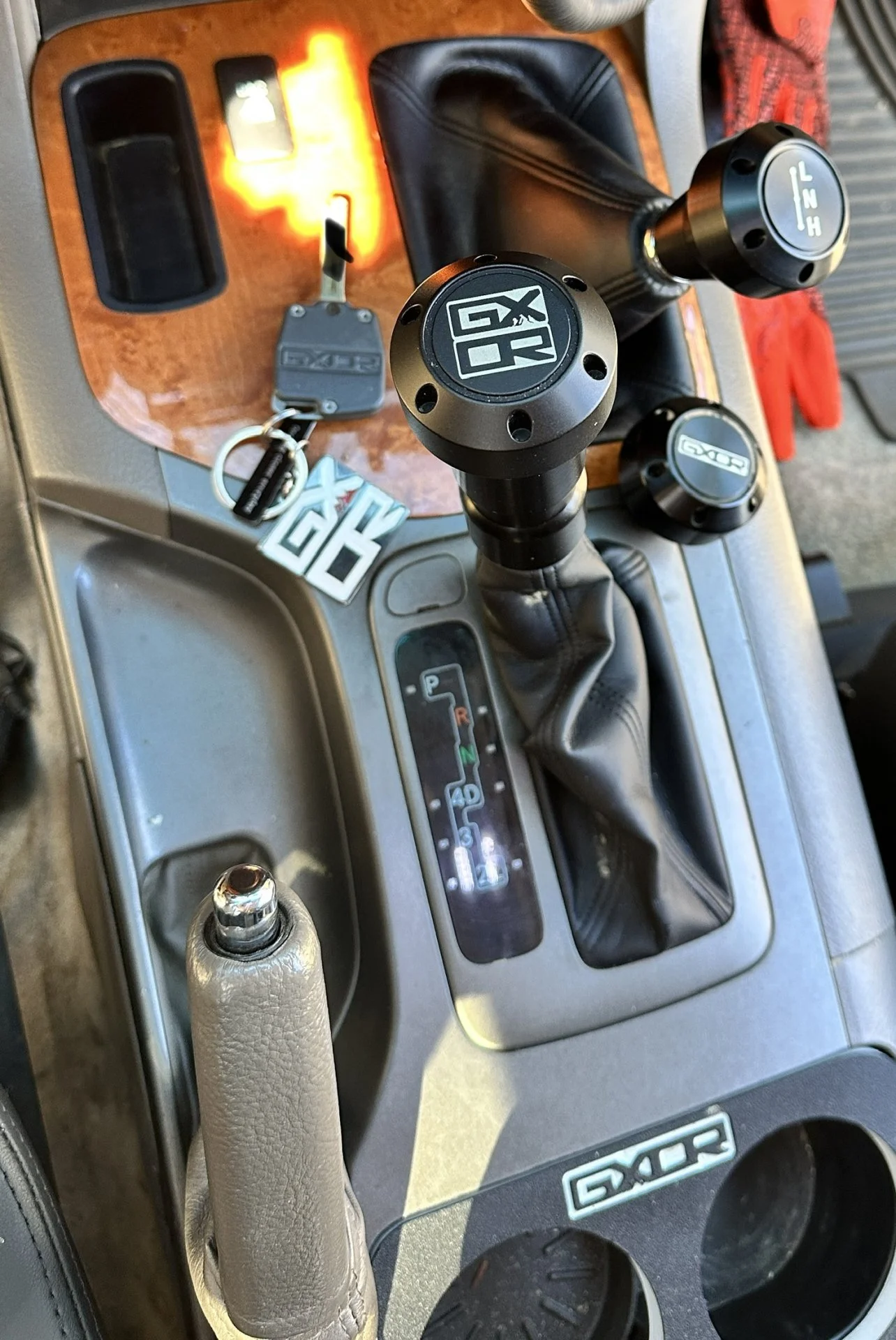

Added an aggressive amount of logo stuff to the truck from gxor.org haha
