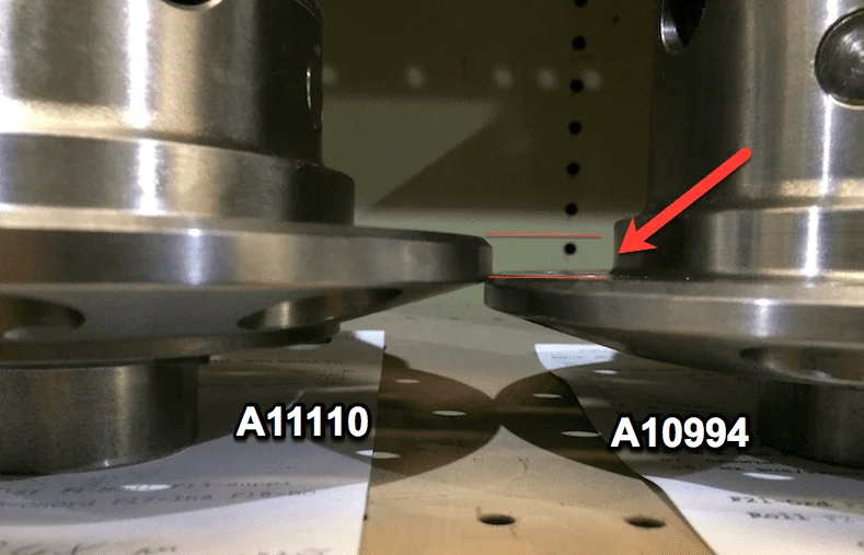

Thanks. Yep, the front has two p/n listed based upon ratio. It gets a little complicated when regearing with non-OEM spec gears may require use of the "other" p/n due to thickness of housing. Here is a comparison of the two models. With a lower gear, the ring gear gets thicker....

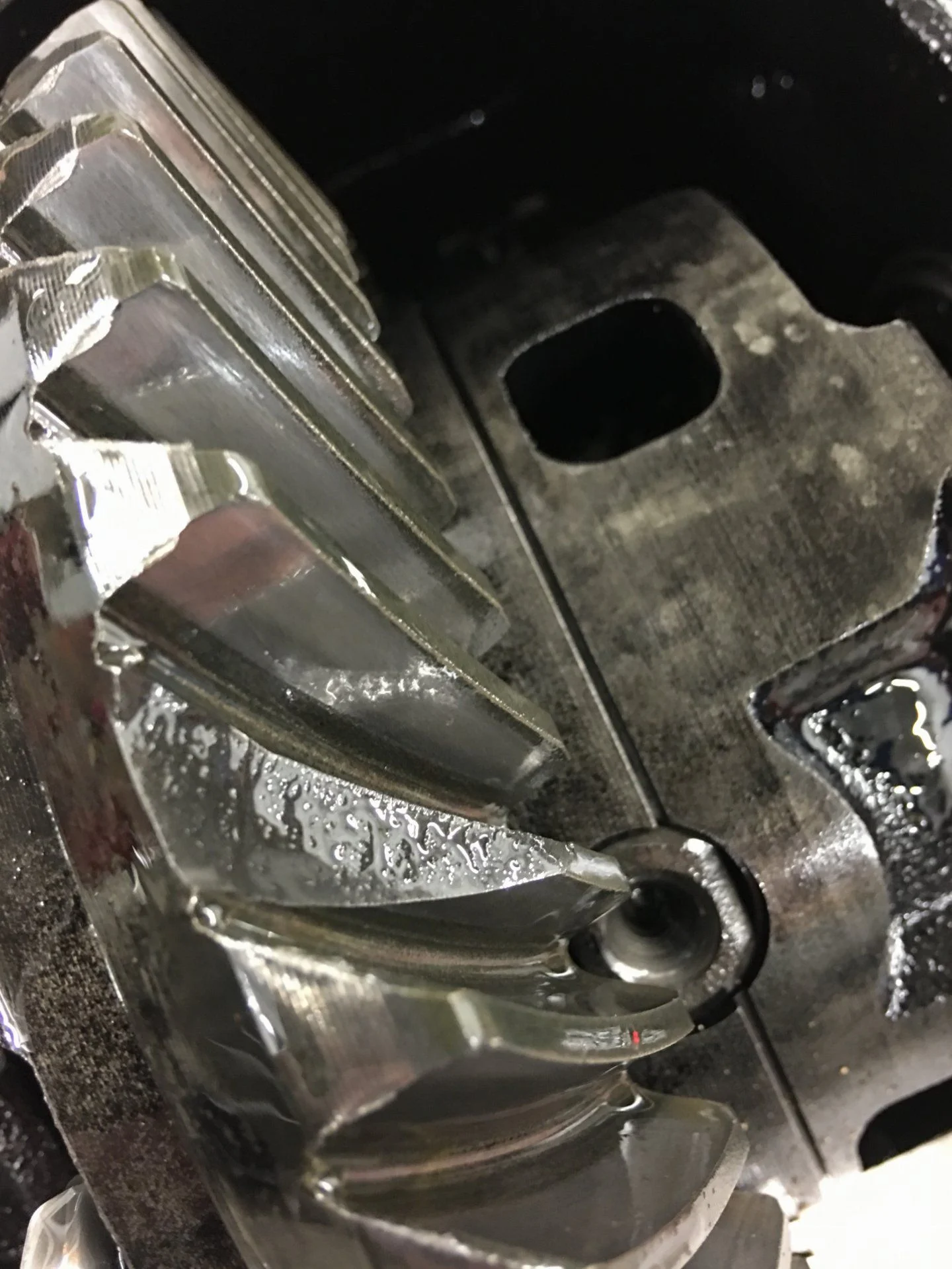

Stock (with some teeth missing, note the backing plate and overall thickness of the ring gear):

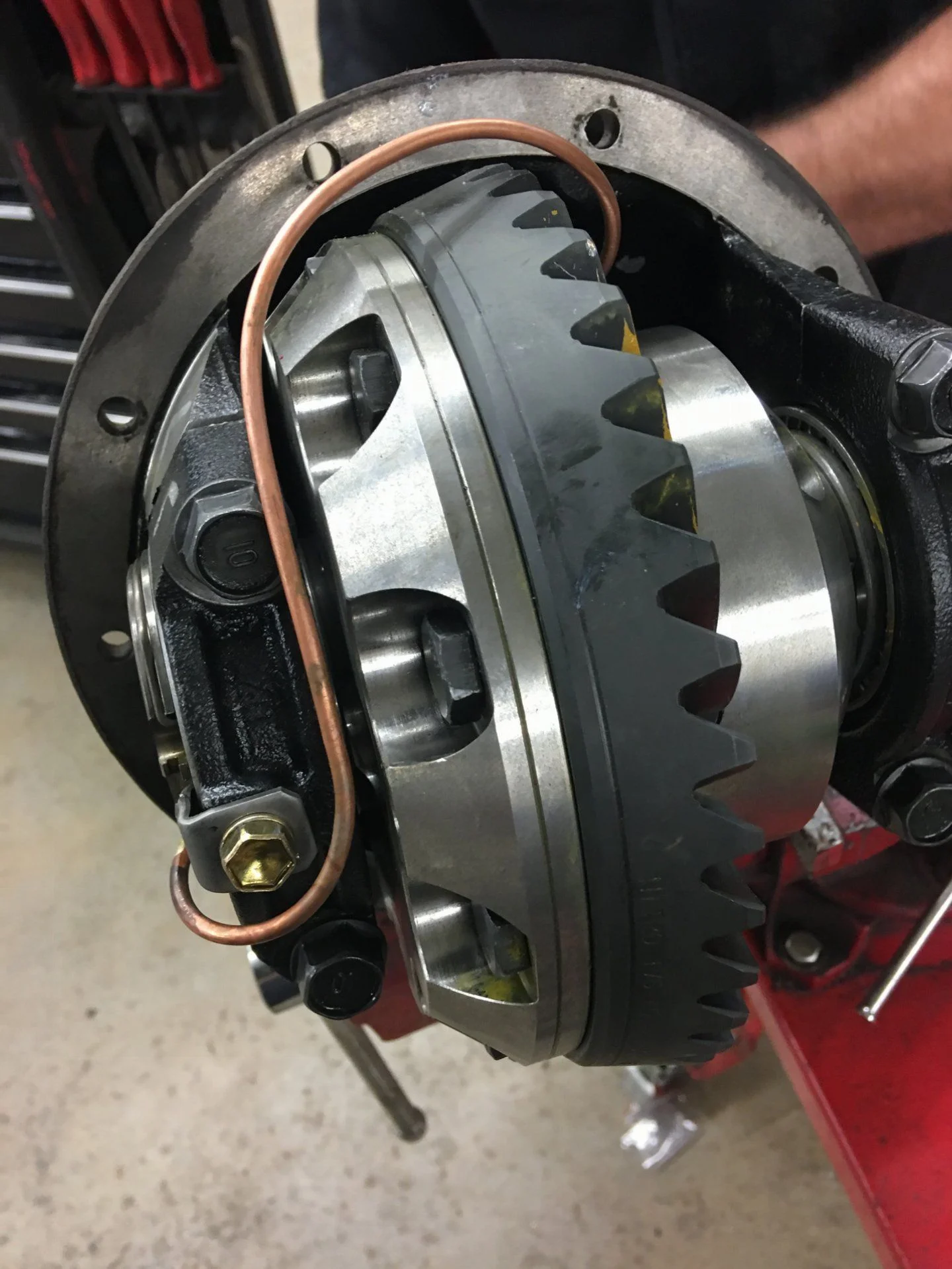

Nitro 4.56 gear replacement:
