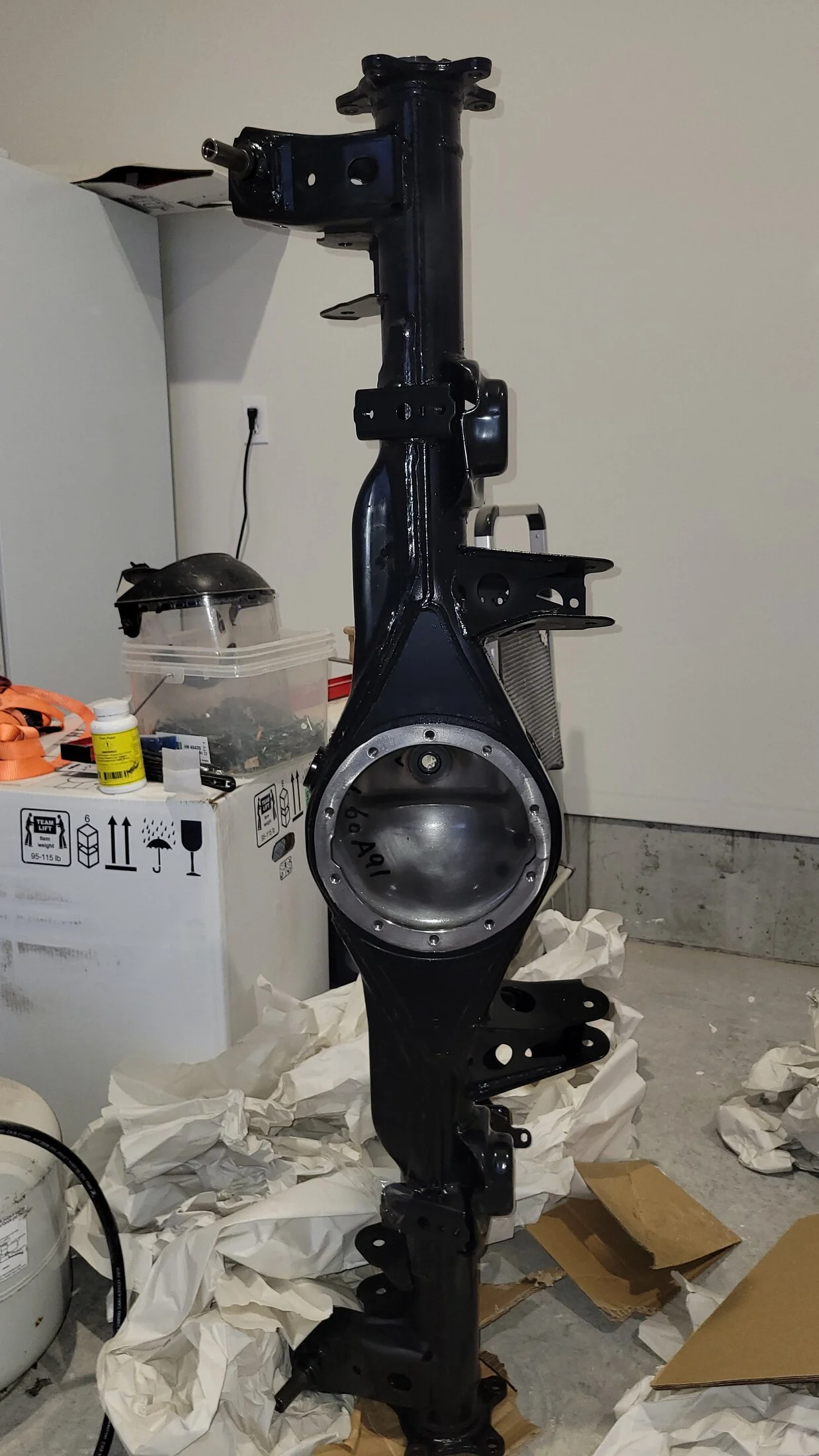

I have collected an 8.2 3rd member from a GX460 (rusty, but I can get it blasted it it was only $285) and have an OEM trussed 8.2 housing on order from Japan (Prado 150/non-US FJ Cruiser part number). I will update my build thread when the parts arrive and I confirm whatever nuance is needed to make this conversion work. I plan to re-use my axleshafts, brakes/brake lines, driveshaft, etc. The only complicated parts I foresee is 1) confirming that the GX470 rear sway bar mounts are in the same location and 2) figuring out how I can use my adjustable Ironman rear coil spring conversion mounts on the OEM coil rear axle or if I need to just get longer coils and ditch the conversion kit.

The housing did arrive however.
This housing looks great! Brand new candy!
Never mind…I just saw your other post with more pictures.
Can you take a close up of the area that’s different than the standard rear differential?
Basically the same price for this new housing and core 3rd member (sitting in a box right now, no pic) as I'd be in for a junkyard 8.2! They are too expensive used and are rusty in my area.

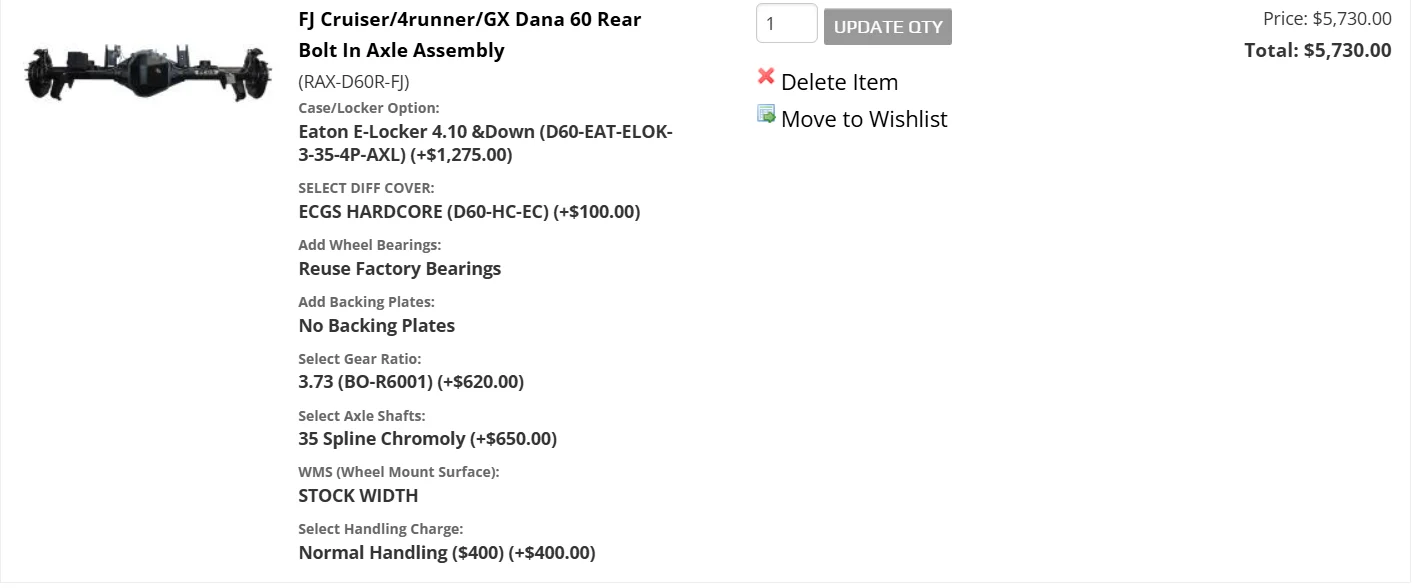

Found another one too, East Coast Gear can build a 60 to the door for about $6k:

ECGS also sells a bolt in Dana 60, which is a few K cheaper than the 9". Front Range off-road sells a bolt-in 9.5" housing as well.

The Dana 60 is certainly a good option as well and is a proven rear end with easy parts availability (even if non-Toyota). I think the pumpkin hangs down kind of low though, being it's a cast steel housing as opposed to a fabricated housing like the other options.
