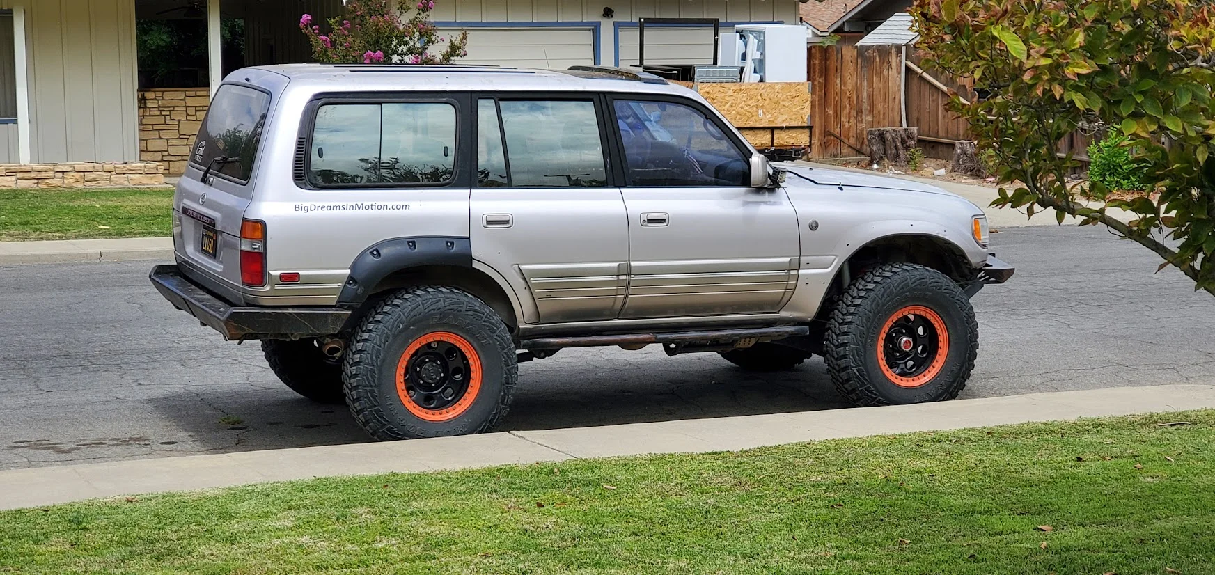

What’s the point in marking shocks when a 37” tire and uncut fenders is the limiting factor? Mine are set so the tires come with it a couple MM of rubbing in the worst case scenario and the shocks still have room to compress. Nice I dissect my fenders, the shocks might be my focus.
Because Im a suspension nerd and I like data!
There no point in explaining if you don’t already get it and my fenders are cut LOL
My fenders are not cut like most. The rig is still stock and all natural.

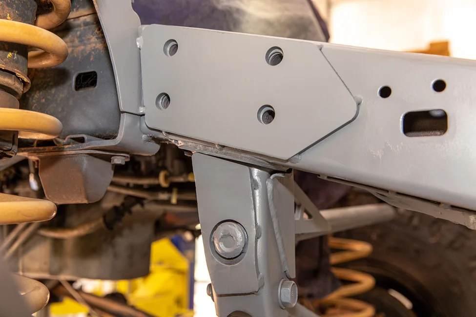

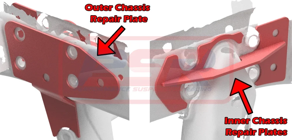

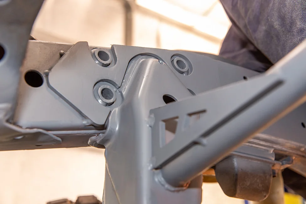

The Delta DIY steering support brackets came in today.
They are beefy thick, didnt measure, but must be 1/4" thick.

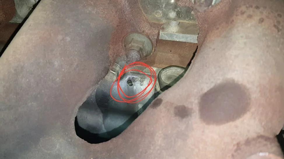

But now that I am looking at them they dont directly address my panhard crack.

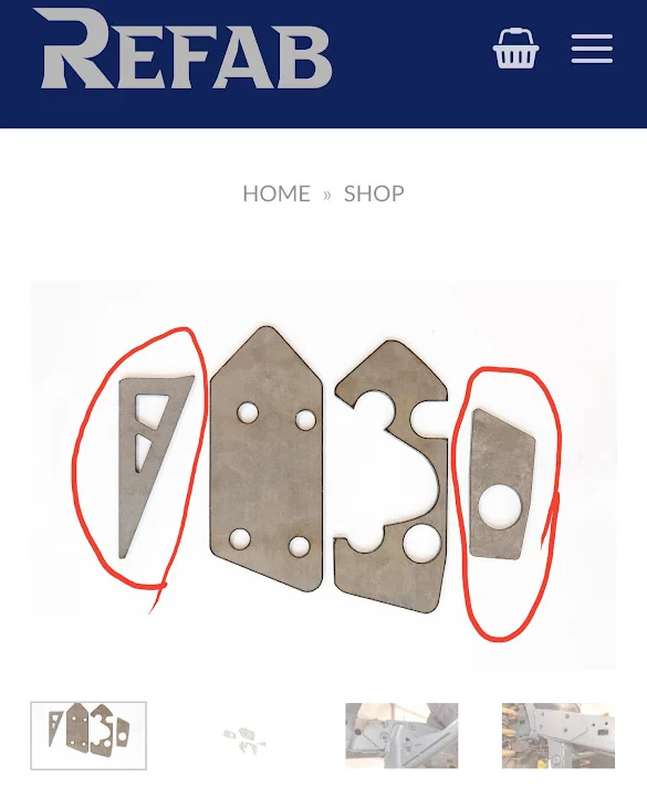

I will need to fab up some extra simple flat brackets like some of the Australian mfg. have in there kits.
Here are the Delta brackets:
Here are the extra brackets that I need to correct the panhard crack.
You have to flip the pics in your brain because the brackets are for RHD.
Prepping the weld area on the inside of the frame is going to be very tough with the engine in place.
I just don’t see how you would need those Delta plates.
If fact IMHO I don’t see any thing in your pictures that would address the issue your having.
The gusset will help if the weld is cracking where the tube meets the frame mount.
But I don’t think that’s your issue
The plate that that welds to the mount in my eyes doesn’t do much either as all it does is make the mount thicker.
IMO what’s needed it some gussets in front and back of the mount running with the frame to increase the mounting area.
Or if the plate that welds to the mount, third picture post 927 had wing ( gussets Build into it ) that welded to the frame that would also increase the mounting area.

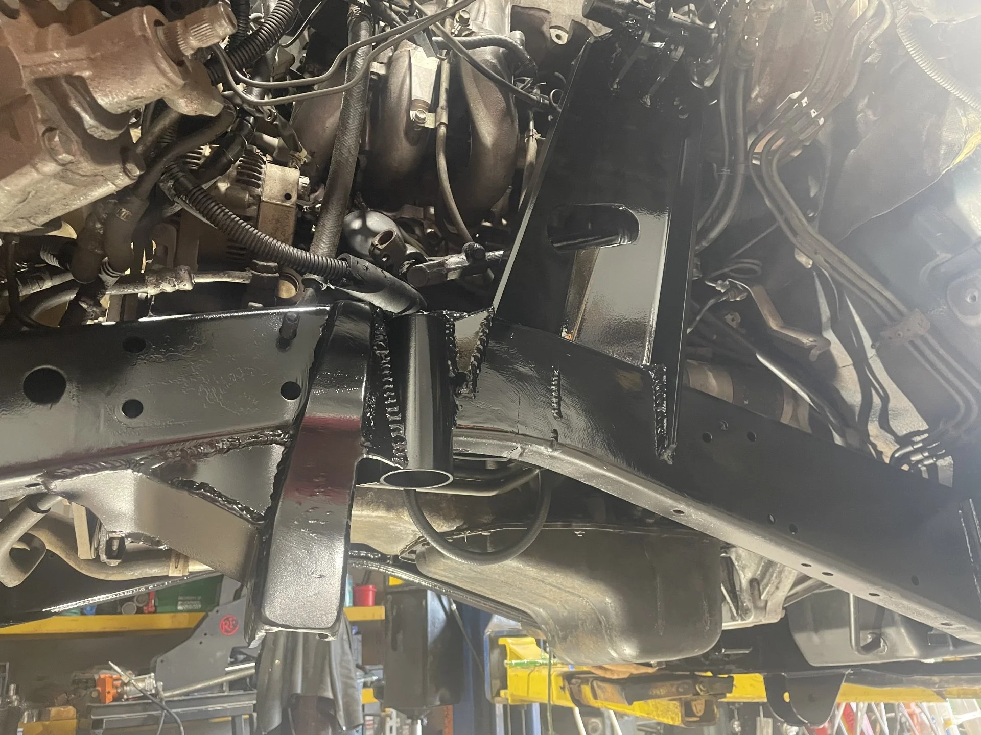

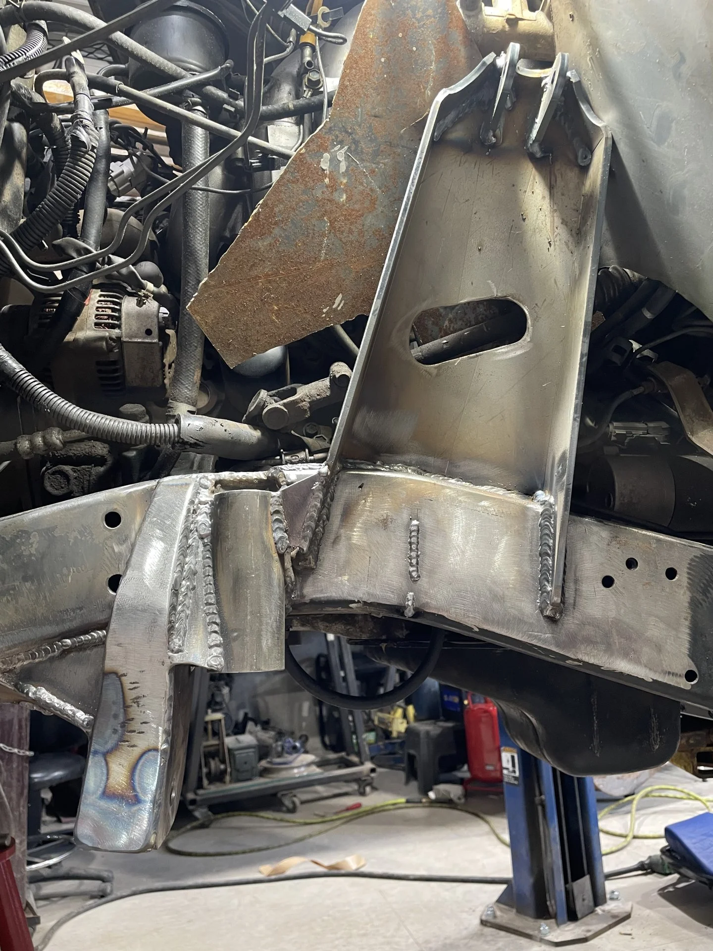

After seeeing the damage I did to my panhard bar mount and how weak the factory design is for trucks that get wheeled… I’d just cut it off and start over… plate both sides of the frame and build one out of 3/16” or 1/4” material..
Here is some pics of mine after it was redone for the 3 link. Modified 4wheelunderground mount that didn’t work for my setup. I still kinda regret not plating my frame on both sides.

I will be driving as easy as possible on this cracked frame bracket until I have time to address the repair.
I have been watching this crack develop since 2020, so another month won't be a big deal.

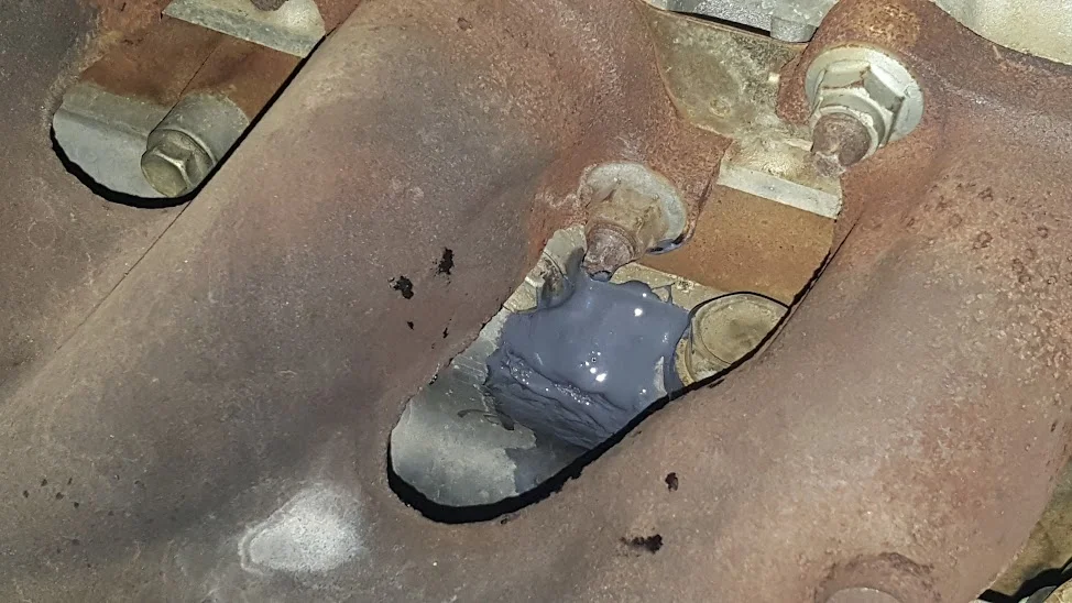

One day I noticed very small water seeping on passenger side of the block, the next day it almost over heated because the amount of lost coolant.
I found some internal corrosion at the top of my oil cooler, had to high temp JB weld it for the time being. I did get a oil cover from Slow95, but the real fear is the rusted exhaust manifold bolts :banana: :banana: :banana: :banana: job. Here is a few pics.

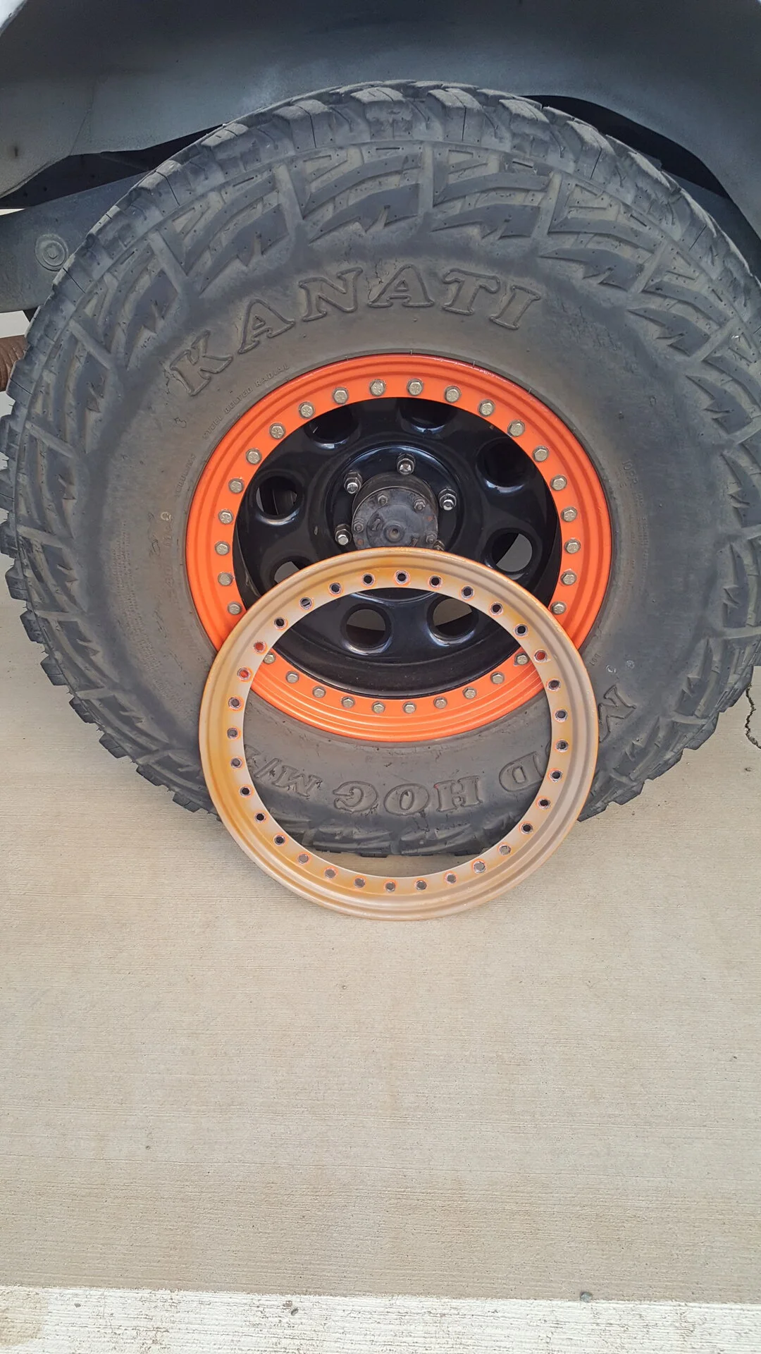

I have slowly one ring at a time been repainting my bead rings. (2 completed)
The last paint job only lasted one summer.

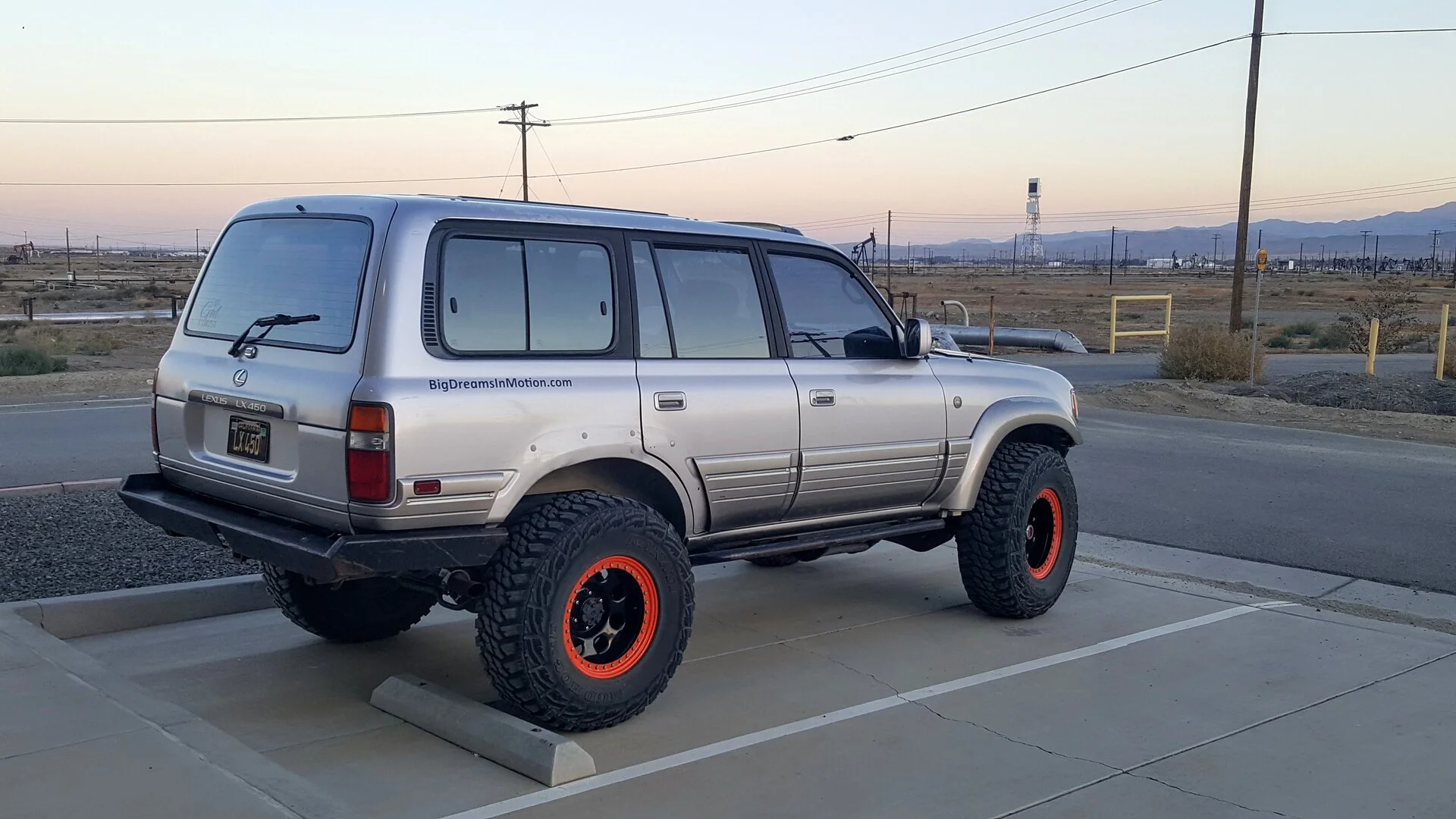

Washed it to take a few posser shots. Haven't done much to the Adventure Rig lately, it's been on daily duty. :steer:
I did manage to repaint the faded bead rings, it took two months to complete all four though. I also relocated the power steering cooler.
I remounted the steering cooler to the normal spot most people put where the stock paperclip is mounted then rotated the winch control box back 90* degrees to get more air to the radiator.
