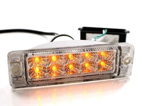

Looking at the pictures it appears that in addition to the light housing there is another module wired off the side. Is that present on the lights you purchased and what is its function?
There is a rectangular module hanging off by two electrical wires. Looks functional. The wires are long enough to use tie wraps to secure it out off the way.
I did modified the mounting some what. I removed the plastic nutserts that ARB uses. I got size 6 stainless steel machine screws long enough to go thru the light and thru the ARB metal tab.
I used a stainless steel washer and a nut with plastic inside (forget what they called) to secure the whole thing.
