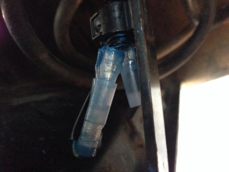

LED light installed. I cut both connector ends and installed tin coated copper from West Marine Sent from my iPhone using IH8MUD

Did you reuse the ARB housing or are those LED lights all new, housing and all?
