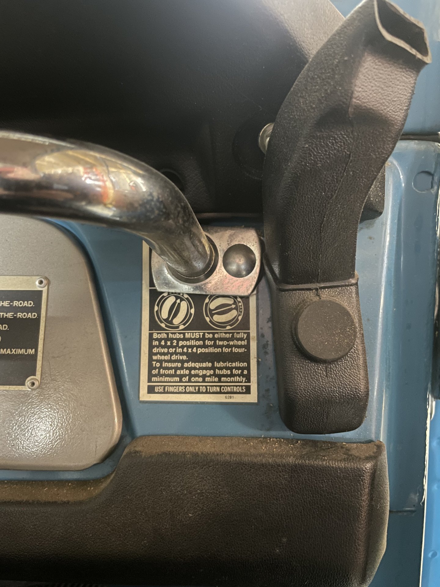

Couple pics I had already on the phone-
PO/port/dealer installed 🤷‍♂️
Seems pretty stout to me.
Rather than mount the SOR handle centered on the glovebox, don’t forget to allow enough clearance to undo the right side windshield knob.

Guess who can't back his out all the way. 😆
I'm debating about removing it and patching the holes when paint happens. Or, moving it as you recommend.
