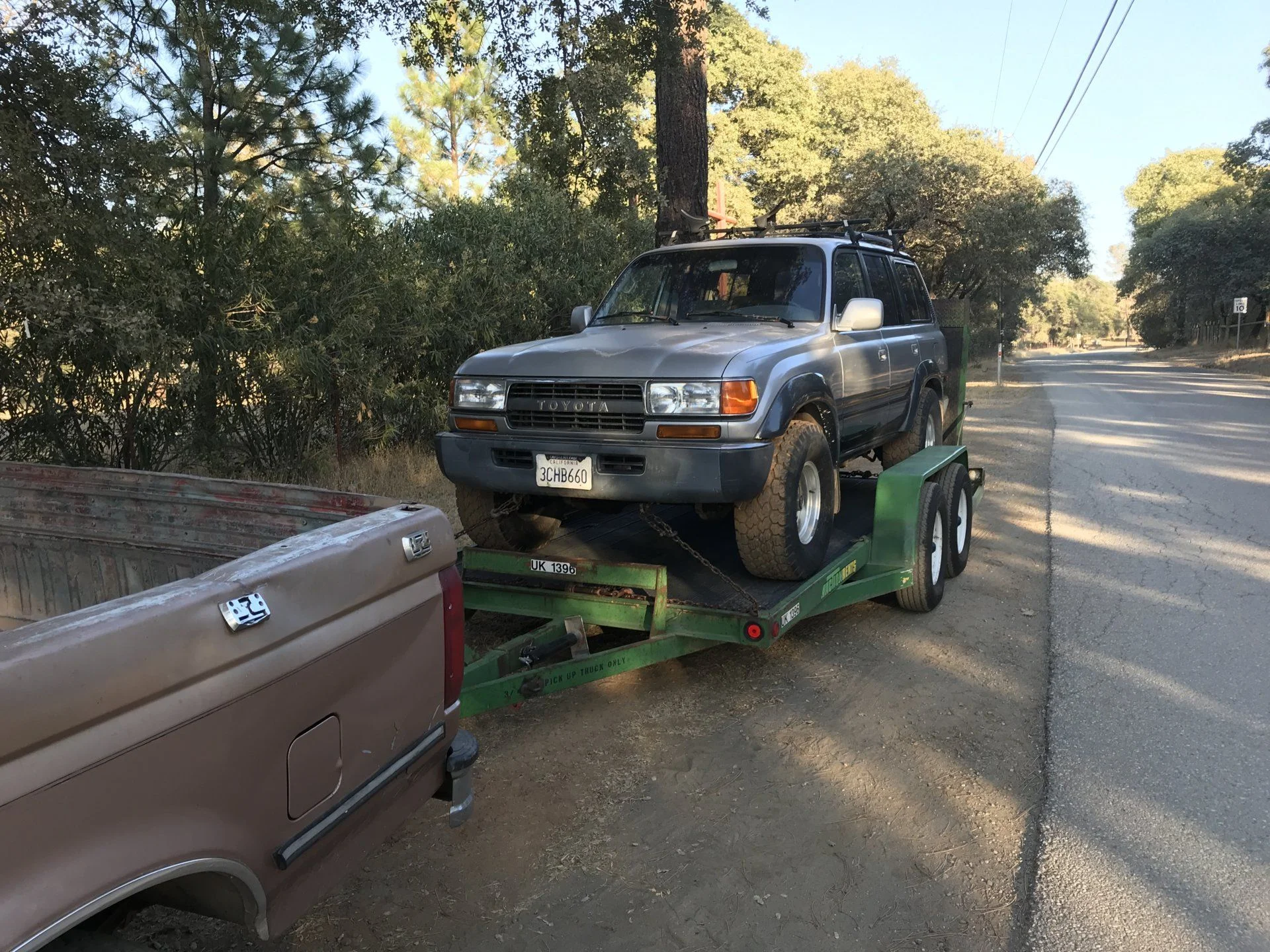

Sooo... my 40th is coming up and I want to do a big trip but the pig is in pieces. I am not sure how I talked my wife into it but I figured I should buy another rig! Newer, but since I have a small budget I was shopping for something that needed work. I was open to 4runners, Tacoma, fj80, fj60, 100, or a Lexus gx470. I scoured the internet for something I could afford but wasn’t too rough. My wife had great advice and said I should be patient and get what I want. After 3 months of looking I found the perfect rig. 1991 fj80 with 138k miles, clean body and interior but “needs a head gasket” called the guy and set up a time to go look. It was a 4 hour drive and I get there and it was not quite as clean as the pics but still pretty good. Paid the man $2500 and towed it home.

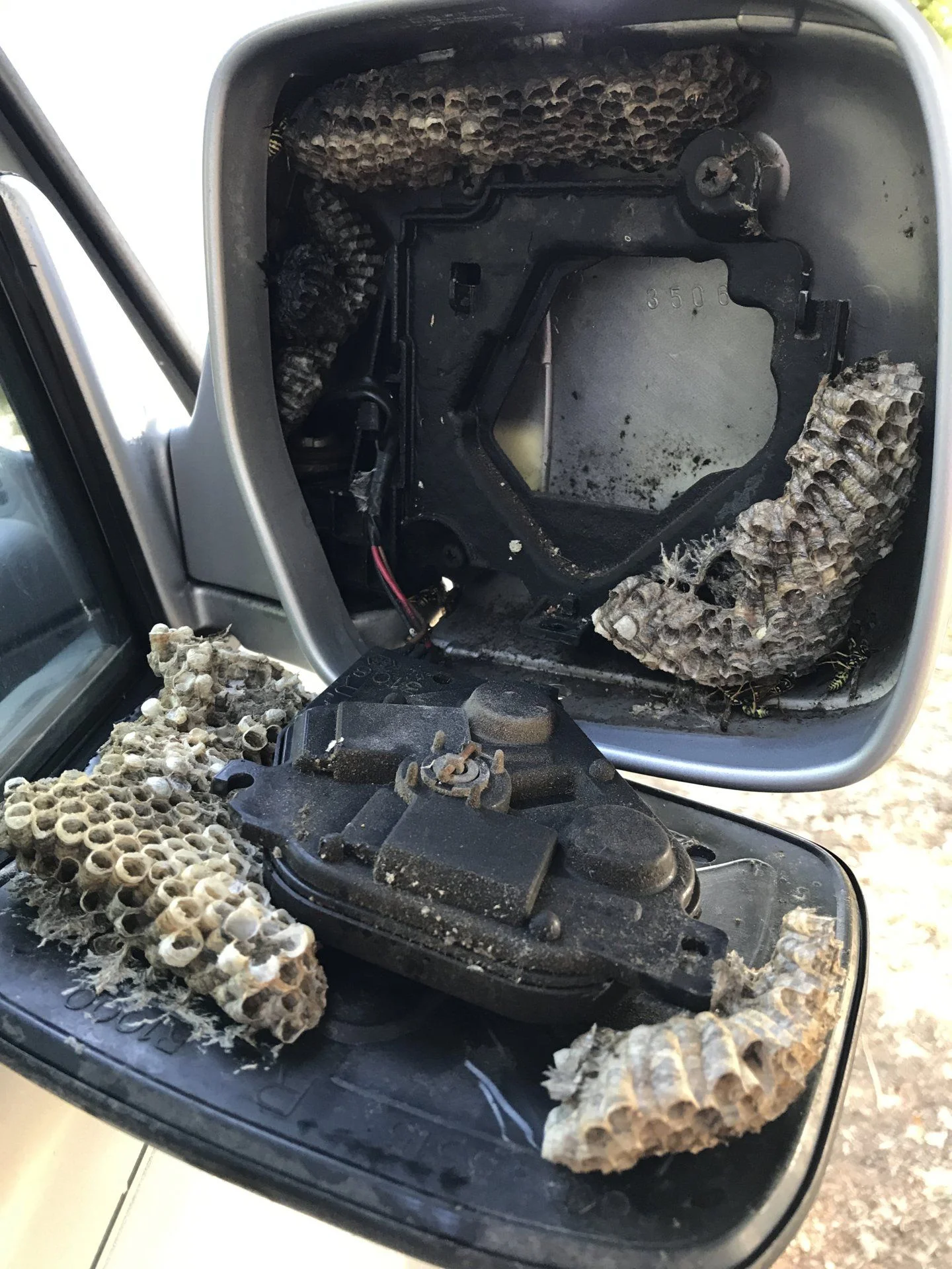

One of the gifts of the previous owner is that the entire rig is filled with wasps! My son got in to go for a ride, closed the door, and all hell broke loose. Luckily the windows were up and they were outside. Had to take the mirror apart to clean it out.

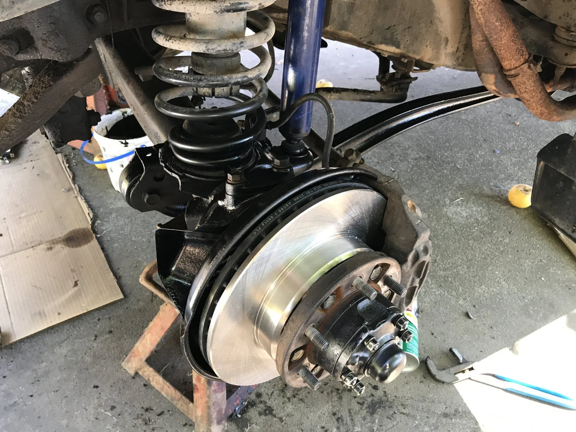

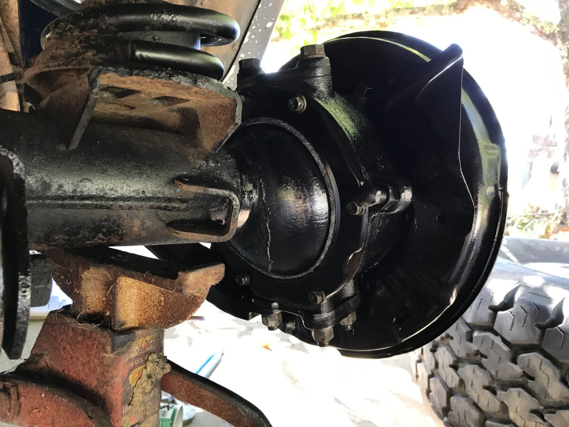

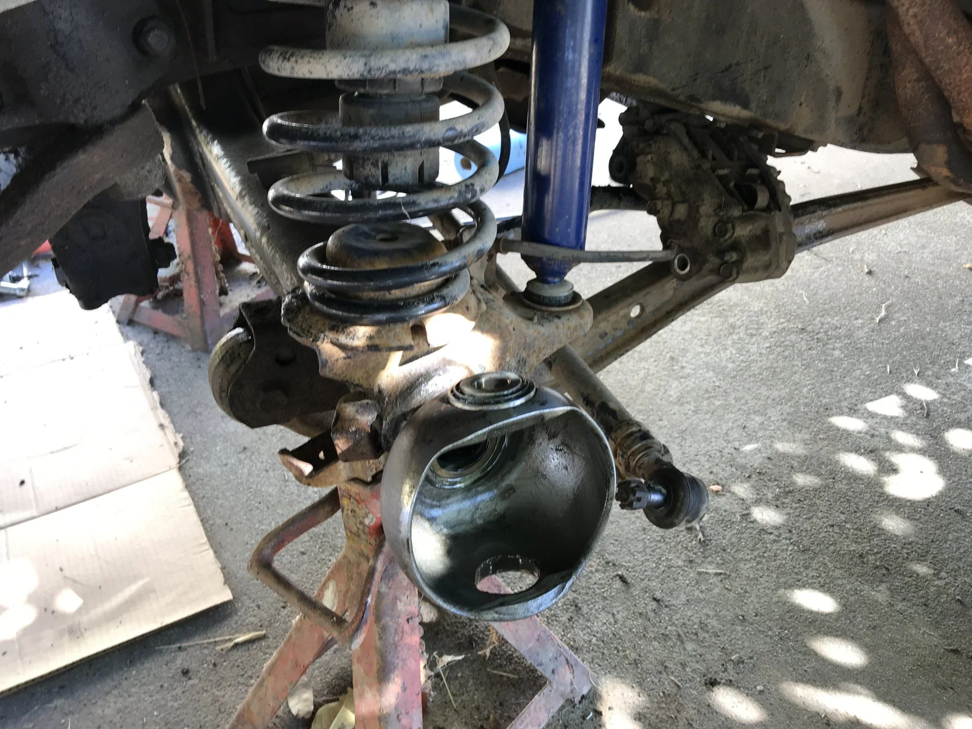

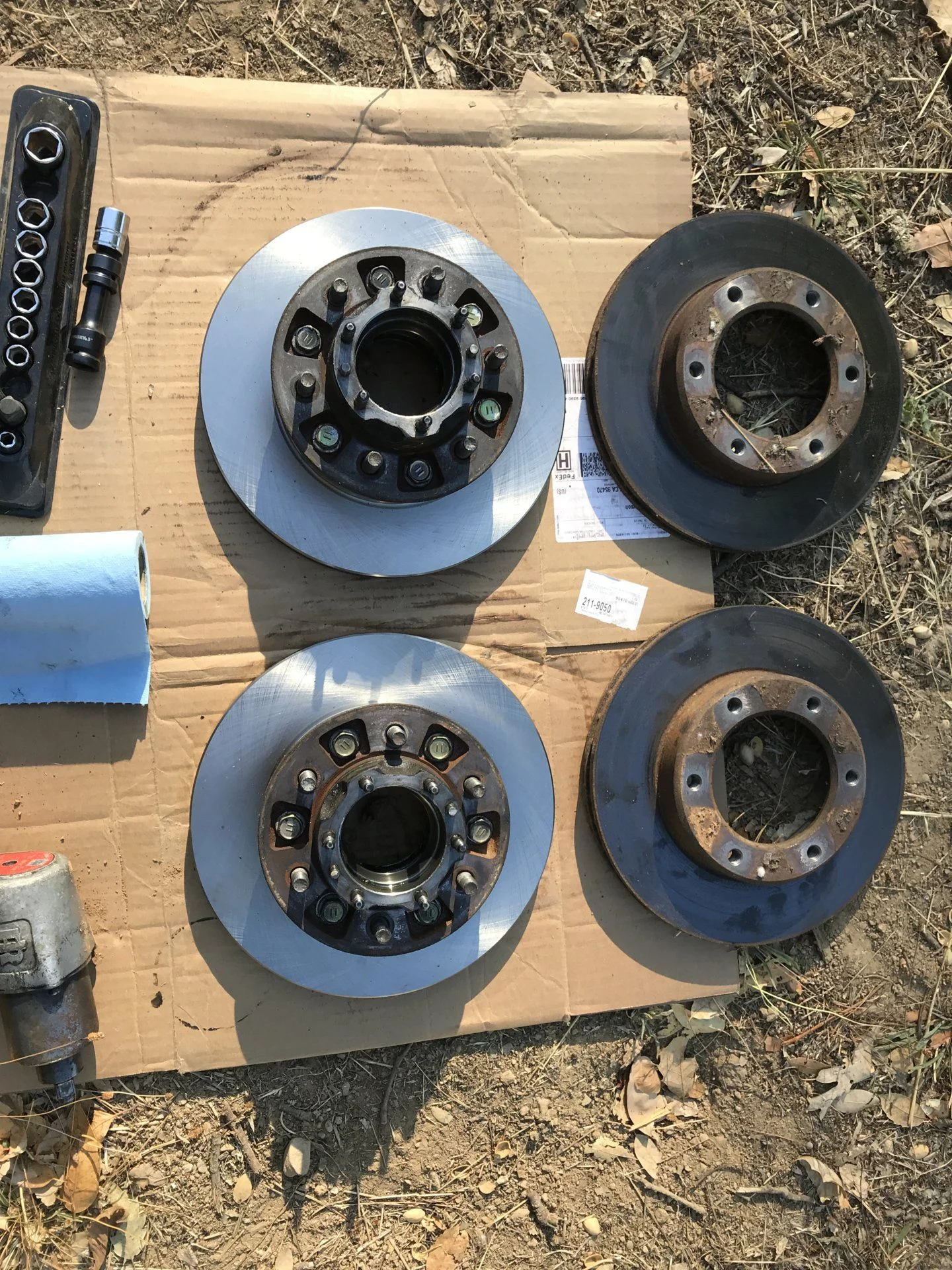

Put it off for a bit but finally started the Front axle rebuild. Bought a front axle rebuild kit from Marlin Crawlers. Its a messy job but now I have new brakes, wheel bearings, trunnion bearings, seals and fluid in the front axel.

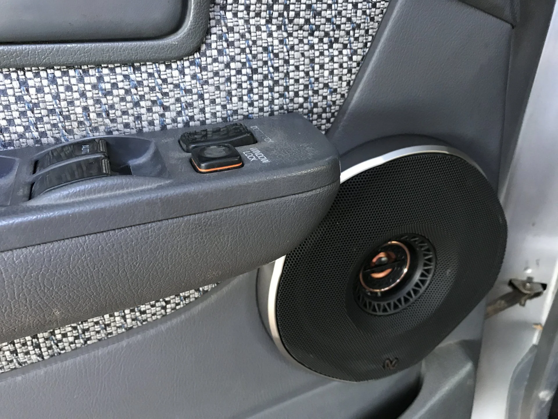

The front door speakers were shot and the display on the original head unit was non functional so I needed to update. Had an old Sony deck laying around and bought some low profile Infinity Reference 6-1/2” speakers. They were the only thing I could find size wise that would fit in the doors. Only $45

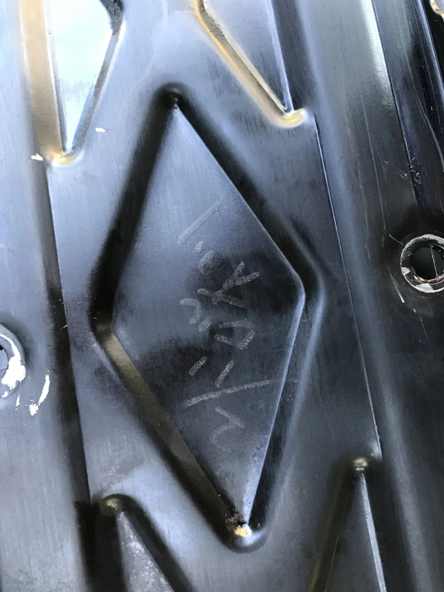

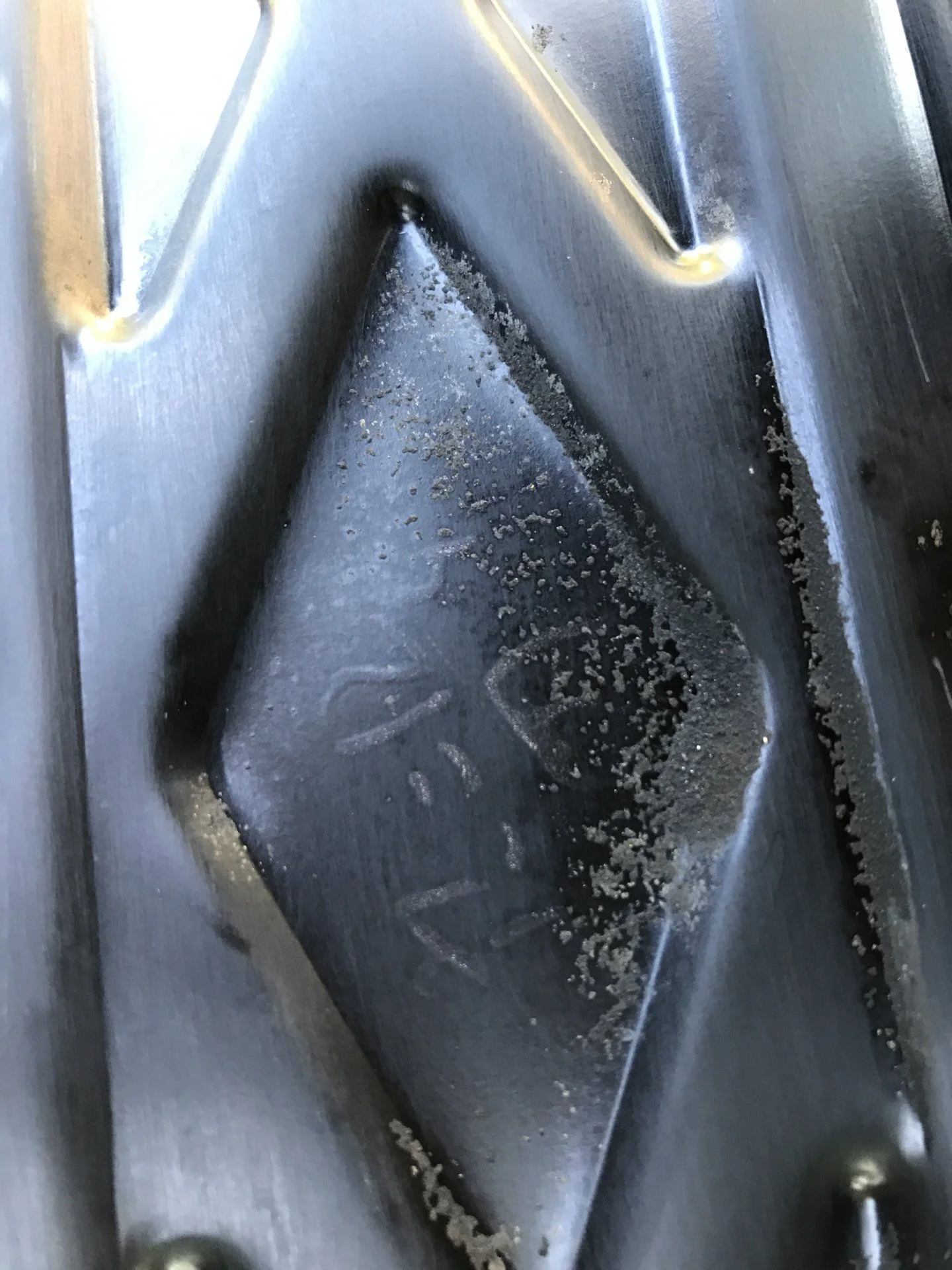

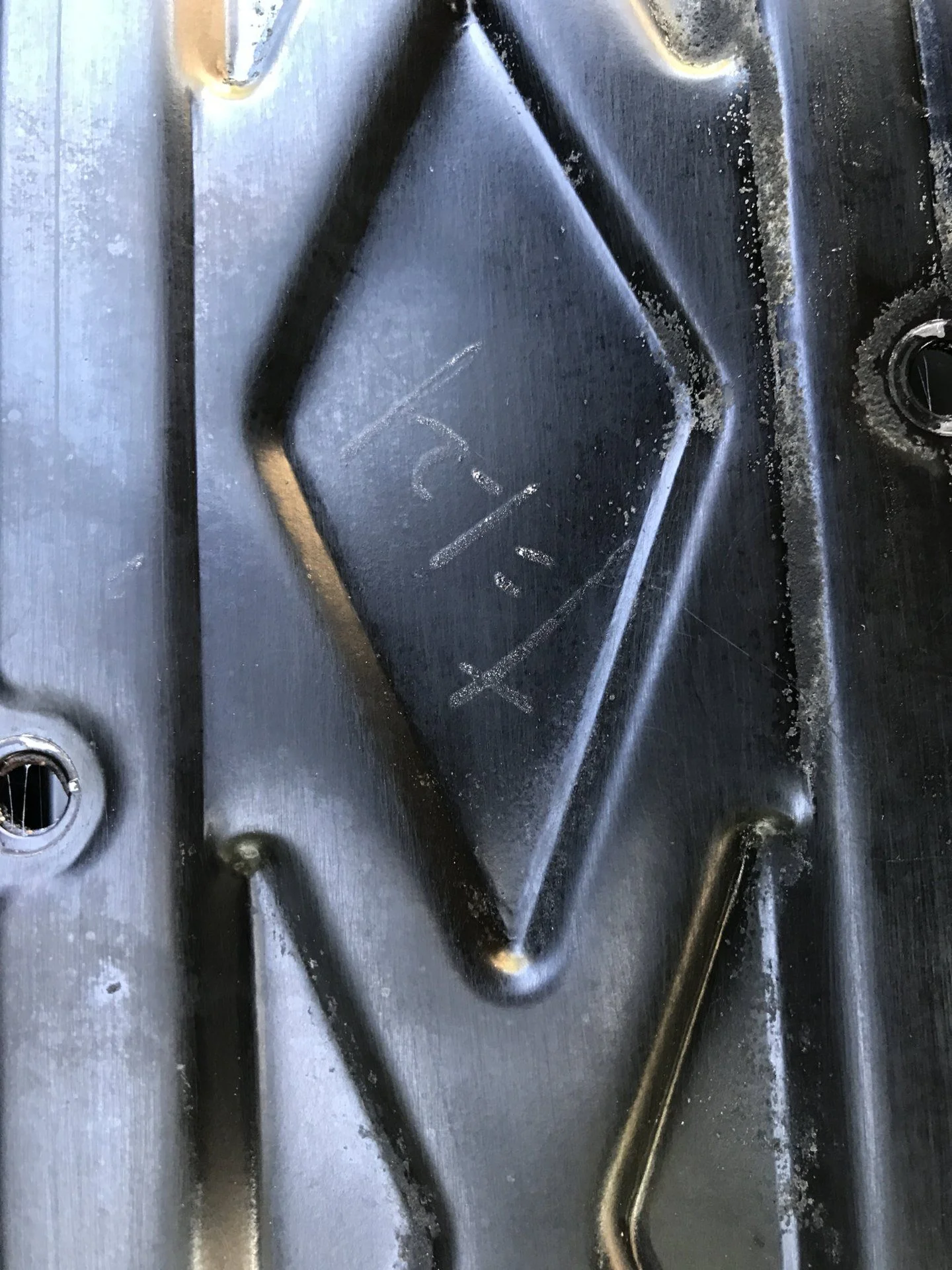

Next is resealing the engine. I replaced the valve cover gasket, lifter cover gasket, timing cover gasket, and front seal. After cleaning the lifter cover some factory markings became visible. Not sure why but it made me smile. Anyone know what these mean?

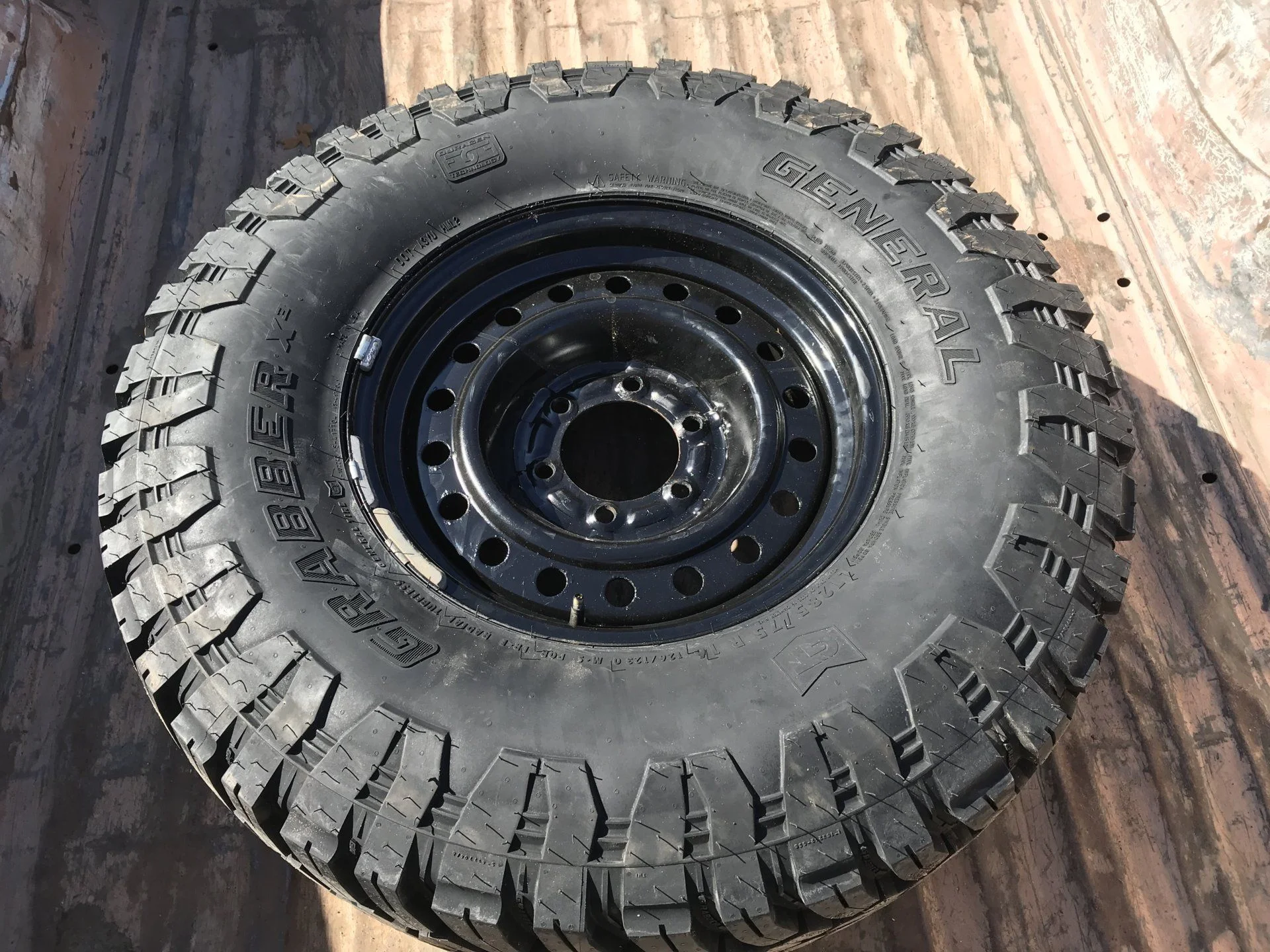

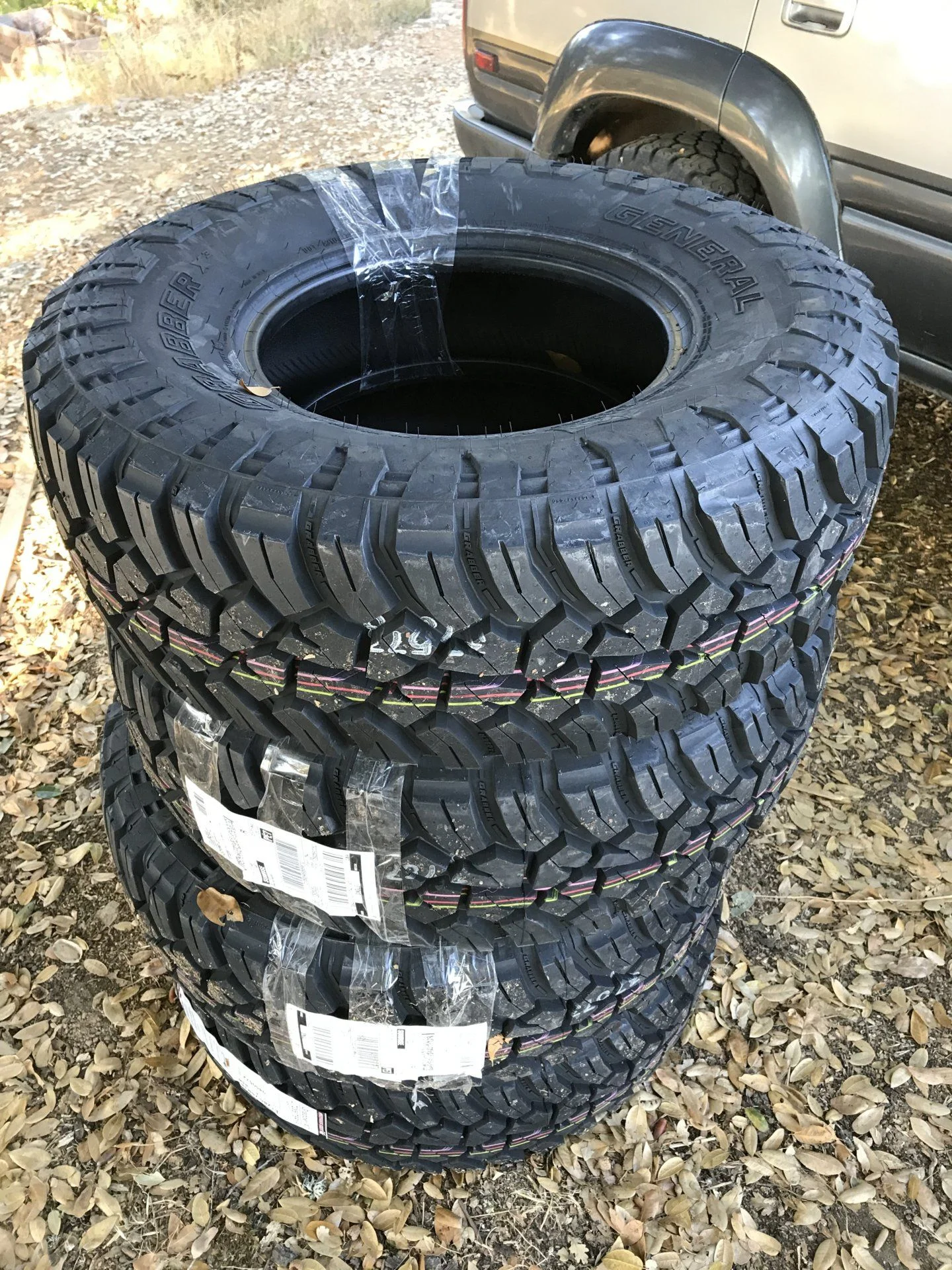

Major day! I bought tires:
General Grabber x3 285/75R16

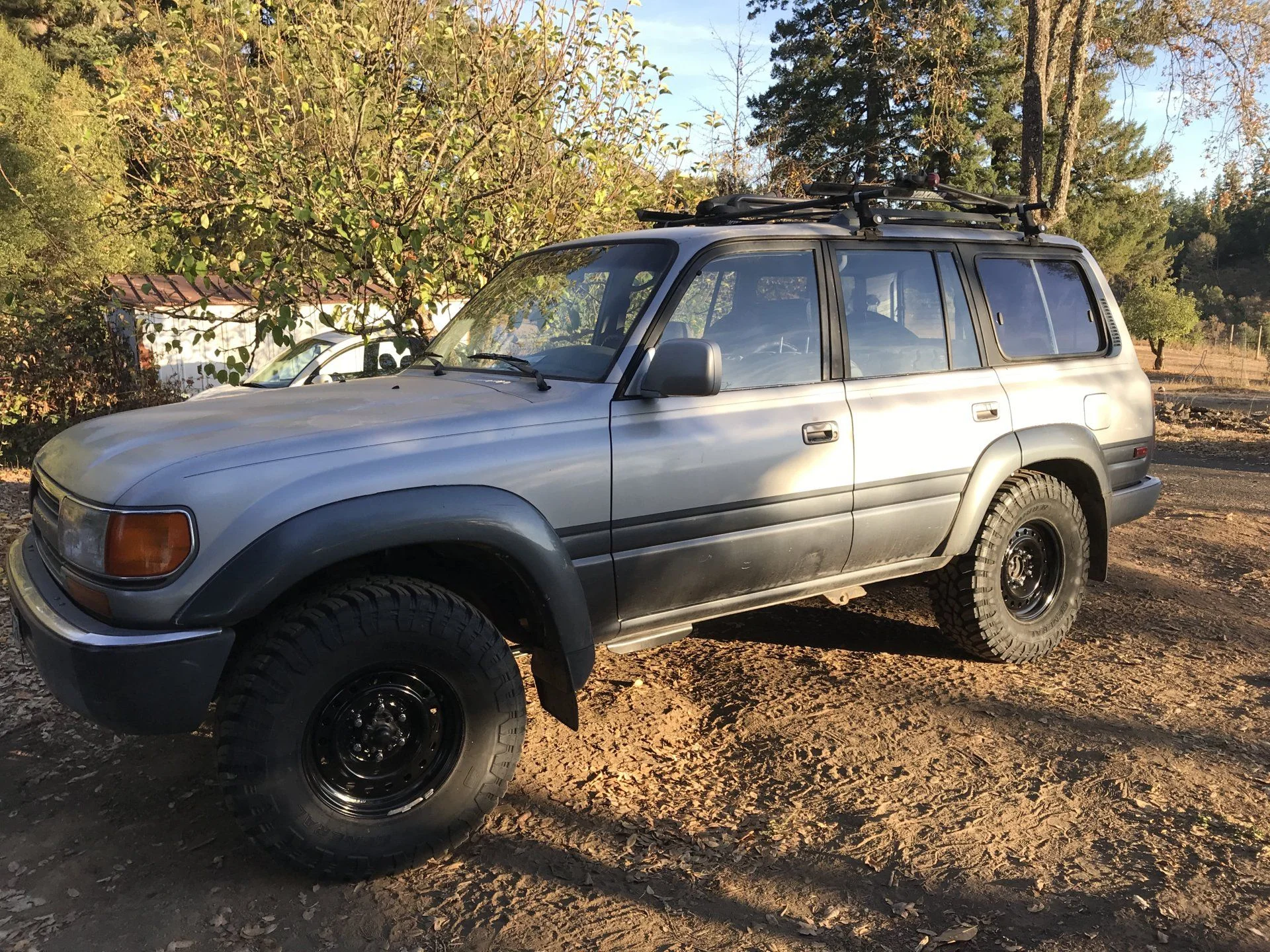

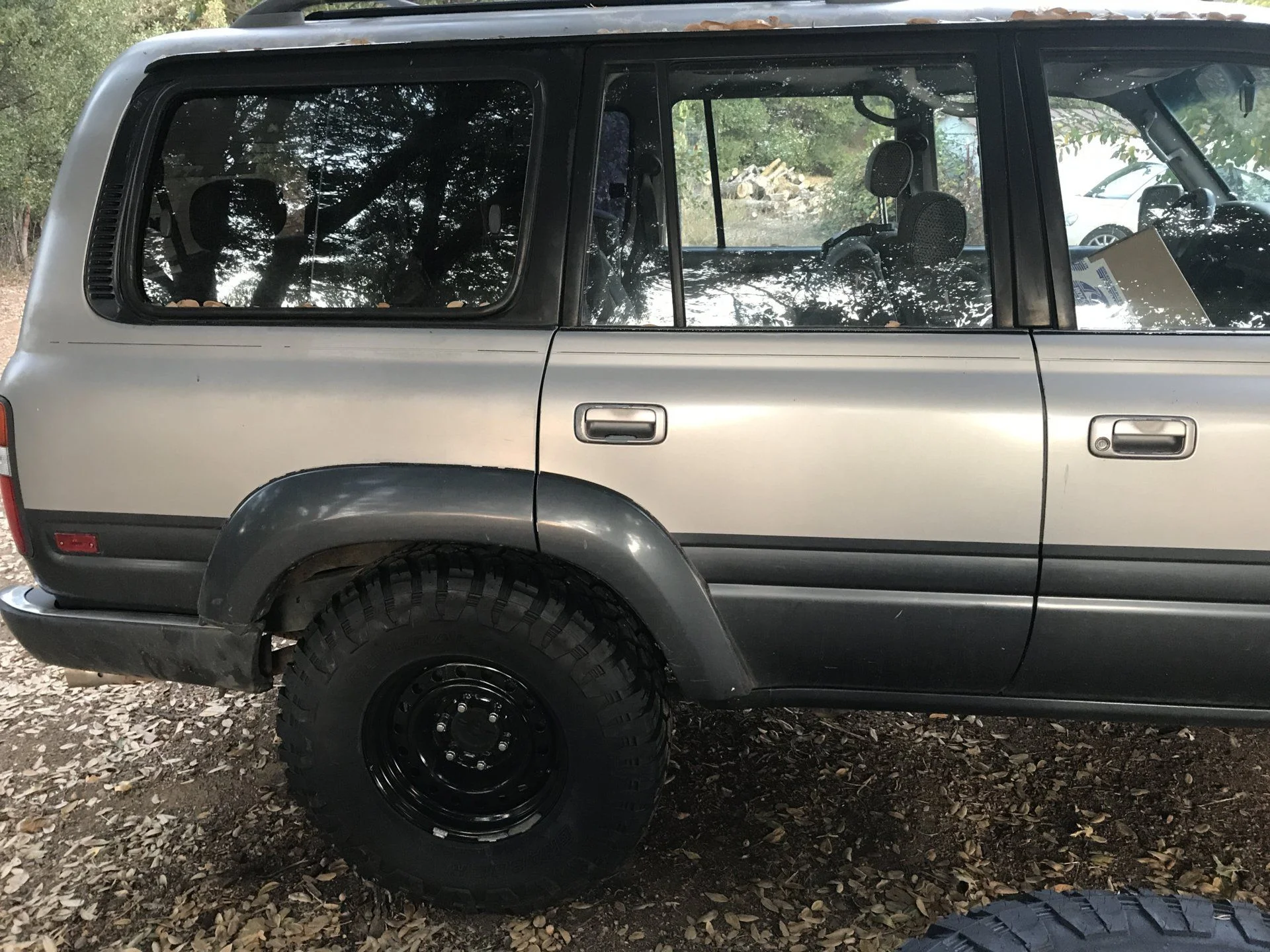

What came on the truck were 33x12.5x15. I debated about keeping the 15in rims but all the tires that size had a lower load rating (C). As 80's are heavy to begin with, and this thing is going to be loaded with people and gear, I decided to move up to 16in rims. I really like the look of the Toyota steel spares. After doing some digging the 1996-2002 tacoma and 4runner had 16x7steel rims for spares. I found one rim at the local auto wrecker for $35 and painted it up to see if I like it
Turns out I like it. Got rid of the 1990's blades and balloon tire look and gained the more industrial look of the black steel rim. the rim and tires are narrower and the offset of the steel wheels places them more in the stock location. This means less mud on the side of the truck and you know ih8mud!
Now I just need 3 more rims...

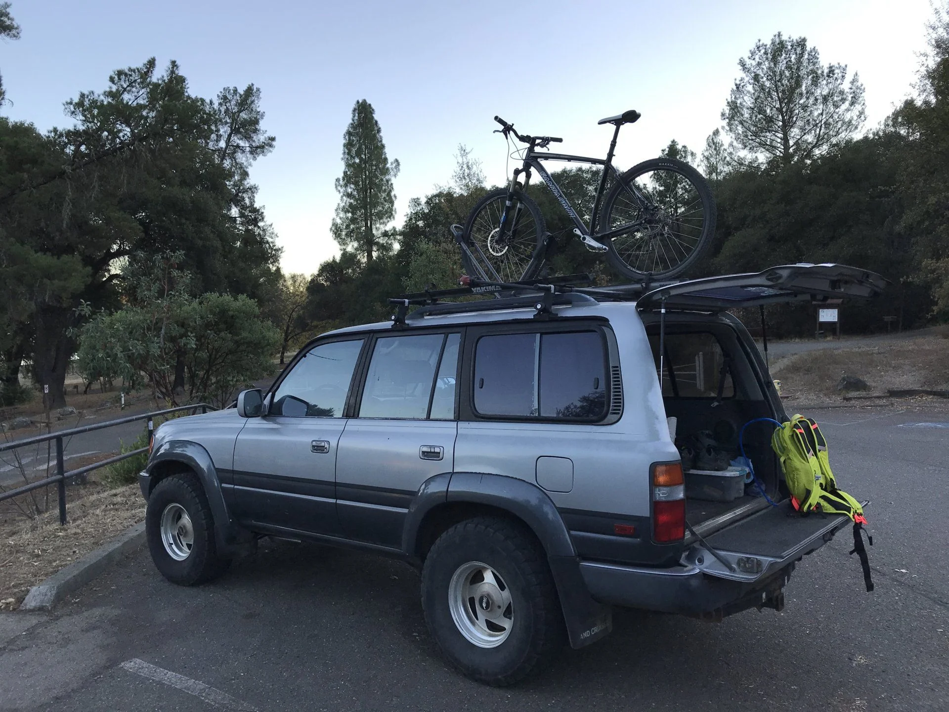

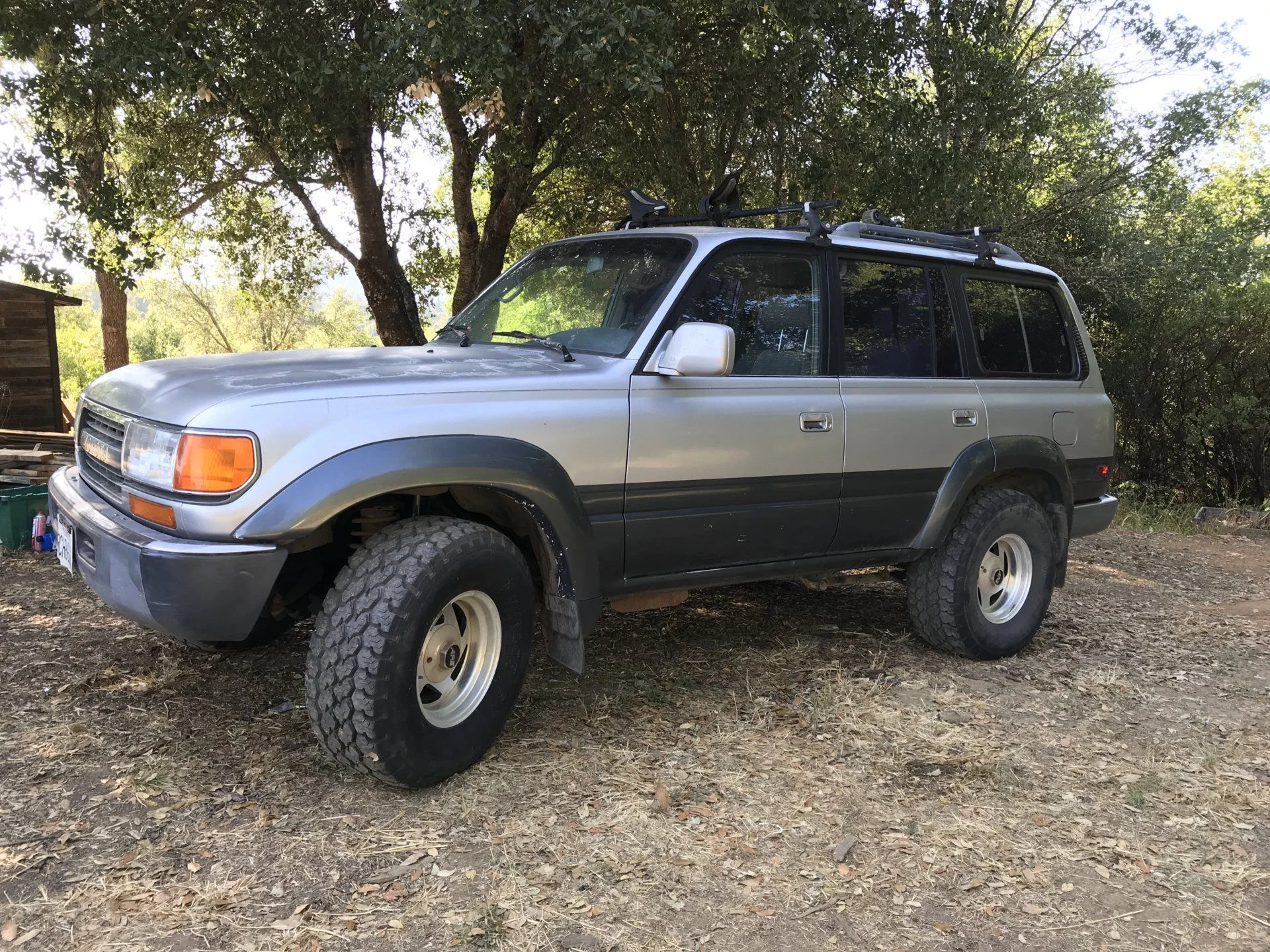

On the bright side, I get to drive it again! Got the racks on it and went for s ride.

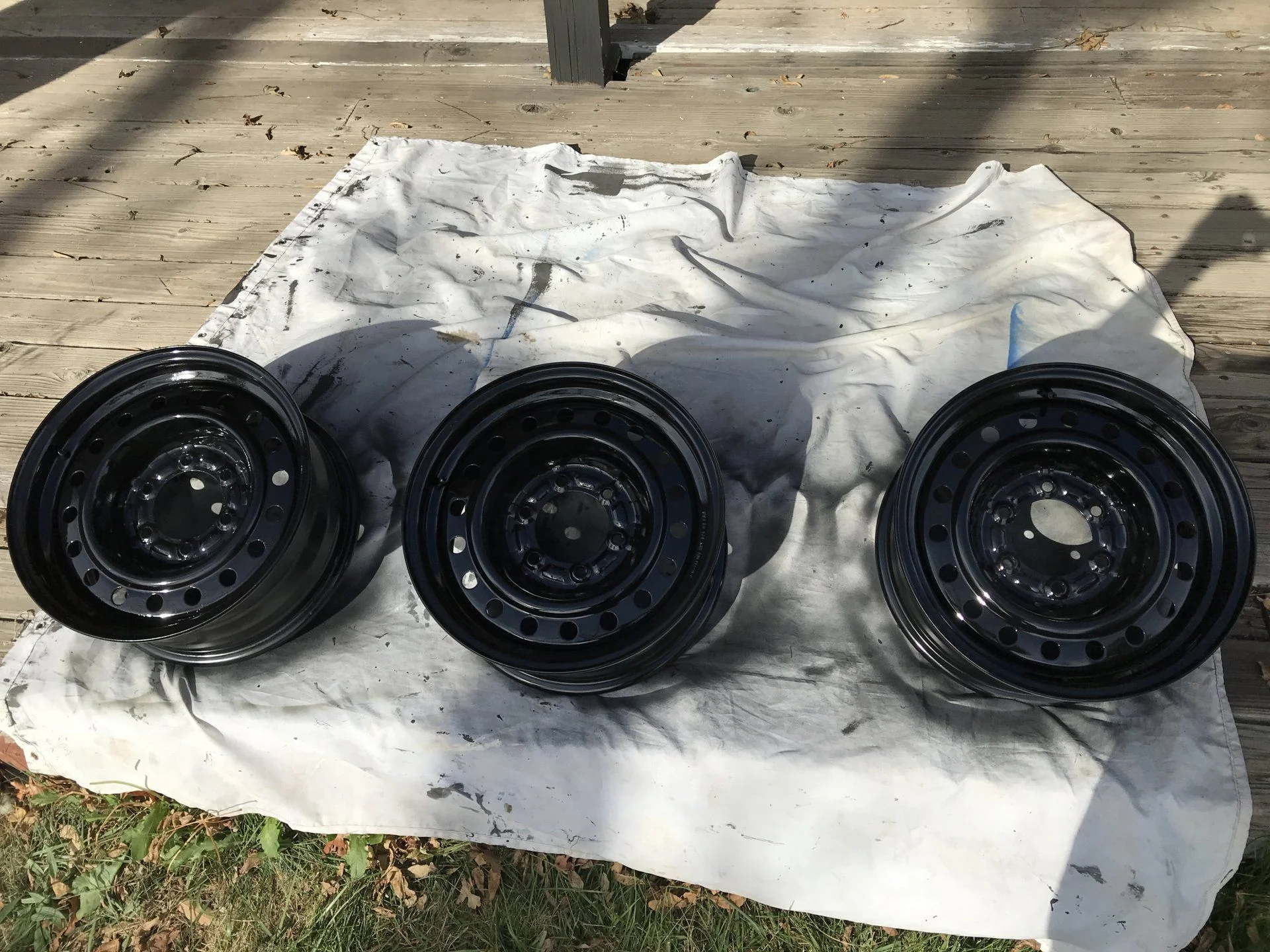

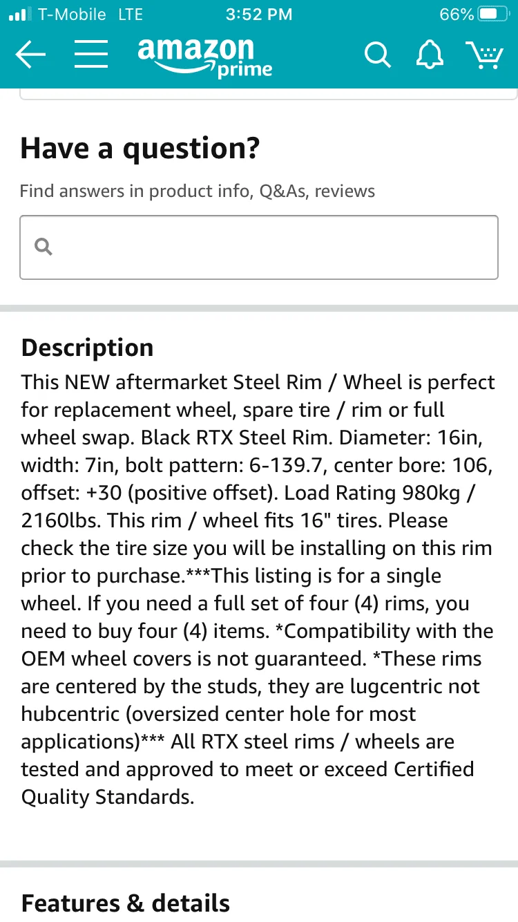

Total wheel fiasco. I am trying to piece together a set of 16" spares off 96-02 4runners. Found one at the local auto wreckers for $35 which was a score. Drove 1 hour to pick-n-pull and struck out. Looked at ebay but shipping made them seem over priced. Found some new reproductions on amazon for the same price. The load rating was 2,160 lbs so I ordered 3. Finally arrived and they look different than the pic (not the end of the world) but the wheels and box are labeled with "max load 1400 lbs" I hate shipping things back but since the the load rating is almost 1000lbs different I think I am going to have to. Ended up ordering 3 used wheels from 3 different venders on ebay... heres hoping they arrive before I leave for my trip.

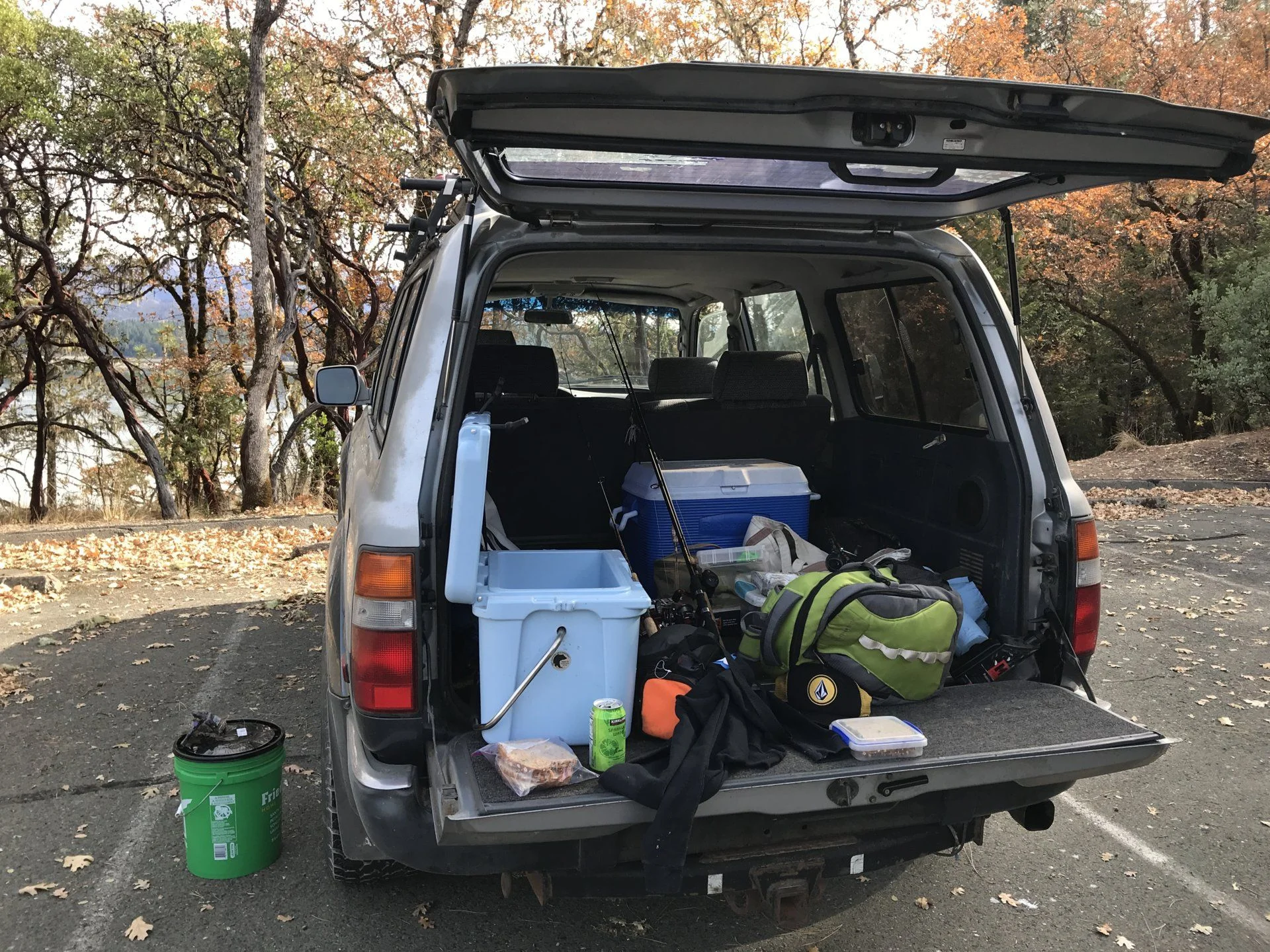

In other news, I took my son and his friend fishing to a lake up an hour long dirt road. Love the way the 80 handles dirt and stoked to have a rig to get out and about with!
Finally got the last of the wheels sourced. Ended up buying off ebay for about $75 each after shipping. Did some sanding and painting today and will try to get the tires mounted up tomorrow.
