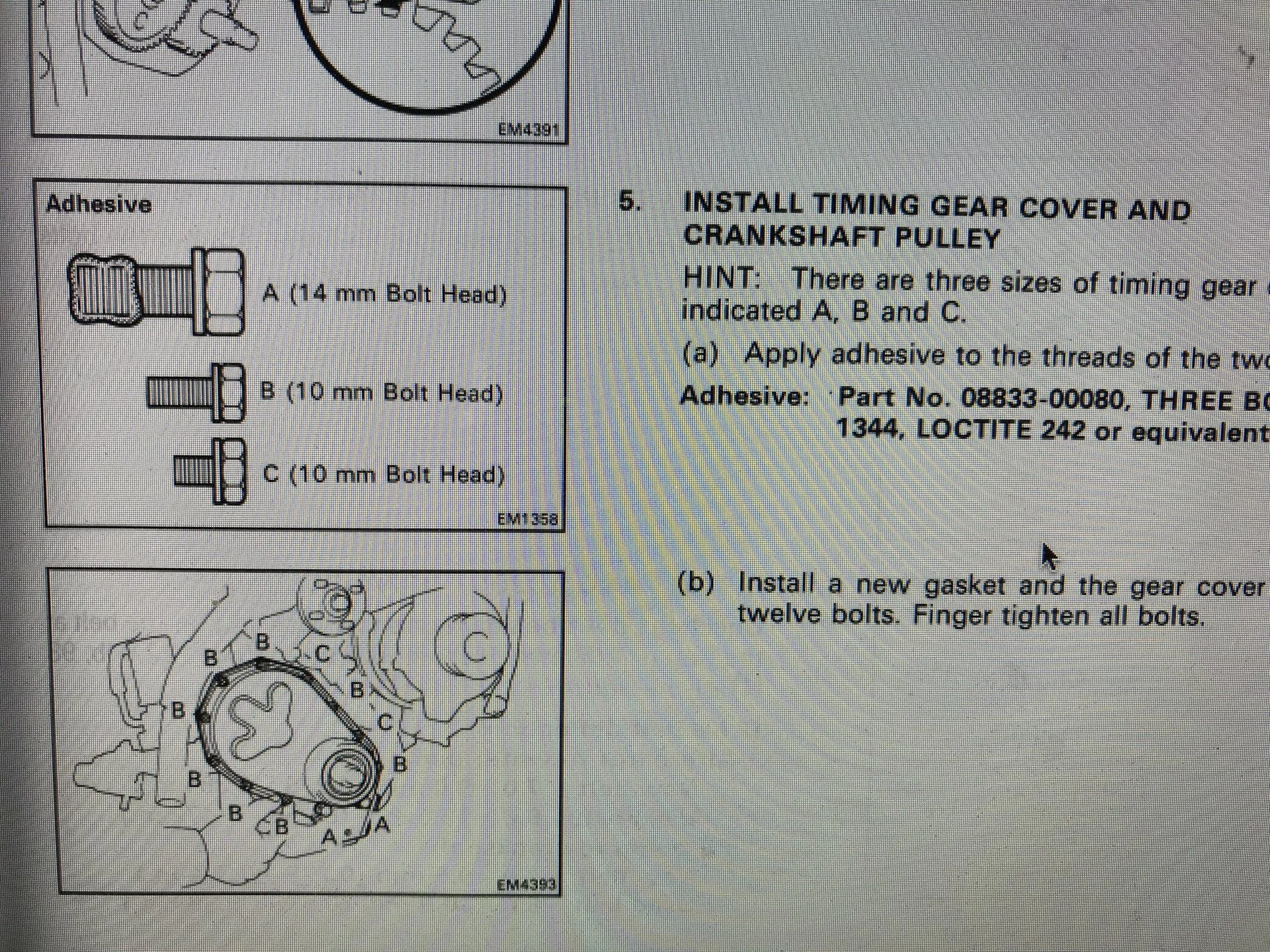

I have been using a Haynes manual for 1980-1996 Land Cruisers and it had this image for the timing cover bolts:
But I only had 2 short bolts... So I put them in the in the two upper "B" spots.
I then downloaded the 3FE FSM and found this diagram:
So I think the long bolts in the short bolt spots which pulled the front end plate away from the block and caused the leak. Switched the bolts and all is well!
