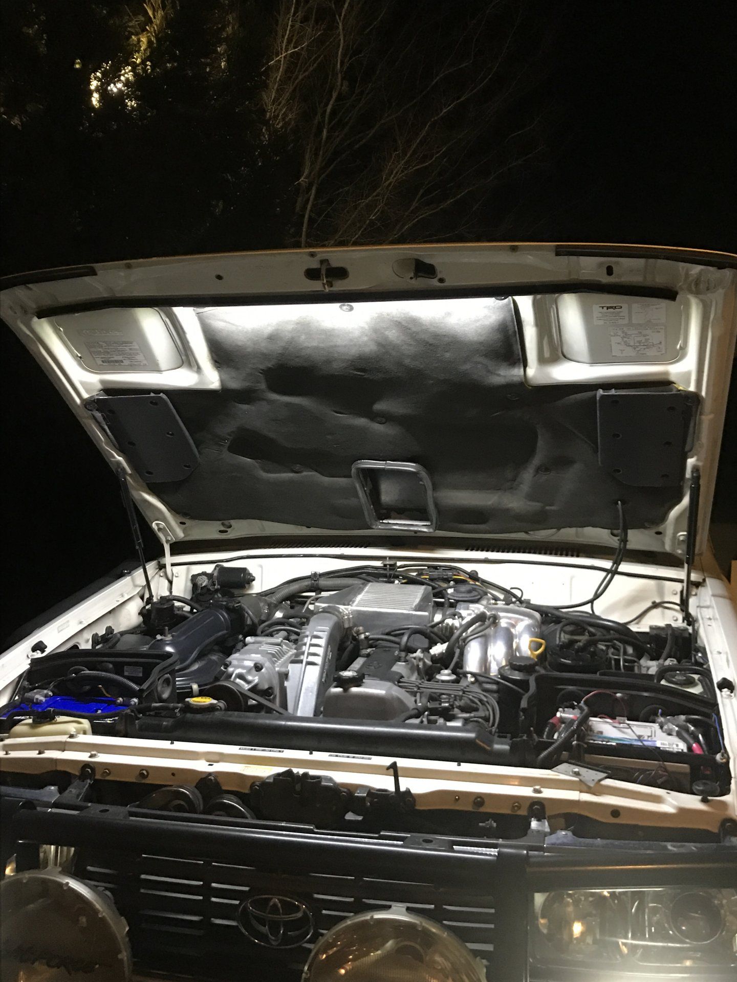

I have an air-to-air made by @Atoyo1031 along time ago. Running a Subaru WRX small scoop.
In the process of adding the Landtank SC MAF kit with WRX injectors and a 2.8inch SC pulley. Here's how it used to look.

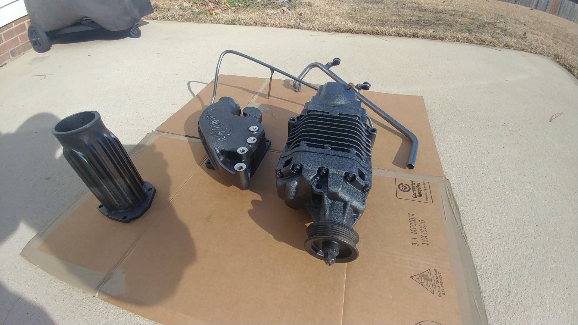

I met up with @fourtrax a day too early to assist with some wrenching on one of his projects. So will greased my hubs and driveshafts. While talking about the supercharger, we decided that I should paint it since my valve cover is painted and the supercharger isnt installed yet.
So. . what do you all think?
Looks nice.
