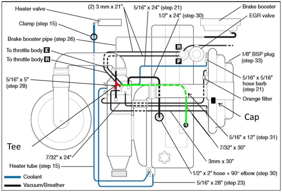

What are you alls thoughts on this?
Running the PVC hose to a "T" w/ or w/ catch can. Suppose to help with oil blow back for not getting into the plymouth. I think LC Phil said he's been running it this way for year, but Land Tank has a different opinion.
Although I really only want to make preventive maintenance purchases now for the LC, I think I have all that's needed in my garage other than a catch can bracket for where I would like it to be mounted.
Also. .when am I suppose to do an oil change on the SC? I think I've seen anywhere from 30K to 70K where the guy wished he would of done it sooner.

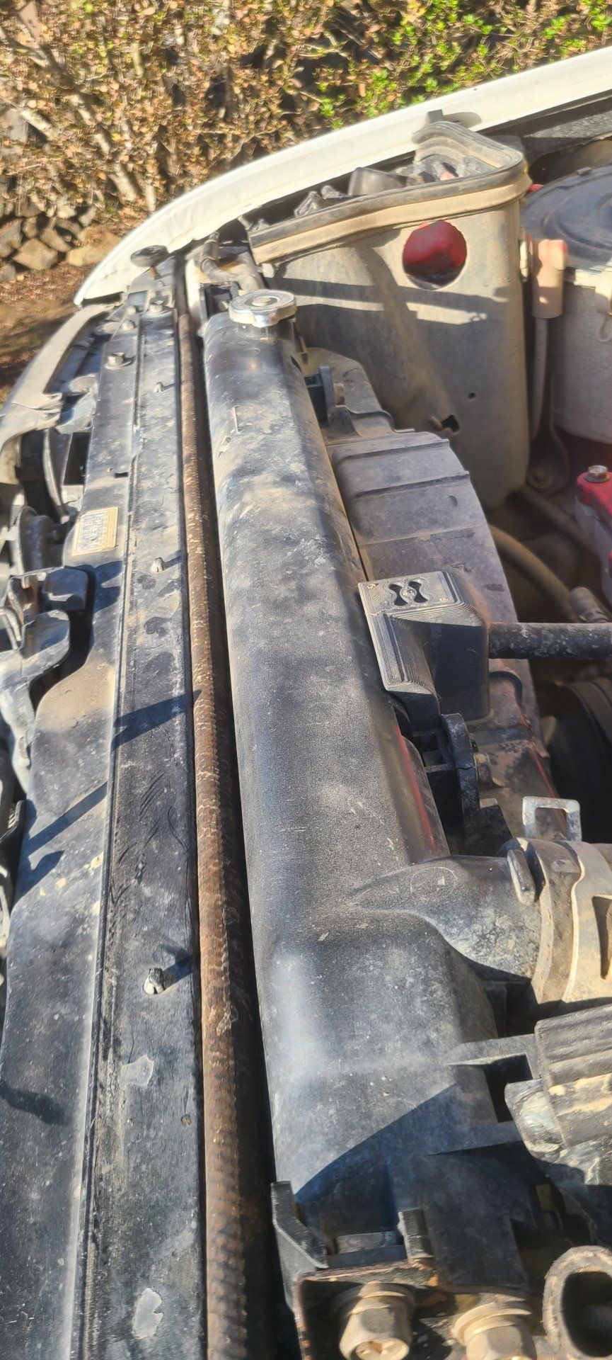

@MyWhiteSheep tube and nipple protector View attachment 2600989
Thanks. I haven't looked it up yet, but I like your radiator nipple guard. Someone broke mine on an old radiator, and I'm always keeping an eye on it when I'm doing work.

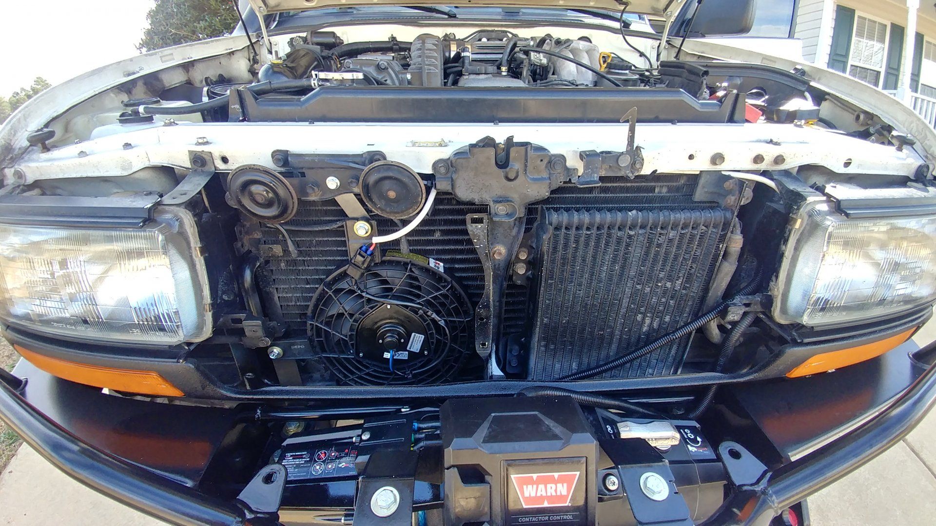

Got off a little early and re-pinned my MAF connector, and installed the hood risers from @Outsane.
The rise of the hood is more subtle than I thought. . Which I like.
What's the point of the hood risers? Never seen someone intentionally misalign body panels before, outside of a trail :P
What's the point of the hood risers? Never seen someone intentionally misalign body panels before, outside of a trail :p
Lol. Some folks talk about overheating because of the SC. Though I don't think I'll have this problems, I'm adding a little reassurance.
windshield wiper defrosters.
any issues/smells from the A/C. seems like with the hot air exiting right by the fresh air intake your air entering the cab could be warmer.
i like the look/angle
We call it a twofer. Reduces the heat under the hood in the summer, and helps defrost the windshield in the winter
I haven't driven it yet. Just did it yesterday evening. Since it's been nice out, I've been driving the Challenger
Re- routed the PCV hose
Re-routed the PCV hose from the plymouth to the brake booster pipe for oil blow back.
