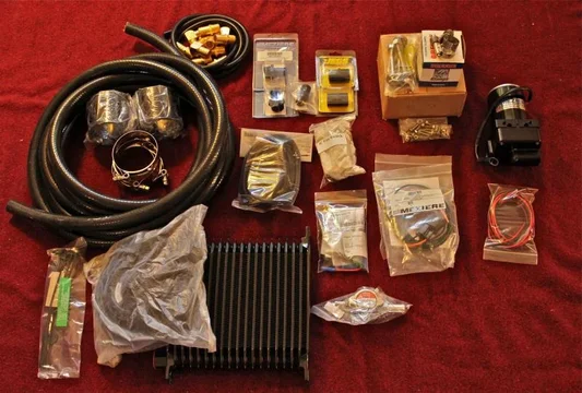

At this time I’ll be offering the kit in two different configurations. The Basic Kit includes the main fabricated parts, leaving the circulation pump, wiring and plumbing up to you. The Master Kit includes everything needed to get up and running. Both kits will also come with detailed instruction notes and photo documentation. It’s not exactly a step-by-step manual, as there are too many variations in how different trucks are set up, but gives enough detail for the slightly-above-average shade tree mechanic to complete the install.
Basic Kit ($1250):
Intercooler Core
Intake Flange
Coolant Pump Mounting Plate
Heat Exchanger Mounting Brackets
EGR Modulator Relocation Bracket
Master Kit ($2250) includes all of the above plus:
Coolant Pump (Meziere all aluminum 20 gpm)
Coolant Pump Fittings (x2) (AN to 3/4" Hose Barb)
SS T-Bolt Clamps 3" (x4)
Silicone Straight Coupler (x2)
Heat Exchanger
Heat Exchanger Fan (7")
Remote Fill/Bleed Cap 3/4"
Silicone Heater Hose 3/4" (20')
Silicone Hose 6mm (6' for overflow)
Brass Elbow 3/4" (x6)
Brass 1/2" NPT Male to 3/4" Hose Barb - Straight (x6)
Brass 1/2" NPT Male to 3/4" Hose Barb - Elbow (x4)
Rear Heater Switch (OEM Toyota)
Wiring and Fuse/Relay Kit (x2 for Coolant Pump and IC Fan)
Wire Loom, Fuse Tap, OEM Terminals for Connection to AC Pressure Switch, etc.

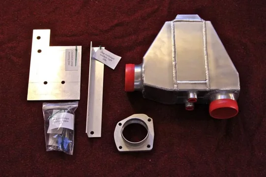

- Basic Kit -
- Master Kit -

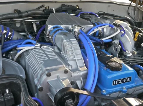

- Overview showing IC core and intake flange connection -

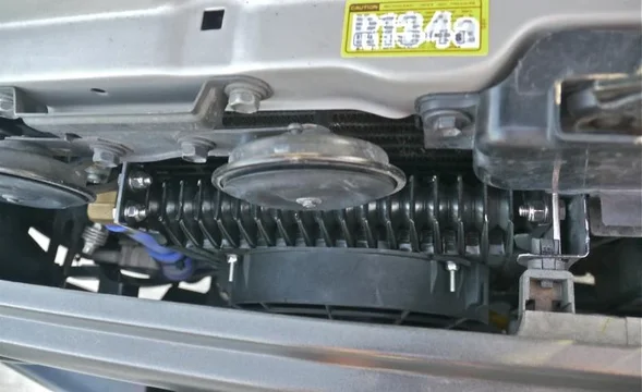

- Heat exchanger mounted behind stock grille (minor trimming required) -

where did the pump mount behid grille or remotely? and which meziere did you prefer?
Pump mounts down on the PS frame rail, and is a 20-gpm capacity all-aluminum unit.
