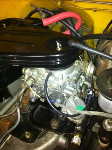

Great suggestion. Only problem is I got home from dinner with the wife and got a wild hair and cleaned and reassembled the carb.
Just finished the whole job when I took this pic and went to my phone and saw your most excellent suggestion. Kind of feel like a cross between Homer S and the dad on Christmas Story trying to set a personal best with the ole tire change.
Anyway, sweet thing is asleep so I will fire it up in the morning and see if I accomplished anything. If nothing else, I'm starting to feel like I can work on one of these things at Happy Hour.
All you vacuum leak guys have been vindicated, I think I have a manifold leak somewhere near #2. Once I got the right angle shooting carb cleaner between the manifold and head I saw the idle jump up a good 500 rpm's. Weather is headed south this weekend so here goes a dig a little deeper, never pulled my intake and headers. Who's got the best gasket, TEQ?
Carb work was probably good all along, but hey I got a lot of training!
