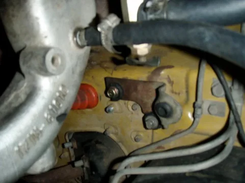

Cleaned up the firewall and installed the linkage bracket.

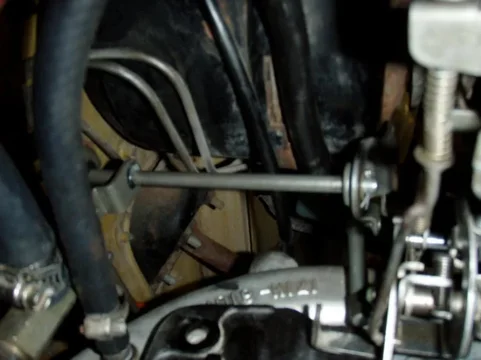

When I set the carb, carb linkage and linkage in place I found the linkage rod did not line up from end to end. Went with a 3FE 40 bud to look at another 40's linkage. This is from that 40, the linkage was slightly different from what I have accumulated but I figured I should be able to make mine work.
Ended up placing some of my linkage brackets in the vice and bending them to get my linkage rod to sit level and at a square 90 degrees to the front and rear bracket housings. Upon a more detailed look it appears my firewall where the back bracket mounts has been bent slightly at some time (maybe when the PO converted to cable linkage). So I placed some washers between the firewall and bracket to help square it up to the shaft, then installed the carb
Here is the linkage installed, everything looked pretty good but I found I was not getting the full throw with the pedal ( primary was not opening to full 90 degrees). Since I checked this when I rebuilt the carb I looked at the adjustment of the long rod from pedal to linkage. In the end it appears the carpet and floor mat was possibly interfering with the full motion of the pedal, so I pulled it and bent it slightly in the vice to get full motion. Installed the pedal and now I have the carb primary opening fully.

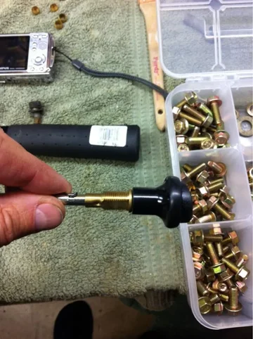

Finding a fine thread backing to the choke cable. Purchased a brand new one, unwrapped it this morning and no nut to hold it in place. Any one know the size and thread pitch?
Found the idle solenoid 12v tucked away behind some electrical tape, switched fitting to match carb and tested.

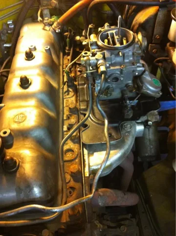

Removed the alternator and bracket to have access to the full length of the hard lines. The supply on truck the truck has more bends that a river delta but I got it to work. The return I picked up was pretty clogged. Spent the day in carb dip, running wire through it and rubbing with a scotch bright. Finally have it on, now to reassembling all I have taken apart.

Is that a crimp in the hard line in your last photo, the one on the right? Maybe it's just the pic?
Yep it does have a little crimp but I think I can still get plenty of fuel thru. I would have used the supply you brought me but it's pretty clogged.

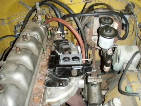

So the large 16mm port coming out of the insulator component of the carb appears to be for the EGR. Since I'm de-smogged I'm looking for confirmation that this should be plugged.

Looks like you plugged the EGR port on the carb. That's correct for your setup, or else you would have a massive vacuum leak.
