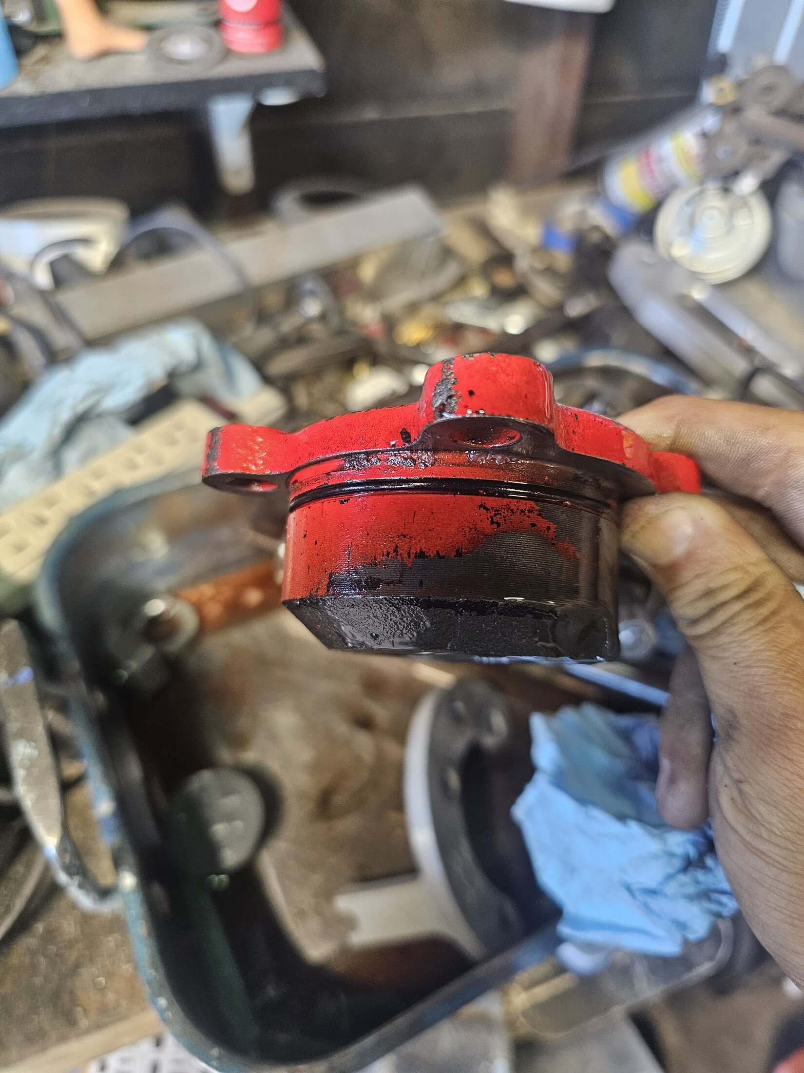

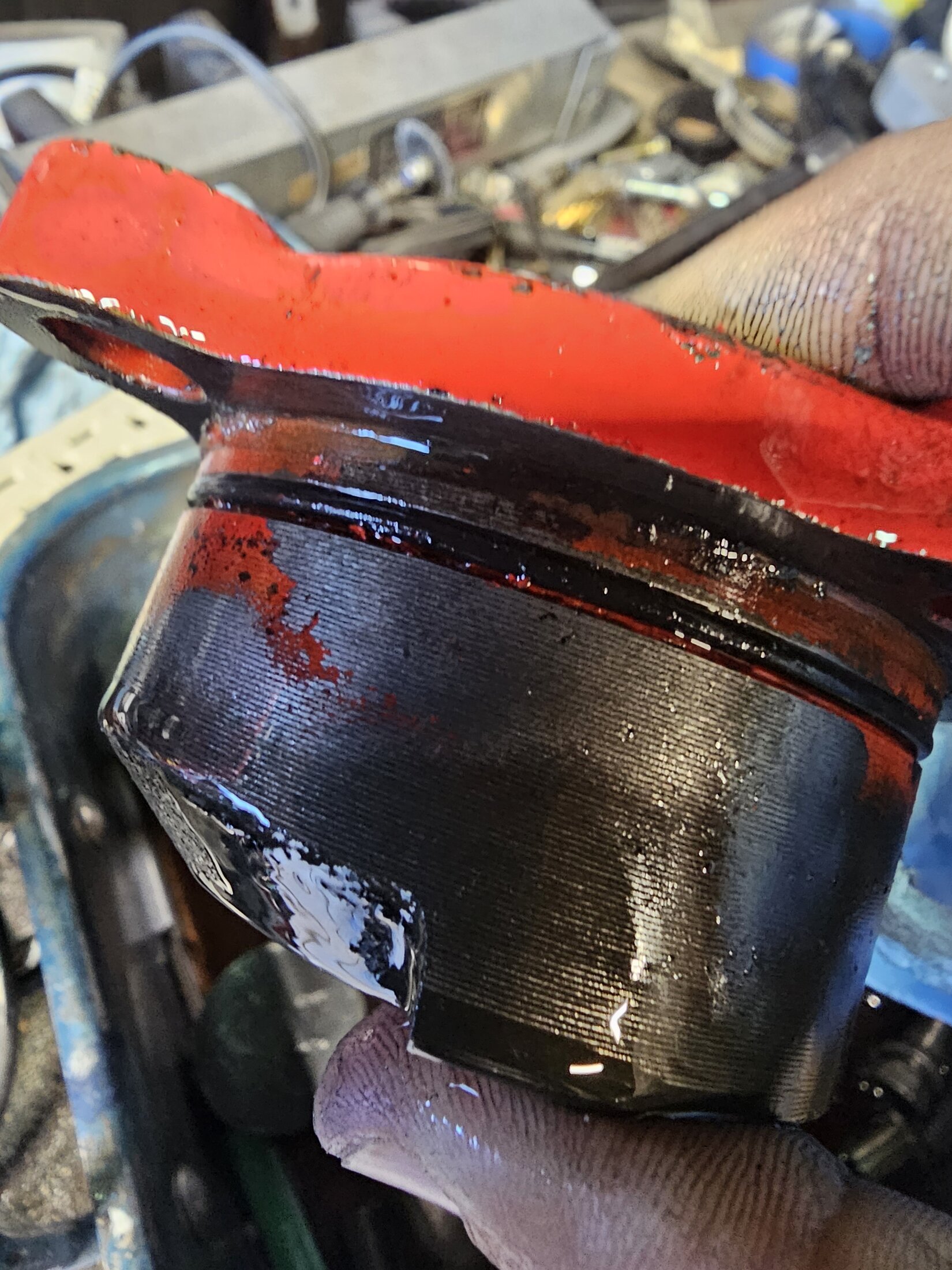

@Outsane was the steering box leaking from that o-ring where it was painted red?
I believe it was leaking, I didn't see it leak myself. I just don't see how it's good practice to paint a sealing surface this way.
100% that should not be painted. I work in automotive and we spend a ridiculous amount of time masking. When you see stuff like this it just screams rush job.

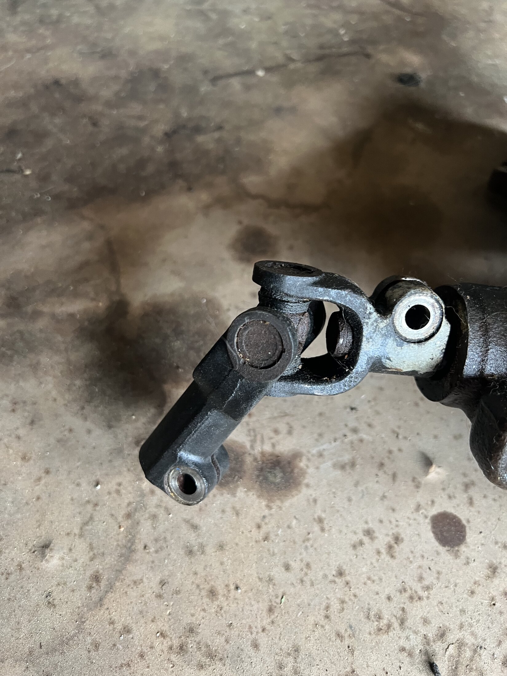

Dredging steering stuff back up with another question. Part # for…?
Its funny you ask this just as I am searching for it. I've gotten as far as to know its called a "sliding yoke sub-assembly". Unsure of exact part #s, but seems like something that you'd want to do while in there. If anyone knows I would also appreciate it. Diagram in the link Remove and reinstall the steering gear box - https://forum.ih8mud.com/threads/remove-and-reinstall-the-steering-gear-box.554162/
