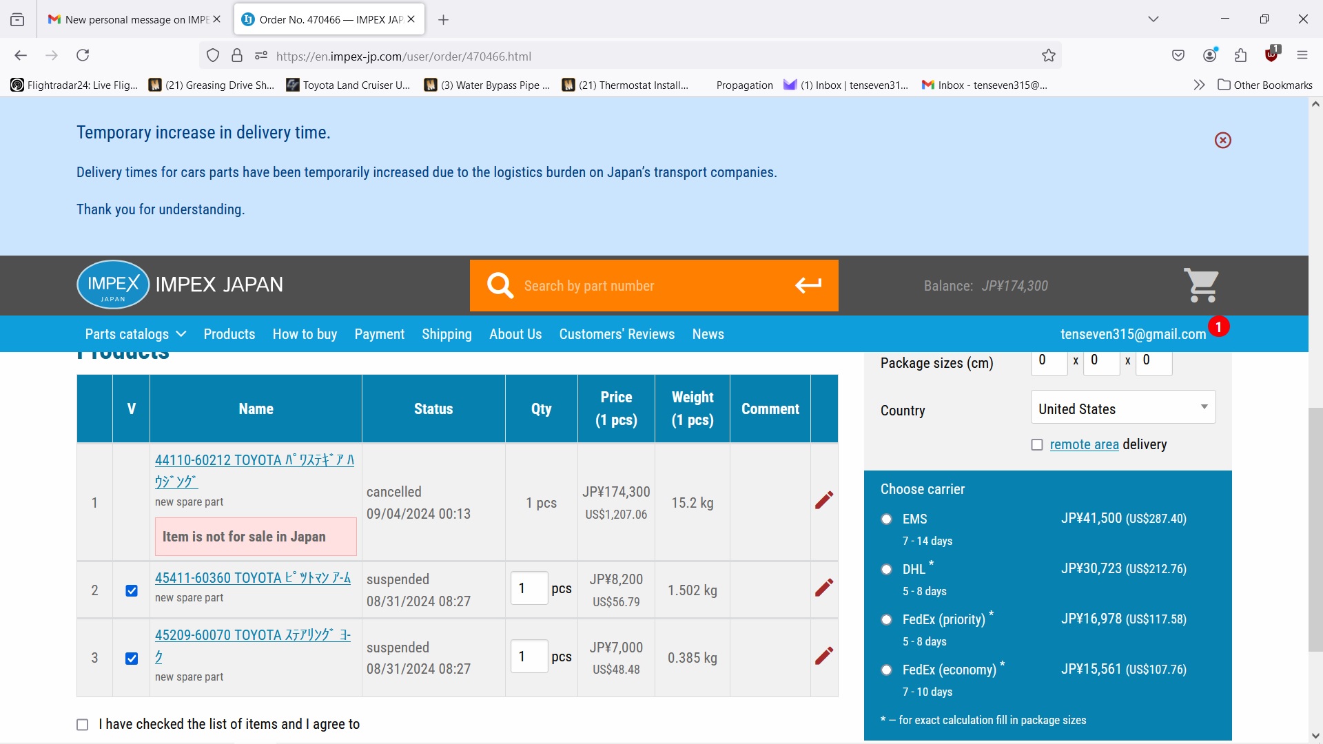

Go to for Steering Box?
Just ordered a steering box from Impex and got this "item is not for sale in Japan" message?
Any help appreciated cuz no refunds from Impex I might be eating $1300.

Wait, they don't refund your money even if they don't have the product? Maybe they don't take returns, but I can't imagine they could get away with just not shipping product. The Wits End business model tends to backfire.
If they don't offer a refund for product never shipped, that sounds like the sort of thing I'd dispute with a credit card company.
Thank you all I sent message to Impex see what happens. Kinda tough working Japan to English language.
I ordered from Impex cuz FAR cheaper and a parade of Mud users received the part. Guess I was last in line and no soup for me.
Here is the message I received:
Note that in case there will be no reply from you within five calendar days, the order will be cancelled, with the money you have paid for the order refunding to your balance.
^^Yes refunding to balance means a credit on your account not a refund. I think...
I agree, that's why I messaged them to clarify that I was expecting a refund not a credit.
Thank you just did the same. Wish I got the steering gearbox though. Story of my life = no love cheap.
