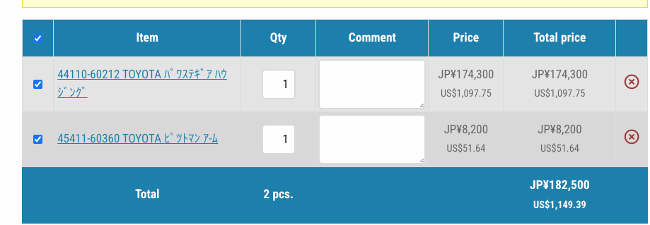

Is that steering box with the 105 sector shaft and I see it is for the 100 series does it work with the 80?
The box comes with the 105 sector shaft fresh from the Toyota oven. All you need is the pitman arm as the og one won't fit since more teeth.
I just bought another one to stash. $1,235.58 delivered to CA. I will mark it up 3x 10x in 10 years when it's unobtanium. lol
