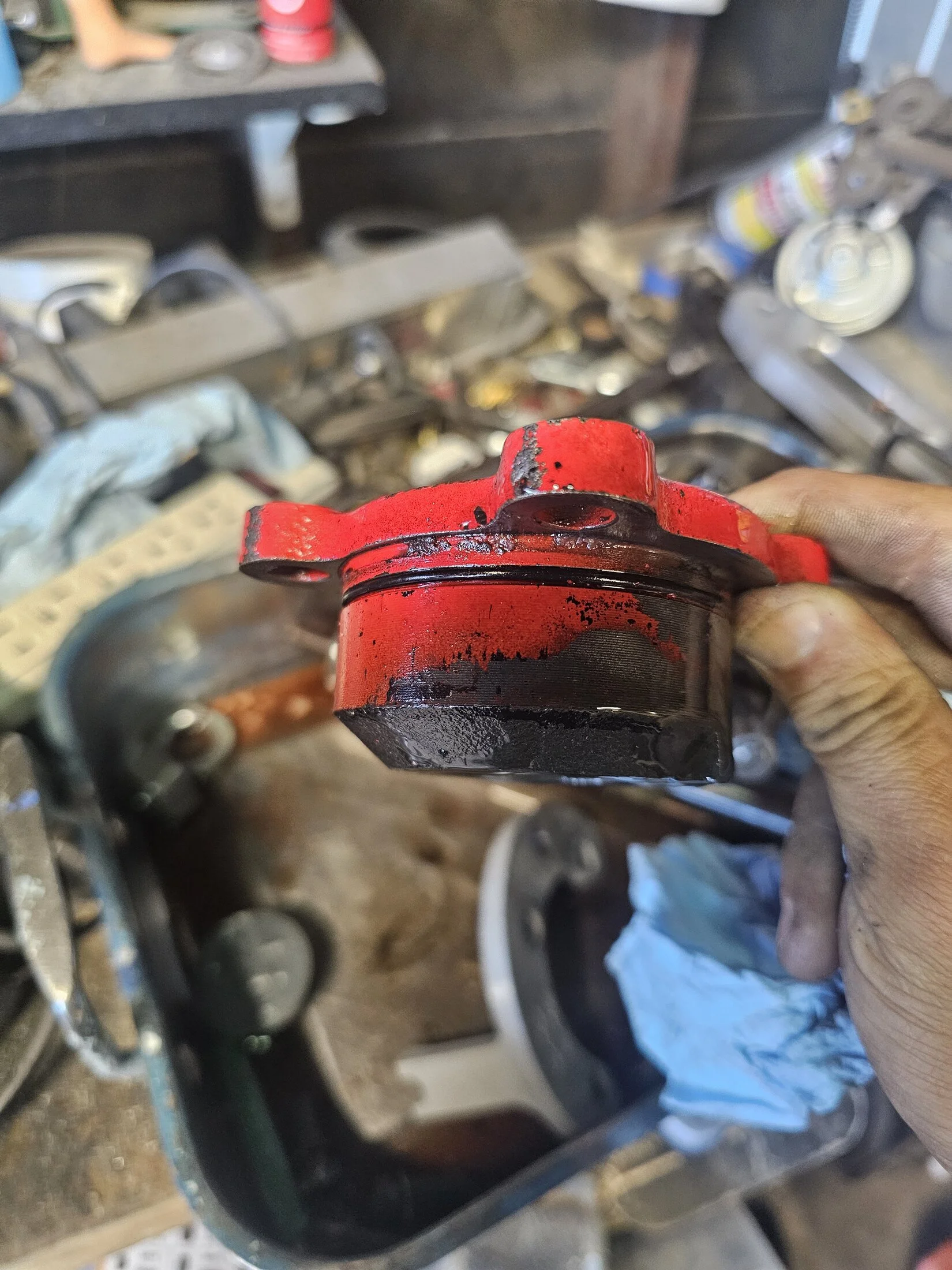

Yes, the weak Yen helps us USD buyers, but ~$1200 is a whole lot of money for me to spend on something that just has a little seal leak. Not that ~$1200 in and of itself is a catastrophic amount, but it's more than I want to spend on this right now. I'm Yankee/Scots frugal.

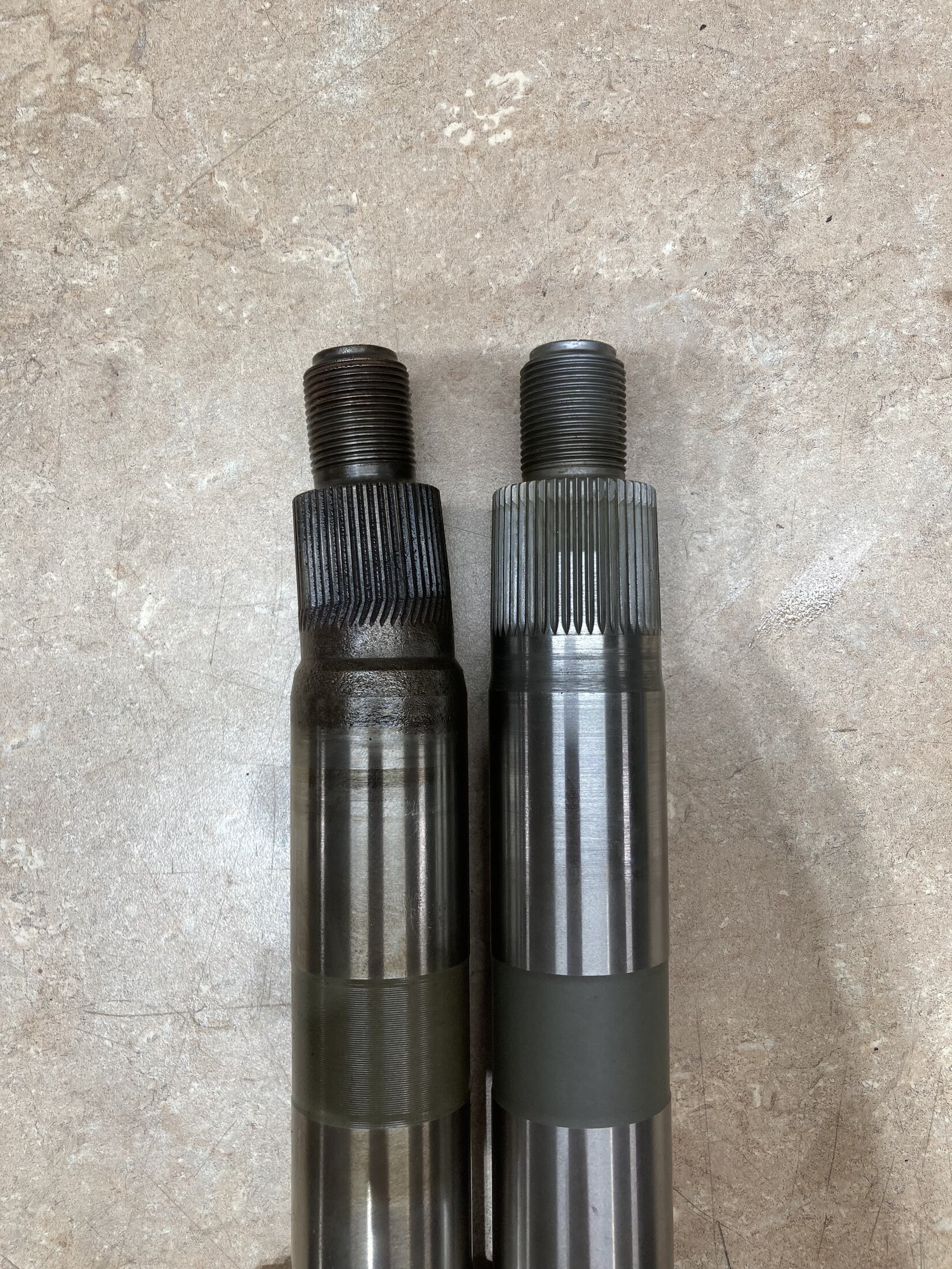

I'm psyched for people that are able to get a new box with the upgraded shaft and arm. It sounds like a great time to buy due to exchange rates, an opportunity to get one while they are still available, and also gain the benefit of a new, perfect part to improve function.

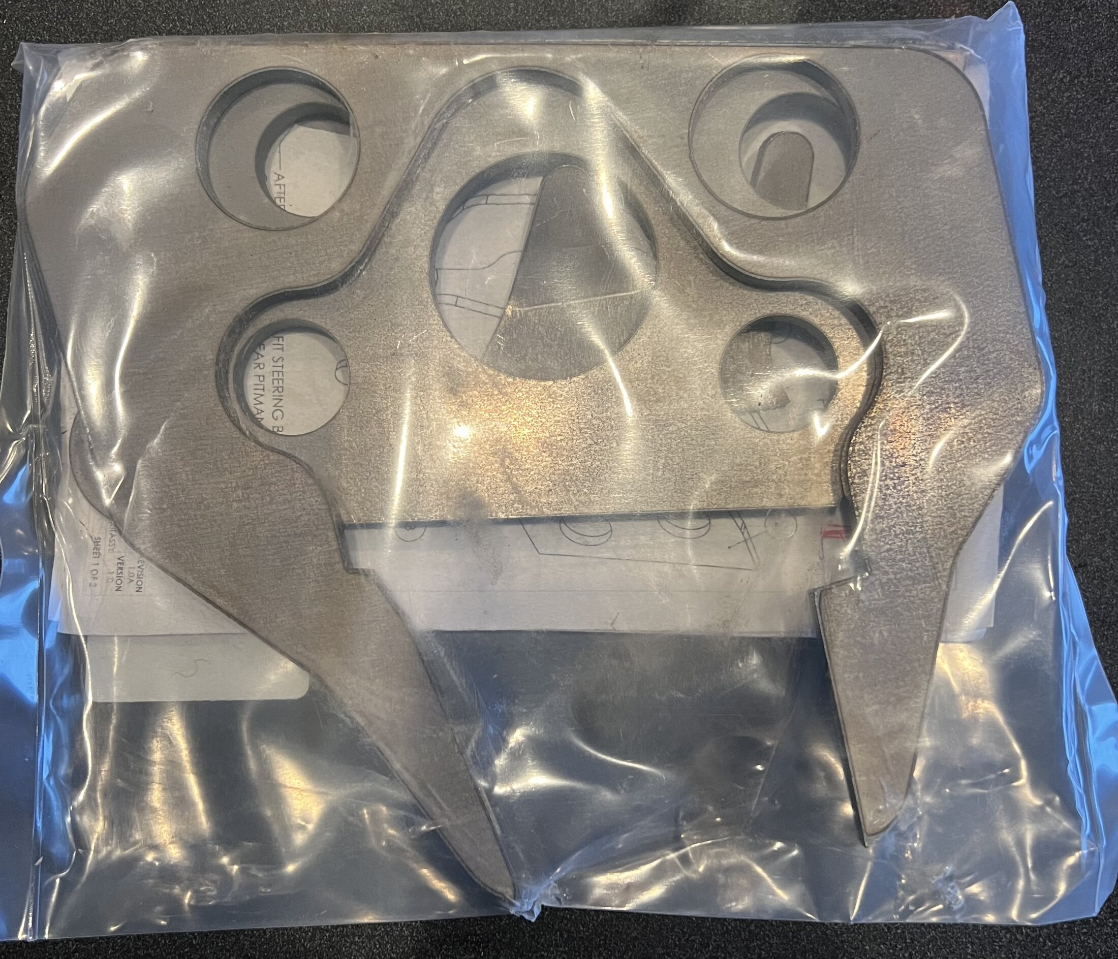

For my part, I'm buying a used steering box from a 'mud member and a rebuild kit (Toyota parts from Japan, benefitting from the exchange rate). I'll weld in the Delta plates, and install the used box, then reseal my original as a spare. If stars align, and I find a super deal, maybe I'll even rebuild with a 105 shaft and arm. Hopefully this works out and I'm not being penny wise, pound foolish.
