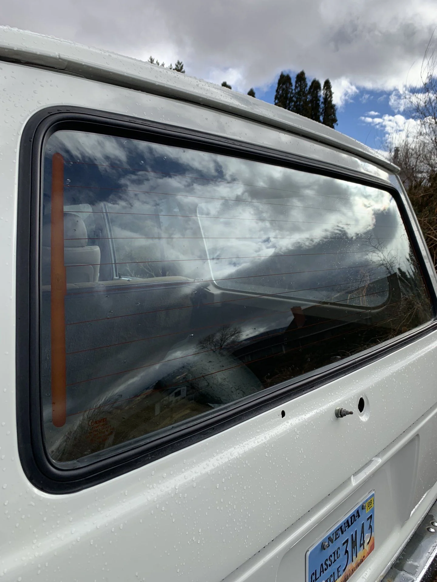

I used some “chrome” lock strip I got from @TRAIL TAILOR that looks spot on factory. I’ll post a pic shortly. I wanted to keep the OEM 80s look. :)
Definitely use a lock strip tool to install but it looks perfect :D
