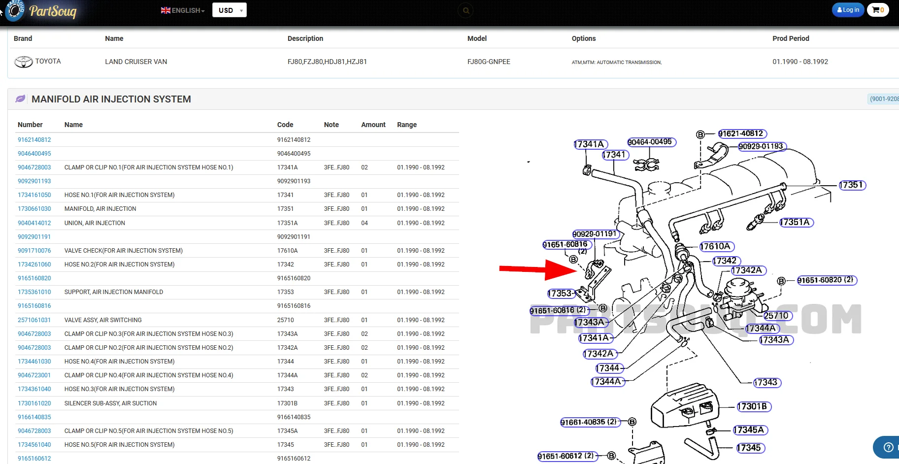

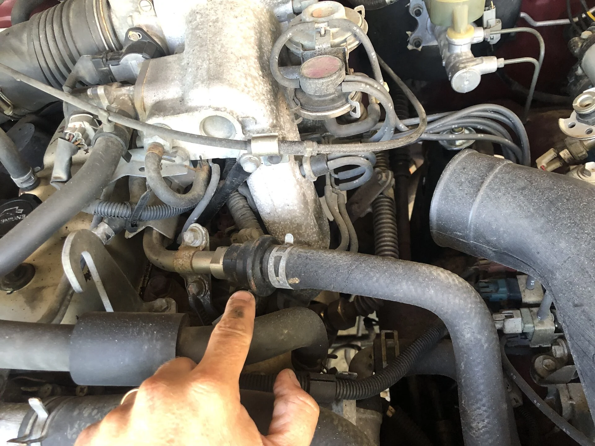

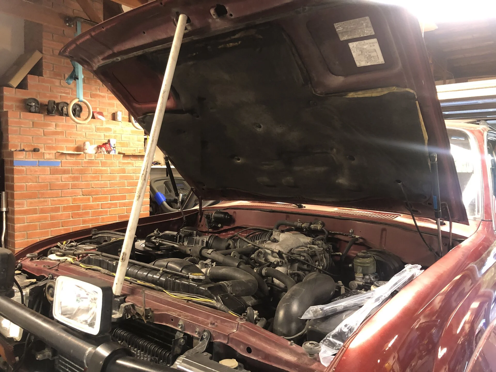

Does anyone have a part number for this check valve and hose? I know it’s Check valve A from a diagram, just can’t seem to find the part numbers. This one seems roasted.
+ 1 for Partsouq.com
Good source of genuine parts without paying the full Toyota tax.
Find your chassis/ frame type in the Toyota menu, then search through diagrams.
Diagrams are usually labelled by 'system'. Eg, heater hose, ventilation hose, bypass hose etc.
Sometimes, you need to dig, things aren't always in the obvious diagram
Thank you, I’ll definitely look at that. Thank you for the resource.

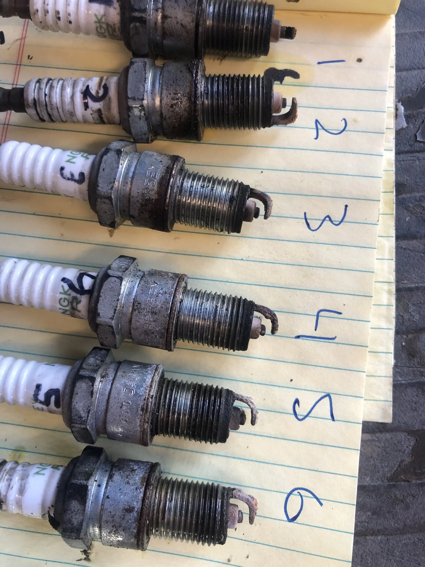

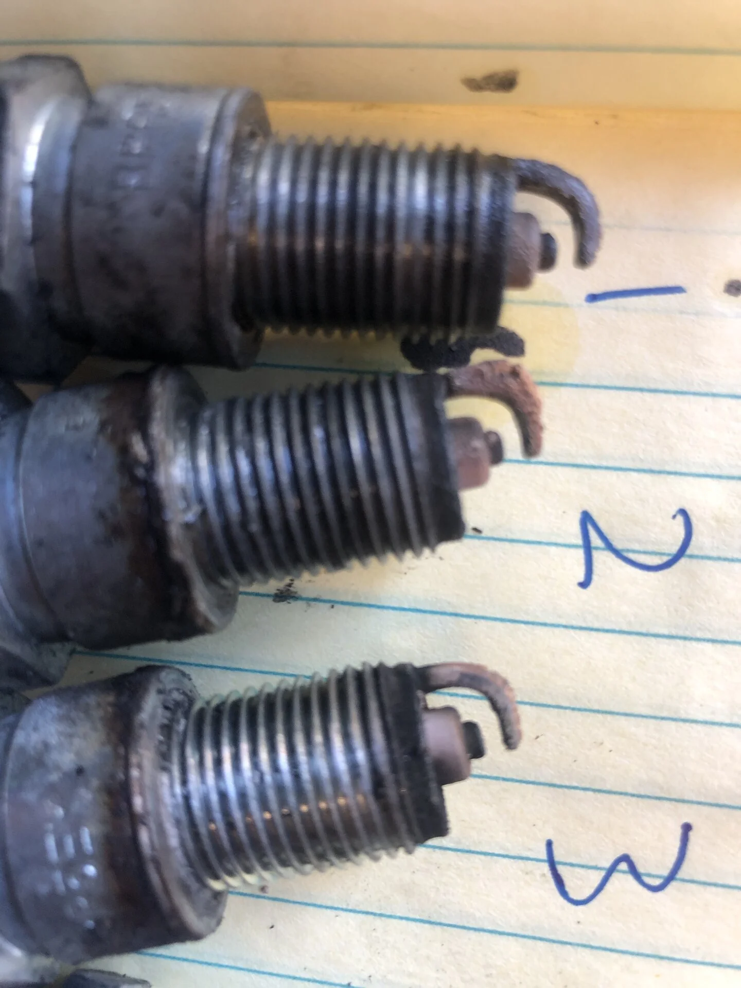

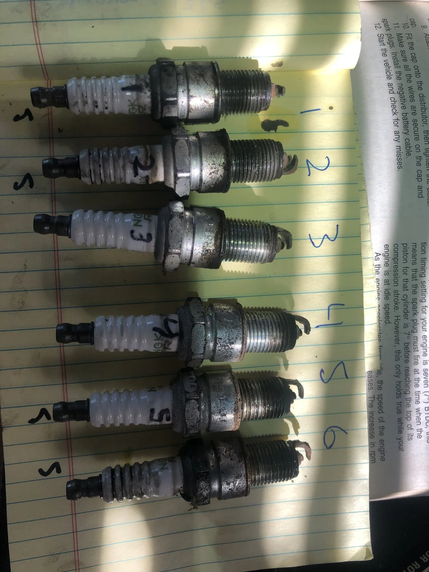

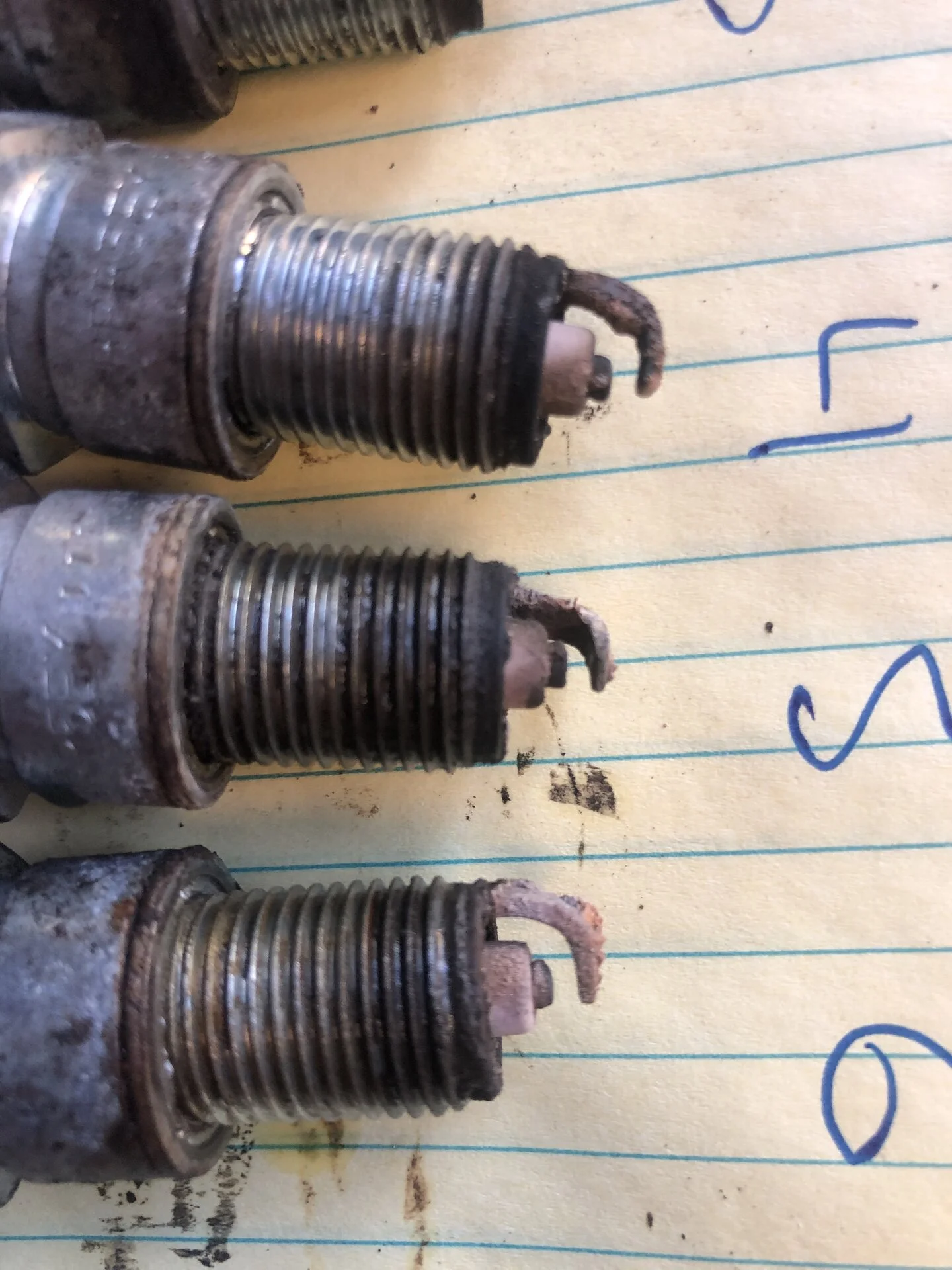

Another note, use anti seize on your plugs. I lucked out I was able to get all of my spark plugs out. 2/3 were seized.. whew!

so I’ve searched, can anyone point me in the right direction. I can’t find this part, and the hose I’m pointing to. Any help would be appreciate. thank you.
I have an FZJ, but I'm guessing it looks like an air injection hose given the mounting bracket looks correct. Welcome to mud. It is an amazing place.
Thank you!!! I was sure it was part of the emissions. Thank you. 17610A, and17343! Hell yeah. Good to be here!
The actual part number is on the left side.

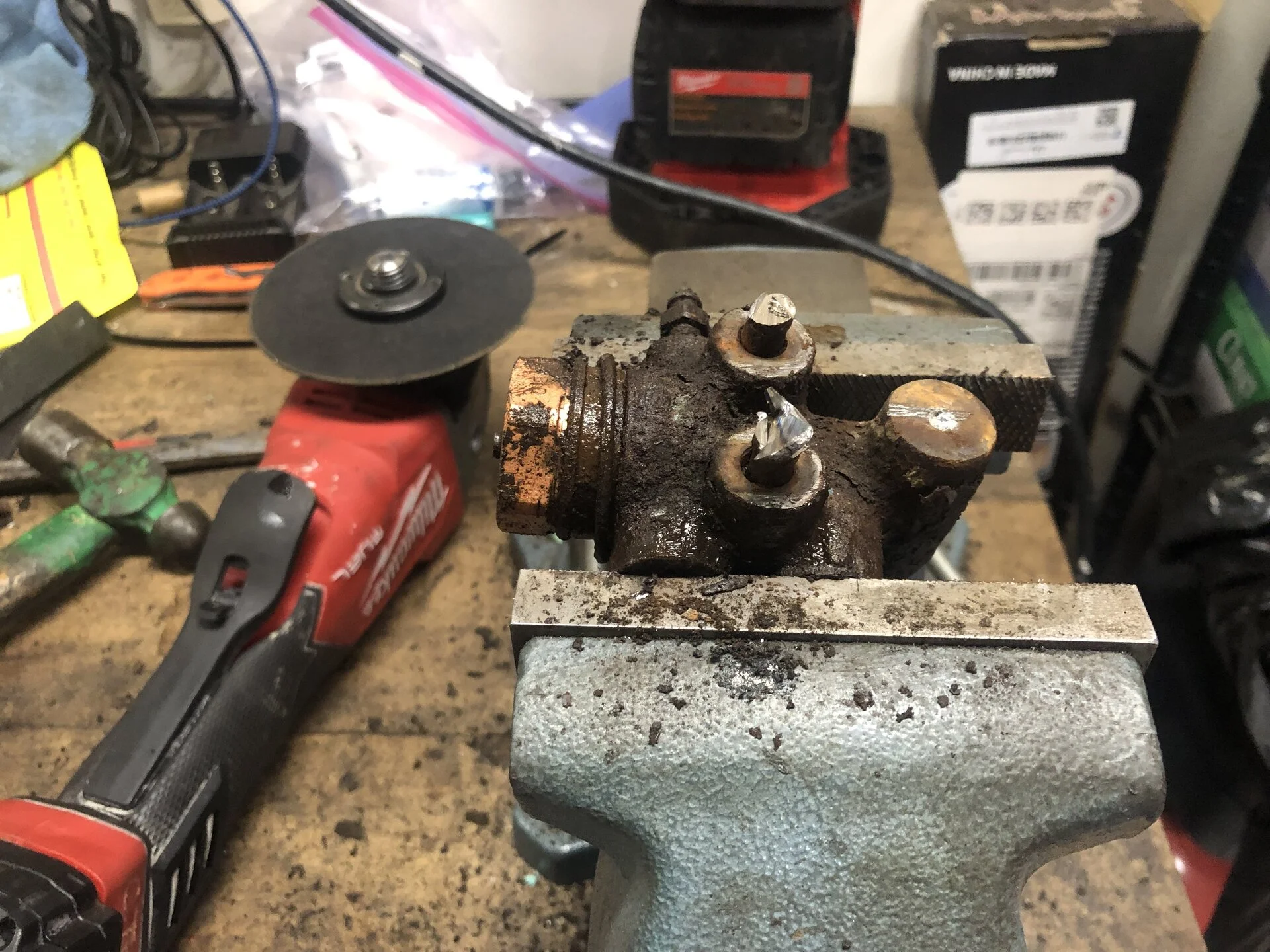

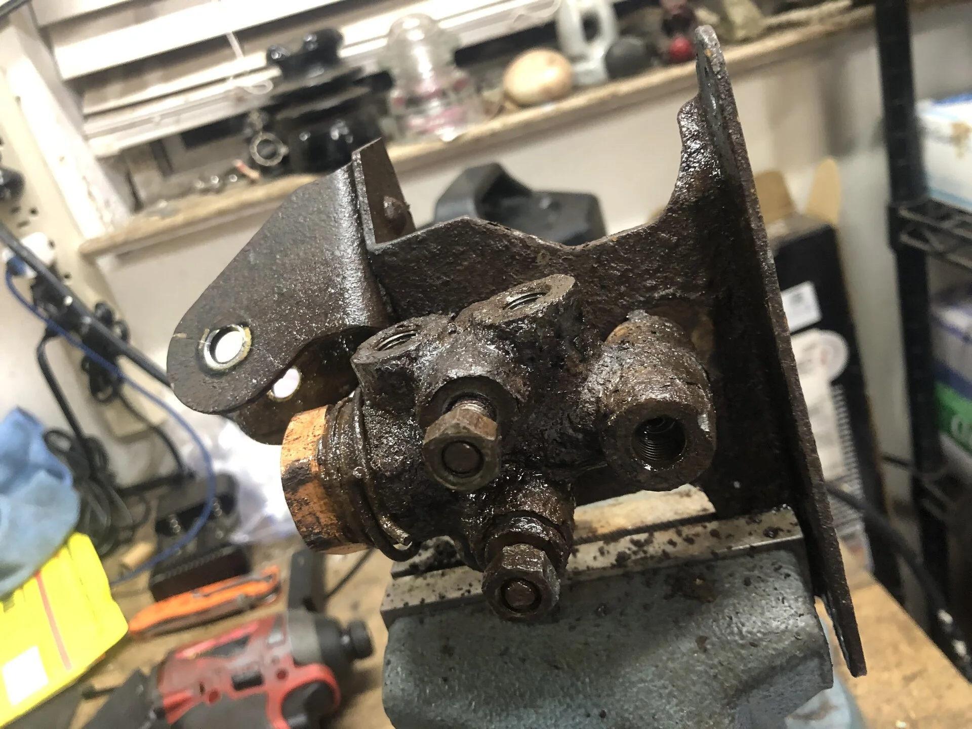

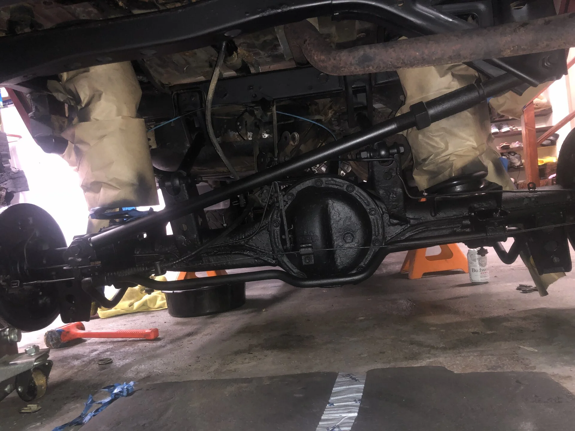

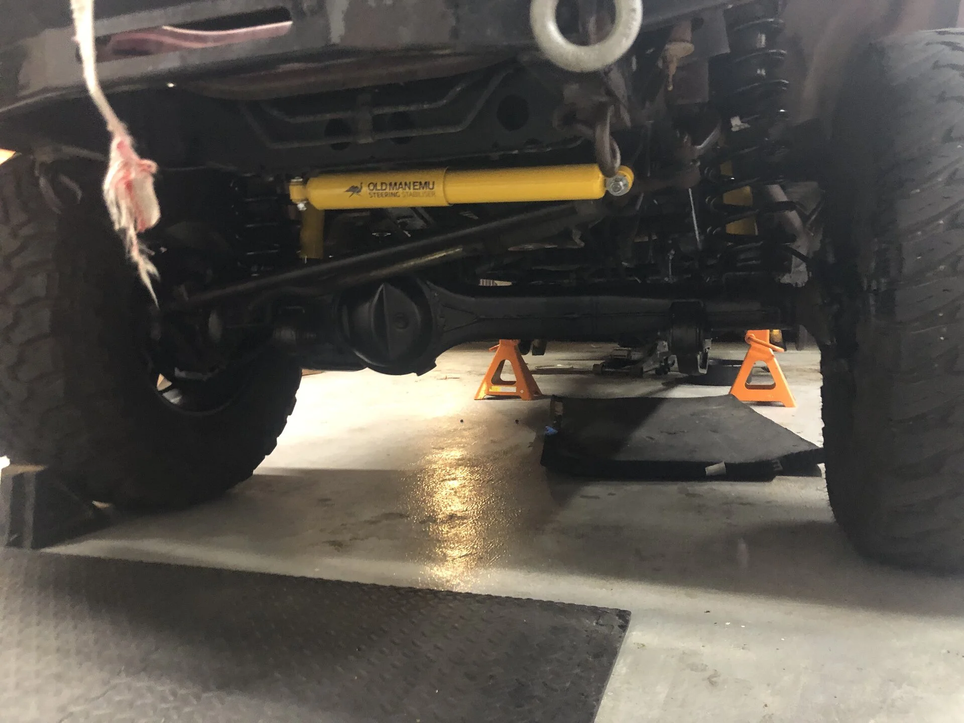

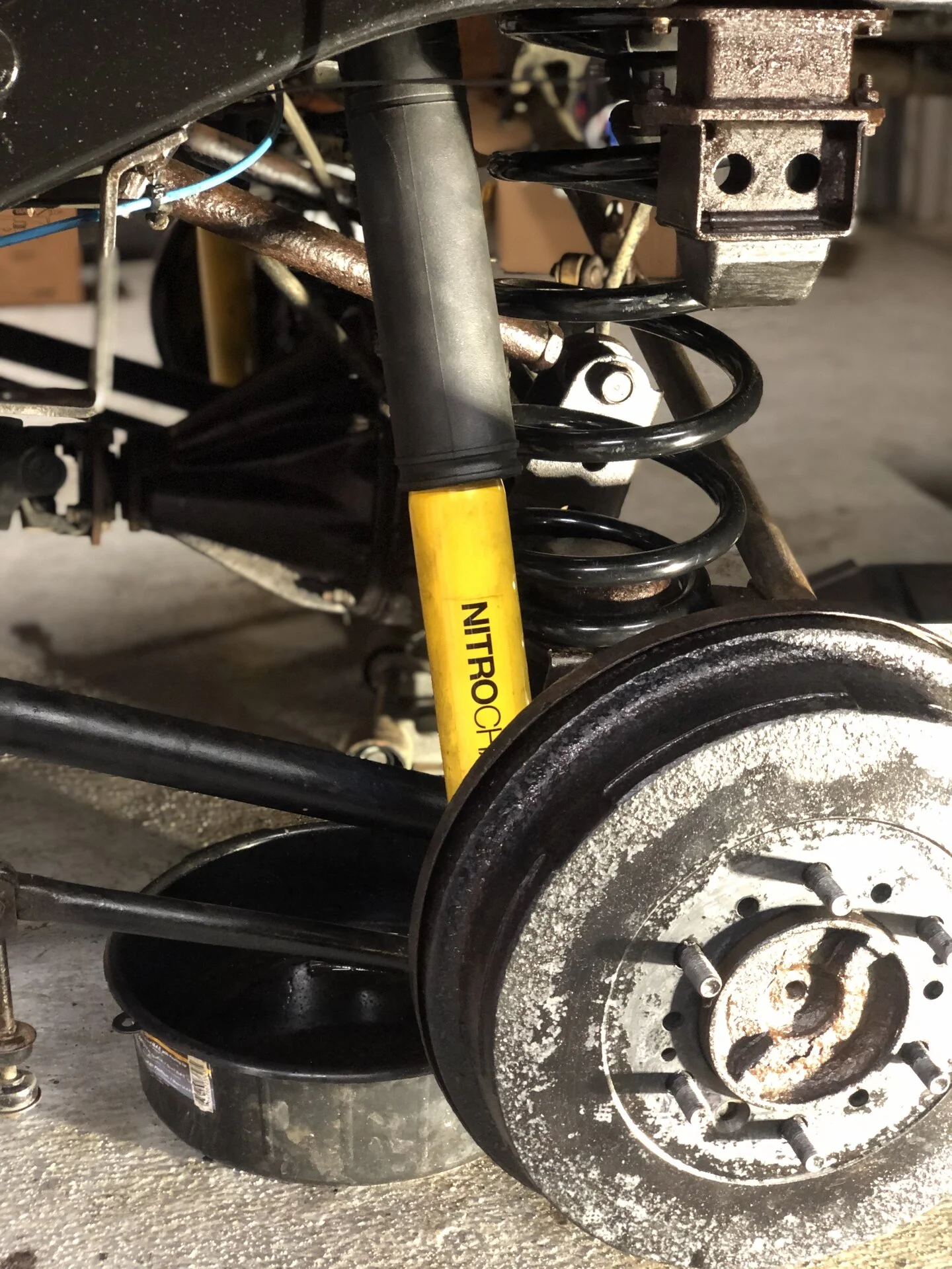

Long day. My neighbor came over and helped me for the day. He’s a former mechanic. His knowledge was super valuable. I definitely wouldn’t be as far as I’m at. I probably would have rage quit numerous hours ago with out him. I got the new rotors, and calipers on. The rear brake drums wouldn’t bleed. My LPSV is/was completely frozen. New one coming in Monday. It was so frozen we had to cut the bracket out of the car in order to get it loose from the bracket so I could reinstall a new one. Would someone share a photo of what their LPSV and arm are supposed to look like with a 3.5” lift? The one I have it looks like there’s an extra bracket, but it was bent on one of the control arms. Looks a little off. I just want to know what one is supposed to look like so that I can make mine look like yours. Thank you.
That front end though is looking bad ass!
