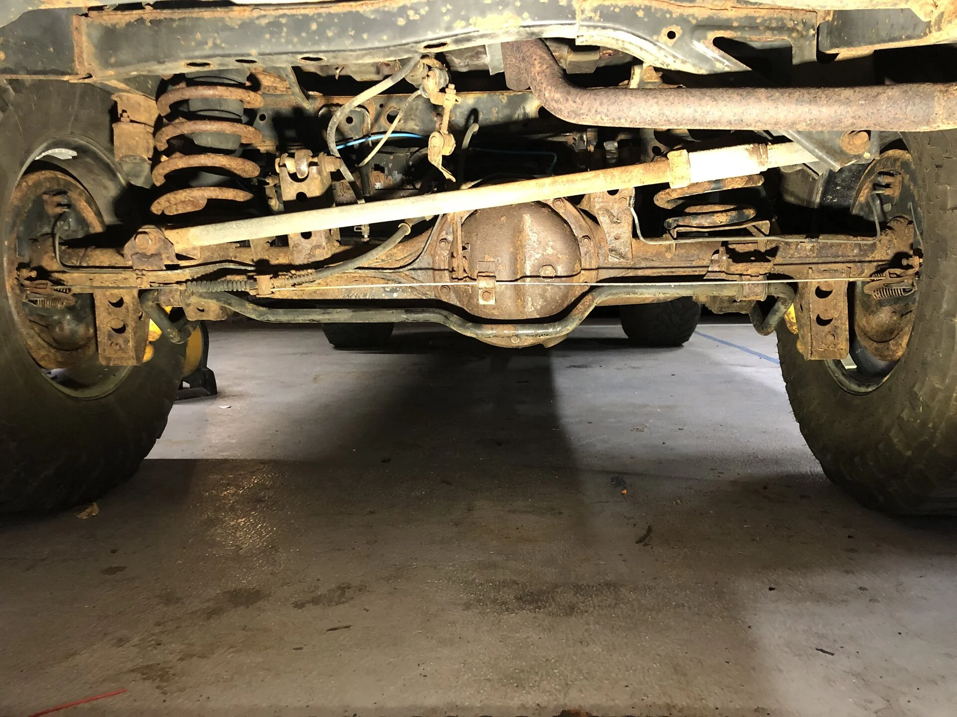

I need to get it running good. Then I’ll deal with front lockers. I’ve got quite a list going. I talked with the cruiser outfitters today. I’m not sure if I have a 2.5, or 3.5 lift. I’m right around 24” from center hub to bottom of wheel well. Is that a 3.5” lift?

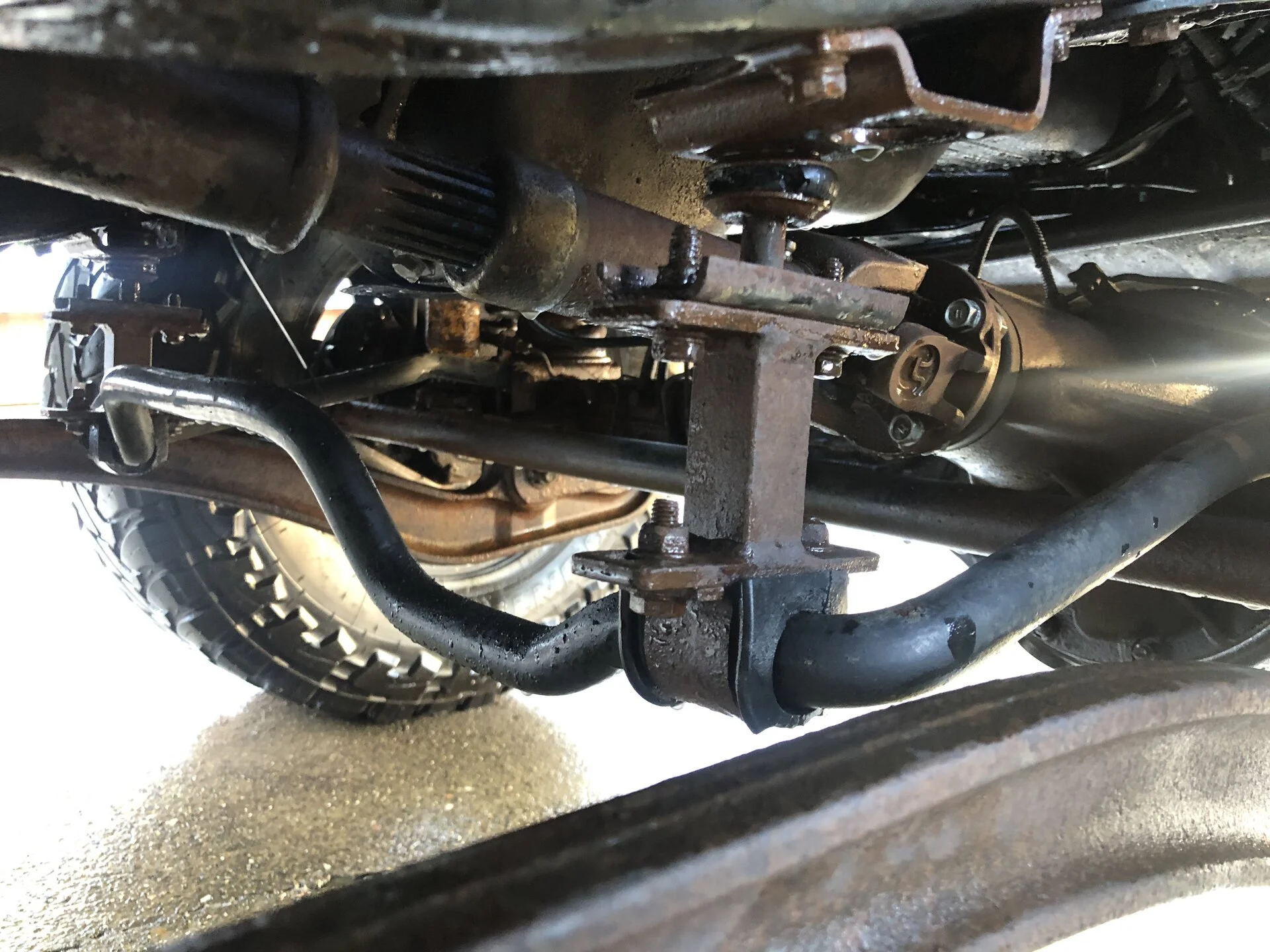

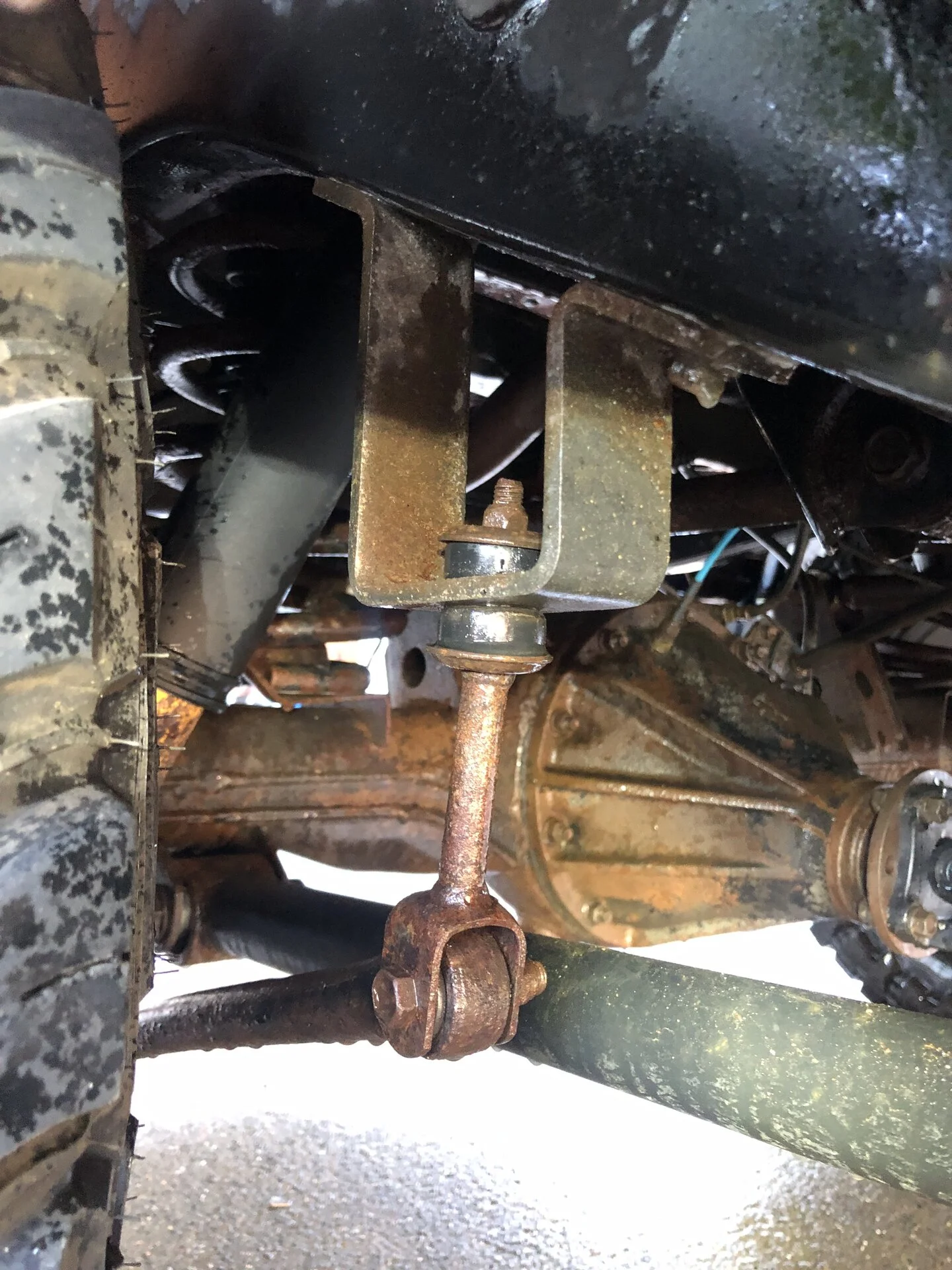

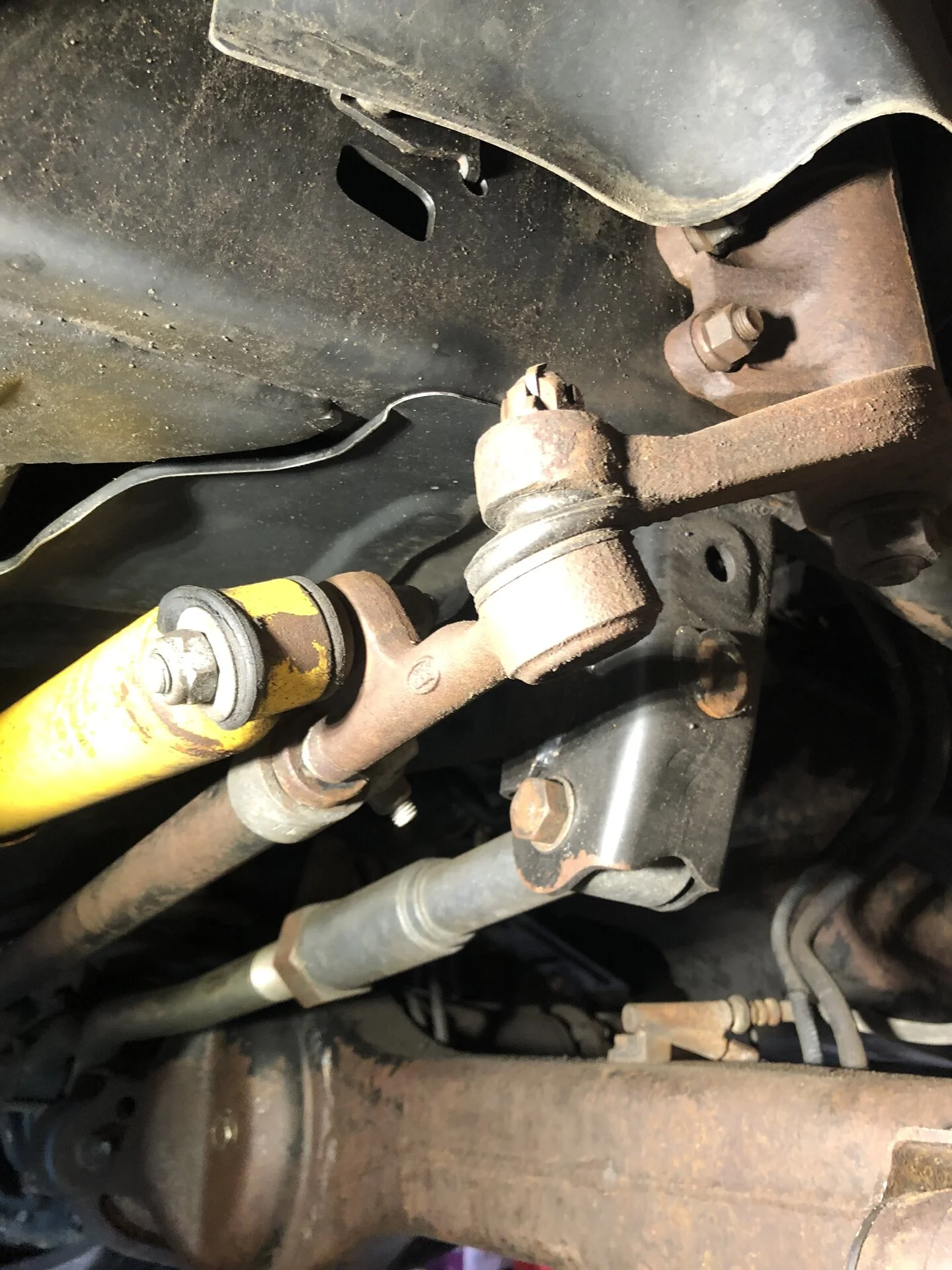

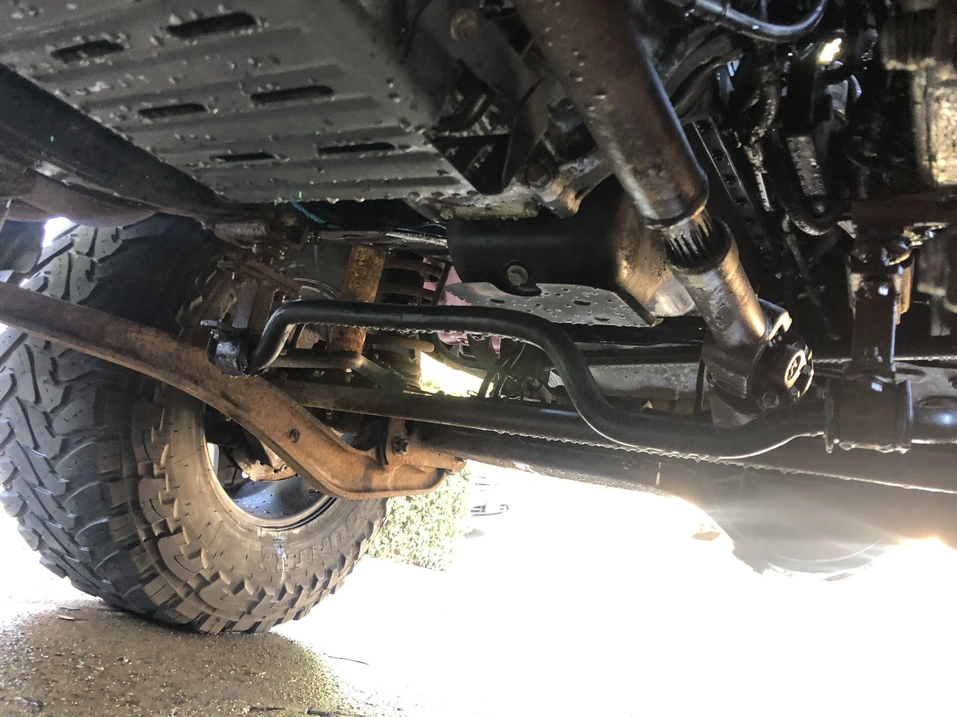

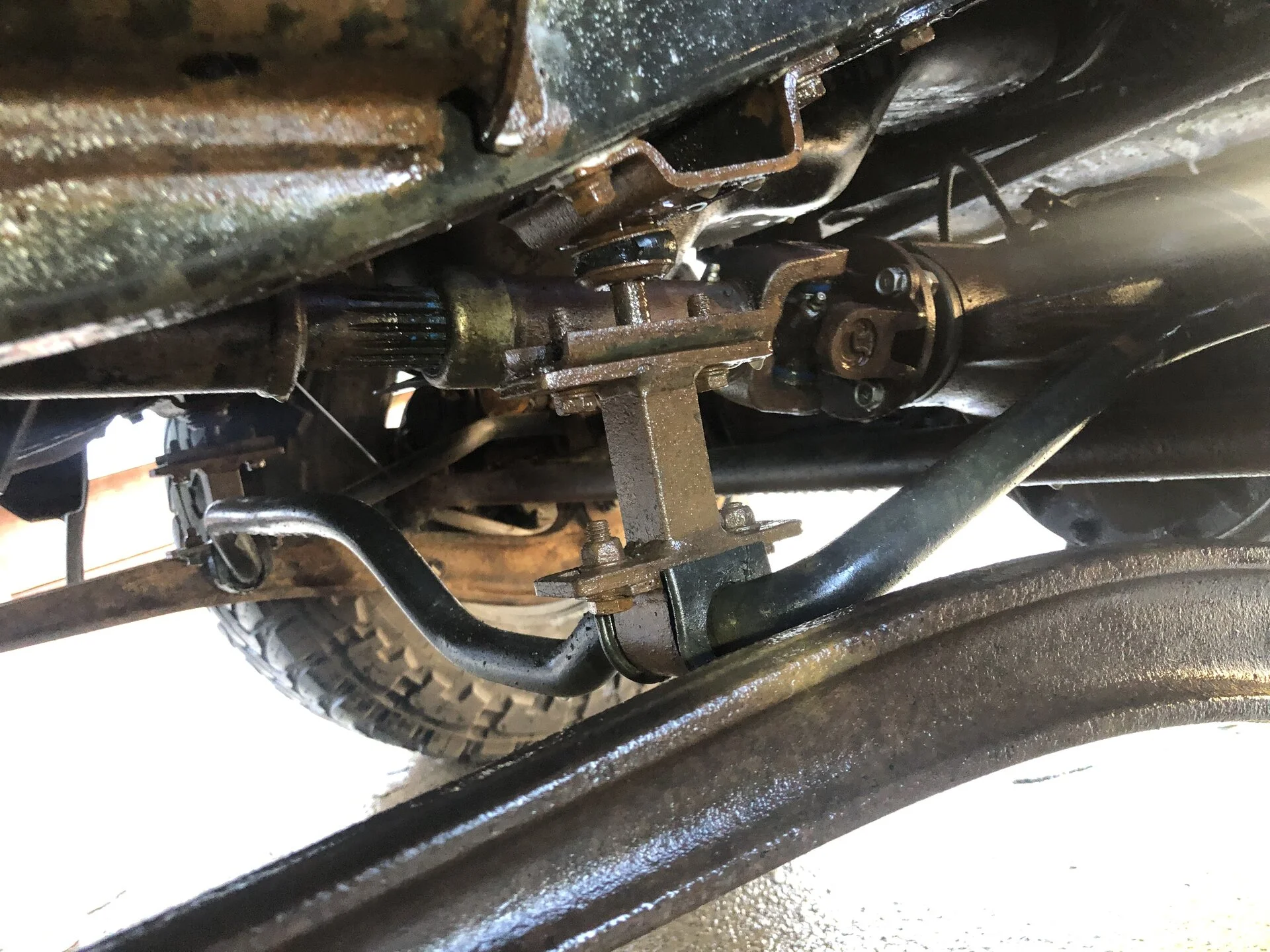

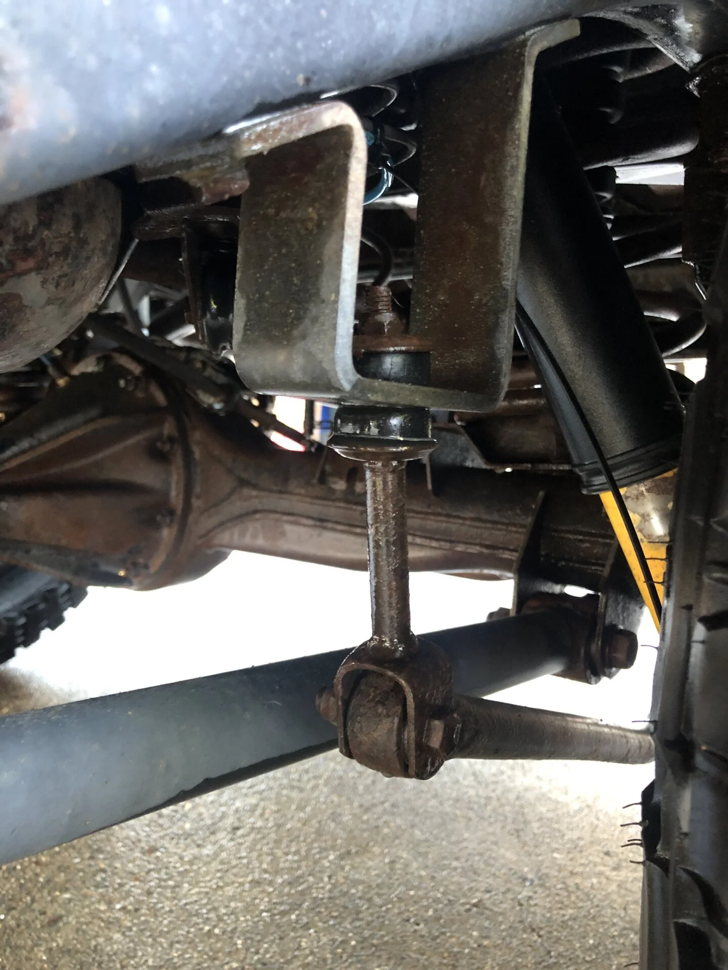

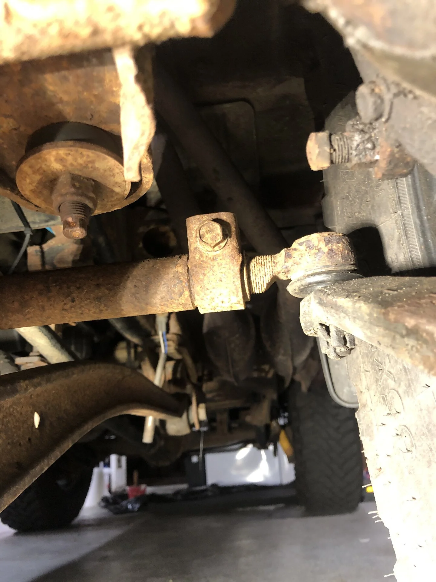

these look aftermarket to correct geometry, is that a fair assessment?
Yeah, as said they help say bars work properly with your lift.

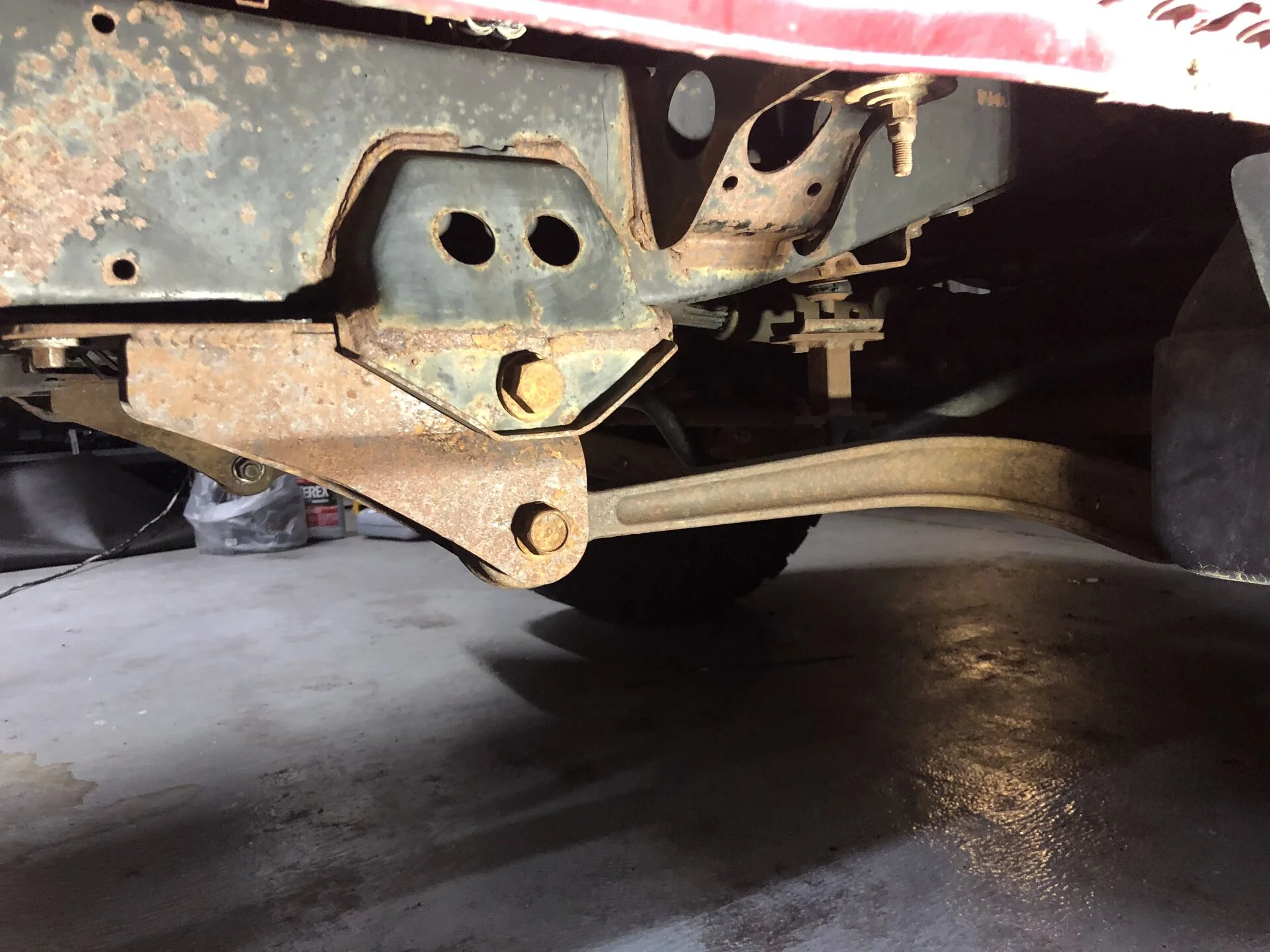

Can't see any caster correction in those pics. Take a pic of where the front radius arm connects to the chassis.
Hard to be sure, but the angle of the radius arm looks like there may be drop boxes to lower the connection point at the chassis and fix steering geometry
If you're right that is 3.5" of lift, if there's no caster correction been done you'll likely have negative caster and funky steering.
Also, I don't think your front driveshaft is a factory part. At least, the uni joints are not
