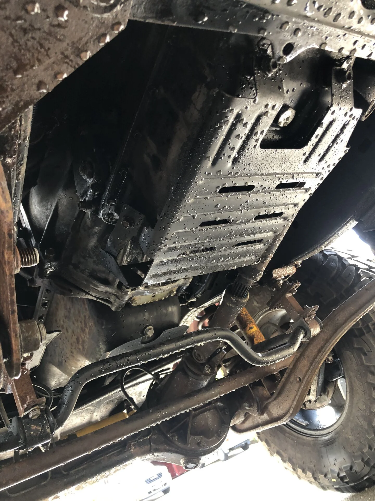

I just pressure washed 20 years of oil and grime away. Took 3 separate washings to come clean. Now I can get the PB Blaster so start soaking.
*edit - 4 pressure washes.

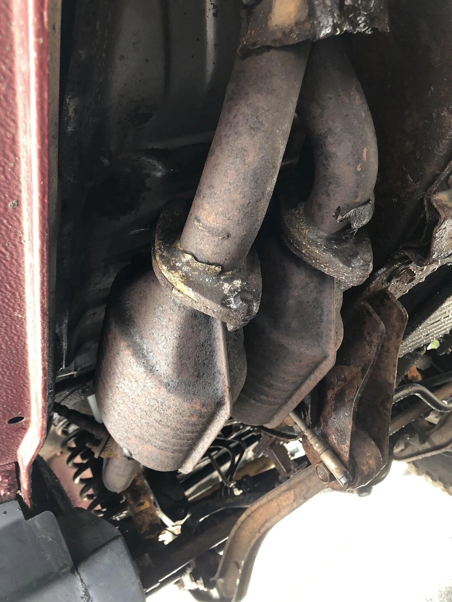

Will FJZ exhaust/cats bolt up to an FJ80? I need new exhaust from the down pipes back. Saw some local on craigslist.
Is the exhaust leaking? Or just ugly?
If not leaking, hold off.

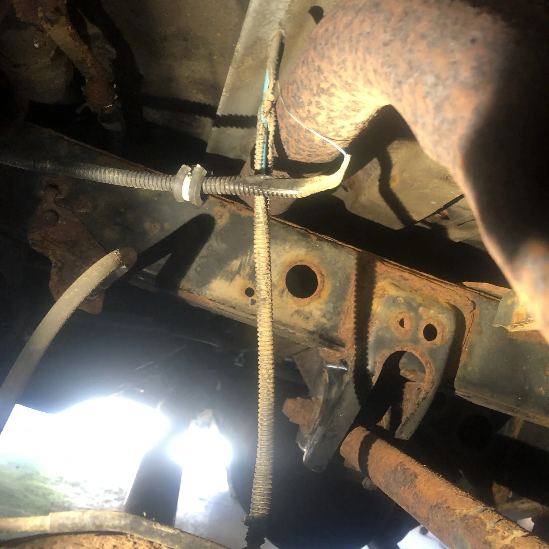

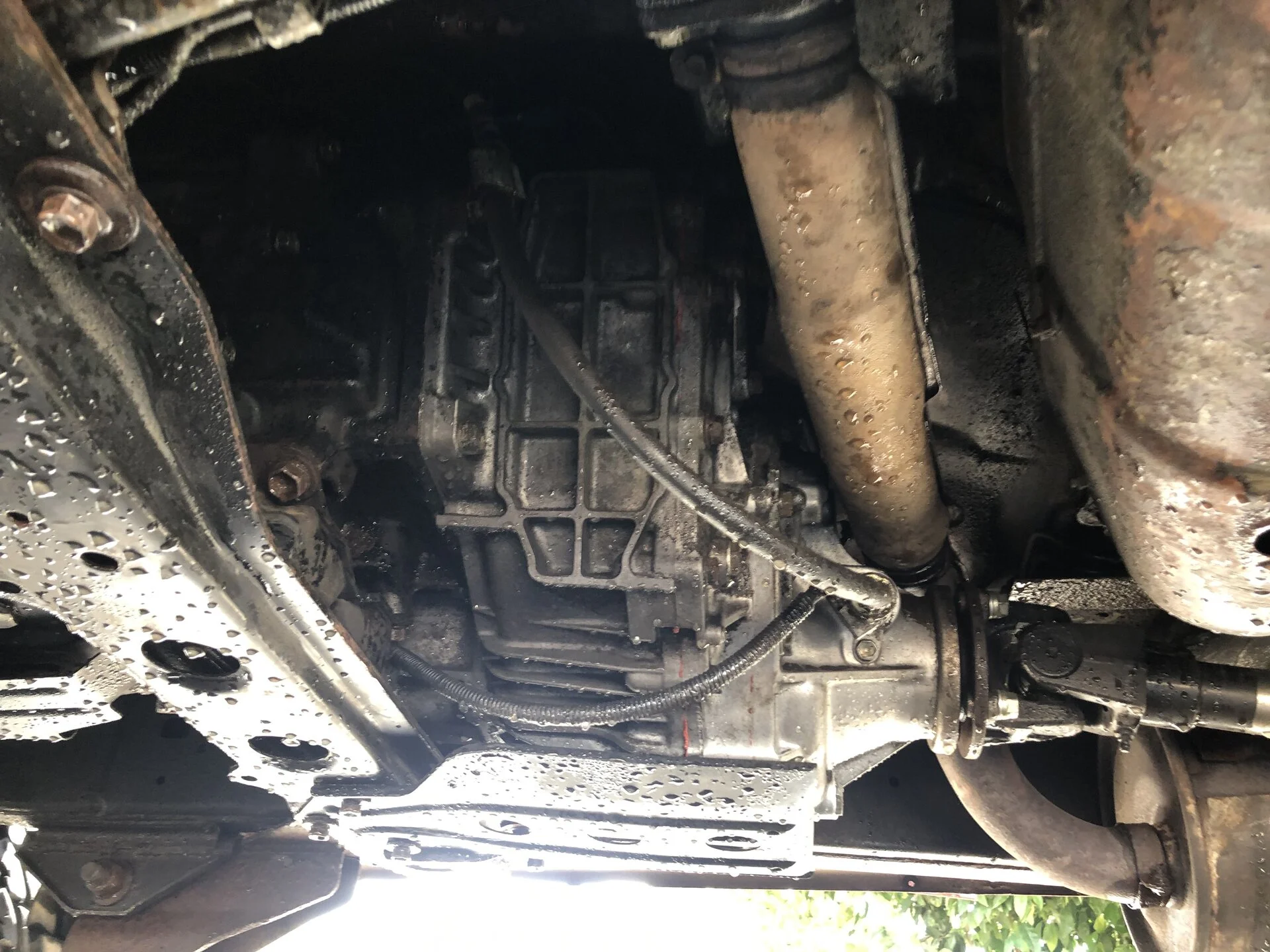

The exhaust is shot. Rusted out. Broken 02 sensors, rounded, frozen nuts, rotted hangers. I’m no stranger to modding. I’ve been known to go overboard on vehicles. Although, the plan here is to keep it as cheap as possible.

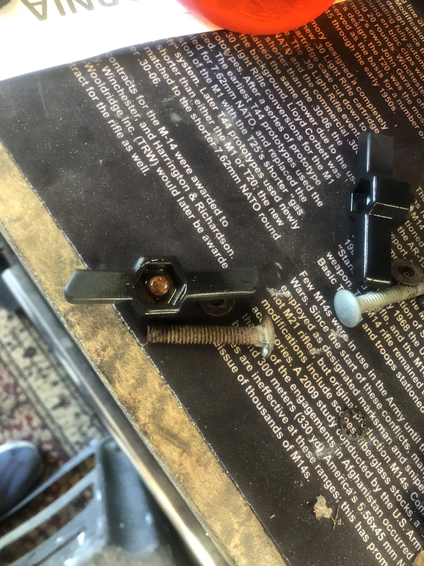

First frozen, sheared bolt. Just trying to get the ski rack off.

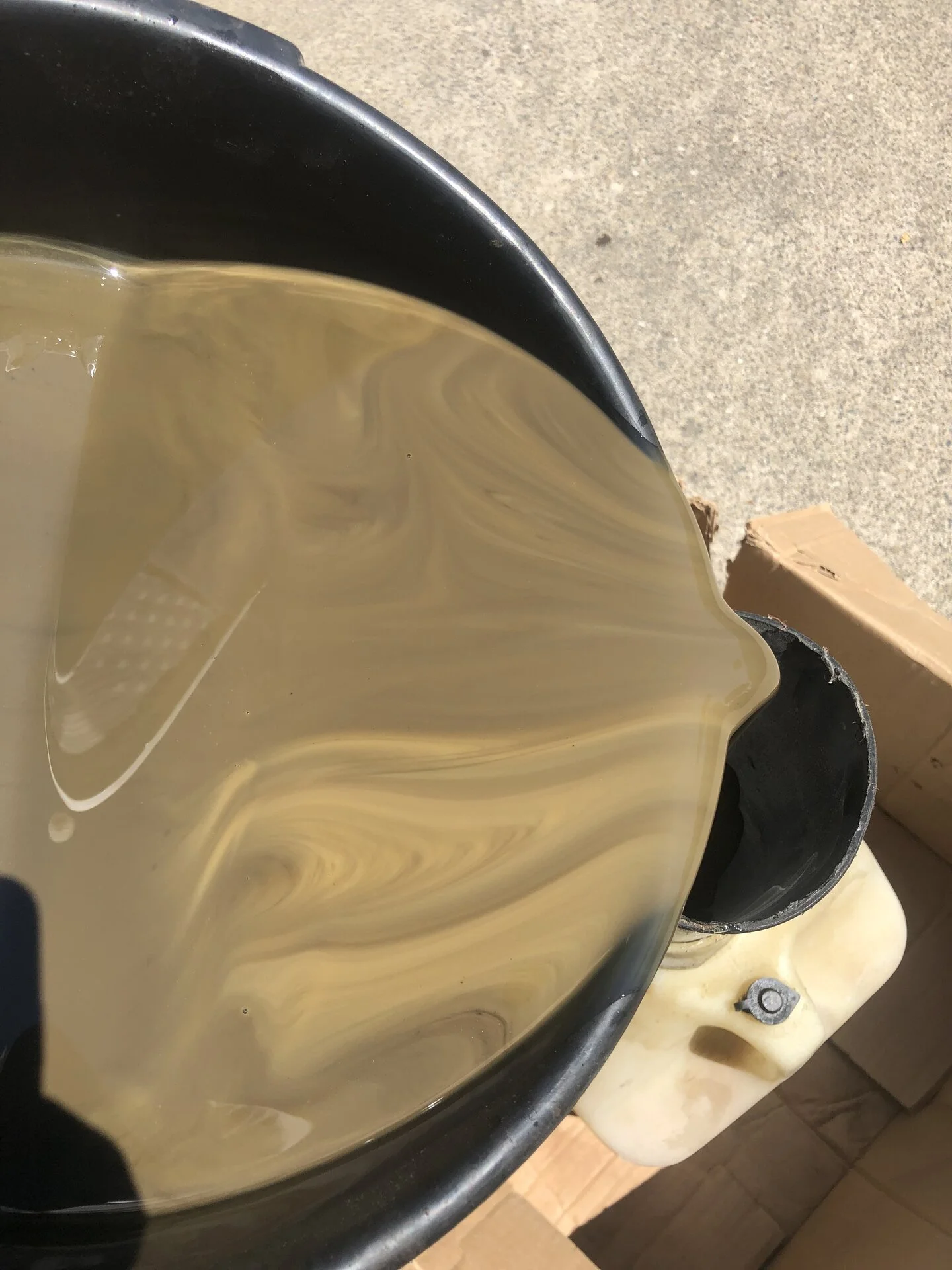

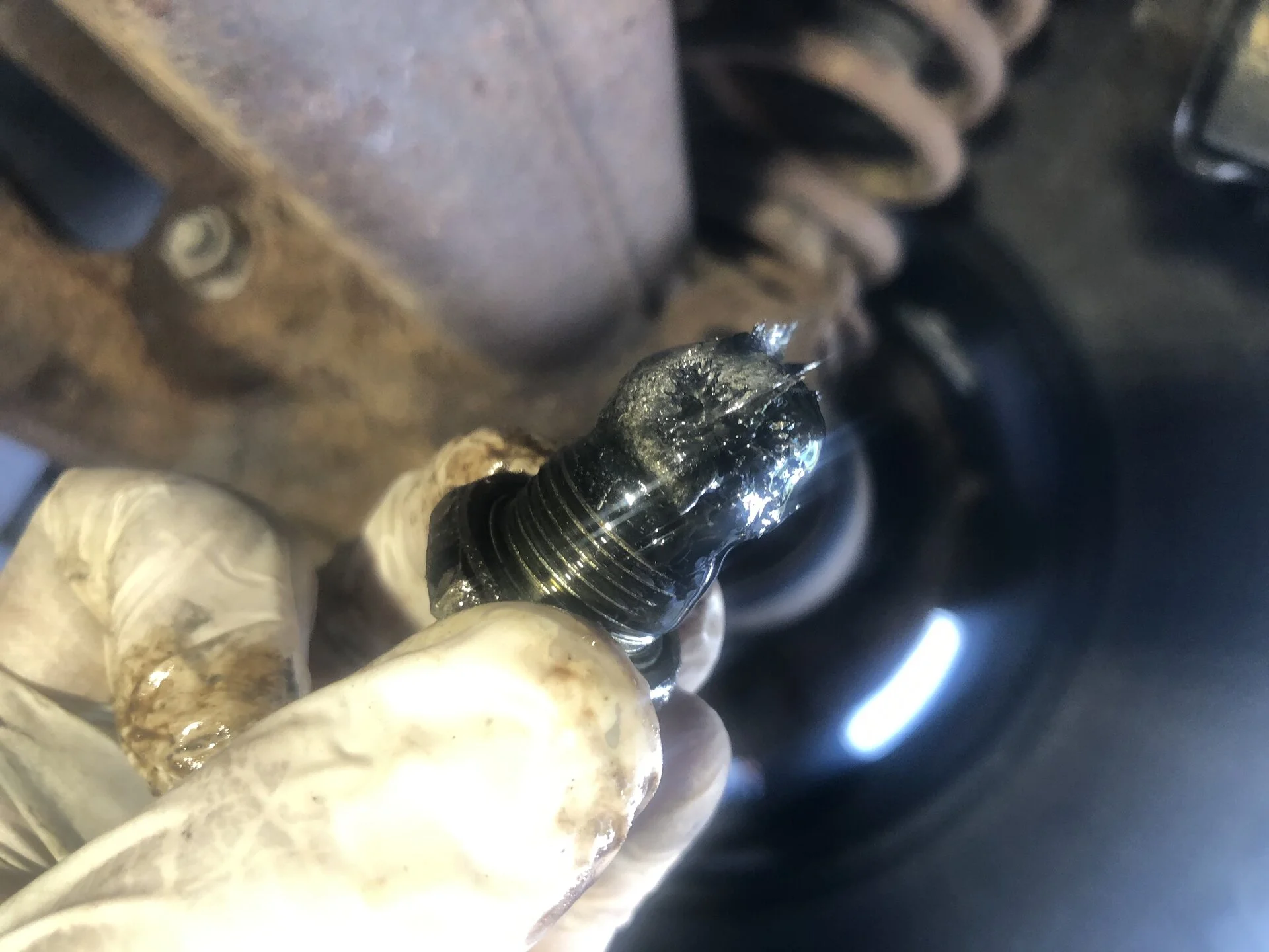

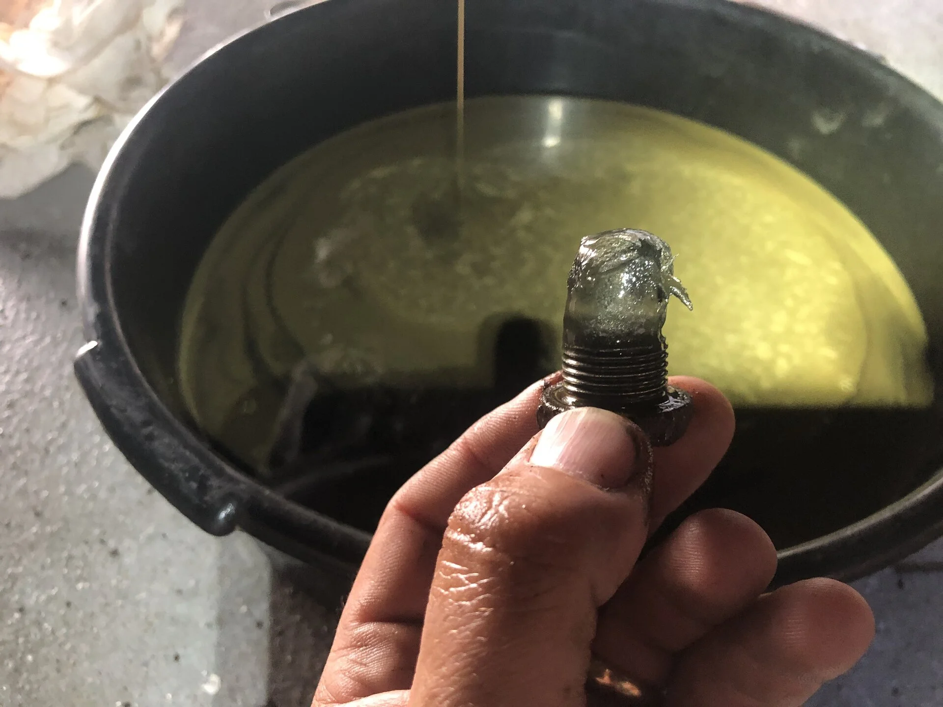

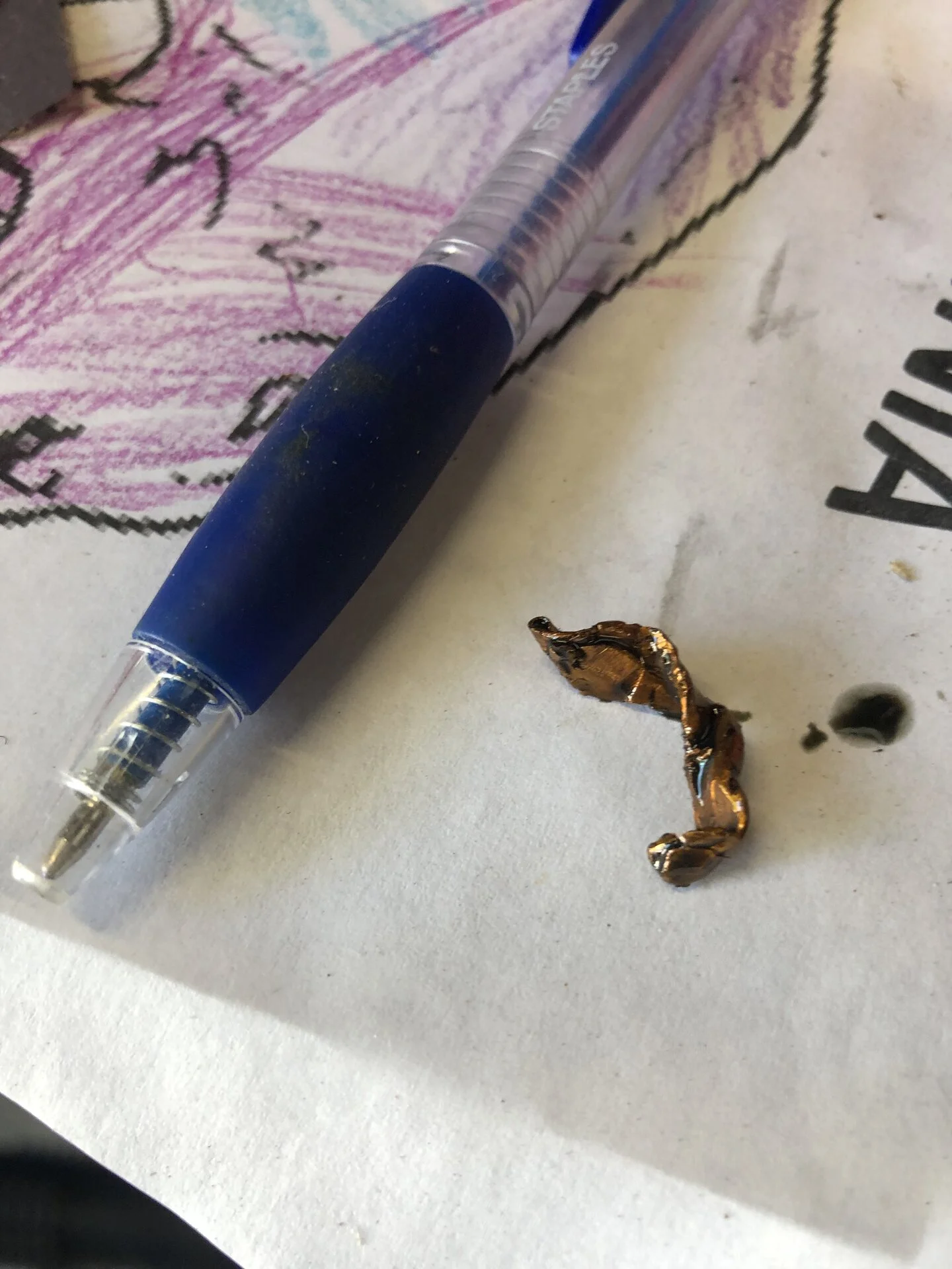

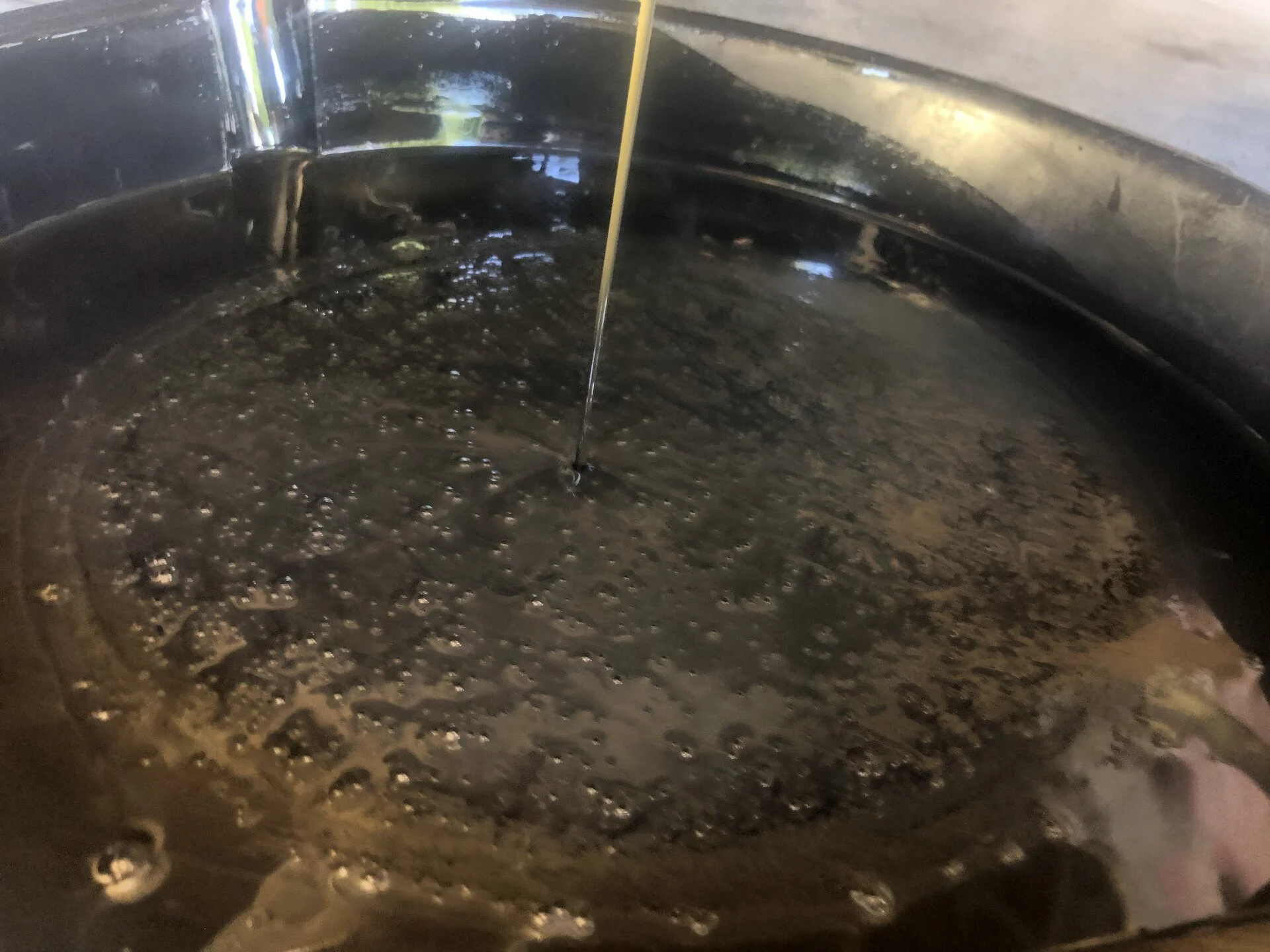

Front and rear differential oil replacement. That stuff was nasty! Milky in the rear, metallic in the front. One decent shaving came out of the front diff. Could that shaving be part of the arb air locker tubing set up?
Why? I’m not driving it. It won’t pass until I change the cats/exhaust anyways. I’m still trying to source out exhaust.
I would look at magnaflow they have bolt in cats for the later 80 series, but check the website they might have some for the earlier ones. Since it is a CA rig you have to get CA compliant cats, but with the tags still out of state you might get away with ordering Federal compliant cats and save you tons. The only way you can get the non California compliant ones is to have them shipped to family outside of CA and they forward them to you. IN NO WAY AM I TELLING YOU TO DO THIS.
