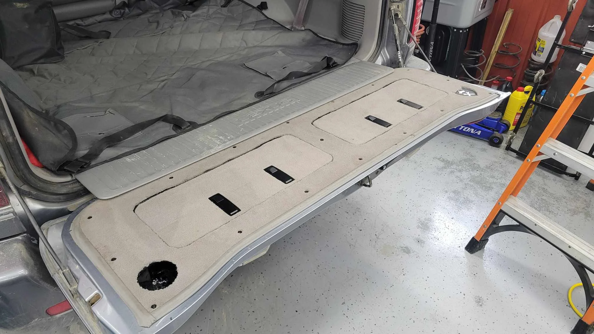

I have a 2006 TLC. Wondering about the double latch situation, is it much more hassle to open the covers with the double latch? i.e. take two hands etc. I wonder if there is a solution where it retains the single latch but is not centered on the panel. idk, just a thought.
Did you keep your tailgate lift assist spings/rods/torsion bar in place? Did you keep the center support in place? Would love to see a pic of the inside with the flaps opened

The latches are easily opened one handed. You don't need to hold one while you open the other or anything.
The only way to avoid the issue with the double latches would be to offset the latch from the center of the door, and for strength purposes they really should be centered/ even.

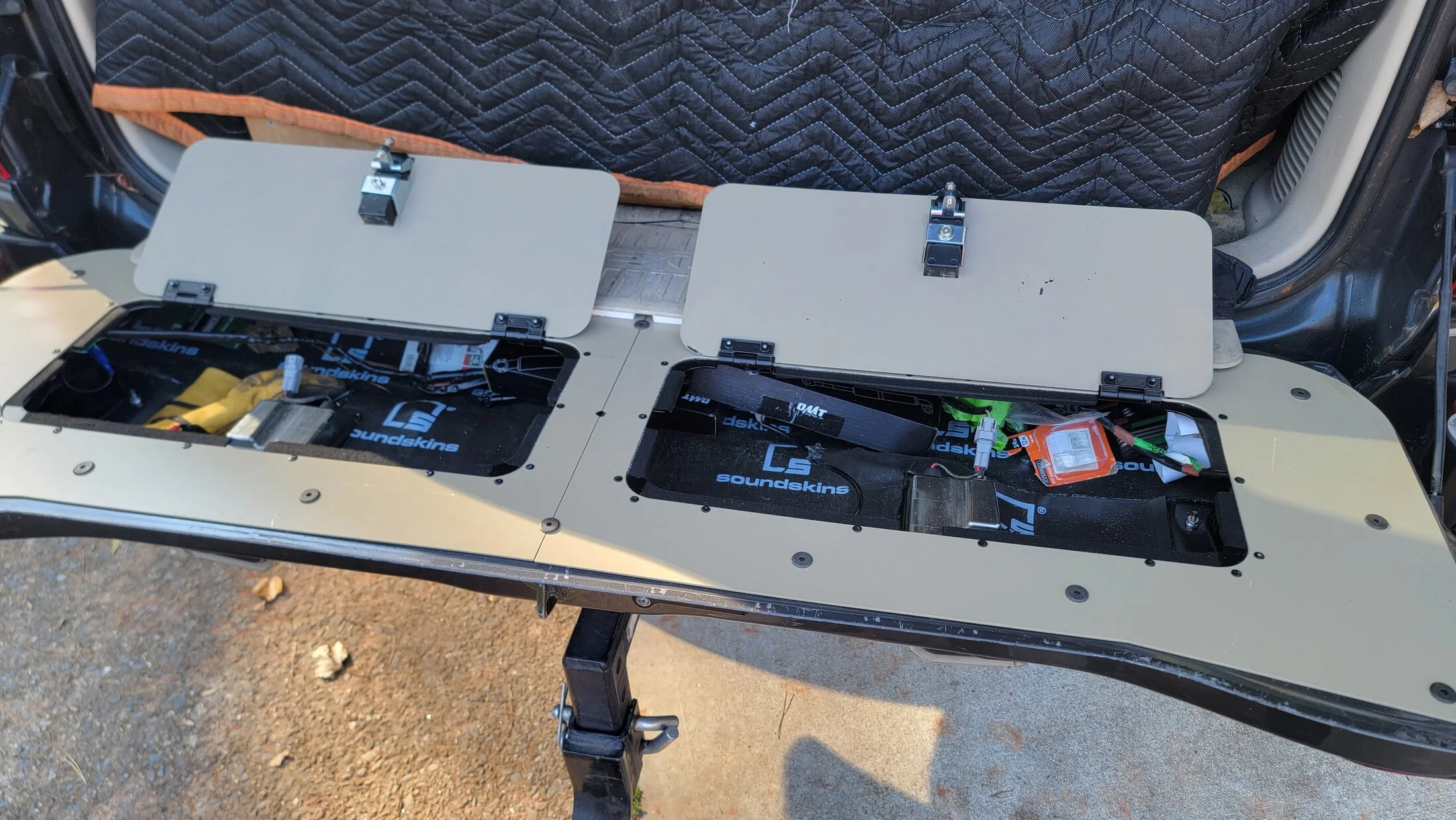

No progress on the lift assist unfortunately. Something I need to get back on. I have 2 of the lighter 14ga kits cut and ready to go but they're both the single latch design, which won't jive with your LC well. (If any LX owner wants them, I'd do a deal vs the original price to get them out of my garage as they're not the identical product I'm moving forward with.)

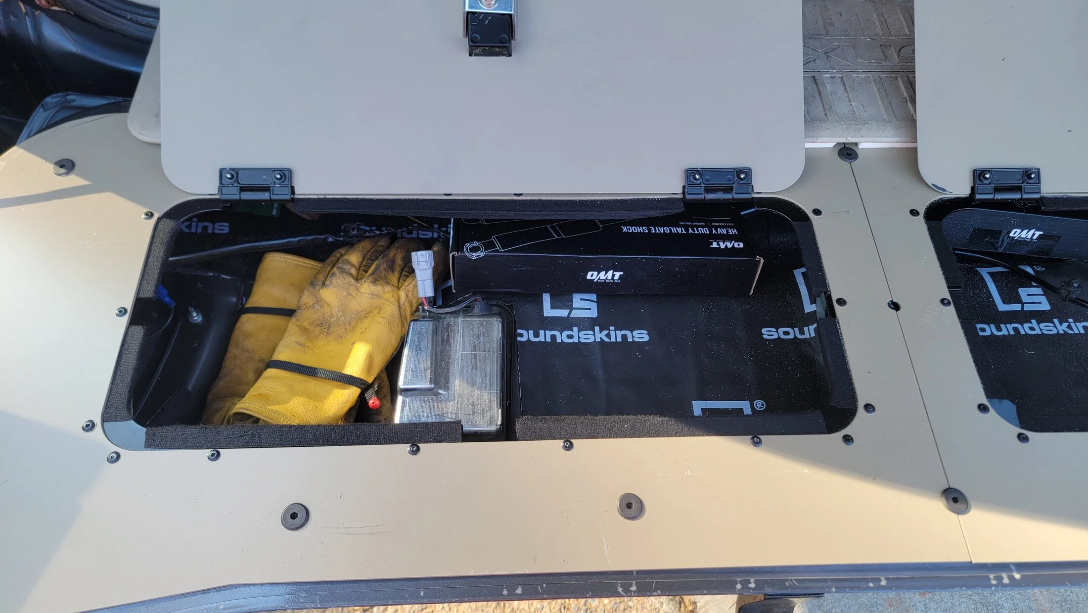

This is what I have for pictures of the interior. I can take some more from different angles if you'd like. The 2 latch design going forward is identical to the single latch, just with two per door instead.

@ShenValley100LC I installed mine last night and have the same issue .The furniture sliders they include are borderline comical. I'll think about what I can install under the flapper that is more of a permanent solution to gain clearance for the locks.
Other than that, I really like the kit. Shipped really fast from Texas and all the holes lined up perfectly.
As you can see in the 2nd photo. i kept those spring bars or whatever. Wondering if this helps with raising and lowering it? I have all my recovery gear in there and doesnt seem to be heavy at all.
I'm also planning on extending the tail light harness so I can run them up and out of the way completely. right now i dont have enough line to do that so they are still kind of in the way.

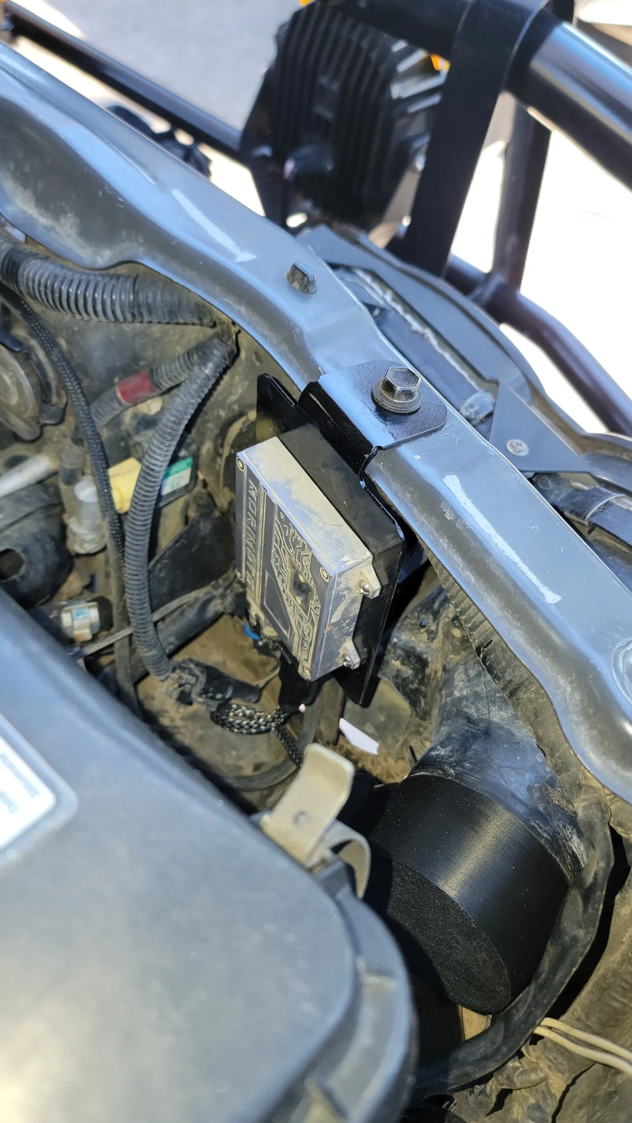

So Alex @LJE designed some really cool projector caps after he did a D2S retrofit. I'm currently selling them over at The Artisan Garage. I finally got some free time between other projects today to install them on my own truck.

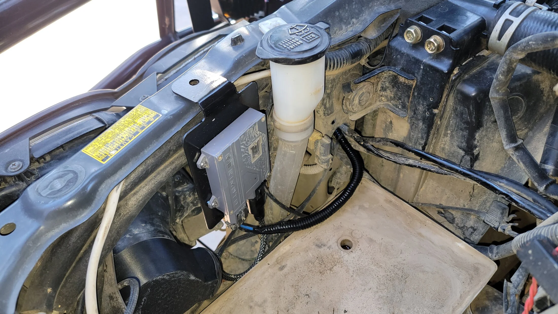

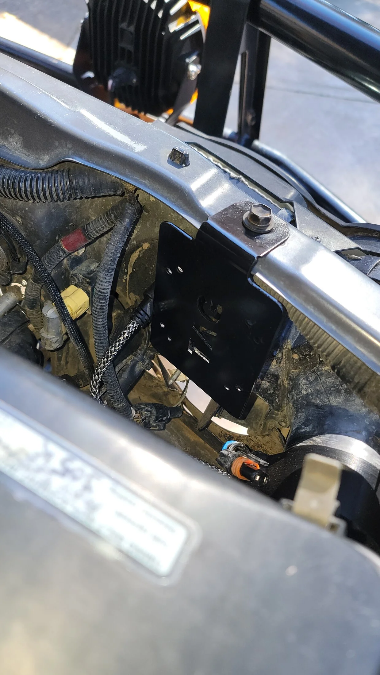

While at it, I was kind of shamed for just letting my ballasts flop around the engine bay, loose like sleeve of wizard. So I whipped up a little bracket that bolt to the radiator support and use factory threaded holes and bolts to install. DS installs under the forward end of the battery tie down, and I don't know what was originally mounted to the passenger side. I had nothing there, but I did have the OEM bolt sitting on a mag tray in the garage.
The bracket will come cut to allow users to mount their ballasts either vertically or horizontally. Currently just sized for Morimoto ballasts, but if there's another someone would like compatibility with, just let me know. Would be easy to make it happen. This will arrive on the website within a week or so. Cut from 14ga steel and bent to let the ballast sit comfortably beneath the top edge of the rad support. Sturdy and clean.
Since the driver's side ballast wiring was a little short, I added about 8" to it. First time I've successfully given 8" to anything. Job isn't done until you know it'll work, so here's the proof:
Those 3D printed caps are on the site now and made to be compatible with the rubber grommet that comes on your Morimoto igniters. I'd cut mine off previously, but was pleasantly surprised to find 2 new igniters with seals in my parts cabinet. Win!
