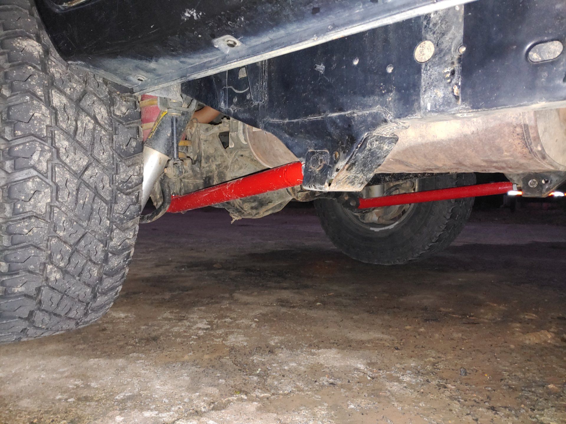

New adjustable RLCAs from TRAIL TAILOR arrived on Monday and I installed them today. They're pretty substantial pieces of metal, and the red color is pretty sweet.
No need to jack up the truck or remove the wheels. Front nuts are 22mm, rears are 24. Keep the grease zerks pointed up when installing. I do suggest adding a 90 degree zerk for the Johnny Joint. With my straight-tip grease gun, it's impossible to reach.
I noticed a tighter feel in the back end for sure. It could be psychosomatic, but I felt it leaned a little less in corners as well. Will be getting a pair of the RUCAs from Jason in the next few weeks. One thing I noticed- the tightness from the back definitely high lighted the looseness in the front. I know my lower control arm bushings and ball joints are not doing their jobs well anymore.
Up next (besides the RUCAs)... I need to get these new diff bushings in, and steering rack bushings. I'm still chasing a vibration coming from the front, only felt whel on the throttle above say 60-65 MPH. I've suspected the aftermarket CV on that side, but have no clicking. I also want to get those LCA bushings and BJs changed as I know they're ready.
