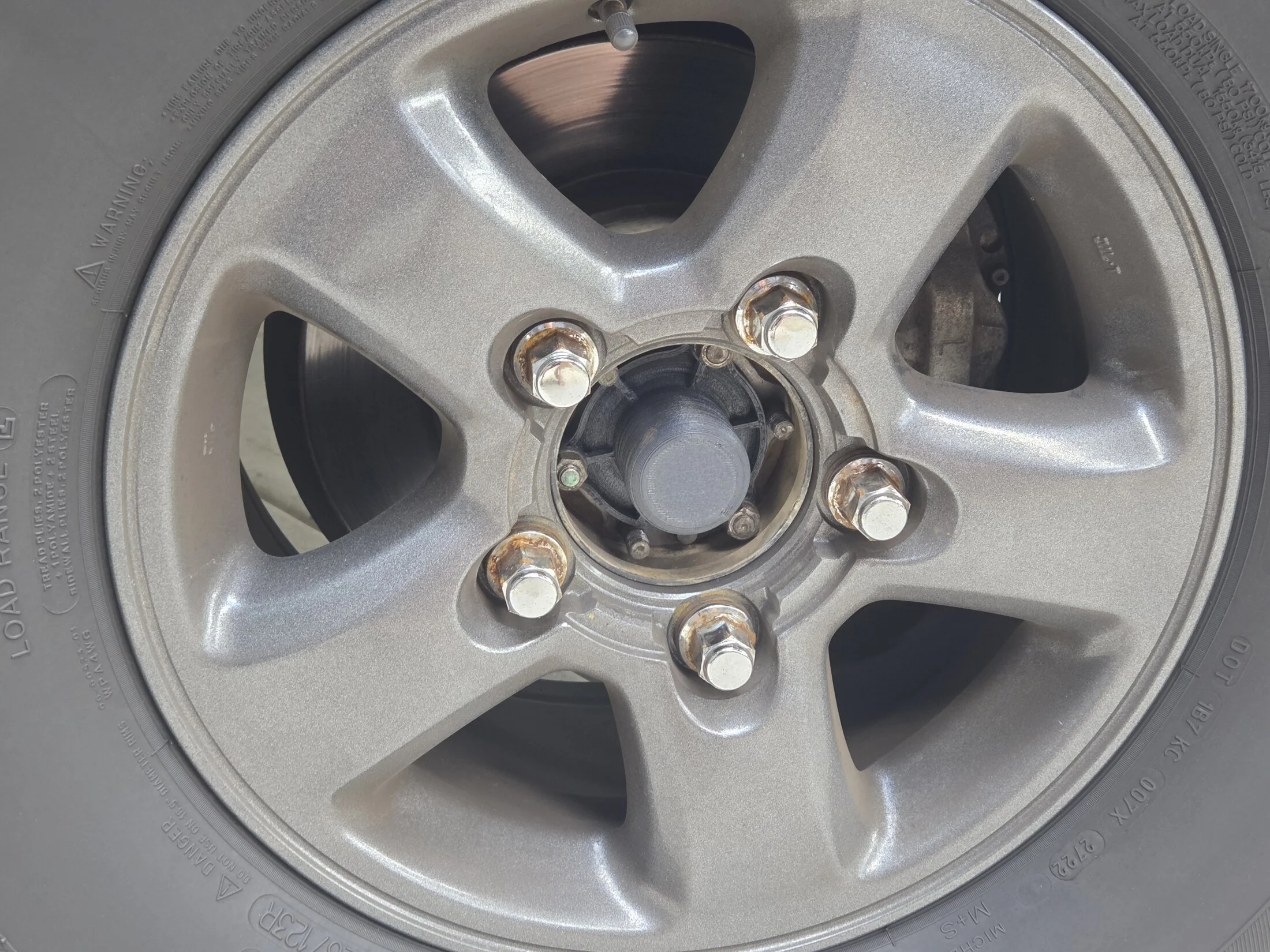

The other day I decided to isolate the diff by pulling off the front hub flanges. @LJE whipped me up a set of hub covers so I could run around like this for a little bit and feel it out.
I'm happy (happy? Am I?) to report that the truck feels much smoother with the diff isolated. This tells me there's something between the flanges that is causing this roughness, and it's something that spins while the flanges are attached, but not while they're removed. OK, so bearings and the actual gears inside. Cool, other than those being the pricey parts. CVs are relatively new OEM and have pretty much only road mileage on them. Wheel bearings feel very smooth. What does the hivemind think?

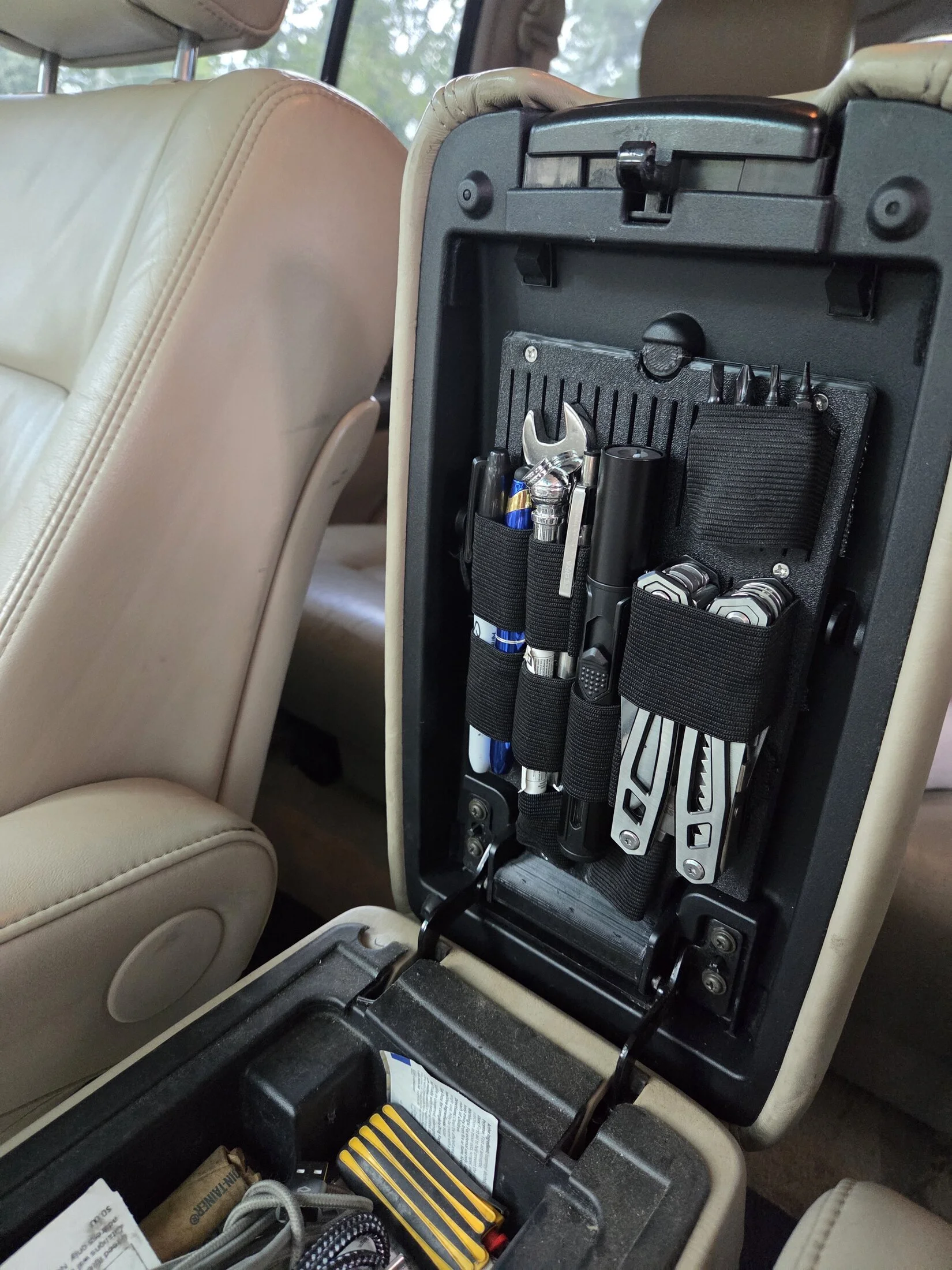

First up, the center console organizer from Alex @LJE . I may have bought the first one, but it's been tucked in a map pocket for a while. Decided to grab a few EDC items that I knew would be handy. Little multi-tool with some drive bits, torch lighter, sharpie, pen, and a flashlight (not pictured). This is a great accessory and if you don't have one, you should.

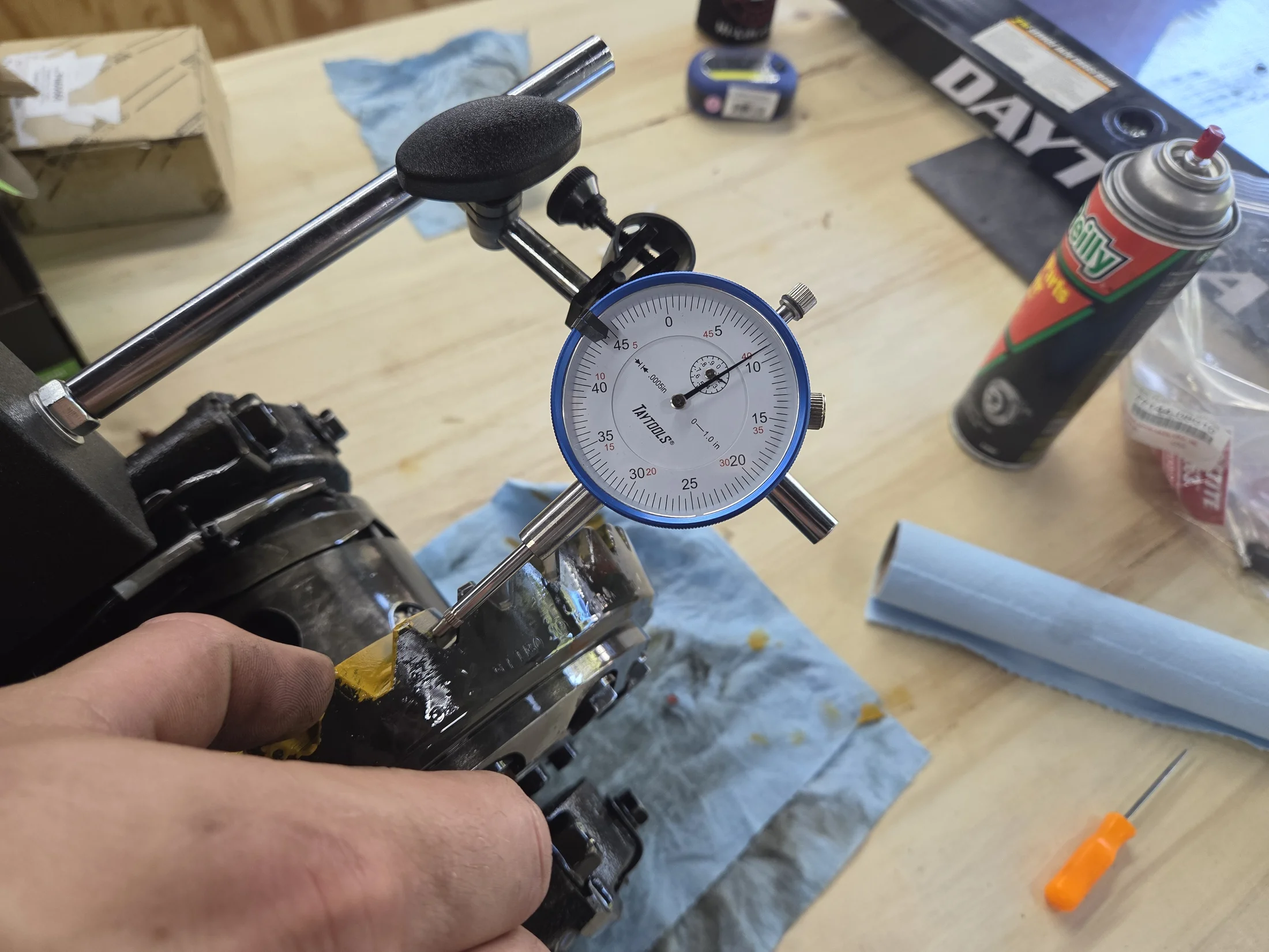

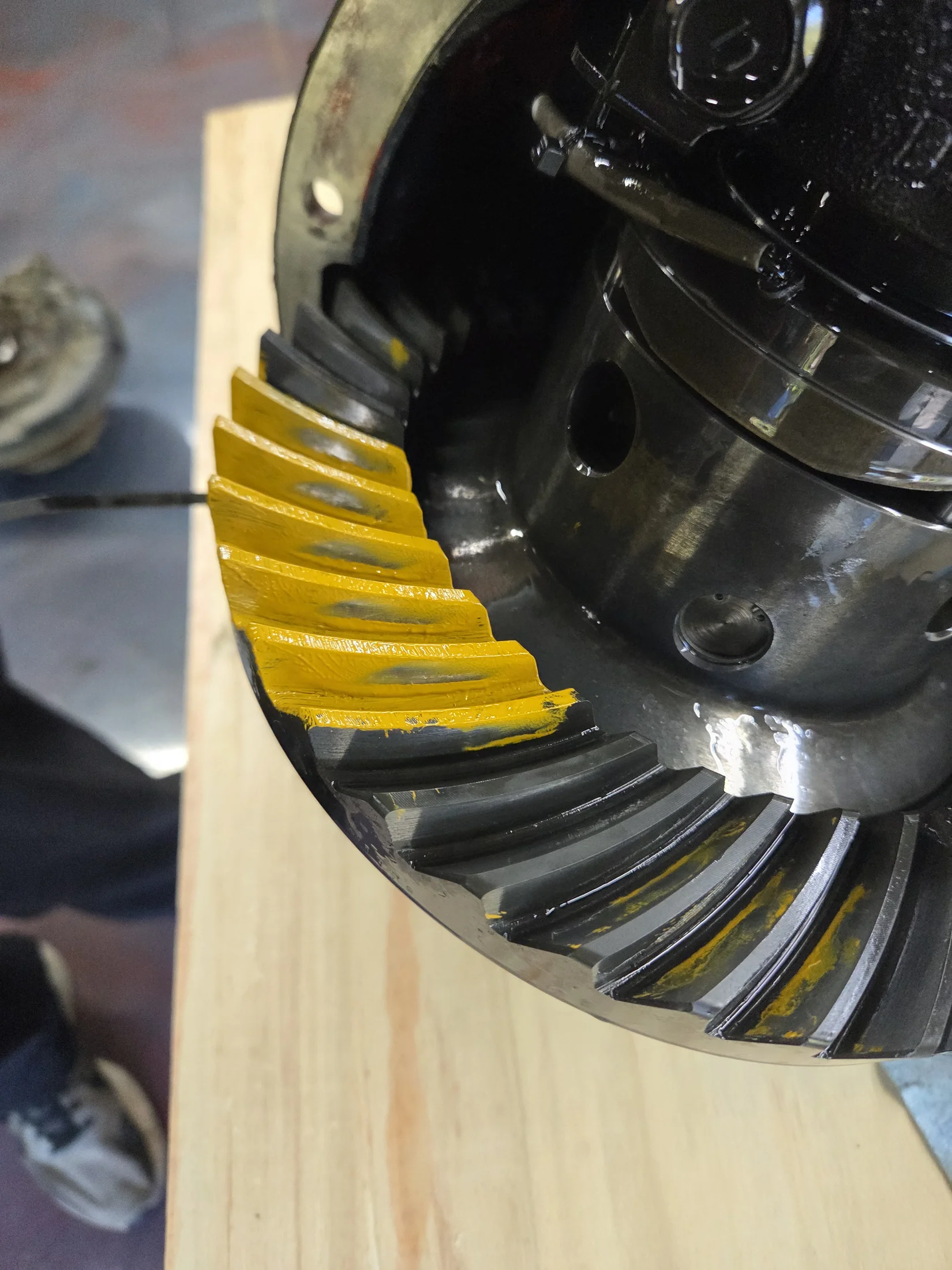

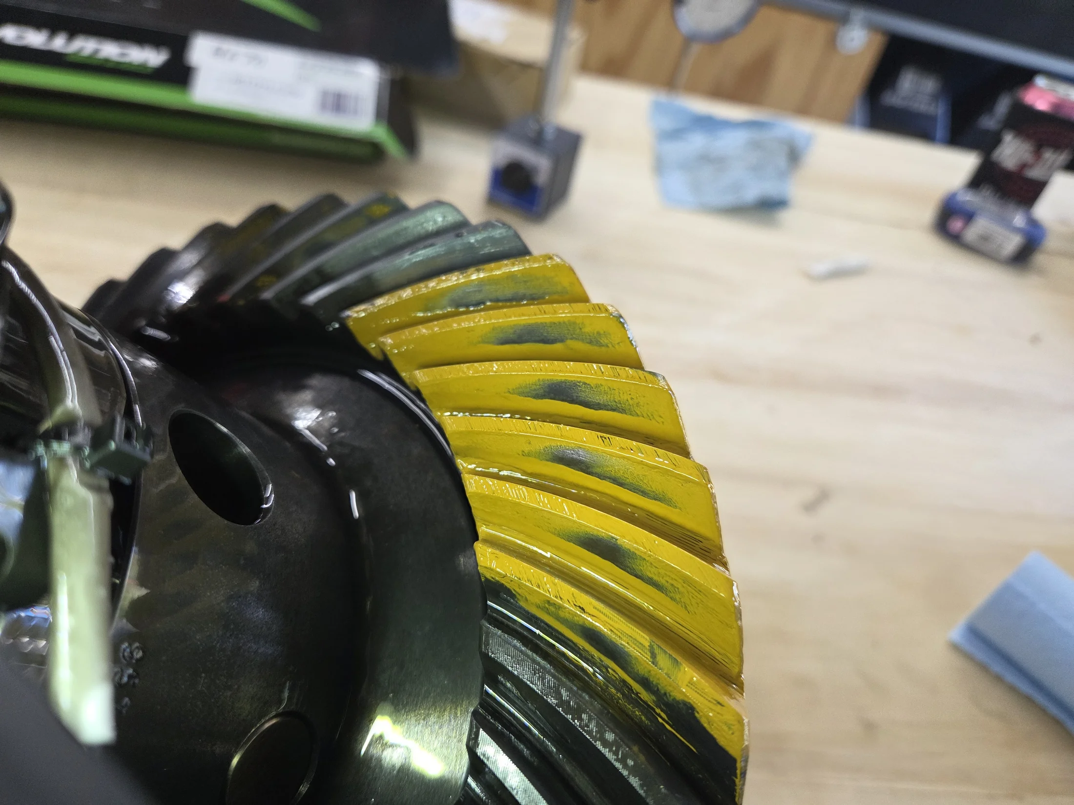

@Wermz came by today to help pull the rear diff and rebuild (if necessary). This set up is at 100k miles since install, fwiw. Pattern was not perfect but certainly not bad, backlash was measured at around 0.0085. Bearings felt pretty smooth when turning the pinion flange by hand. By all metrics we could come up with, the diff appears healthy. I've included pics of the pattern and the runout gauge.
So, diff looks to be in good shape. What else are we dealing with?

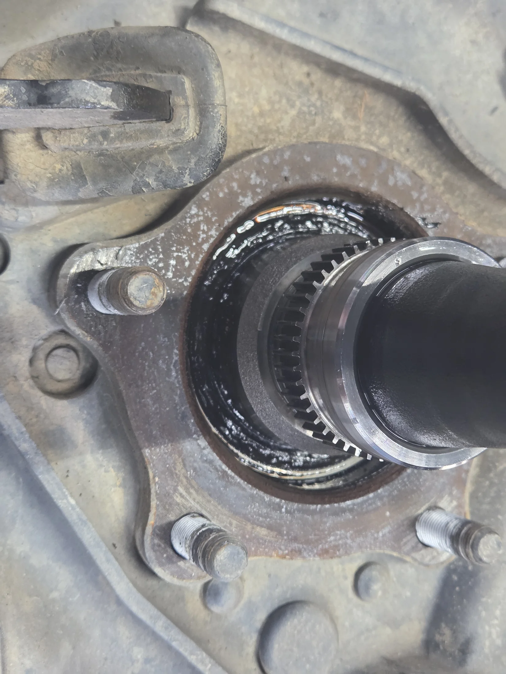

The passenger side bearing seemed to be pretty smoked. With the axle stand standing up right, the thing was so tight it wouldn't turn by hand. There was also some suspicious looking oil/grease on the back side of the bearing. Was this the issue?
Coincidentally my next door neighbor dropped by and took a look. He suggested maybe just the backing plate was rubbing, so we tested the theory and yup, he was right! Bearing spun smooth after giving the dust shield a few whacks with a rubber mallet.
