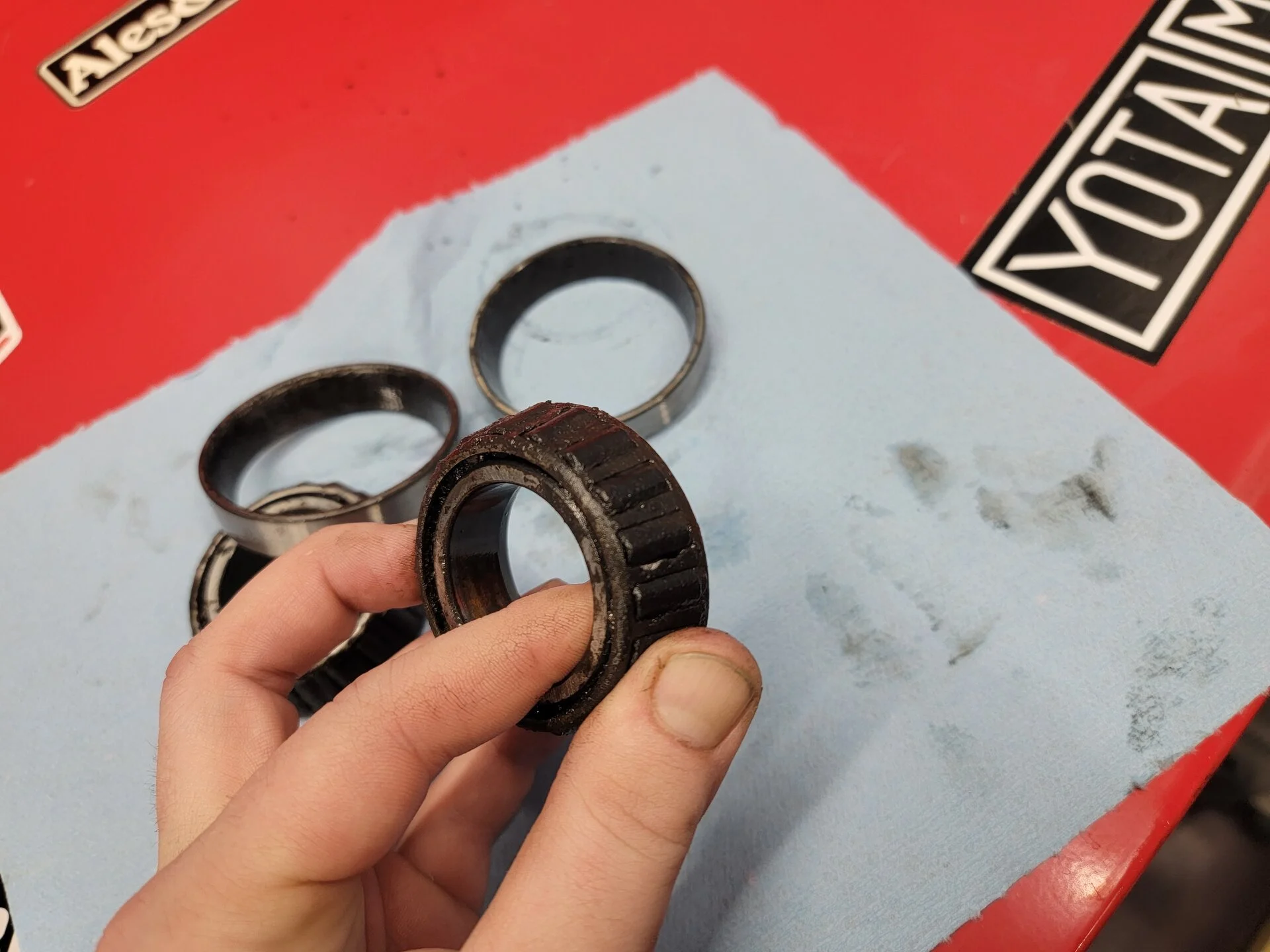

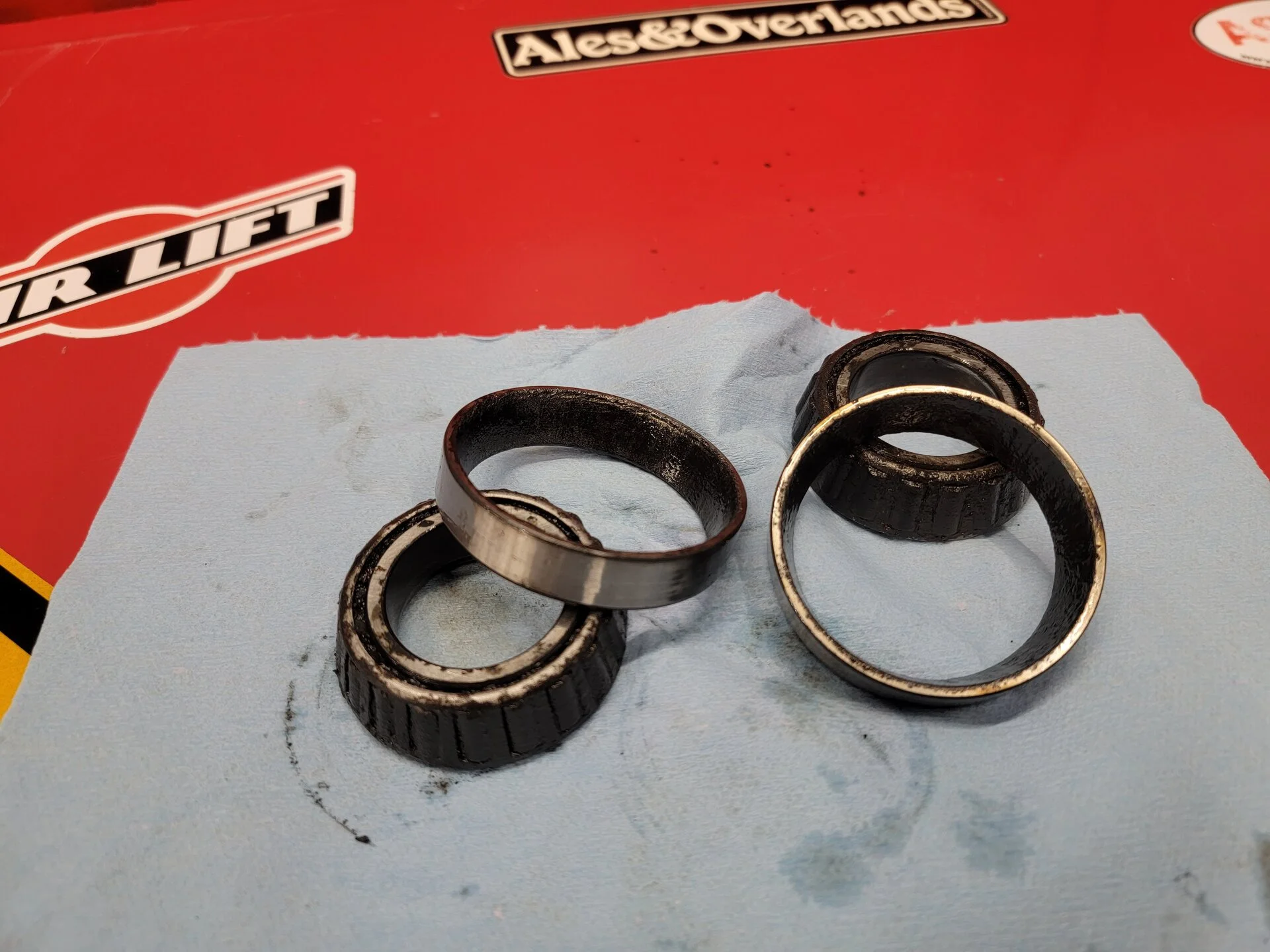

So for a while now, my spare tire swing out has been kind of loose, thuds in to the bumper when closing and sort of drops off the bumper when opening. Not great. Additionally, after some trail rides, I can't get the friggin latch open because the arm has shifted so much from the vibrations.
Well not any more.
Yesterday I opened the housing to see how it looked. Pretty gross. Pulled the nut and checked out the bearings. Holy s***, they're toast. No wonder it's acting the way it is. Even the bearing races were very corroded.
Yikes. The darkness isn't grease- these pieces all went through my parts washer. That's straight up corrosion 😳
The interior of their housing was pretty gunked up. Looks like the seal on bottom failed or I never had it installed properly to begin with. So new everything went in today and man is it satisfying. No more "thunk" then having to lift the tire up on to the bumper.
Worth noting: the nut that holds these pieces together was likely not torqued enough when I installed it. Today I set my Ridgid mid-torque impact gun to level 1 and with 2-3 uggaduggas, it's perfectly snug now with no play and smooth operation.

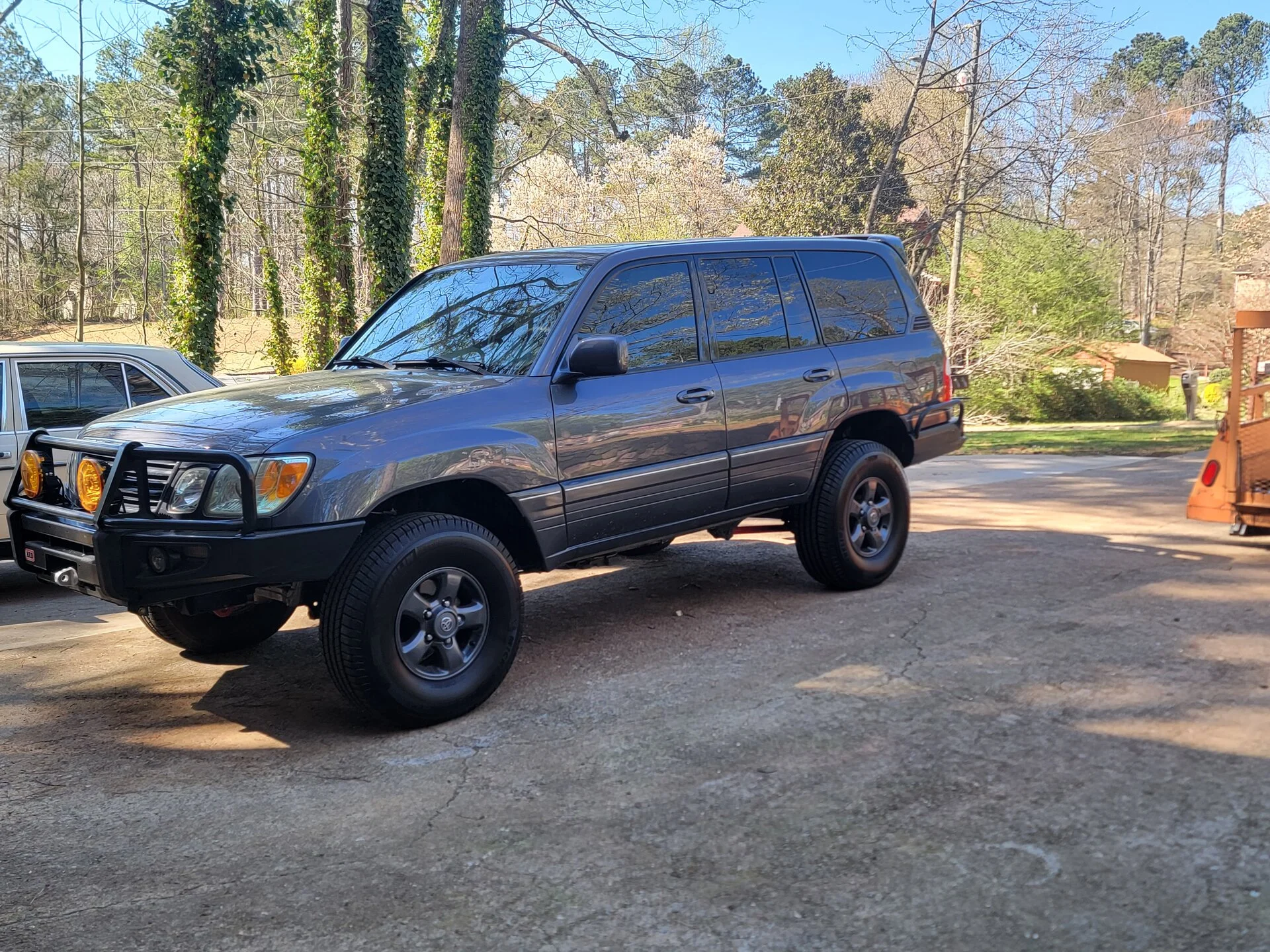

She got the first real bath since COTR yesterday. I forgot what color it was supposed to be. I've also stripped the armor from the truck for cleaning and maintenance. Looks kinda silly now.
Lookin' good! See you around Atlanta (again, lol). I probably should also inspect the spindles on my rear bumper. I have a little chatter from the rear, but I believe it's the safety pins rattling over speed bumps.

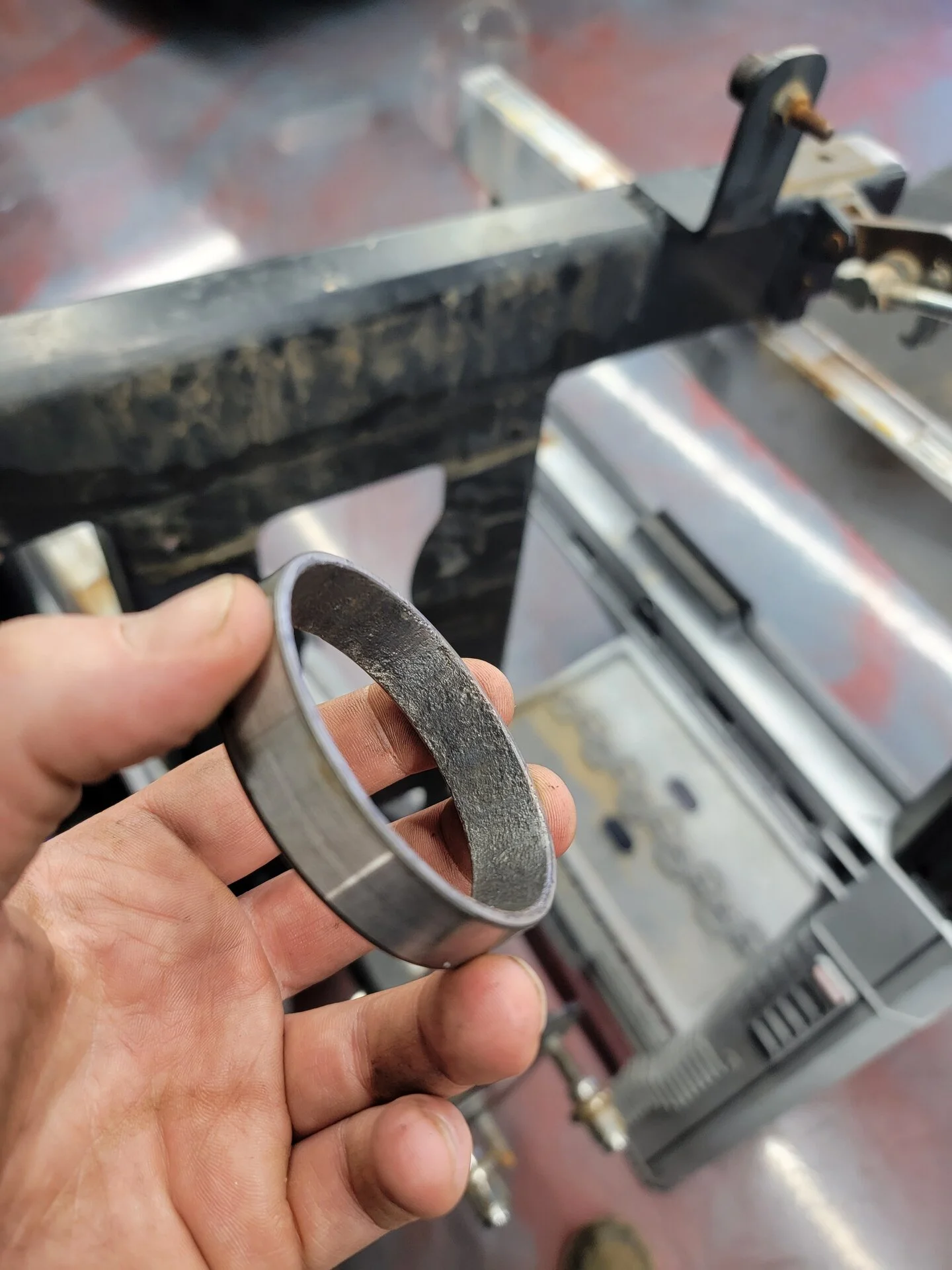

My dissent has gone through two sets of bearings. They actually snapped the thin metal on the top of the roller bearing. This last round seems to be holding up and I added some spacers to lift the arm up which helped with the interference.
Now I try not to use the arms unless I have to get into the back.

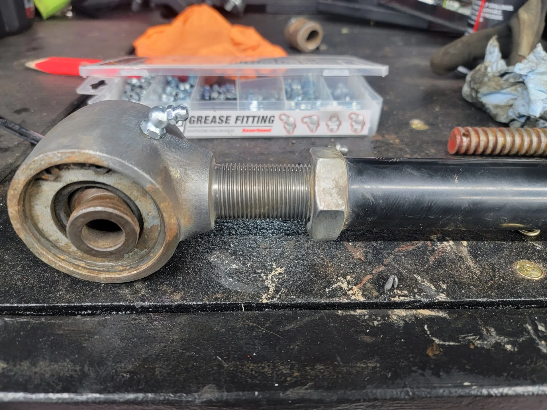

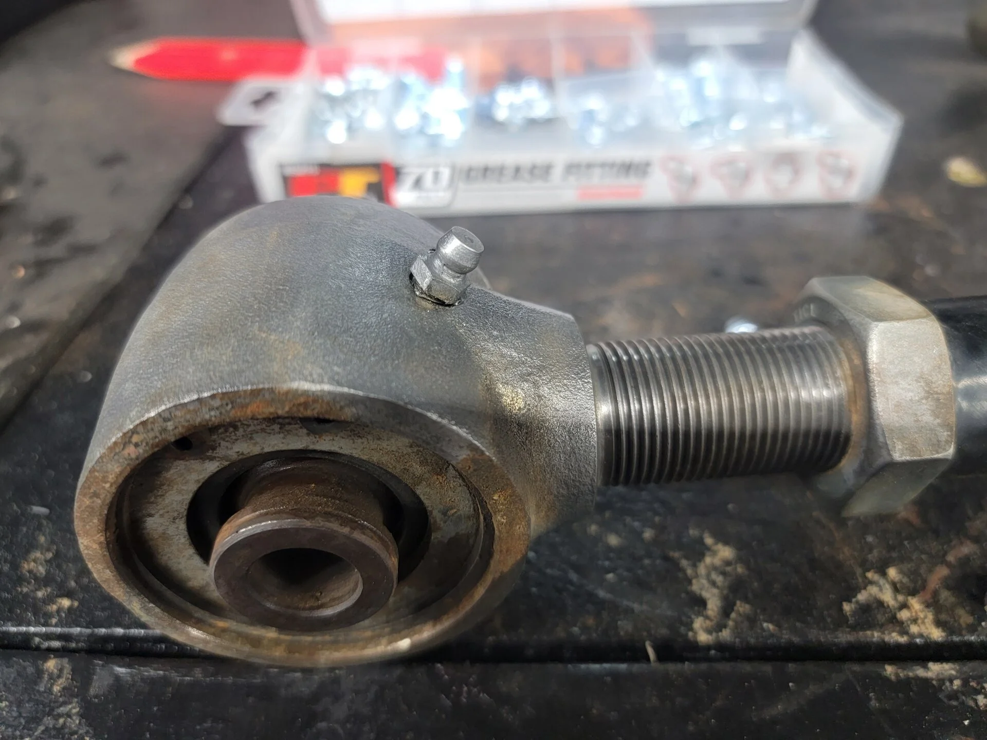

The other day I pulled all of my rear control arms to service them. Because of their location in the housings/mounts, getting my grease gun on some of the zerks has been nearly impossible. The result: my truck has horrendous squeaks. So the move was to ditch the existing 90* zerks and replace with some angled ones. I also cleaned them arms and joints up before going back on to the truck.
I bought a LocknLube coupler for my grease gun as well. Way easier to get it firmly on and easily off the zerks.

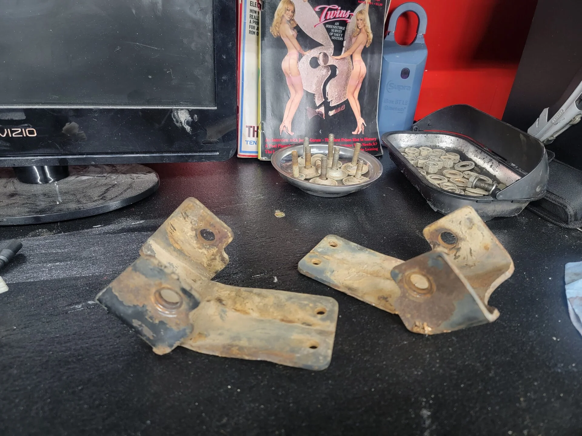

While I was down there, I went ahead and removed these LCA 'skids' that have been on for a while. They worked for a while, but then they didn't. Ultimately I will build a plate steel surround for that mount, and weld a slider bar diagonally up to the frame.
