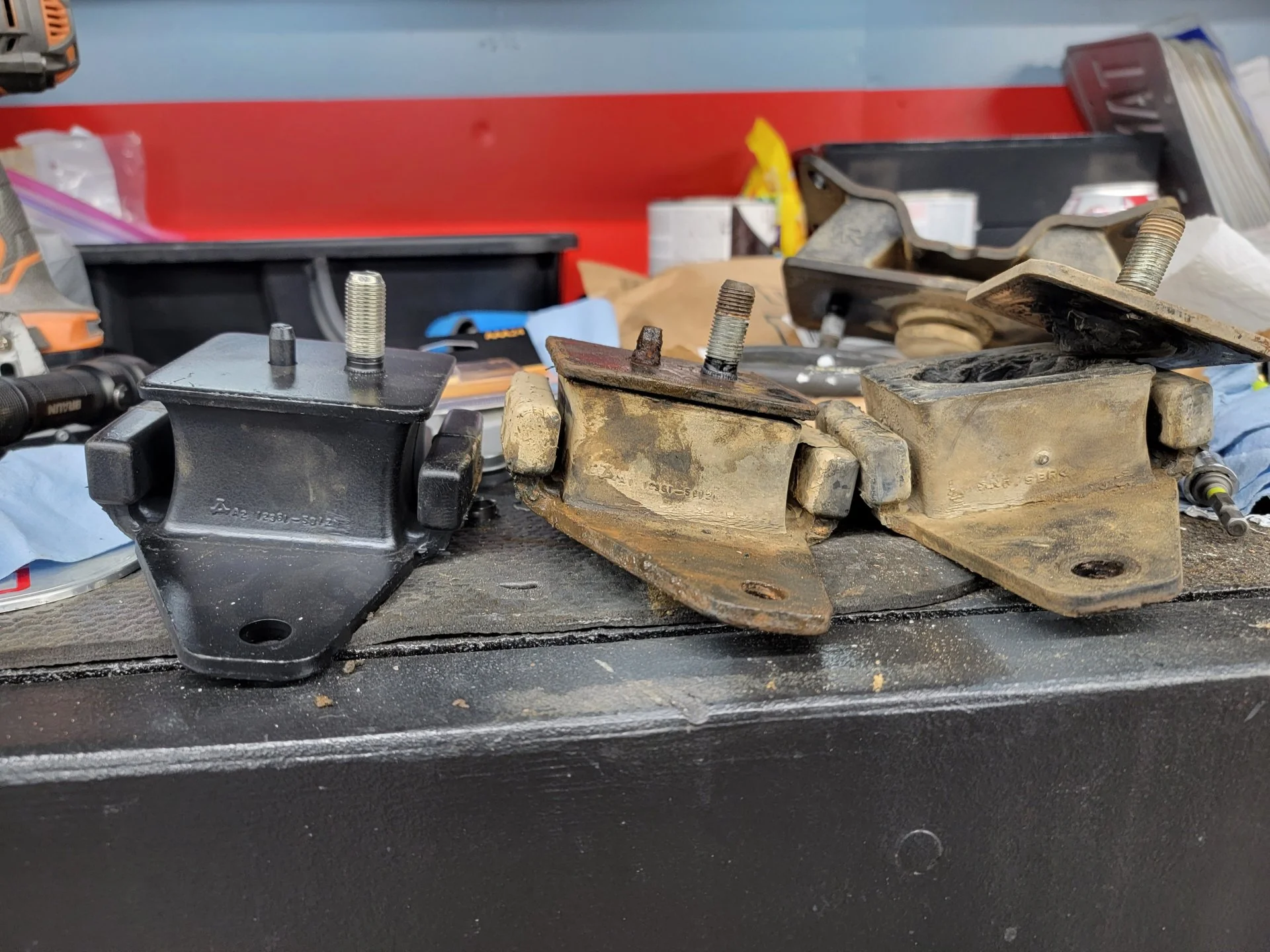

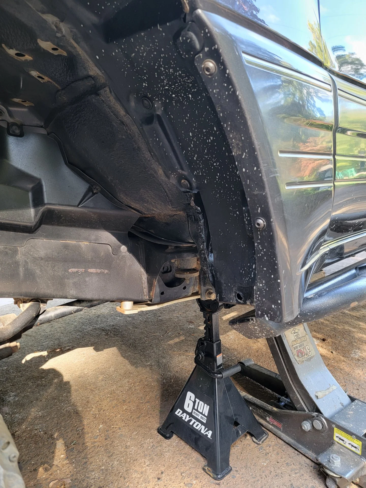

Did my engine and transmission mounts today. Easy enough job. Took me 2 hours including the time to swap vehicles in the garage, do the damn thing, and clean up. I think if you have shorter arms it would be nice to remove the front wheels, but I just pulled the small fender trims to prep. Didn't lift the truck up or anything.
I found it was easiest to set my tools on the nuts/ bolts from the side (through the wheel well) and then actually do the work from beneath. This allowed me to hold the nut(s) from below and use my socket with my arm wrapped around the frame. If you do it, you'll figure it out. Support each unit with a jack while you're working on them. I did disconnect my fan shroud and pulled its lower feet out of their home at the bottom.

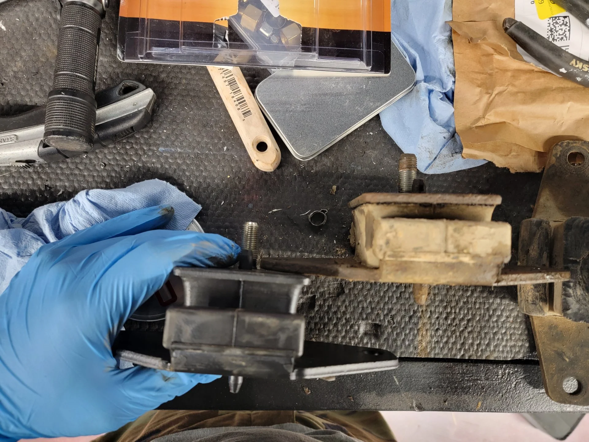

My trans mount came out looking pretty decent. One of the engine mounts had broken, and the other looked OK but was compressed compared to the new one. I notice a more solid feel from the engine at start up, but actually feel more through the throttle now than before. 🤷
Mileage is right at 313k.

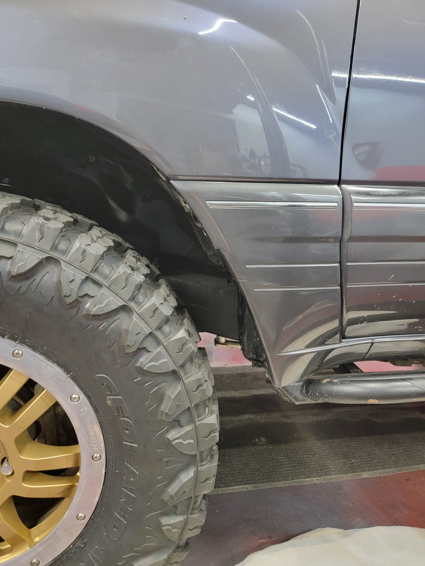

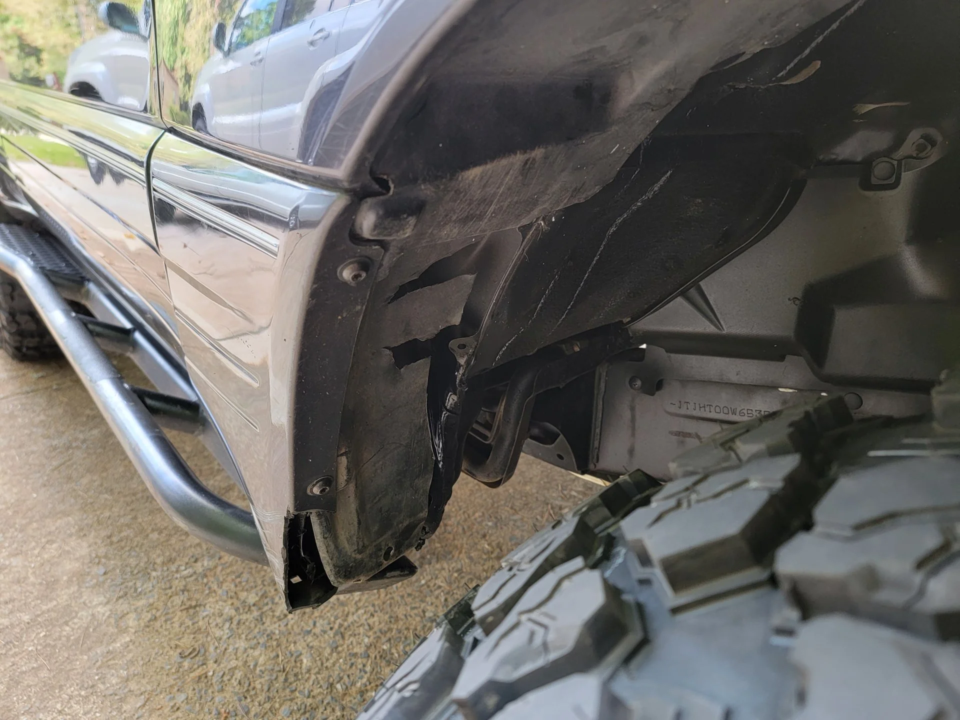

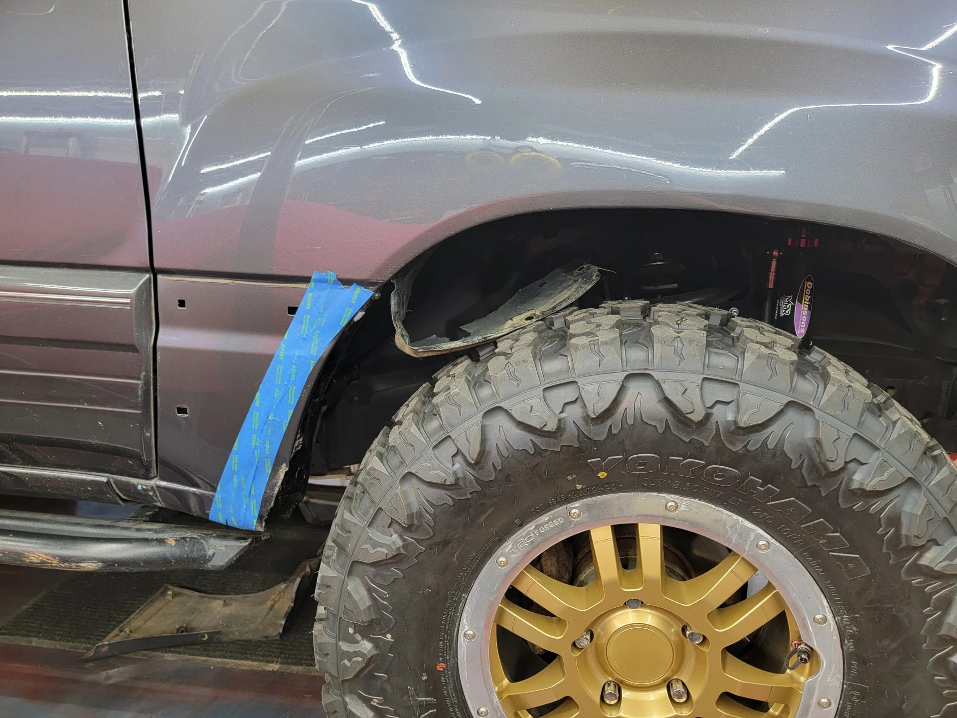

I've been fiddling with these 35s to get them on without any major rubbing. I'd done the pinch weld mod previously, but not sufficiently for these tires.

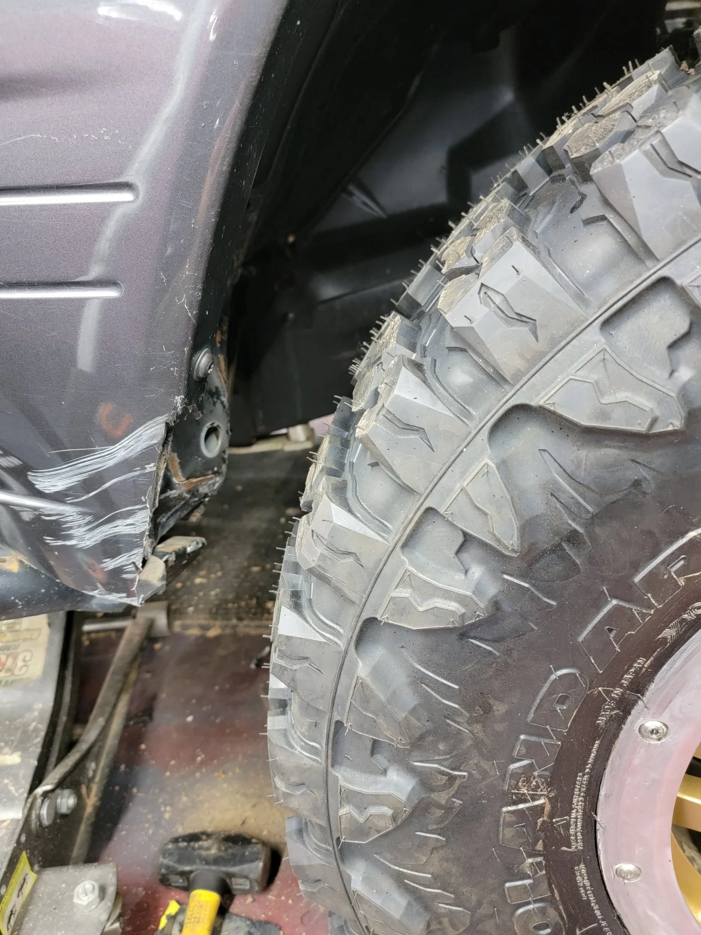

So out came the angle grinder and BFH. I did the PS yesterday, the DS just now.
Due to some existing trail rash, getting the PS done cleanly was difficult. I'm not proud of it, but I ended up cutting the plastic cladding more than I should have. (WTB, BTW). But, with some black rustoleum and the fender liner replaced, it isn't immediately s***ty looking. DS turned out much cleaner.
So far there's no rubbing on the road. This includes little dips going in to parking lots or my driveway. I still need to stuff em up to be sure they won't yank a fenderb off on a trail.
This was mainly a time sensitive thing to be ready for COTR in a few weeks. I'll see about cleaning this up with a more comprehensive solution in the future. That'll require body work, though. If anyone has a PS fender liner in good shape, I'll happily buy it from you.

I also cleaned up the fender trimming some. @Wermz came over yesterday to supervise. I ended up taping a lineasnd then cutting the existing lip on this section of fender. I cut up to but left the upper bracket that ties the outer fender to the inner. This gives me good rigidity still. Then I bent a new lip following the line I'd made, and cut/heated/formed the cladding around the corner to finish it off. It's not a factory job for sure, but I'm much happier with it now than after the last attempt. And, no rubbing! And no more @YezusLX giving me grief for ugliness!

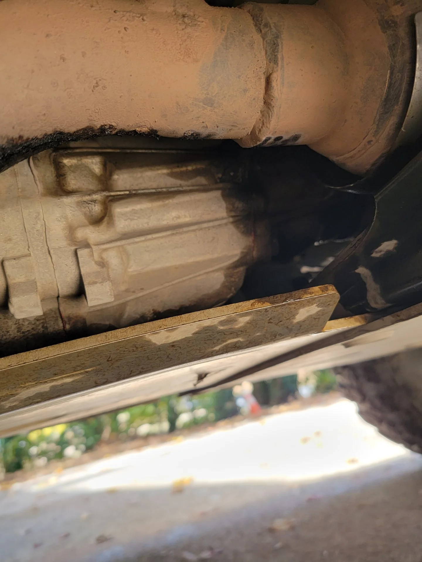

I came home to a drippy transfer case, so I think my truck is telling me it's time to do the crawler gears now.
I ordered some seals and bearings, and now I'm debating if I'm going to attempt the job at home with help, or take the case to a local gear shop.
Yesterday I had some help from @Wermz , @patchagan , and Chris (whose mud name I do not actually know..) Patch and I got the case removed, Chris held the light, and Ryan helped to disconnect the last electrical plug. Teamwork!

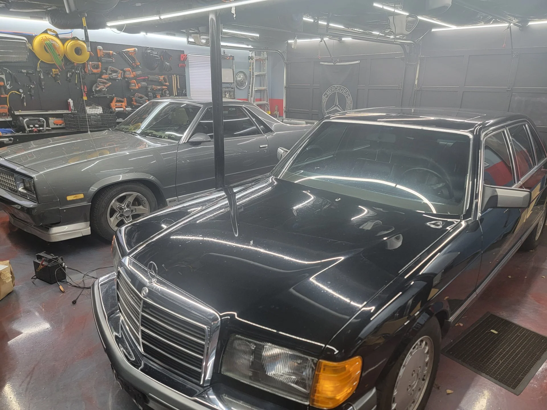

So that's all for now. @ClassyJalopy you'll appreciate this: my 560SEL came home from the shop last week. So I'm getting the last few little odds and ends taken care of and this car will be DONE! 6 years in the making! 😳
