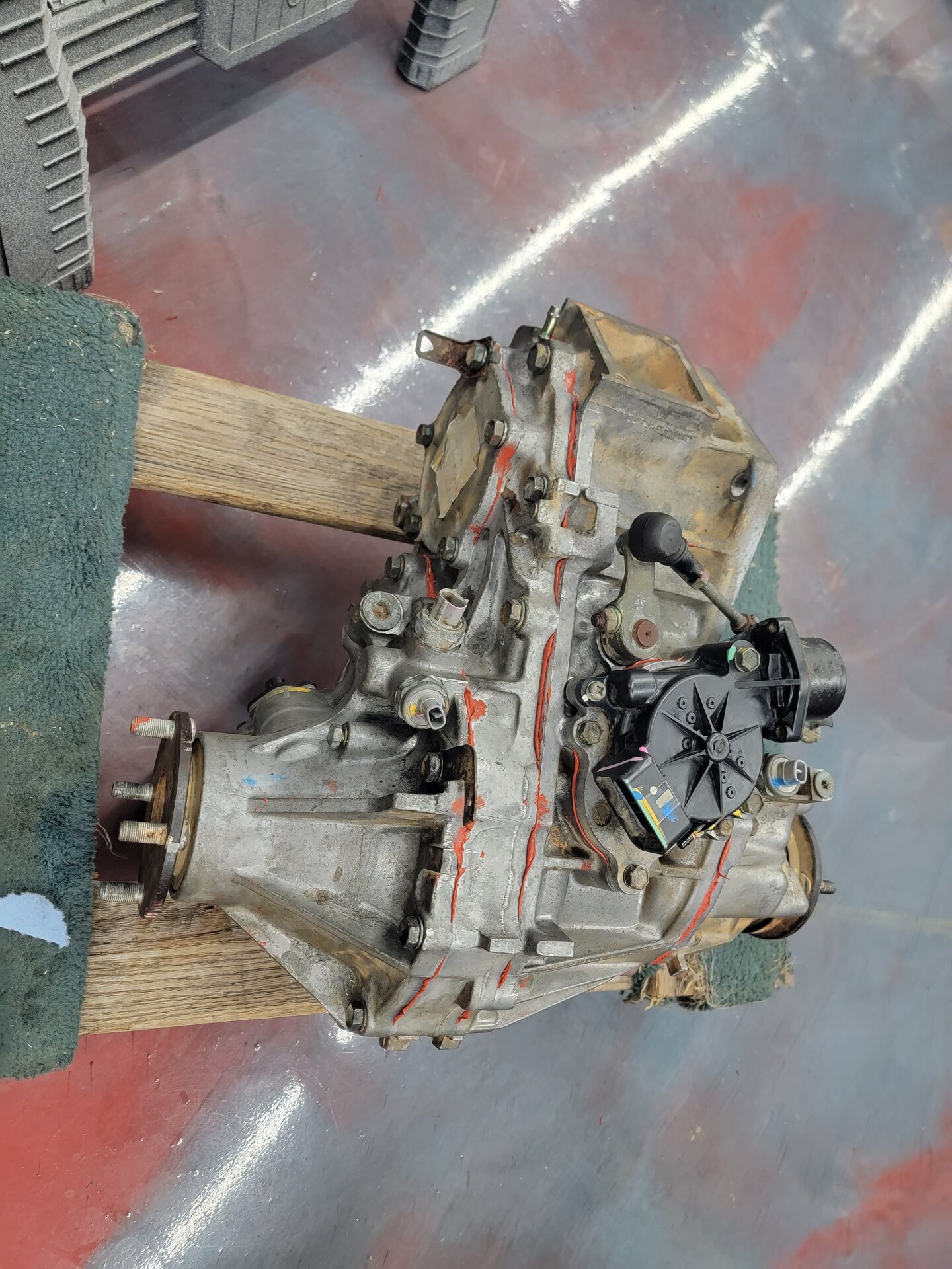

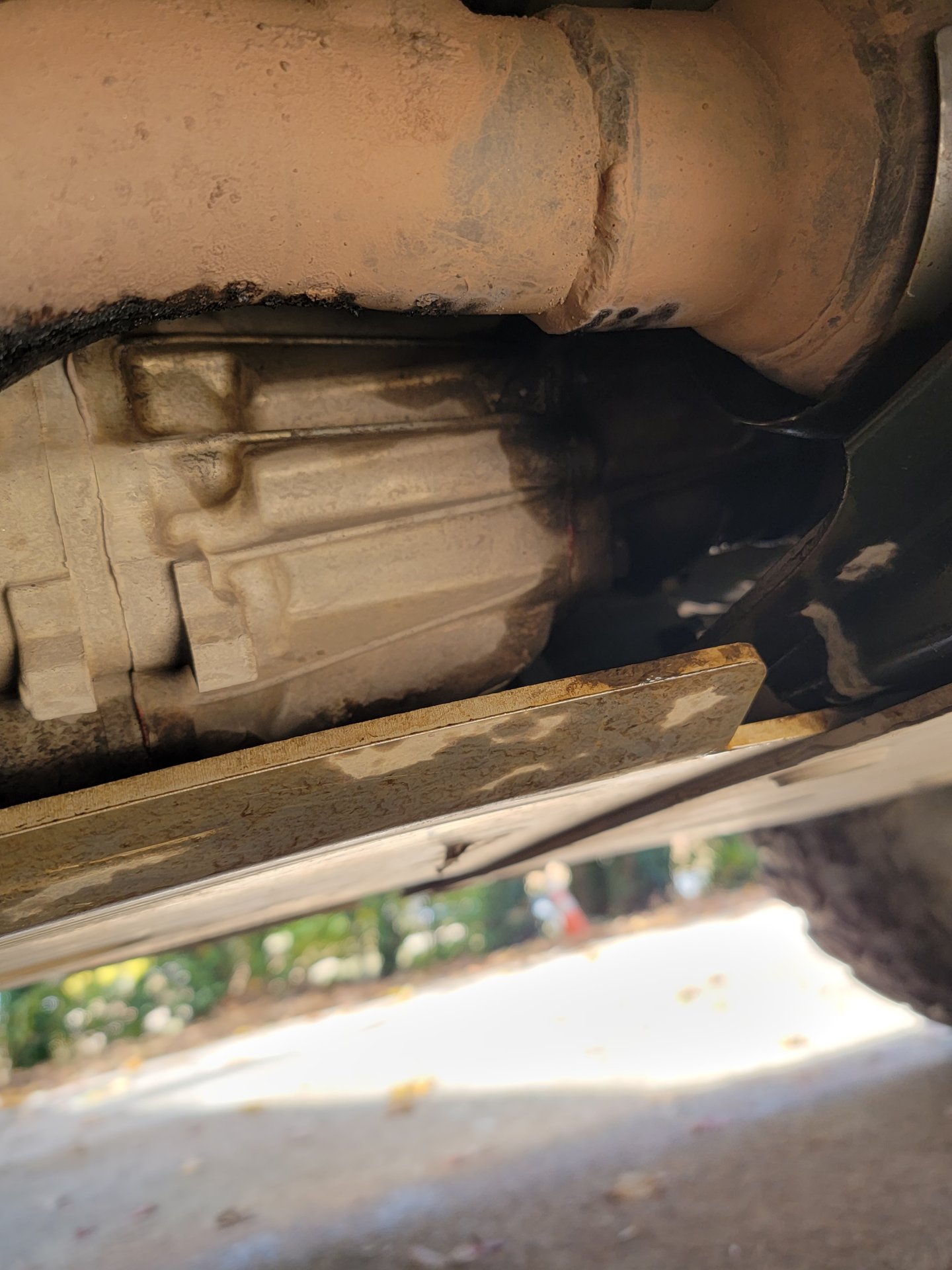

I came home to a drippy transfer case, so I think my truck is telling me it's time to do the crawler gears now.

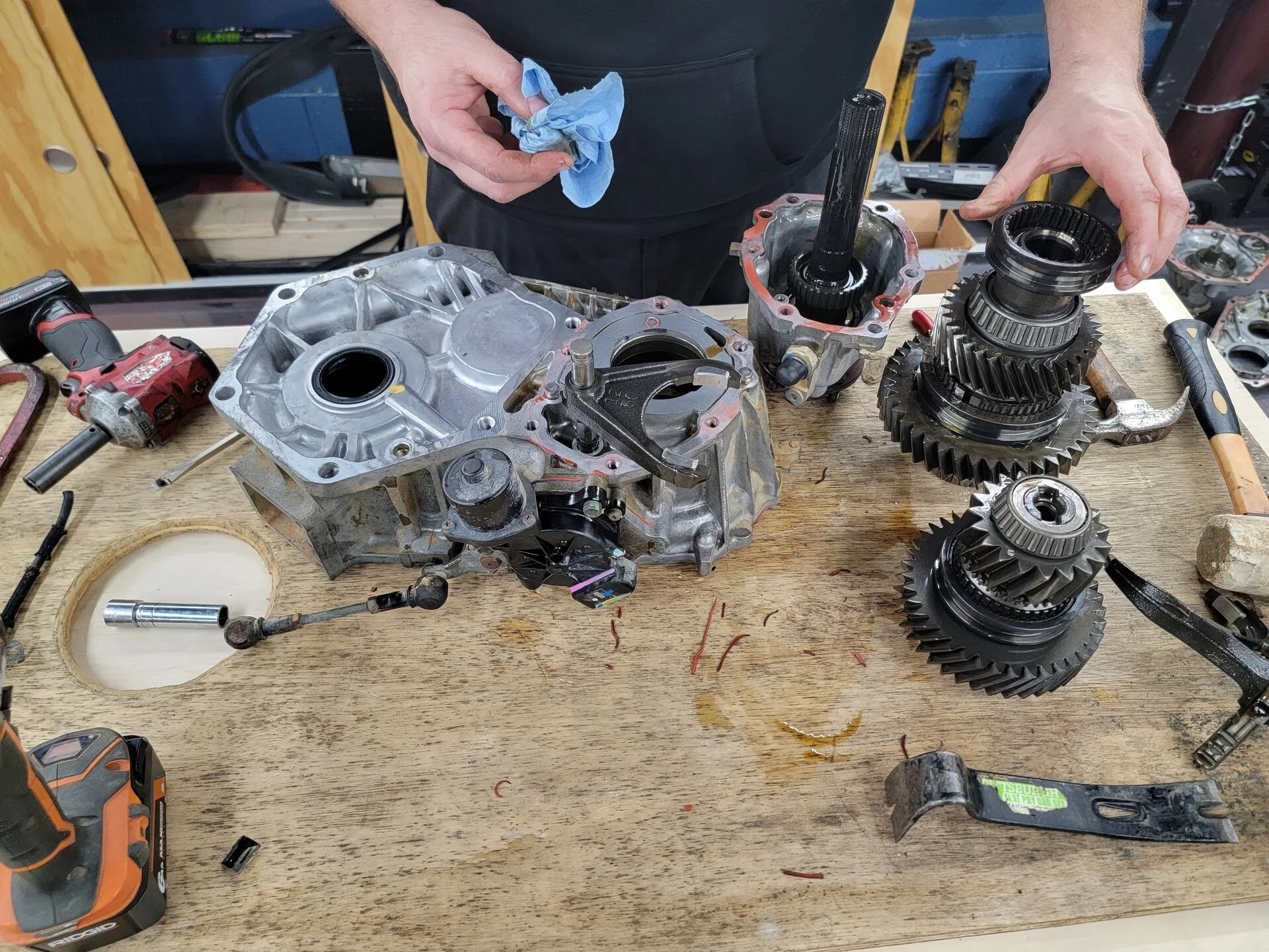

I ordered some seals and bearings, and now I'm debating if I'm going to attempt the job at home with help, or take the case to a local gear shop.
Yesterday I had some help from @Wermz , @patchagan , and Chris (whose mud name I do not actually know..) Patch and I got the case removed, Chris held the light, and Ryan helped to disconnect the last electrical plug. Teamwork!

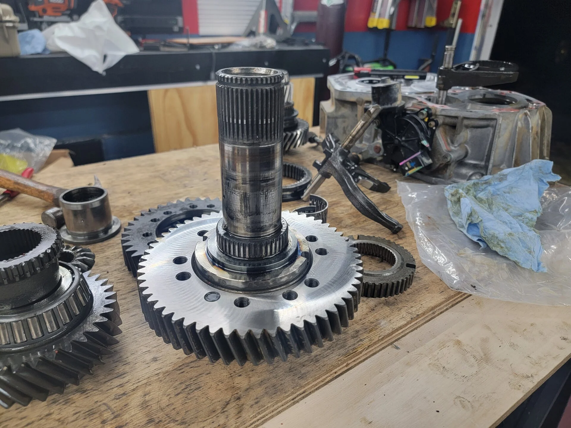

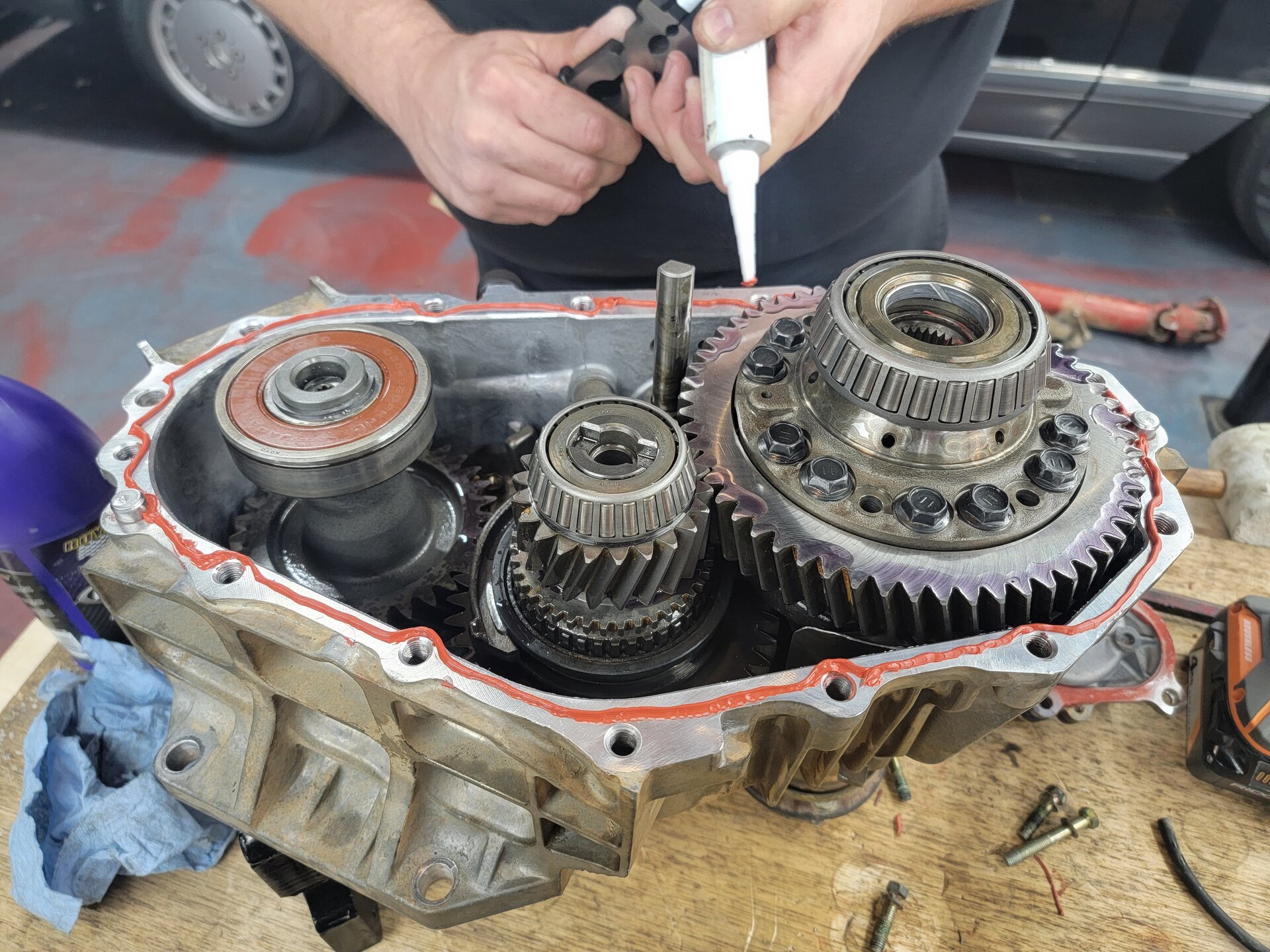

So far so good. We just have to do the seal and bearing on the one shaft left then can reassemble the whole thing.

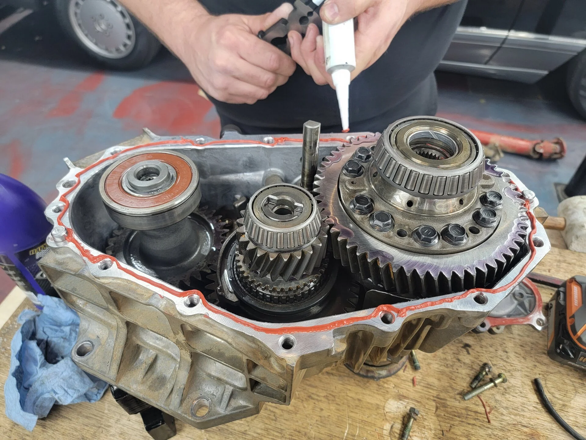

A press is imperative here. I'd watched the OTRAMM videos on YouTube a few times and he makes it look pretty easy. But, with some creativity and a selection of stuff to use to make your set up, we did every bit with my 20-ton press. No pullers used. The jack in my press decided to bite the dust, so I upgraded it to air over hydraulic and that will make the last bit just a little smoother.
@Wermz and I got it buttoned up tonight. Plan is to get it put back in to the truck over the weekend and hit the trails next week!
Before it goes back in, I'm going to take advantage of the space and run my t-case/ transmission breather lines to the manifold in the engine bay.
