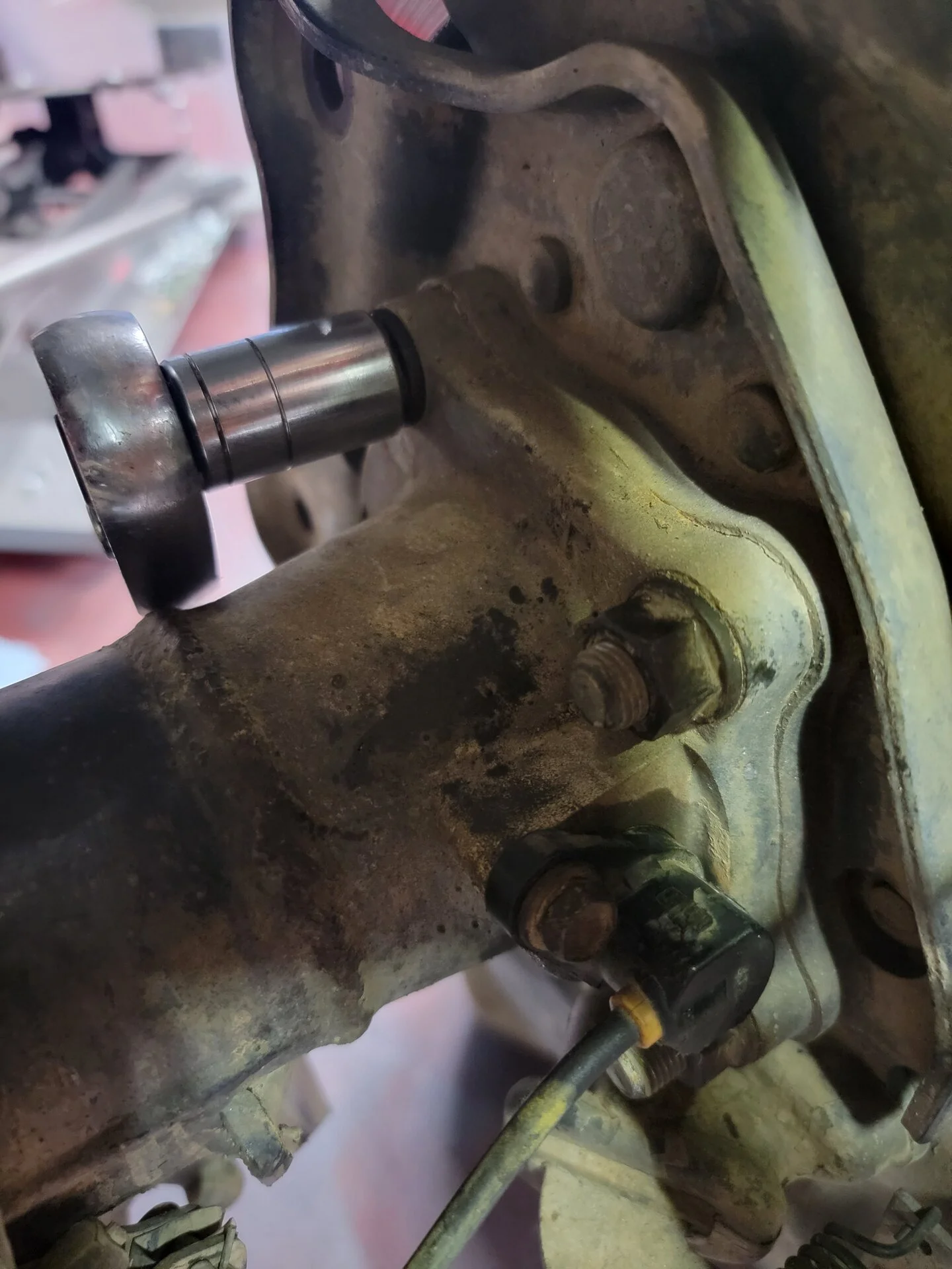

Yeah the bottom bend of the bar is nicely scrubbed. Nothing horrible, but it's kissed a few frogs.

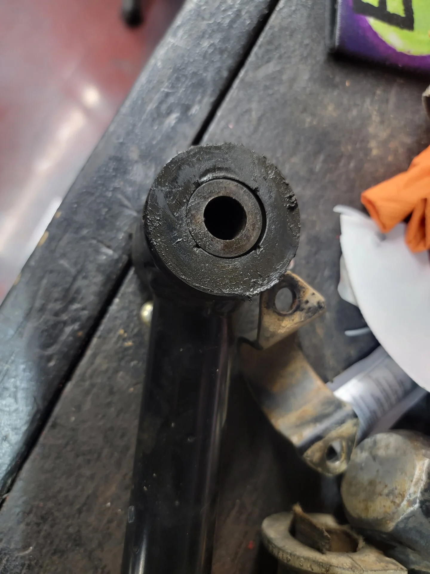

See the slop in the old bushing below?

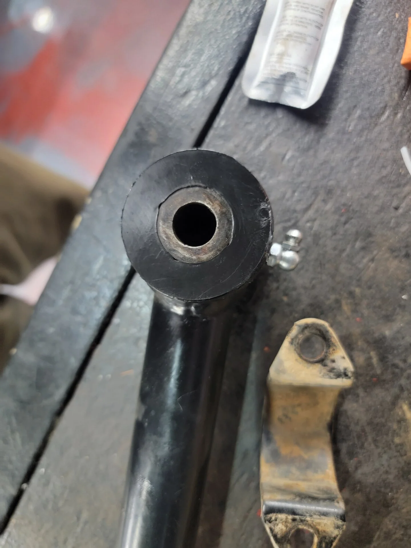

The new bushings pressed in.

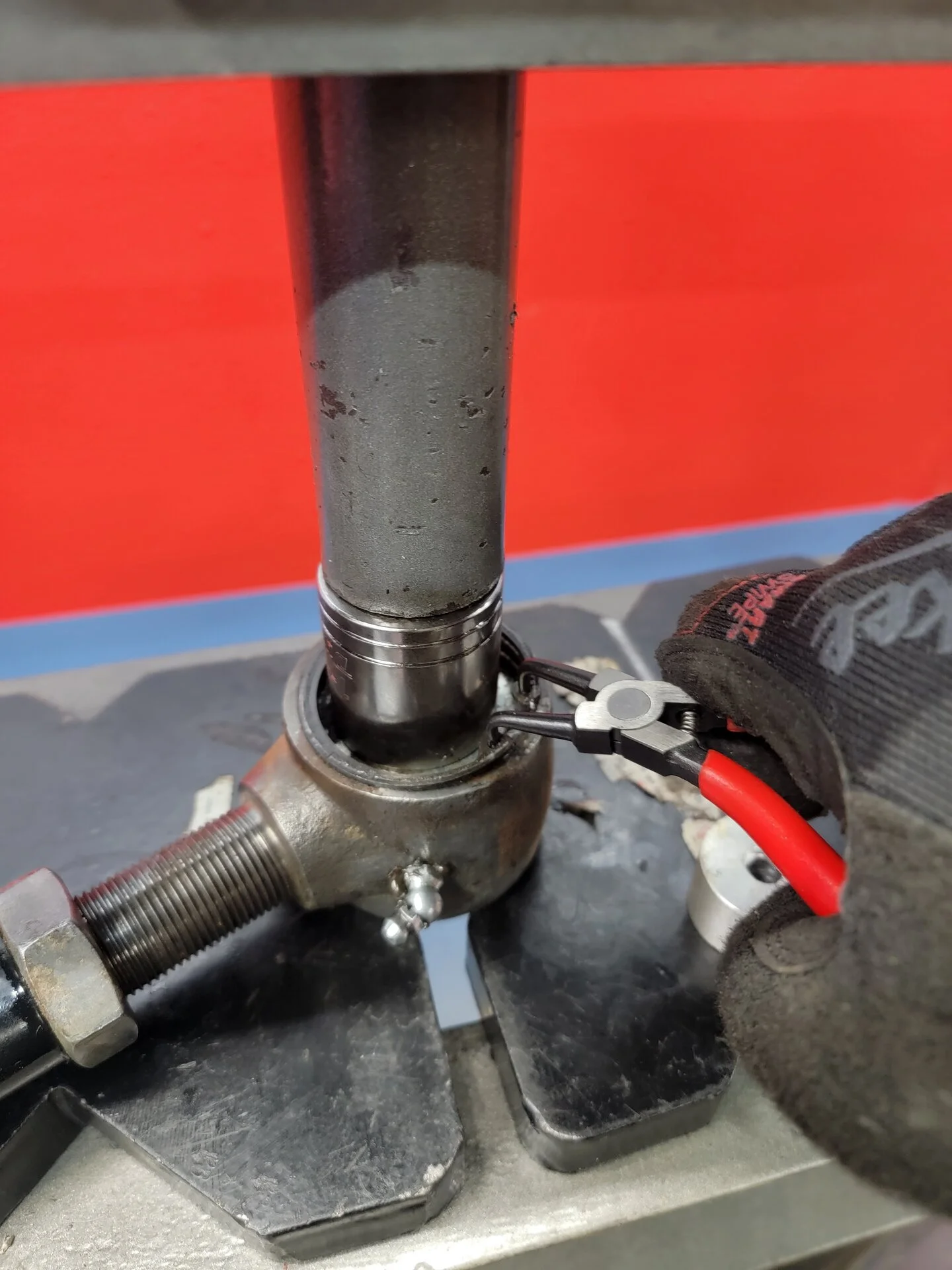

My solution to not having the Johnny joint tool: 1.5" socket to compress the joint on the press, then remove the snap ring around the socket. Works beautifully.

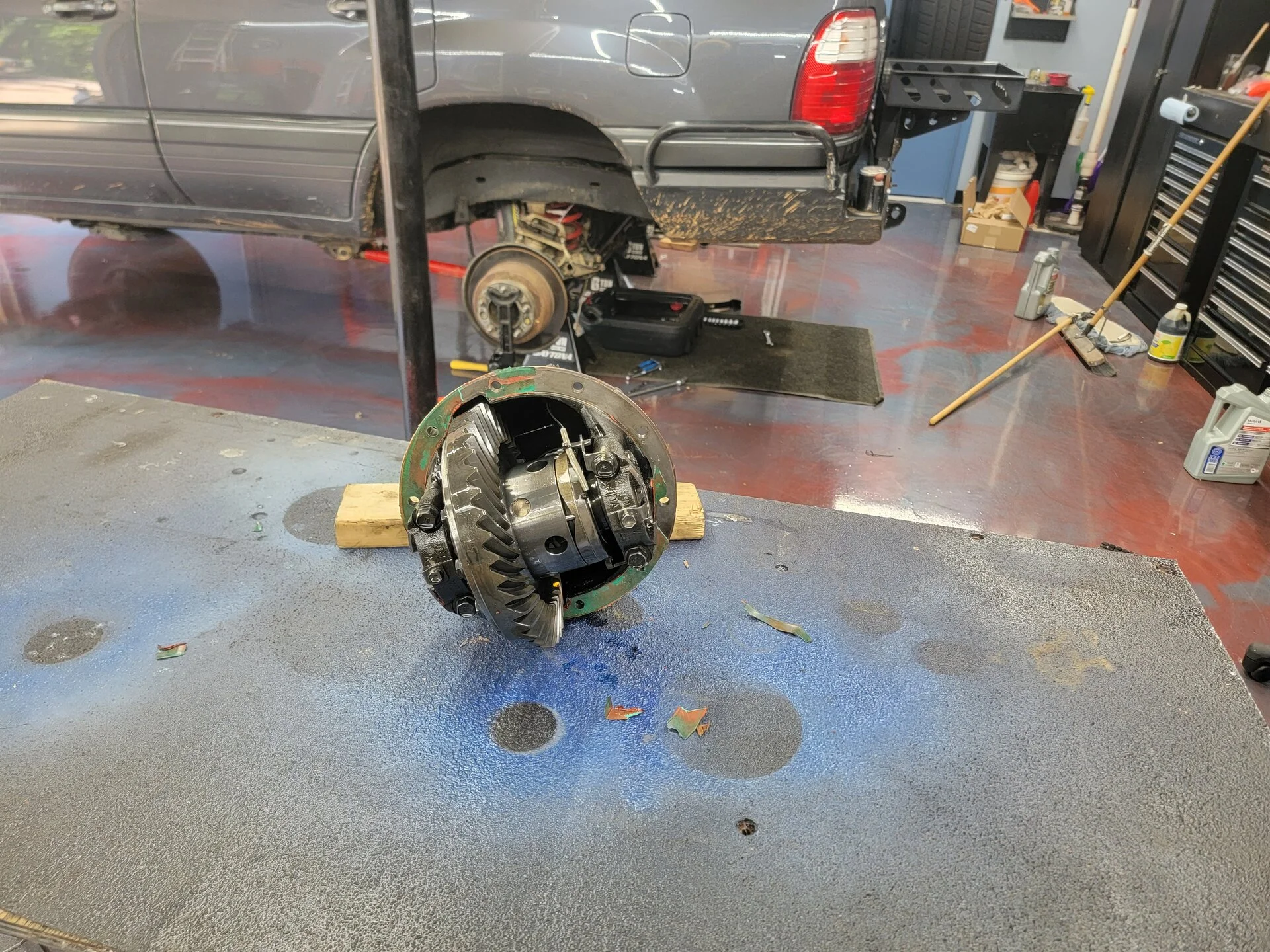

Entire assembled 3rd member is out. You can see the entire axle shaft supported on a jack stand in the background, just a few inches out from its home. IB4 someone says something about resting the axle assembly on the wheel stud. It was fine. Get a life.

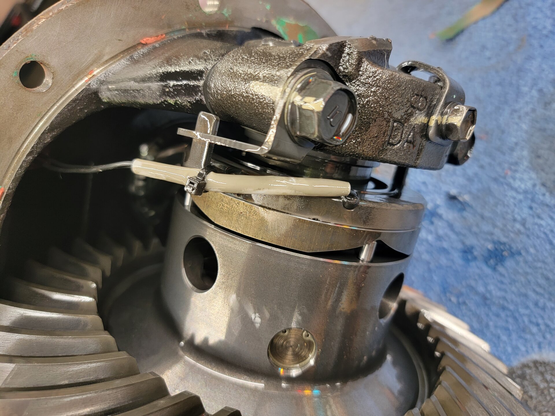

Here we can see the locker itself. It's the big bright silver chunk right in the middle. You can see the ramps and the pins that actually lock the diff. When open, it just spins free. When locked, the pins engage on the ends of the ramps and force everything to spin together. That's my layman's description. If I said something wrong, well the other people who don't know, won't know anyway.
Here's how it works:

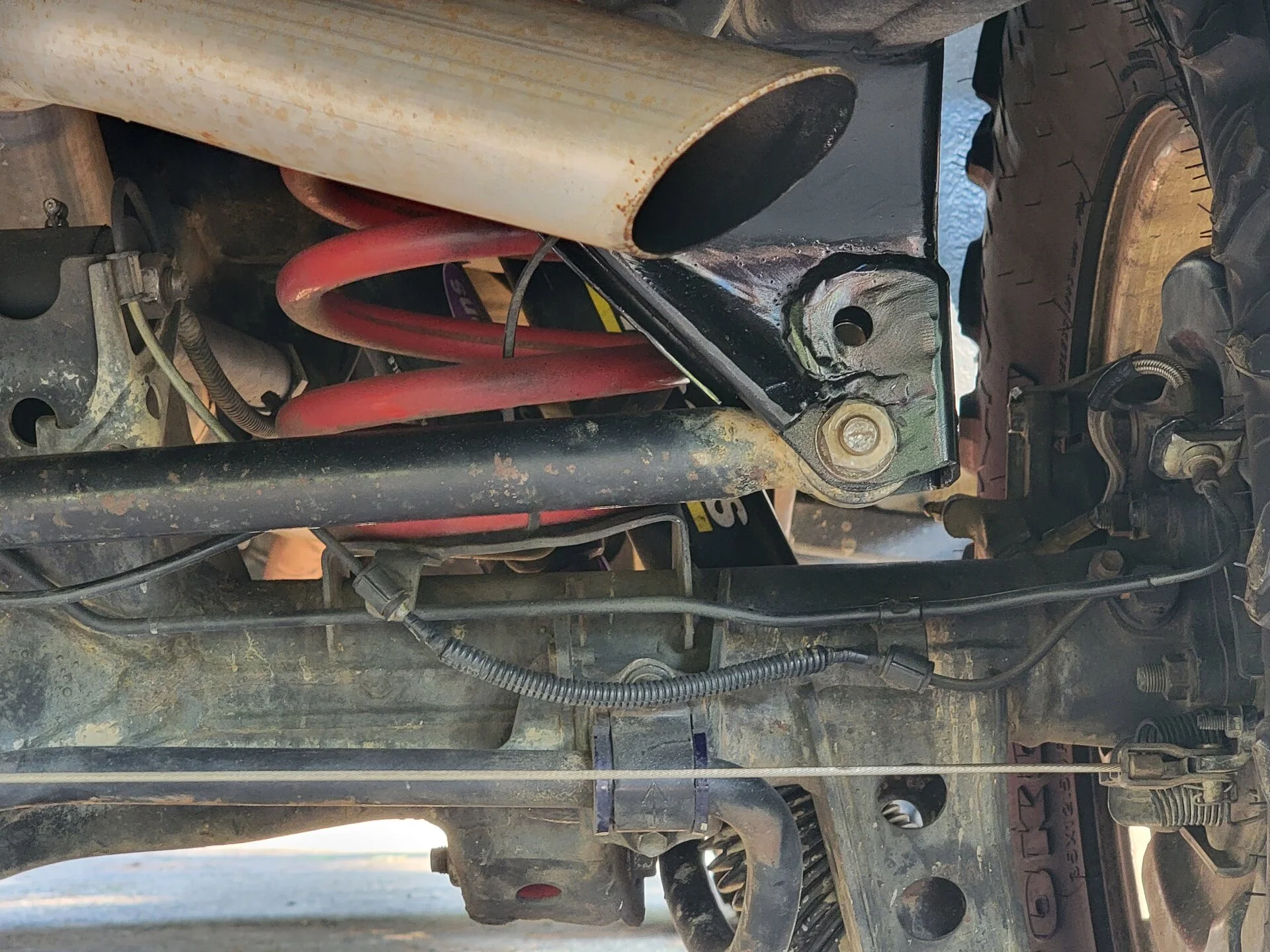

OK so what was the problem with mine? Well, egg on my face, it ended up being a faulty connector. And wouldn't you know it, my gator clips that I used for testing were also faulty, so I was getting false info while diagnosing before pulling the 3rd. What an idiot, right? Probably. But it was not an unenjoyable project, and I feel more competent in my understanding of the truck and my capability to wrench (and **** s*** up).
I added some simple blade style connectors, then heat shrunk and taped the ever loving crap out of them. They're not goin' anywhere. Today I grabbed a new tube of red FIPG from Mr. T and got her all buttoned up. Filled the diff with 3.5-4 qts of Lucas 75-90. Tested everything and it didn't work. Took me a few minutes of fenagling, head scratching, and cursing to think to put the transmission in neutral. Brilliant! Everything works great. I also lifted the front end up, locked the CDL and front diff, and tested everything together. It's a bitch to turn but all 4 wheels move forward together. Great success.
