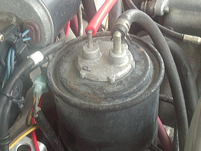

yeah I think the problem is two fold, one is that things are not venting correctly but also the cap is not sealing due to the worn fill neck, I will be going through the whole system and refurbishing it. I am guessing the charcoal canister is probably not available any longer?
New CC confirmed NLA.
Good luck
There is a thread floating around in the 80 section of an Autozone CC that SHOULD work. Don't know if any of the guys on here have tried it or not.
EDIT: yup ACDelco 215-75 is what I have saved in my amazon lists that is supposed to be the one.
What about the charcoal canisters from the late 80s toyota trucks/4runners? Anyone tried one of those? They look very similar.
Part number of pic to reference? May depend on the year too.
I just noticed the similarity from google pictures. I don't know what part number it would be. It has two top ports and one bottom port like the FJ60/62 canisters. This is a picture from a 1988 4runner I believe:
They're all NLA too.
