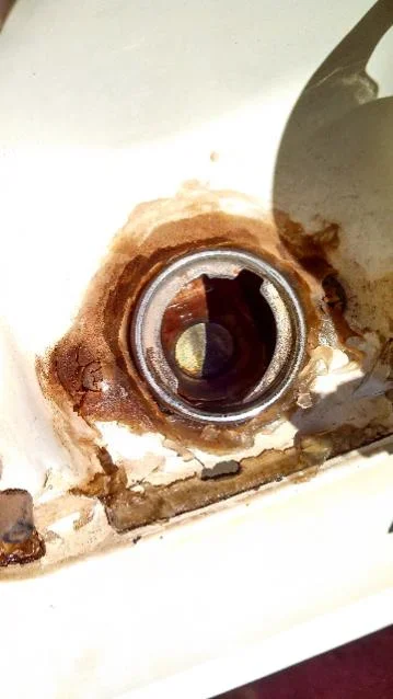

Gas Seeping (Spewing) Out From Fuel Filler Neck
Aug 21, 2003
175
7,412

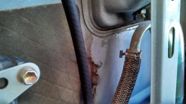

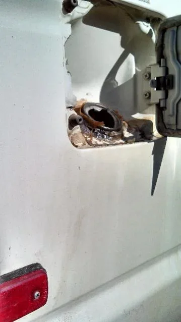

So, I've found out that my 60 ('87) spews gas when it is even somewhat close to full, both inside (from the filler neck, and collects at the bottom of the rear quarter panel) and outside (from the filler mouth, even with the cap on, runs down the quarter panel on the outside, to the ground). :eek:
Every time it happens I wish I would have put bigger premium on my life insurance and hope that I am not being too staticky(sp) as to not blow both of us to kingdom come.
So far I've been successful in absorbing the gas with shop (paper) towels and put them in plastic sacks (double bagged).
I don't top it off and this last time I even drove it enough so it should have consumed a few gallons of gas, at least, but it still happened.
I'll try to attach some pics from my phone later, but I was wondering what I have here and what I might have to do so I won't feel like I'm playing the Russian Roulette every time I feel like taking the 60 for a spin or when I'm picking up my kids from school.
Any advice or suggestions would be very much appreciated.
BTW, the truck has had its fuel tank recall work done about 10 years ago, fwiw.
Thank you guys!!

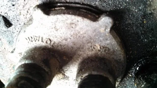

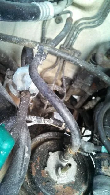

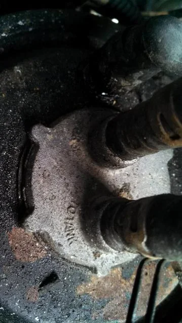

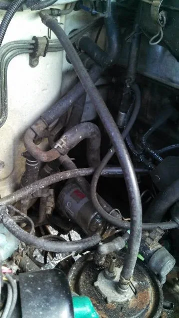

Are the cc nipples connected ton the right tubes?
How the first one is connected:
Numero Dos:
And the other one oozing a little:
Anyway, I removed both tubes and pressed the bike pump tight and blew some air in the first(pic: closer to the front bumper)
Air came out of the other hole/nipple.
However, when I blew in the same with the second hole/nipple nothing happened(That's what she said, lolz!)
What does this mean?
Or is this irrelevant, unless I can apply the exact pressure recommended by Toyota?
Thoughts???
Mot, switch the two hoses around on the top of the canister and problem solved (probably).
There's a one-way valve (check valve) on the tank side, sometimes it gets stuck, corroded, full of gunk. Switching the hoses bypasses it and saves your tank and filler.
The other thing you can do is replace your gas cap with a vented one. Toyota Part # 77310-60090
So, the orientation I have in the pics is "correct" (factory), but I should swap them so this fuel puking issue might get solved? (I've read that somewhere also).
I will also order the fuel cap from CDan the next chance I get.
Thanks a bunch!!
Mot
Can't tell from the pic how yours is set up, but one canister port is labeled "TANK" and the other is "VENT" (don't remember if it says exactly, vent, or something like that).
Factory routing is the evap line that goes back to the gas tank is connected to the canister port labeled "TANK"
Put that line on the other port so the tank will vent to atmosphere. Yes, it will prevent the vapor pressure from building in the gas tank - that's what is causing the overflow. It's even worse now with the new formulations of gasoline that have a higher vapor pressure.

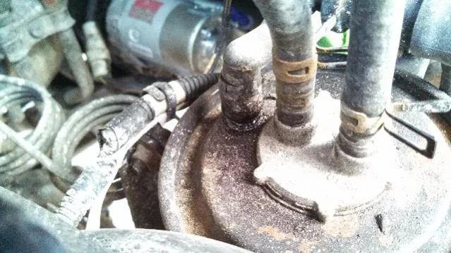

So here's how they're labeled:
And as of now the "To Tank" nipple is connected to the hose the goes toward the firewall and then behind the air cleaner/driver's side, while the other nipple is connected to the hose that goes lower to the frame.
So, being dense I need to ask....
Do I need to swap the hoses or have they already been swapped to the better(non-factory) orientations???
attachment.php
If this pic is the way it's hooked up, the tank line is hooked to the "Purge" port. That's how you want it.
It's possible the whole canister is plugged. You can just leave that tank line off the canister a bit and see what happens at the fill tube.
Hard line to tank could be plugged, too. I had to spray carb cleaner in mine, let is soak a bit, then blow it out.
attachment.php
