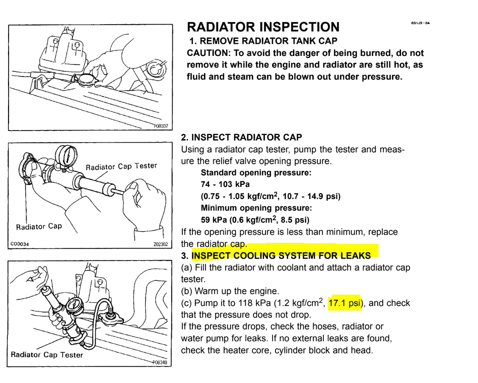

Which hose leaked after pressurizing the cooling system? Any water leaking inside the vehicle, front foot-wells, carpet wet??
There is a high risk of rupturing components in the cooling system using a garden hose as the pressure in a residential water connection is many times the max pressure of the system.
As @Kernal said go easy on the pressure when testing.
Depending on your water pressure the garden hose could be 30-80psi which is way too much.
