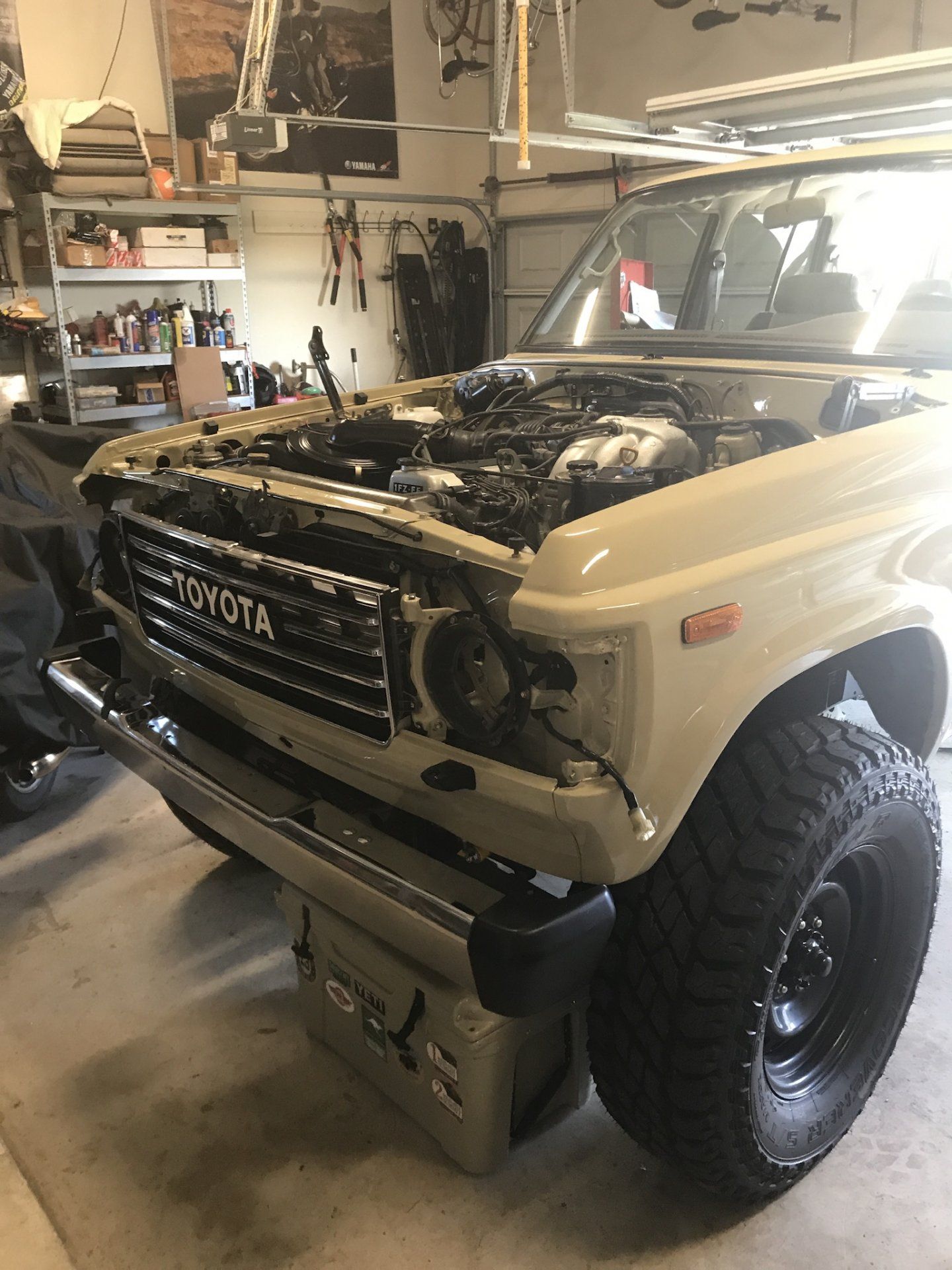

Just about done, sending it out to get the exhaust completed
Send some motivation my way! You work fast.
She looks really good.

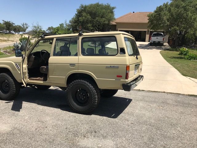

Only one I have at the moment, taken before it was complete
Holy smokes. That's a sweet project. So much going on here that I'll have to pick your brain on sooner or later. What gears did you end up running?

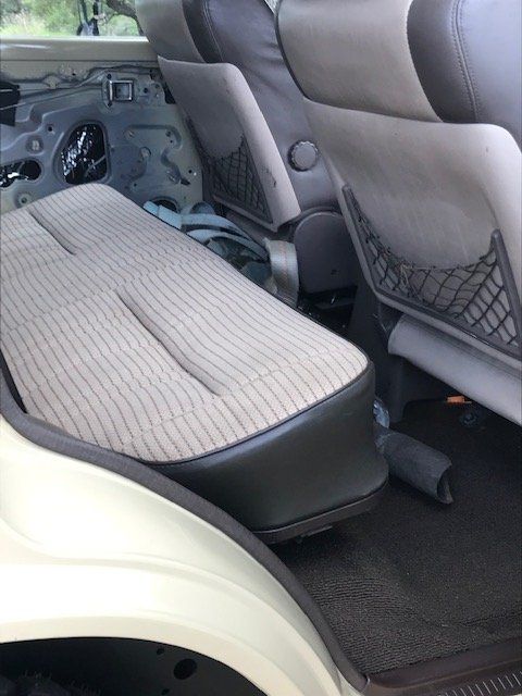

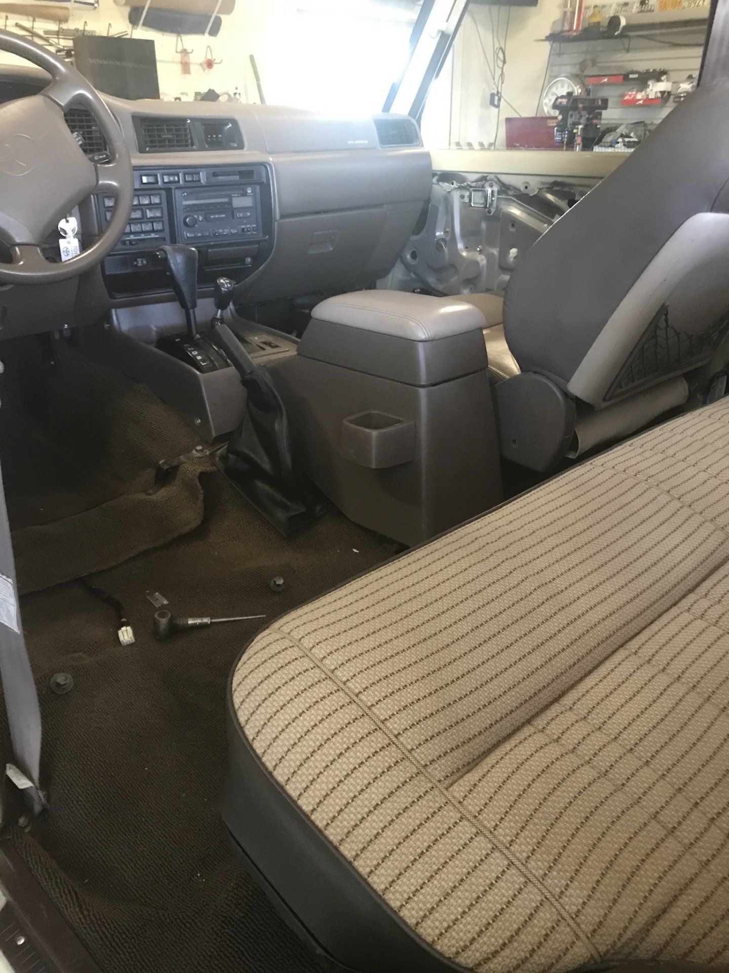

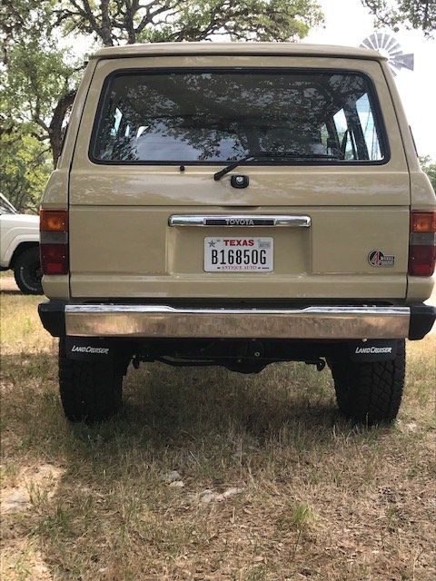

Got the rear mudflaps on and a couple of interior shots.
Still need to complete the exhaust, wire up the wiper motor, build AC lines and find a proper battery hold down bolt.
running stock locked gears, tires are 34” (285/75/17), skinny, i feel this rig should be lighter than my 80 which has good power. Thinking I’ll be just fine with stock gears
