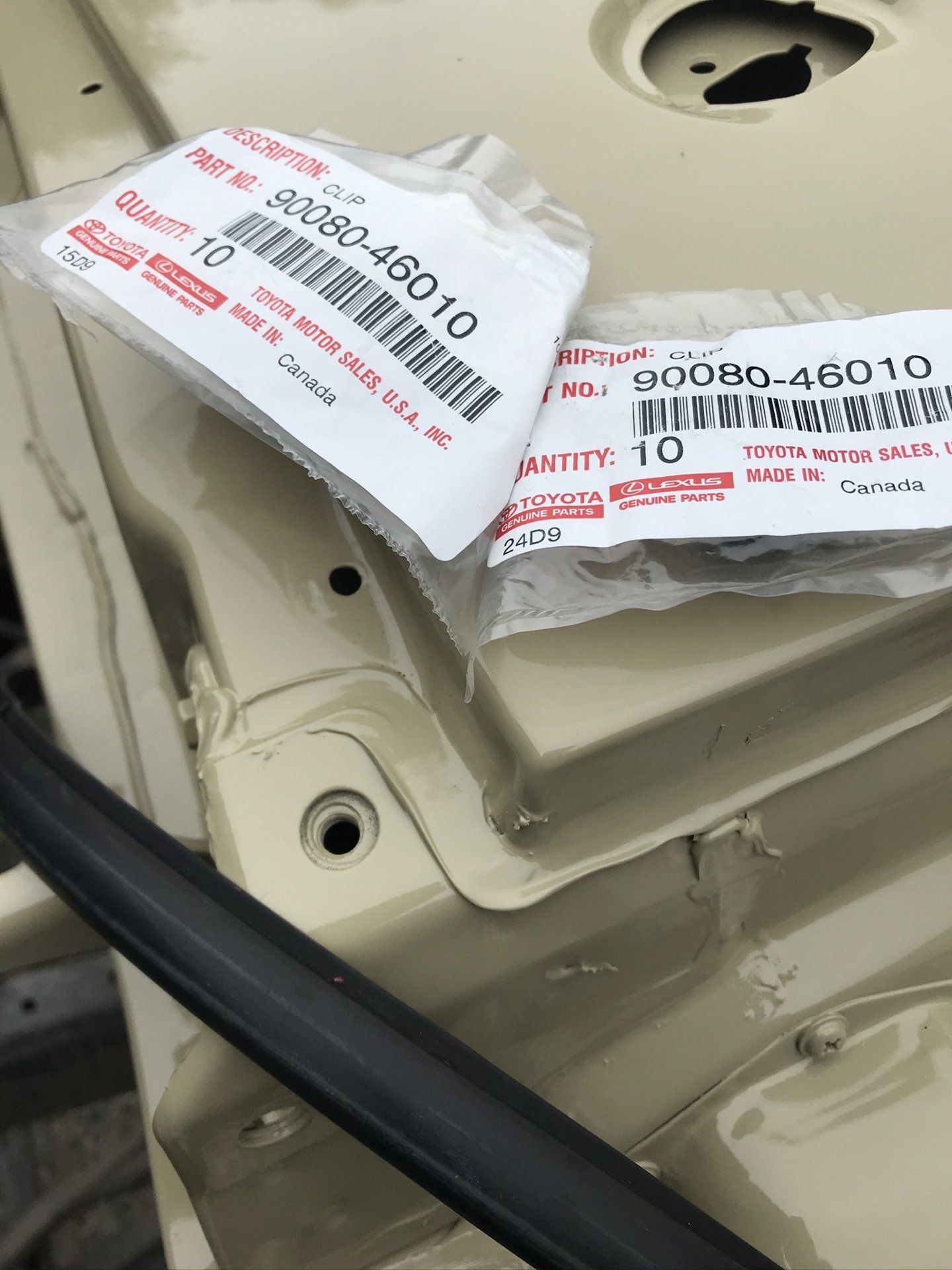

90463-10338 - 80mm
90463-10521 - 95mm
90463-10010 - 120mm
90463-10060 - 135mm
Large diameter portion of wiring harness will be either -10010 or -10060
I'd probably just buy a bunch of all of them for options @Skniper

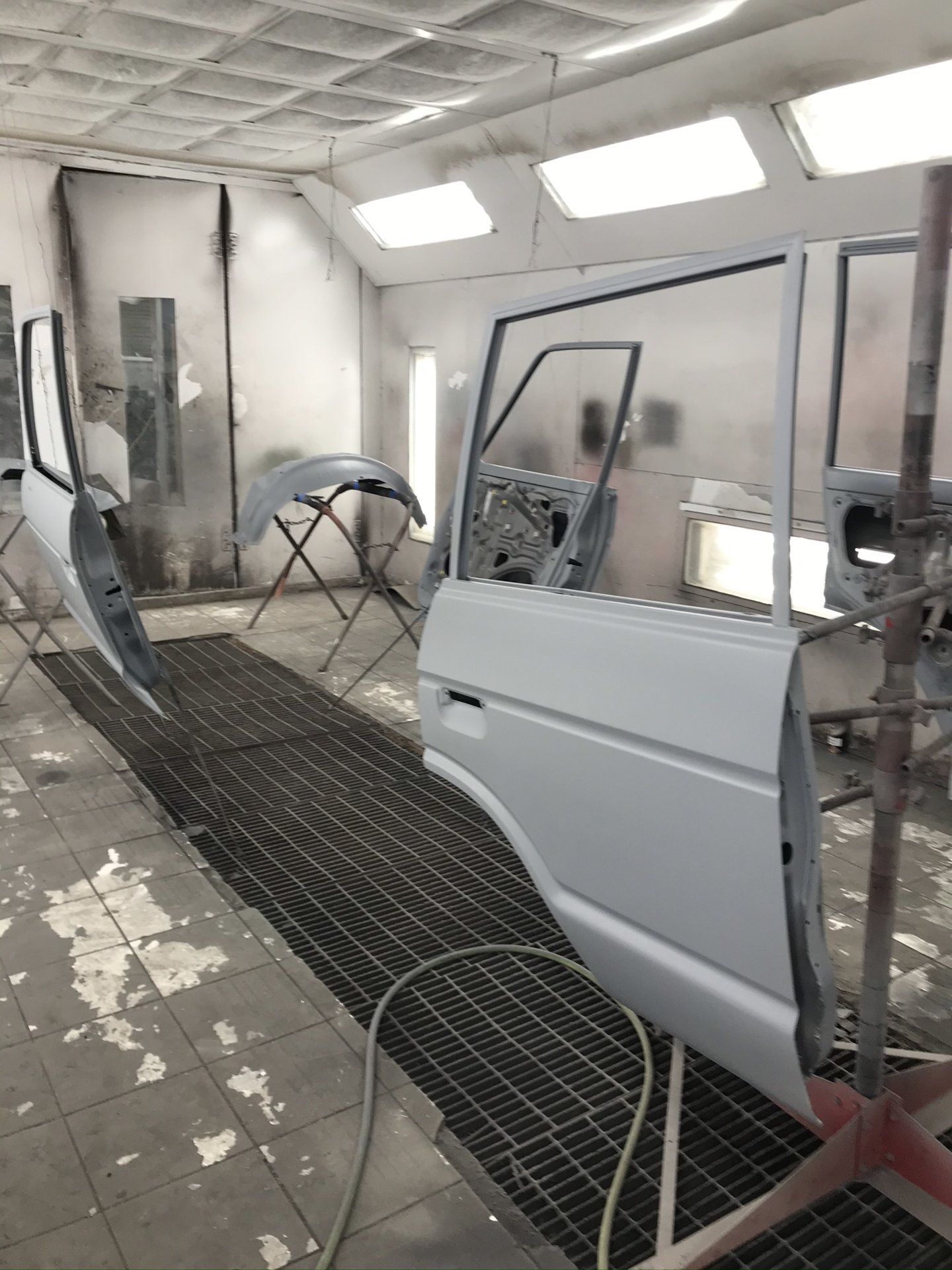

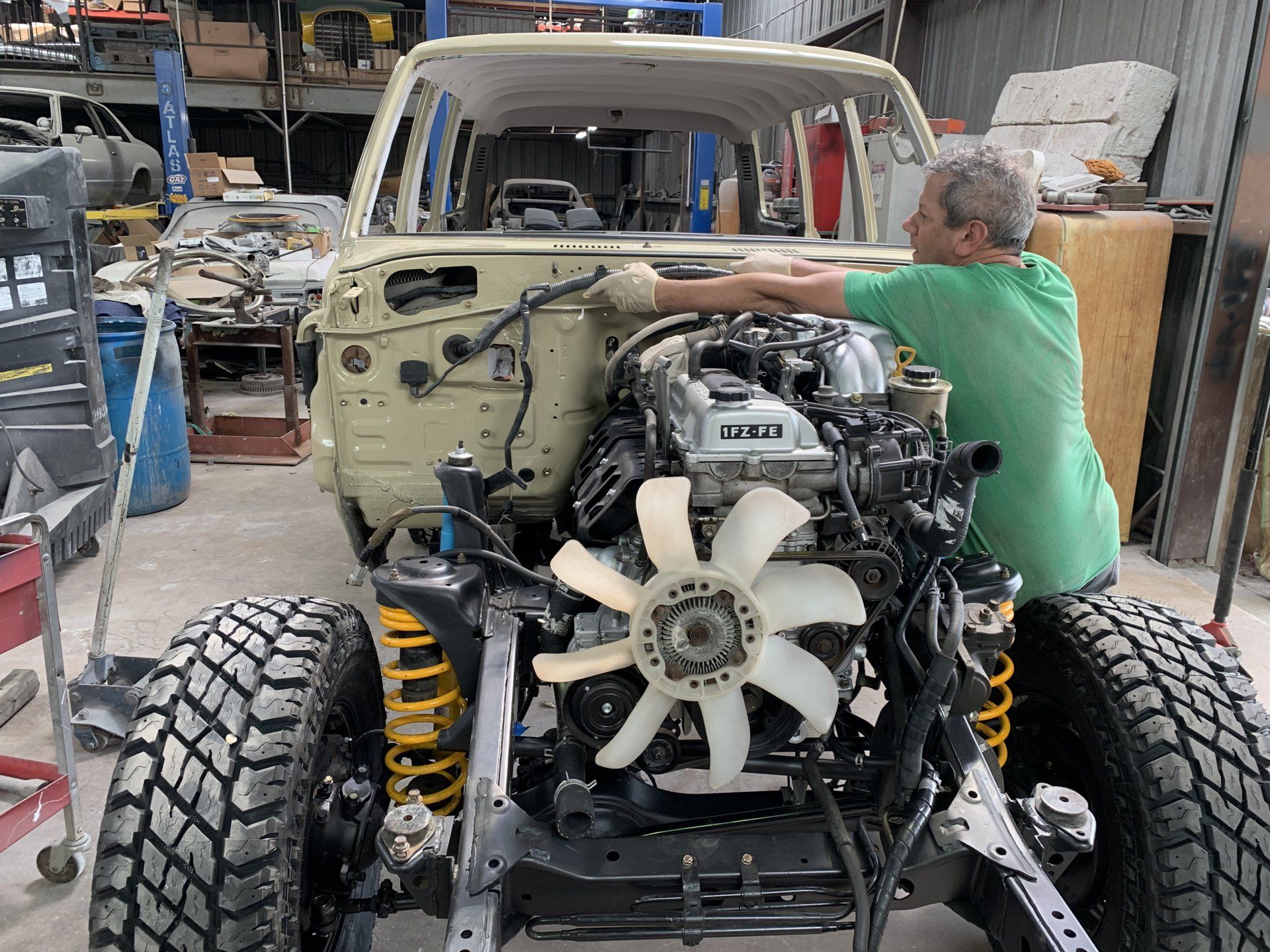

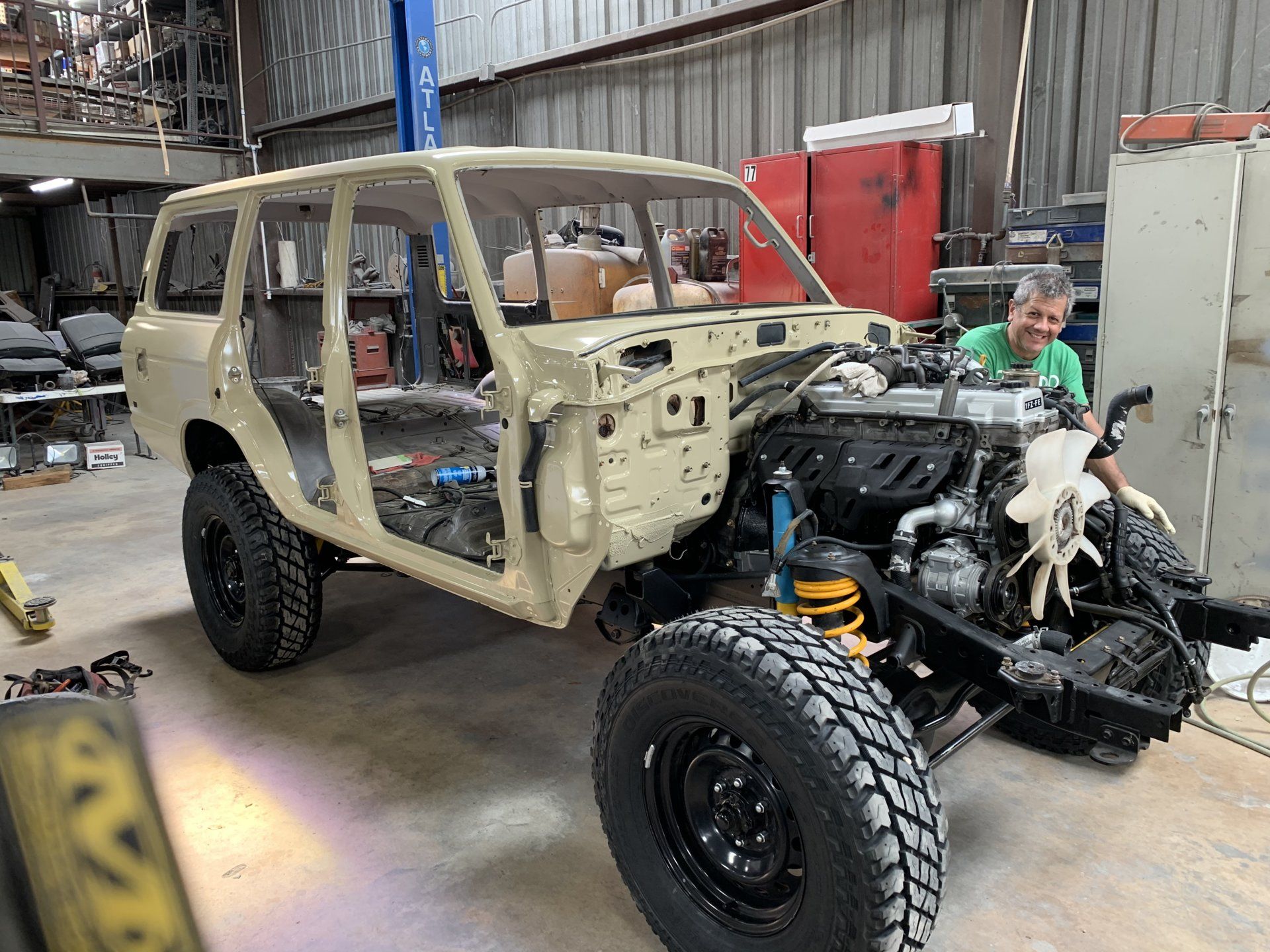

Started assembling the firewall area last night and shooting the doors right now.

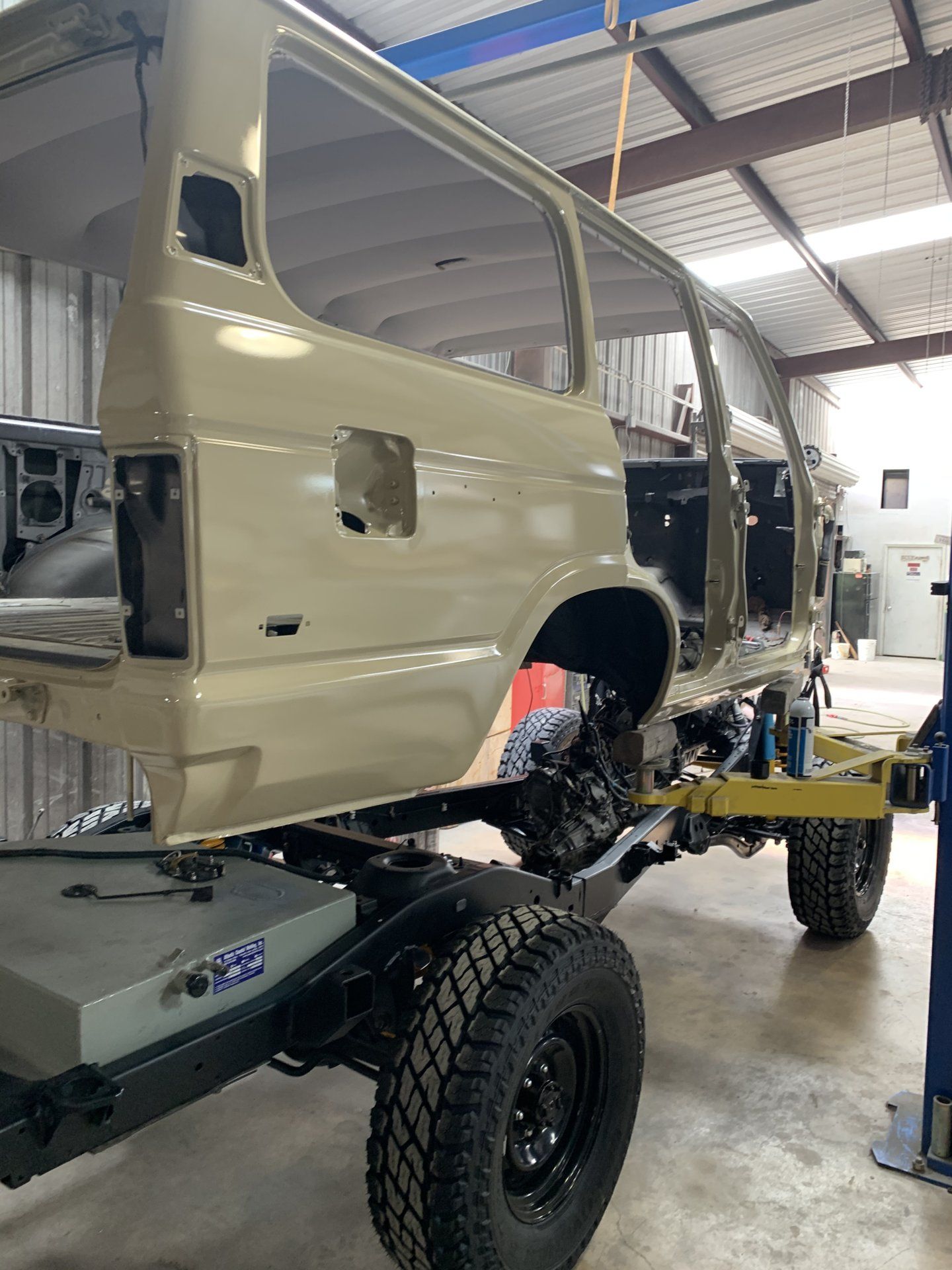

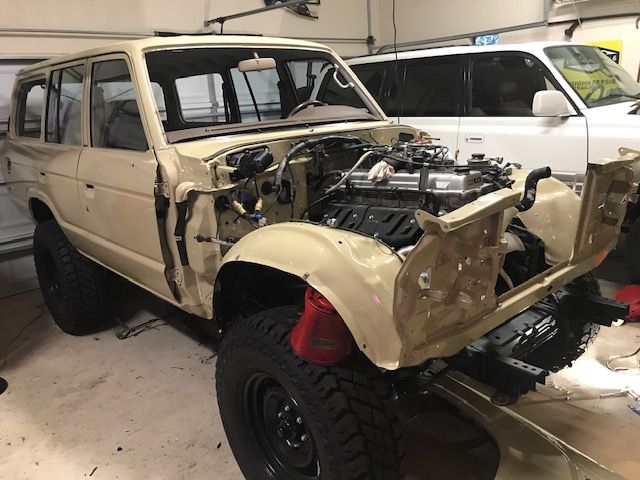

Got the doors hung and the tub mounted back on the chassis. Got new 285/75/17 Coppers mounted too
Awesome!

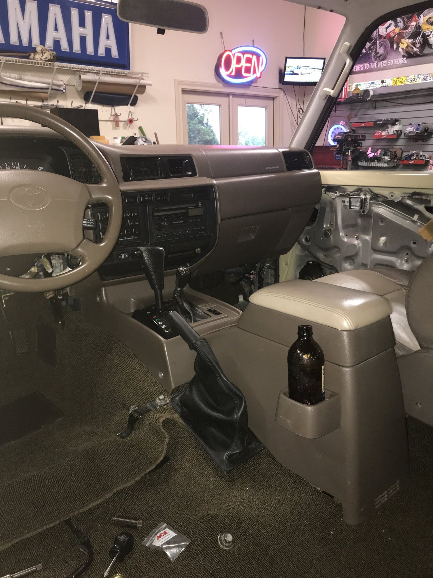

Got 99% of the dash installed, 100 % 80series wiring harnesses installed. I also laid down a ton of Dayamat.
A lot of knuckles have bled to get to this point man. I still don’t have full feeling in my right index finger 🤣
You should be a politician then. Apparently it is inappropriate for them to point.
Are you going to make the airbag system functional Monroy? Seems like it would be easy to do since you have the dash amd 80 harness.
I’ve asked the same thing. He doesn’t plan to have the SRS system functional, but it’s all there. All he needs to do is plug the sensor in. But... we’ve already removed the dash indicator light bulb, so of course, there’s no going back now 🤣
I guess it is probably the better call anyway since it isn't in the truck it was designed for and the 60 doesn't have srs anyway. I don't get all worked up over that stuff anyway but many do.
