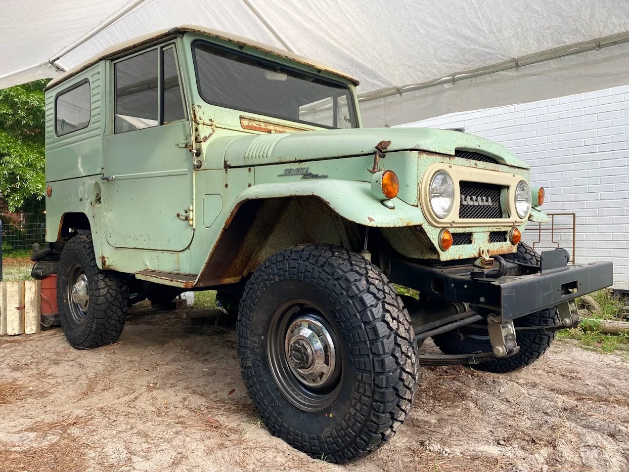

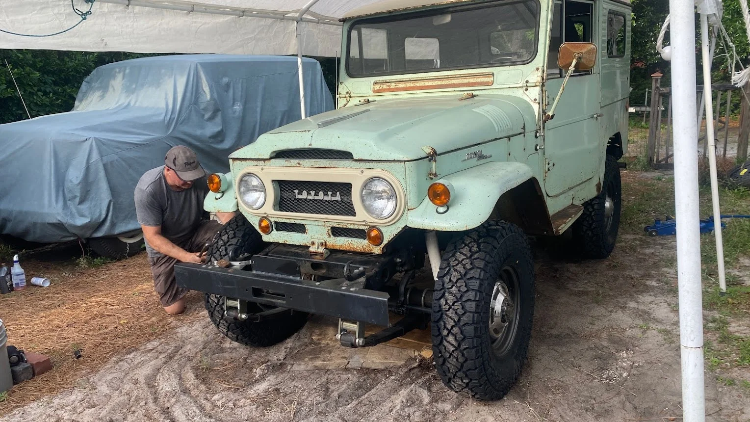

Ahhhh....fresh meat! Got my Klevers installed, replacing 235/75/15 KO2's that were badly rotted. With the 2" OME my rig is a whole new beast! Much improved ride and the look of these 9.50's is perfect IMO.

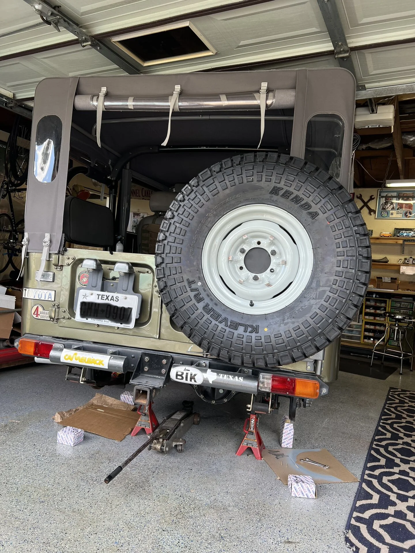

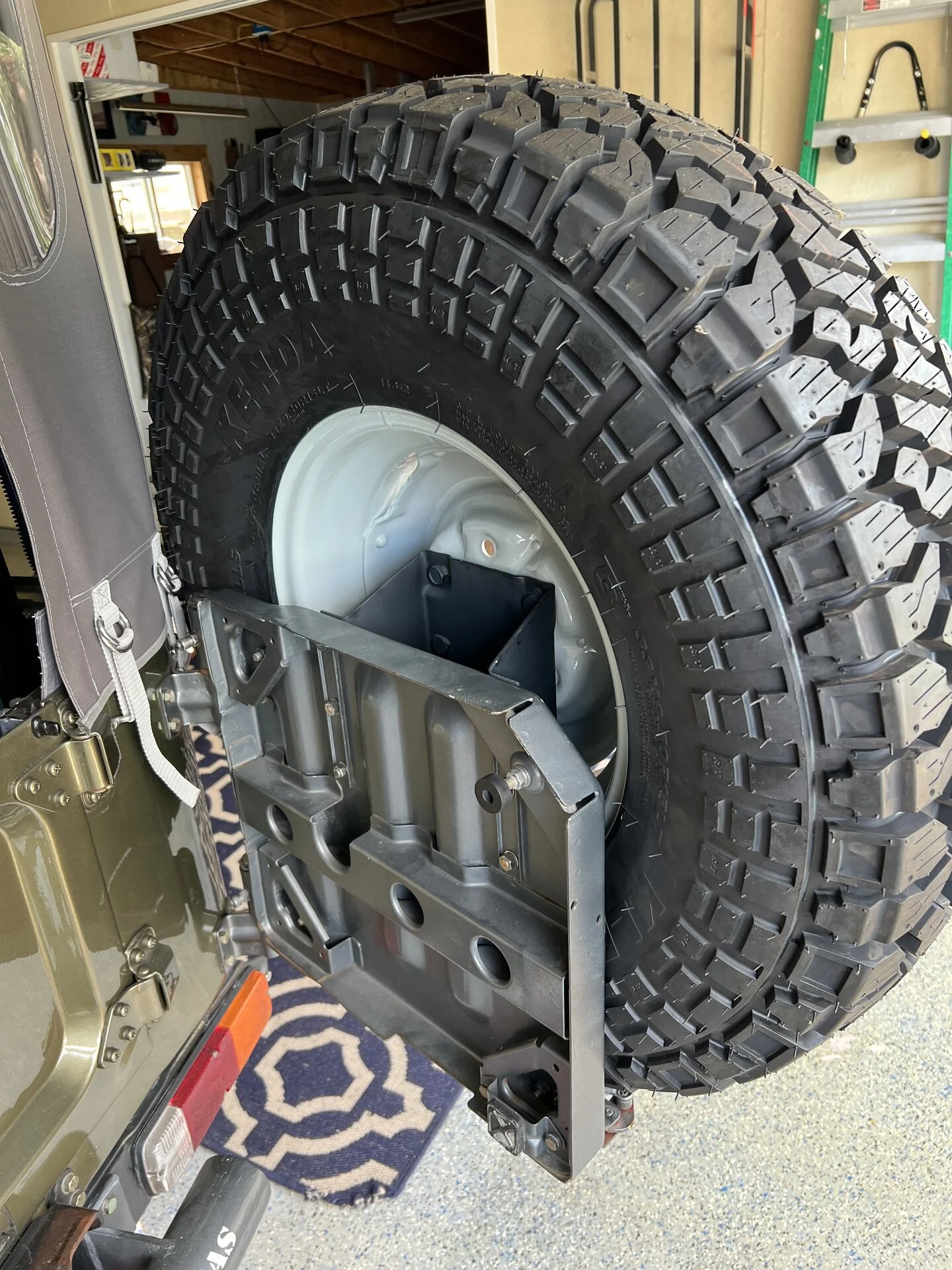

No spacer needed. I made some adjustments to the stock carrier to keep it from being wobbly. It’s rock solid now. The hinges were worn and nylon bushings would be insufficient, so I drilled & tapped the hinges and added these bolts and lock nuts. It was easier than machining brass sleeves.
