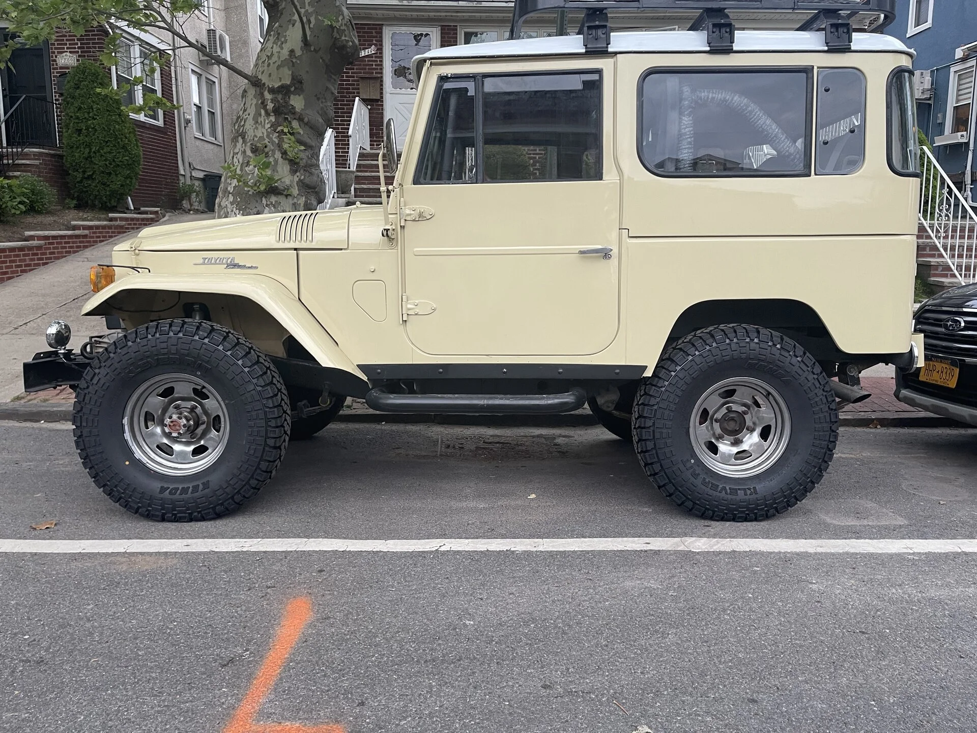

Currently running 32x11.5 tires on my FJ40. Truck has 2” lift. Wondering if anyone was having any rubbing or fit issues with the 33” Kendas. My rims are FJ40 wagon wheels.
Currently running 32x11.5 tires on my FJ40. Truck has 2” lift. Wondering if anyone was having any rubbing or fit issues with the 33” Kendas. My rims are FJ40 steelies.
I think you will be fine. I'm on 33x10.50x15 BFG KM2s on stock steel rims with no rubbing. I run a generic 1/4" spacer as the DS tire can hit the drag link on a full left turn, this solved that issue and can still stuff the tires in the rear wheel wells. Lots of rigs on 33x10.50's with stock steelies

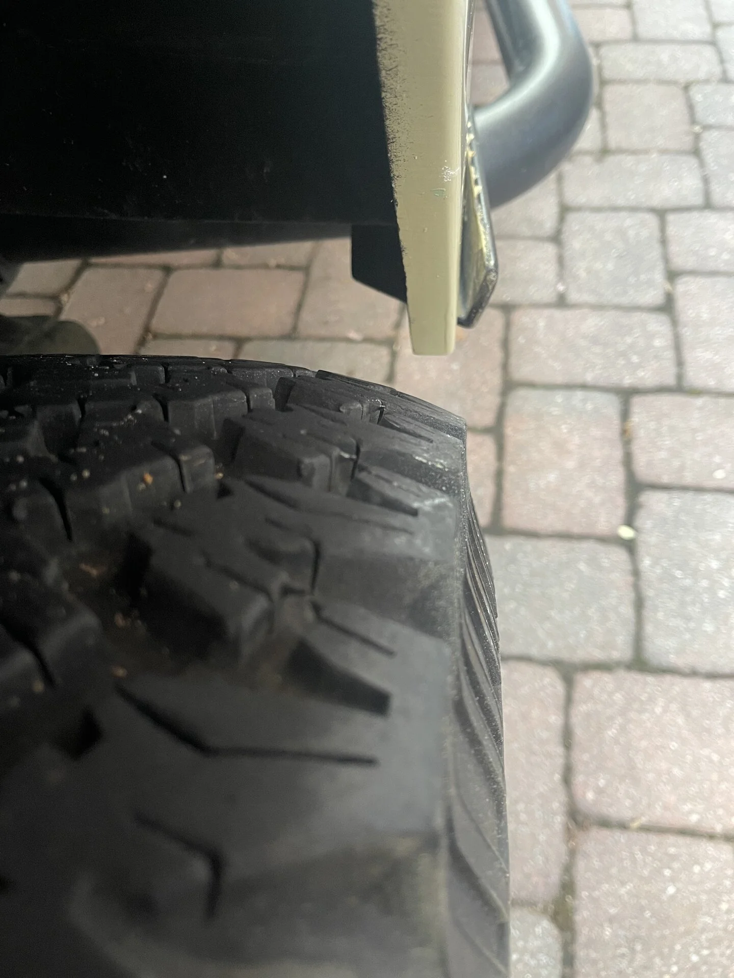

Because I tend to over think... the distance between current tire (32X10.5) the body looks like approx 1.5". I am guessing the 33x9.5 fits inside the body (shown in the second picture and thus no rubbing issues. Is this correct?

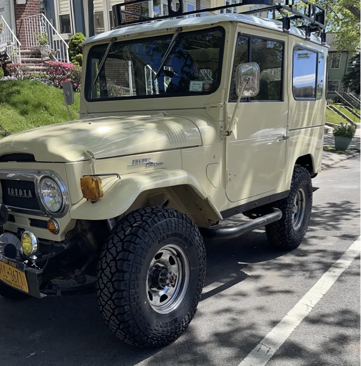

Purchased a set of the Kenda Klever R/T KR601 LT33x9.5R15 form Sears. Driver's rear tire was rubbing on my exhaust pipe (bumps and turns) - needed to put an extension in to push the muffler tip back a few inches. Now I need to put a few miles on them :).
@brooklyn- is your 40 stock height? Seems like the rear tire is pretty close to the front of the wheel well. Any modifications?
@CBFJ the truck has a 2” lift. I am running the tires at 50psi and might take it down a bit. Not sure if that will be good for clearance 😄.
I think the clearance is a half an inch — maybe others can chime in with theirs.
Agree it looks a little close, but so far no issues with rubbing.
50 psi sounds pretty robust, I’m usually aiming for 32-34 on my 10.50/15 BFG KM2s. I’m on stock steelies with 1/4” spacers and don’t rub.

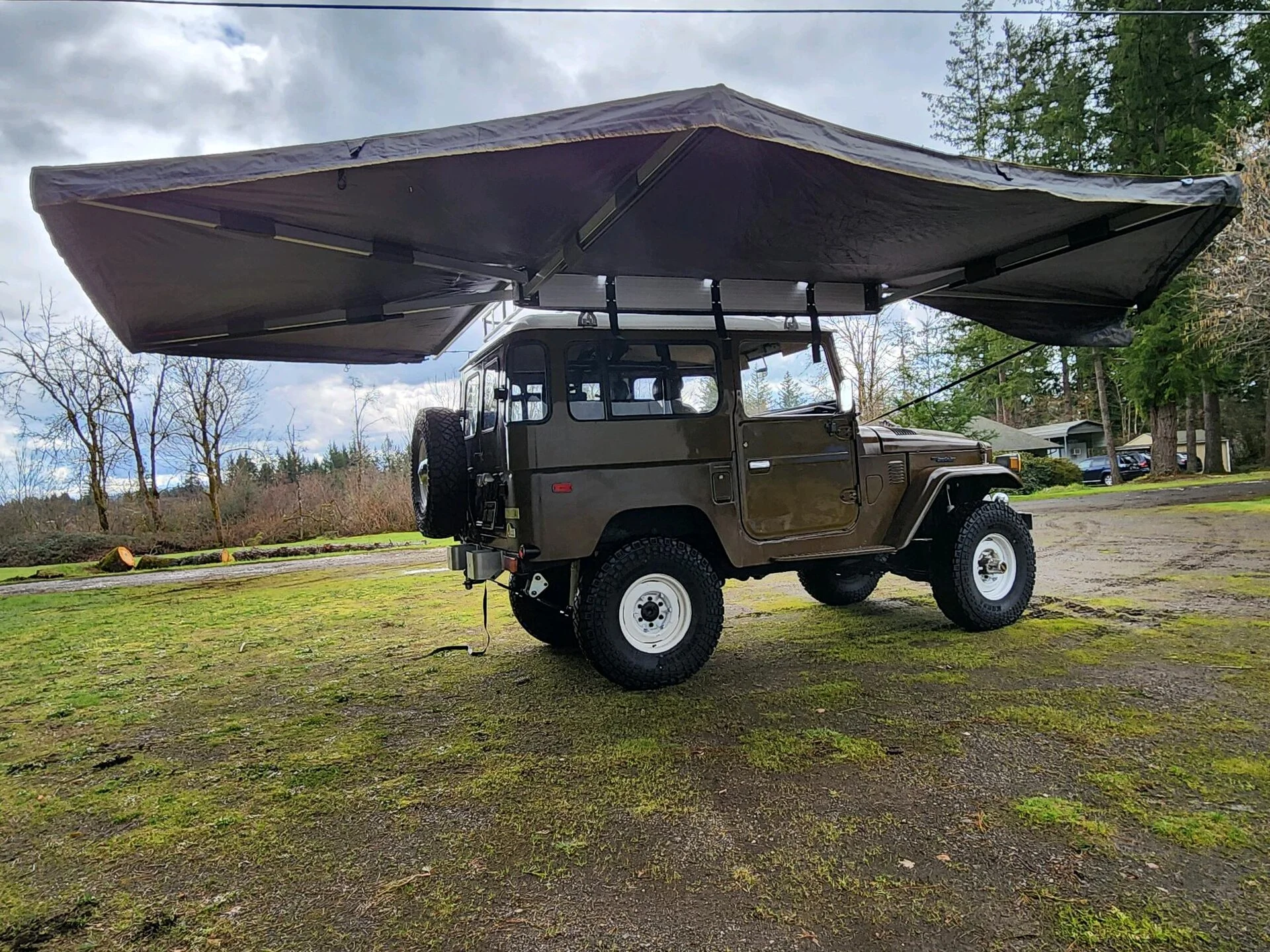

Chris,
Could I ask what brand is your awning and are you happy with it and the quality?
Thanks
Guy
This is the OVS nomadic 270 degree. I think the build quality is great. I dont have any complaints besides it does get wet when it rains in the cover. It sets up and closes up in less than 5 min. It also has full zip in walls that I do not own, but would be fun if camping somewhere cooler.
